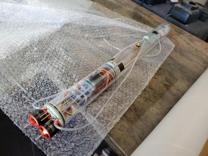

      Hi Bob,
      Can you expound more about the 2" SD you converted to external twin brushless. Click image for larger version

          Hi Bob,

          Nothing crazy in terms of that. I simply removed the brushed motors internally and added the brushless externally. Two motor wiring passes through the bulkhead with bullet connectors. Each motor has its own dedicated ESC (you can't run multiple brushless motors off of one ESC).
          I'm interested in my 2.5. Which esc you used.
          I'm not sure I follow your question, but if you're asking with brushless ESC's I use, then they re BLHELI32 units, available on my website.
