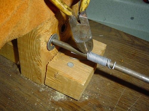

                              If I may add another way I used to make links (for chain, bezels, and such) is a dowel or rod of wood or steel and wrap your annealed brass around it several times. Then use a jewelers saw to cut down the length of your brass coil, now you will have a loop that with some pliers, be able to make the cut surfaces meet and solder for a completed circle. I wish I had photos to share. So, I hope this makes sense.
                                #570
                                Ye Olde Chain Maille Rings: There are many websites that will show you how to manufacture chain maille items, focusing on the different styles of 'weave' (how to combine metal rings together to make a protective and attractive garment) that you can use. Unfortunately, most of …
