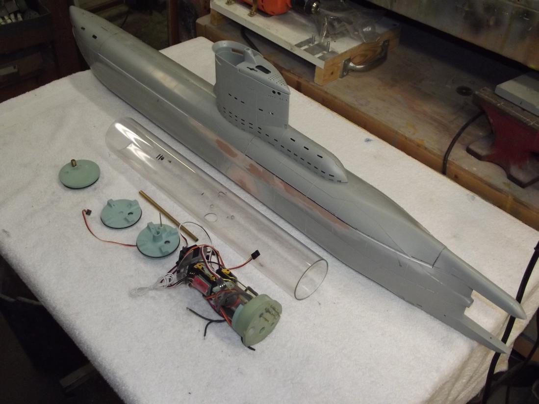

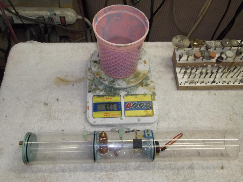

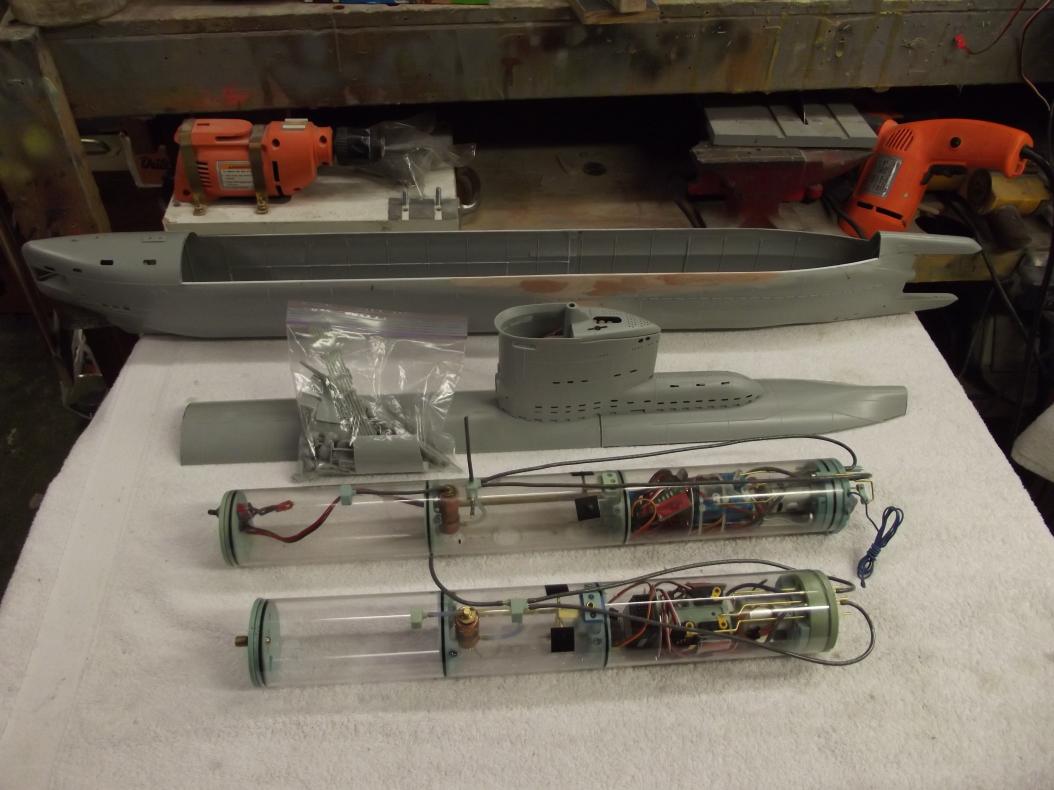

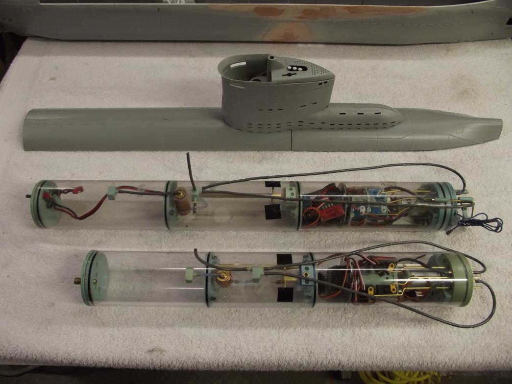

      Note that I've produced two SD's for the Type-23. The longer one is our 'standard' single-motor 2.5 SAS SD that is recommended for most of the modern 1/96 model submarine hulls -- and it's a perfect fit for the Bronco 1/35 Type-23 if you don't want to install practical torpedoes. Though that ballast tank is about five more ounces of water weight than required, that would be compensated for by installing the appropriate amount of foam under the deck, above waterline.
      The smaller SD is purpose built for this kit -- it's length short enough to permit installation of two weapons ... sorry, no re-loads!

        David- If I may ask.... I'm used to the old WTC3, 3.5, mod2, etc. I'm looking at the photo of the smaller purpose built SD specifically, but I see two extra hoses on both, which I'm assuming are the for the SAS variant? Also, with these systems, how do the forward and rear dive planes interact (front fixed, rear on some angle keeper, front on servo, or vice versa?). Also front area of system is for air? How does one drive a torpedo fire mechanism from this type of system? Sorry, lots of questions; my knowledge is so stale...
        Thanks!
        Sam

          I took a swift look at the SD, to me it seems that it can be deployed without making it shorter, took one of my launchers in the build, and did some measurements, it can be done, the extra room inside the ballasttank will be usefull since i have a tendency to throw in some extra weight due to the gizmo's.

            Heh. Just like the real boat.
            Thanks!
            Sam
            Hey, Sam!
            Just like old times.
            Dropping gas as the means of displacing the air from within the ballast tank I use a small air-pump (with the ability to ingest water without damage), taking a suction from either a snorkel protected induction line or air from within the SD itself to blow ballast water. As the pump is in the after dry space I need to run both the snorkel induction line and discharge line to the ballast tank atop the SD. Hence, the two flexible hoses you see. The forward dry space is for the battery. For more dope on the SAS ballast sub-system, read this: http://support.caswellplating.com/in...--how-it-works
            As always (with the exception of the Moebius TV SEAVIEW) bow planes are on independent control loops: the stern plane is tended by the driver or the angle-keeper. The bow/sail planes are tended by the driver or a depth-keeping device -- do not interconnect!
            And here's how the torpedo weapon system is employed, either mechanically or pneumatically: http://support.caswellplating.com/in...structions-172
            Welcome to the 21st century, pal!

              Thanks for the links, David. I have downloaded both pdfs and begun reading them. On my OTW Type XXIII, I drove the front planes with a servo, and used the angle keeper on the rear planes. With this boat's size, I wasn't sure if one set of planes would be enough to dive the model. Also, if you recall, that boat used an onboard compressor to control filling and emptying the ballast tank. For this kit, I like the fact that the ballast system leaves enough room to add weapons.
              The XXIII kit that I ordered from Mike here showed up yesterday, so I have been able to study the hull parts included in the kit, and the details. I'm impressed by the sheer size of the model, and the details look pretty good so far. A couple things already noted elsewhere; schnorkel head is a bit weak, the tubes for the schnorkel could probably be replaced, no horseshoe life ring, the emergency raft hatch at the front of the tower is sparsely detailed. I like that they included some of the trunking under the turtledeck, and some of the other details like the raft and the torpedoes (might be nice for a diorama). I'll be watching this thread carefully as you and Manfred continue to flesh out this conversion process.

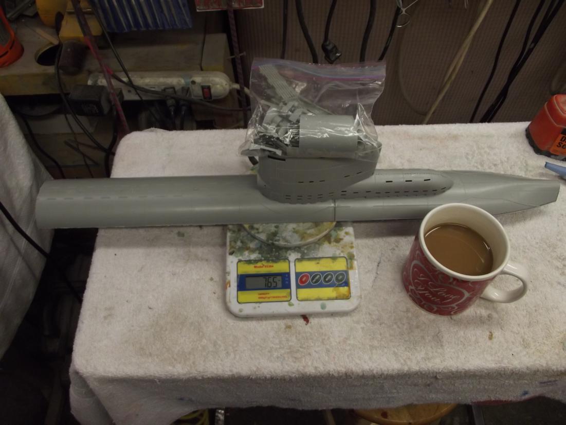

                  I ran the numbers of the actual G7E torpedo against the one provided in the kit and found the kit torpedo to be too fat and a bit longer than the documents I used -- even more room up there for a practical torpedo, guys.

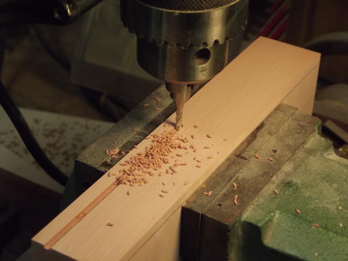

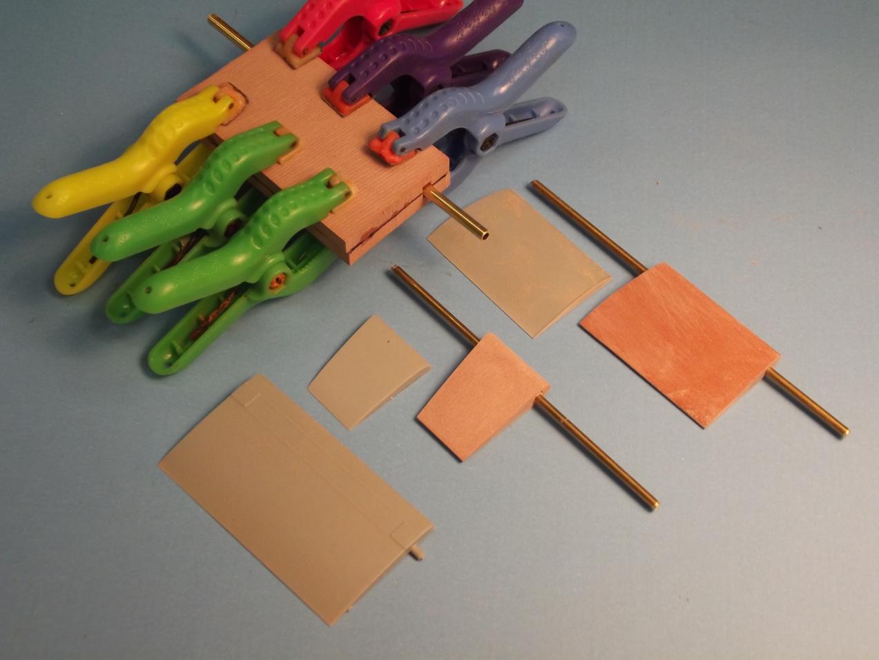

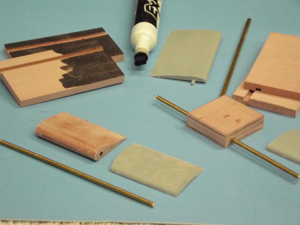

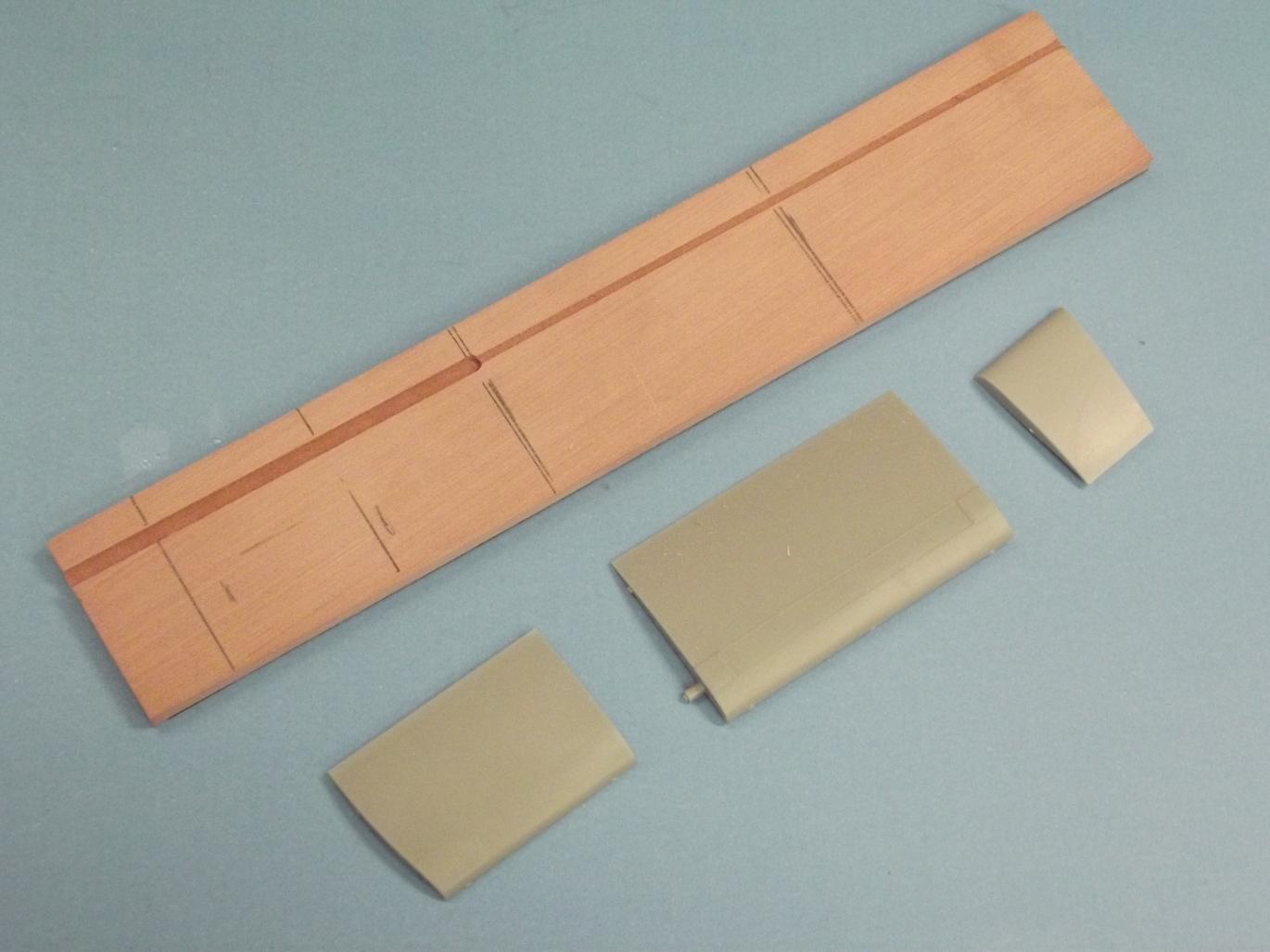

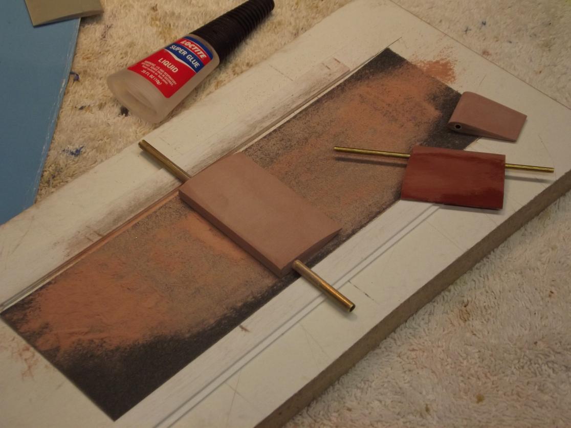

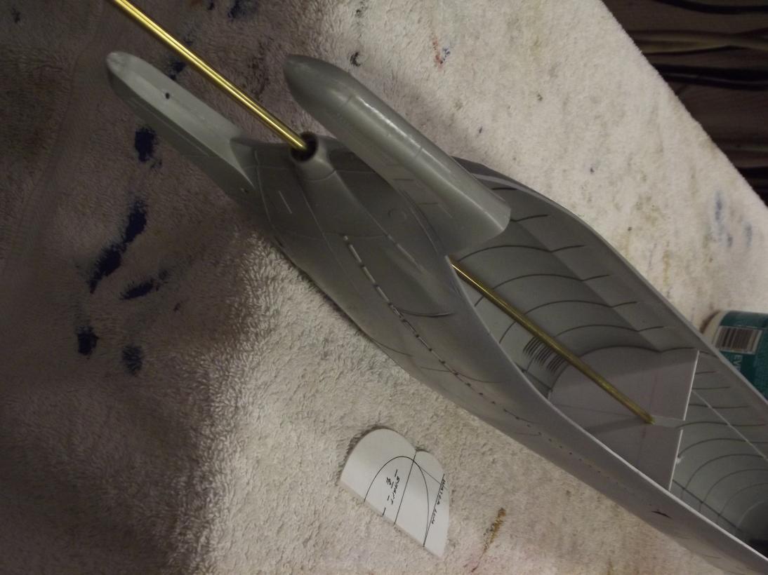

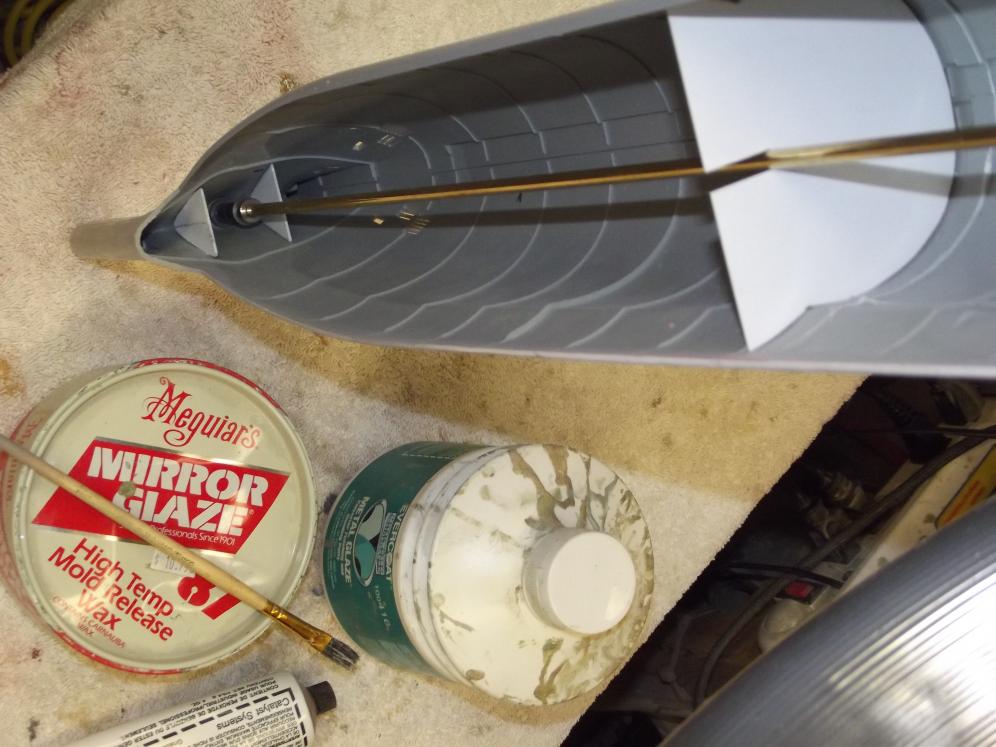

                          This morning I got to work on the control surface masters (NOT using any kit parts ... I have not had a word with any of the good Bronco folk's about such use). The blanks built up by two laminated pieces of 40 lbs. RenShape. The assembled blanks create a reference plain needed to assure symmetry as I cut, filed and sand the blanks to correct foil section, using the dark perimeter outline as a datum.
                          And that's a shortcoming of the kit, the hydrofoil shape to the stern planes and bow planes is a bit off. My masters don't suffer that shortcoming. I've elected to go with 1/8" control surface operating shafts for the stern planes and bow planes as they are subject to collisions on this subject. The rudder is well protected, so its operating shaft will be 1/16" (this will make installation of the eventual linkage components within the tight confines of the upper rudder support piece a bit easier).

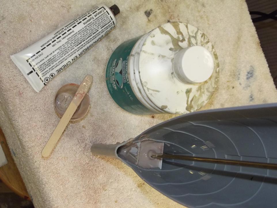

                          I also poured a thinned two-part filler into the stern to form the propeller shaft foundation master.
                          To be continued.
                                To be continued.
                                What do you use to thin the filler with?
