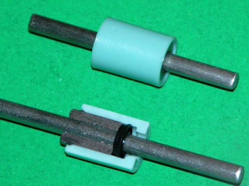

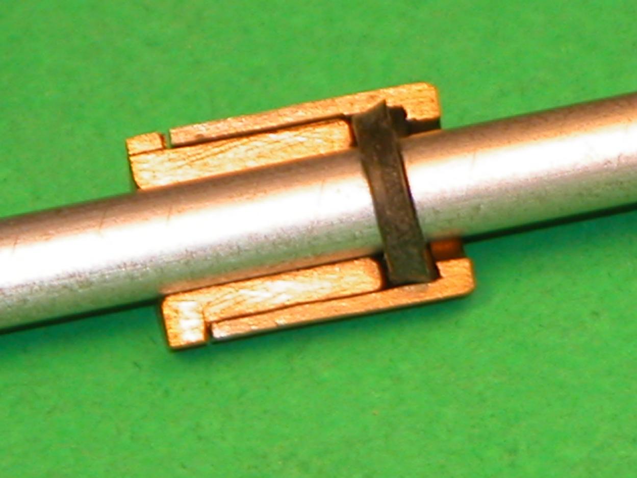

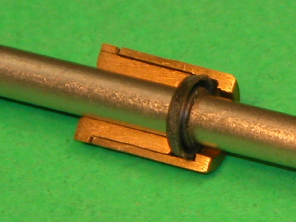

    Wet side to the right.
    Click image for larger version  Name:	035.JPG Views:	0 Size:	89.3 KB ID:	149724Click image for larger version  Name:	025.JPG Views:	0 Size:	83.5 KB ID:	149725Click image for larger version  Name:	027.JPG Views:	0 Size:	79.0 KB ID:	149726

      David, how does the opposing gear shaft adhere to the endcap, I am confused
        • 13974
        #168
        The opposing gear is free to slide out and is kept in place by the rigidity of the running gear - the shaft and universal (flexible tube) elements. The ahead and astern loads are absorbed by the submarines strut bearings (the GATO) or stern tubes (the OSCAR). Neither the drive or opposing gear are subjected to thrust loads.
