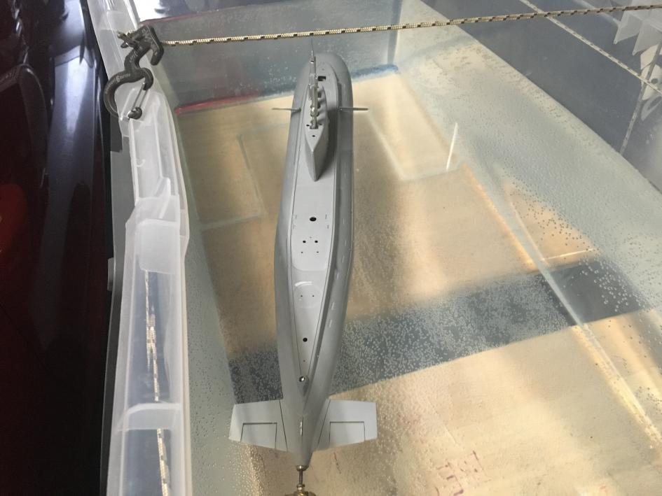

      Working on Trims in trimming tank today, fingers crossed!

        #123
        Trimming is close, need to raise the stern a bit. Click image for larger version

          #124
          Actually, submerged trim is next and I won’t raise the stern as after submerge she is level. Since I driver her in salt water she will sit a bit higher surfaced.

              #126
              She is fully trimmed, surprisingly stable, we shall see when she is transported to my sub compound……. Click image for larger version

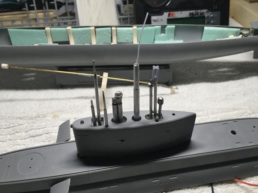

                      For you Bob, the 1.25” antenna : Click image for larger version

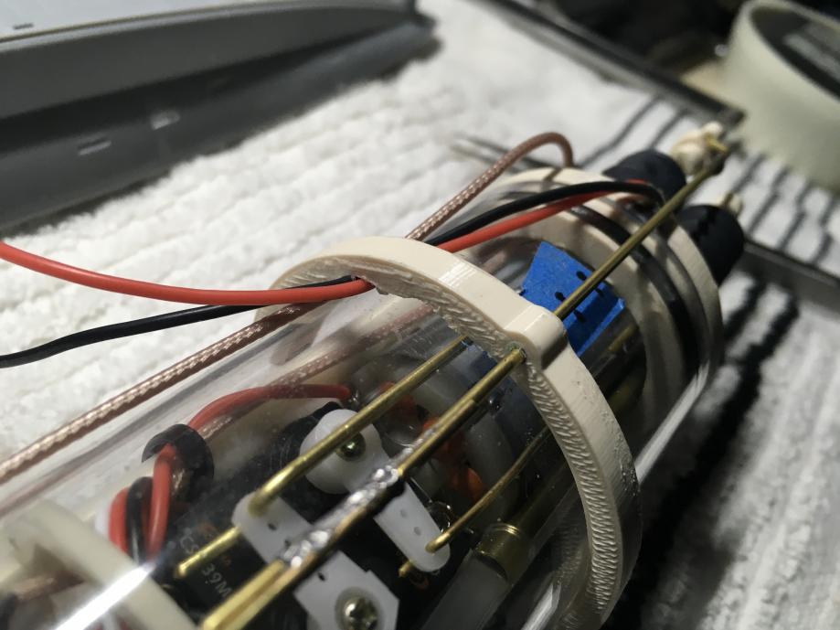

                        #131
                        I created a groove in the dive planes cradle to hold the lighting and antenna wires to rest in place against the cylinder Click image for larger version

                          #132
                          External battery? Doesn't the RCshipyard WTC already have provisions for 2 pairs of 18650 batteries, 2 for the pump and 2 for the drive motors/ servos?
                          • biggsgolf
                            • Jan 2020
                            • 1036
                            #133
                            No external batteries, out of curiosity why did you think that I indicated that?
                              #134
                              I don't know, maybe the RED and BLACK wires?
                              • biggsgolf
                                • Jan 2020
                                • 1036
                                #135
                                Oh, those are for the LED navigation and rudder lights
