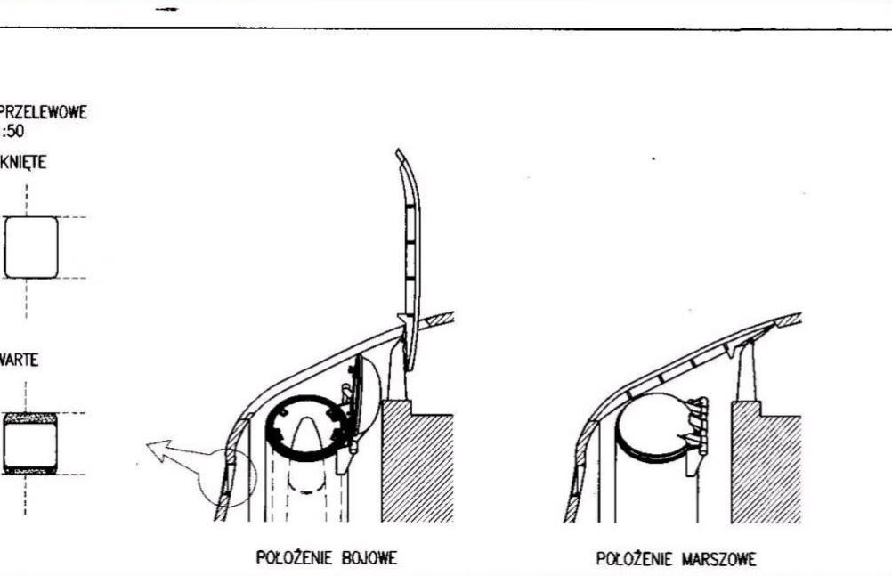

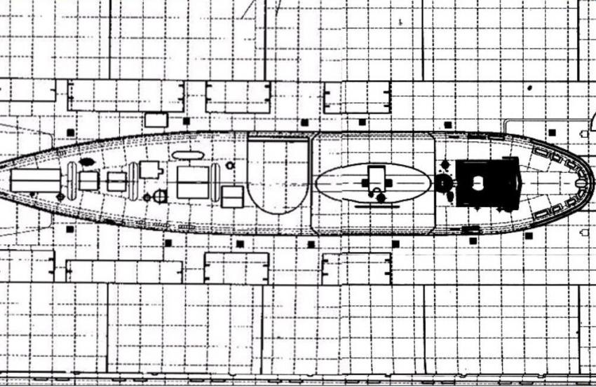

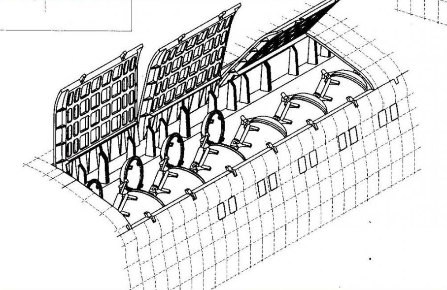

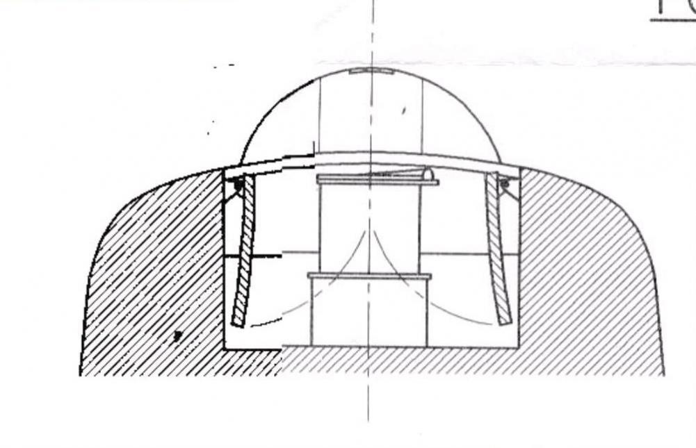

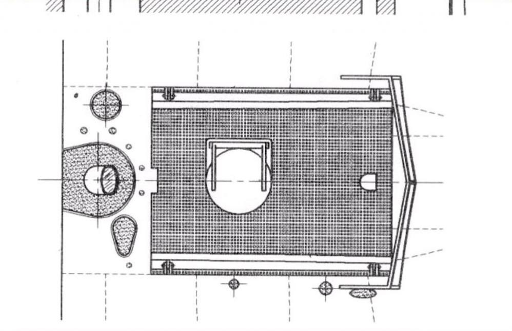

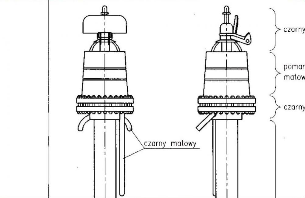

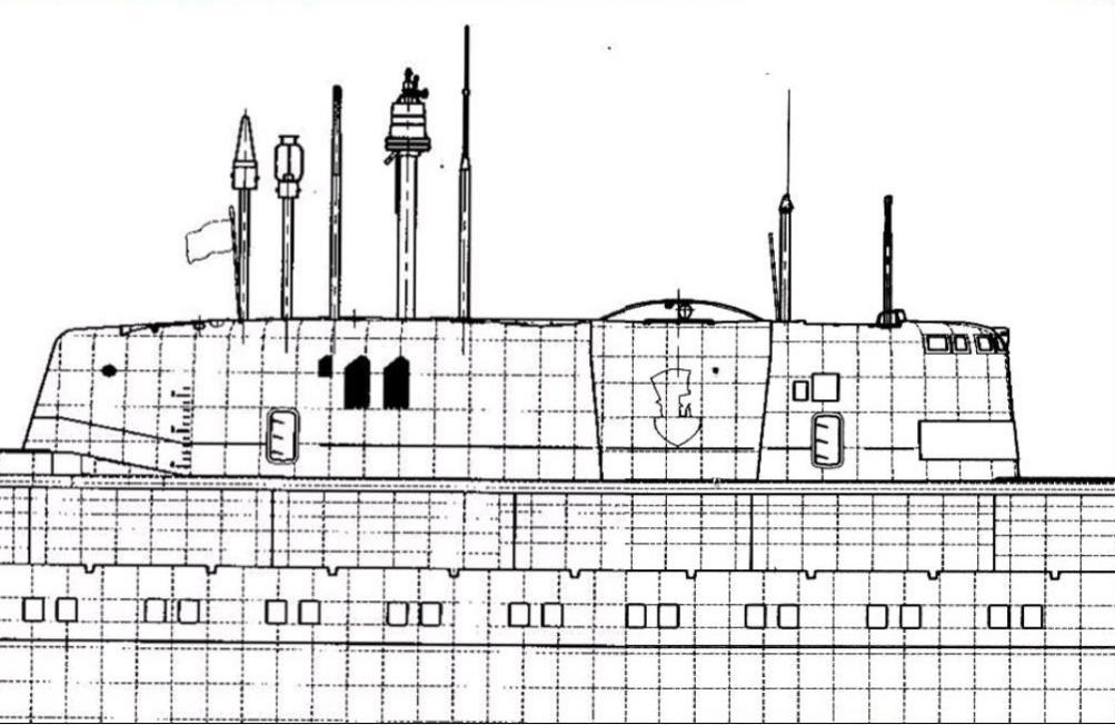

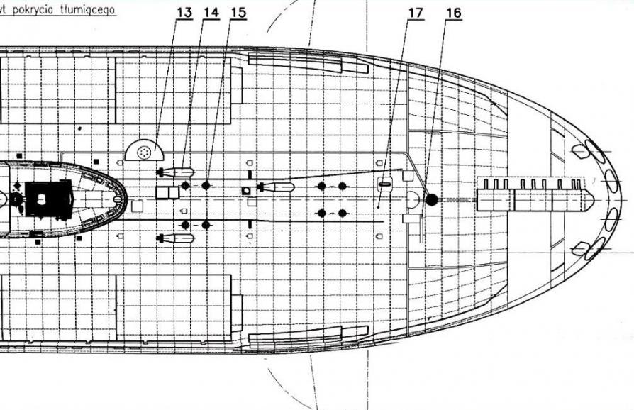

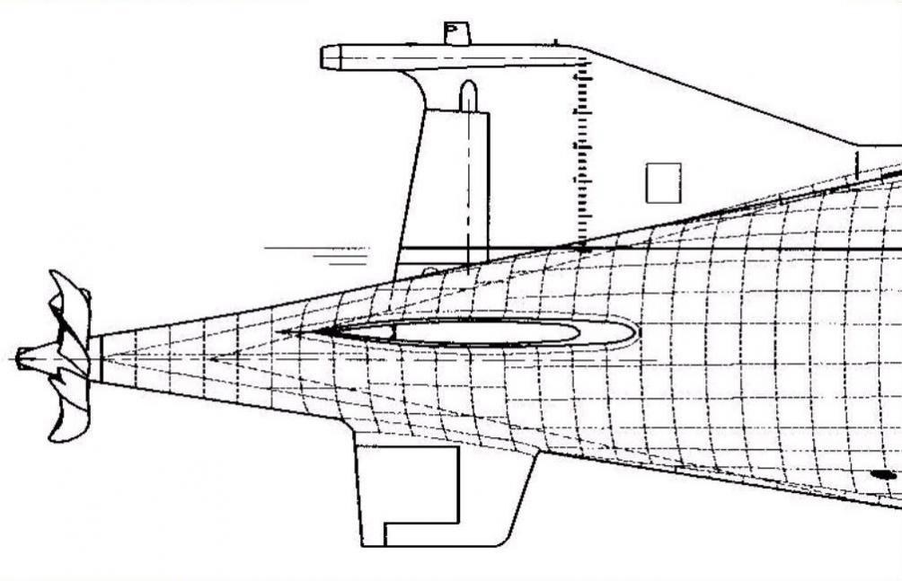

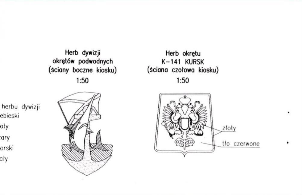

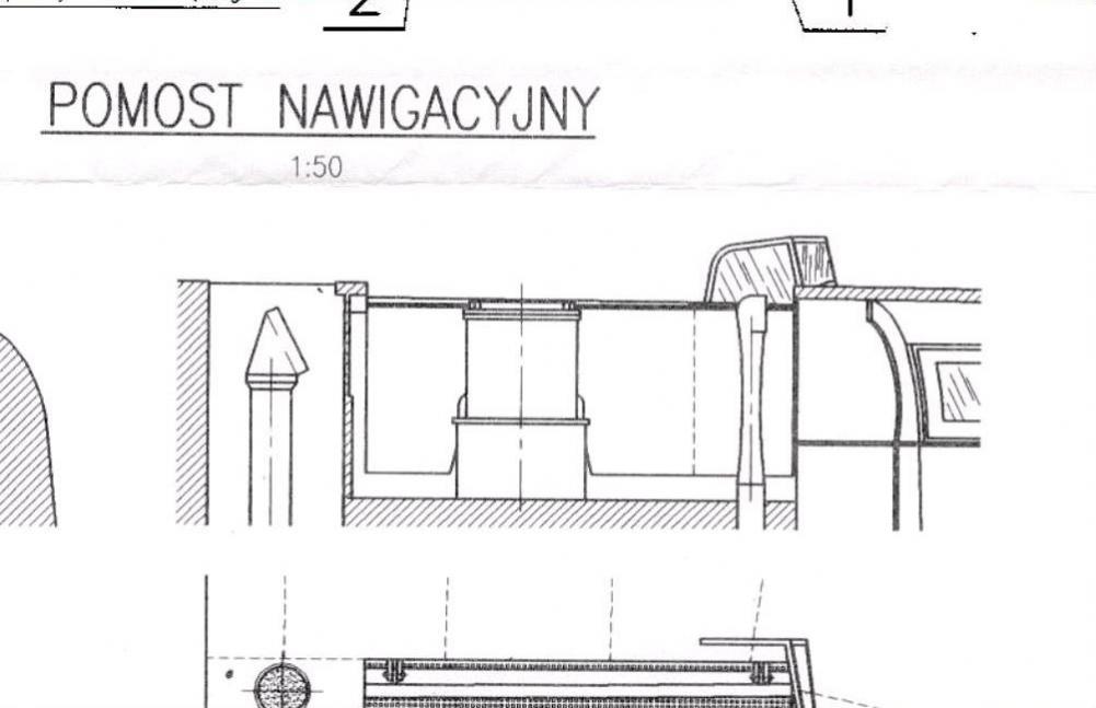

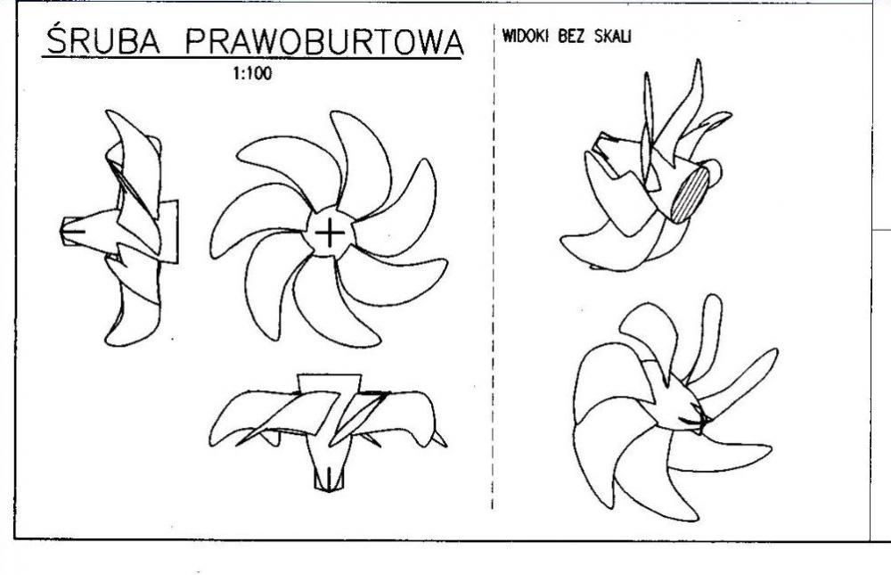

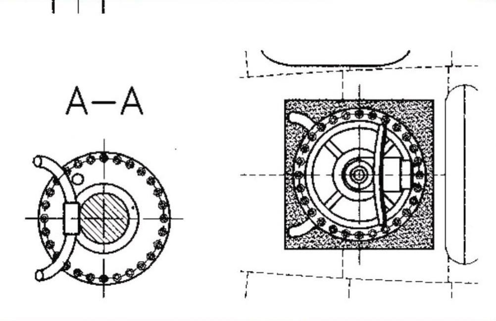

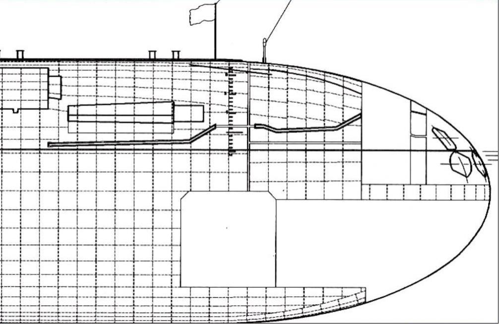

      PeterW found some excellent High resolution plans. After he went to all that trouble, I thought it only proper that I would zoom in on the nice crisp details and extract some images of the plans. Thanks Peter.

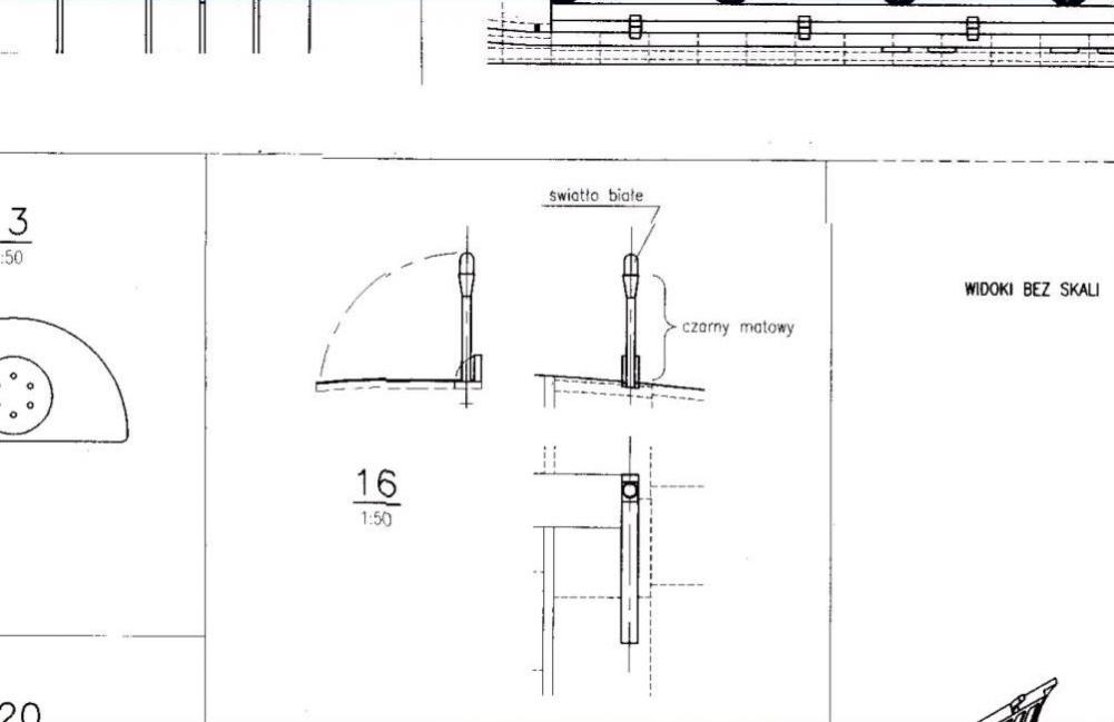

          Another one in this series, the bow light. I didnt know, until I looked at this drawing, that it folded down.
