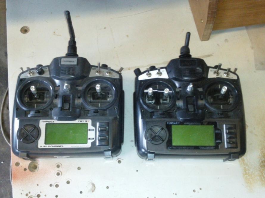

                    On the twin throttle subject I run a modified Turnigy 9X Tx on CGN9 with twin throttle sticks (thx Oztruck!!) I can spin the 3m cruiser on the spot, pull perfect docking maneuvers(most of the time!winds permitting...I also get told off for showing off and going to fast....) For a big twin screw Russian (Oscar or Typhoon) I would invest in a FC16/ or F14 set with the twin stick setup (get em while ya can....) I think Rob over in Perth drives his Typhoon with an F14Navy Tx. With the great width between props 'tank' steering should assist enormously...
                    My two Surface unit Tx's
                    Cheers Bruce

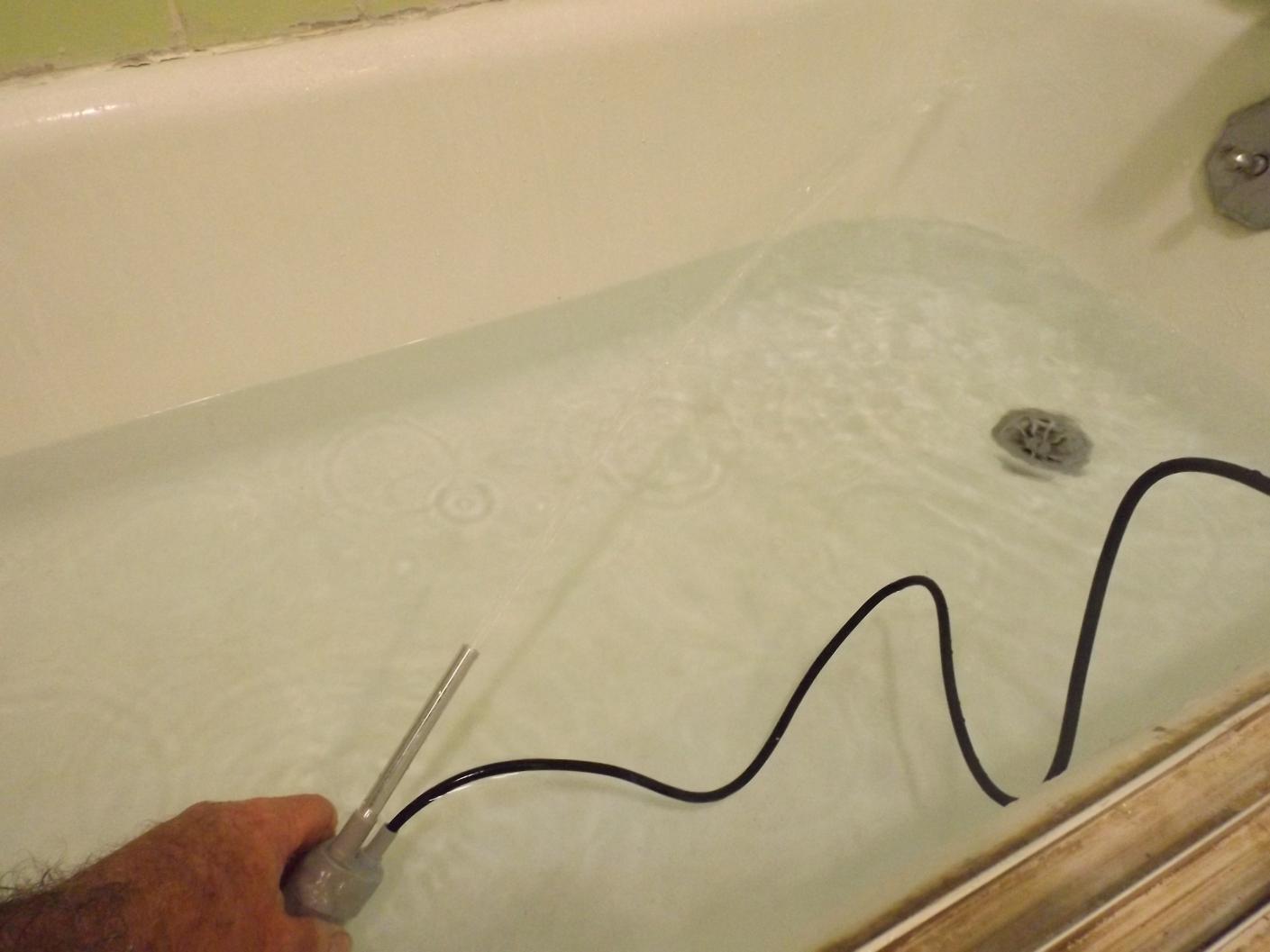

                        Well, I was hoping for more thrust but, I guess that its enough to try it. In the bathtub,as you can see, it sends out a stream of water 2 to 3 ft. long. I reduced the output tube size to a little less than 1/4" to achieve this. Ill do that again so that I can use 9/32" brass tube to exit the hull. I just today ordered three more pumps. After they arrive and are tested then Ill order the electronic switches and begin the installation.Click image for larger version

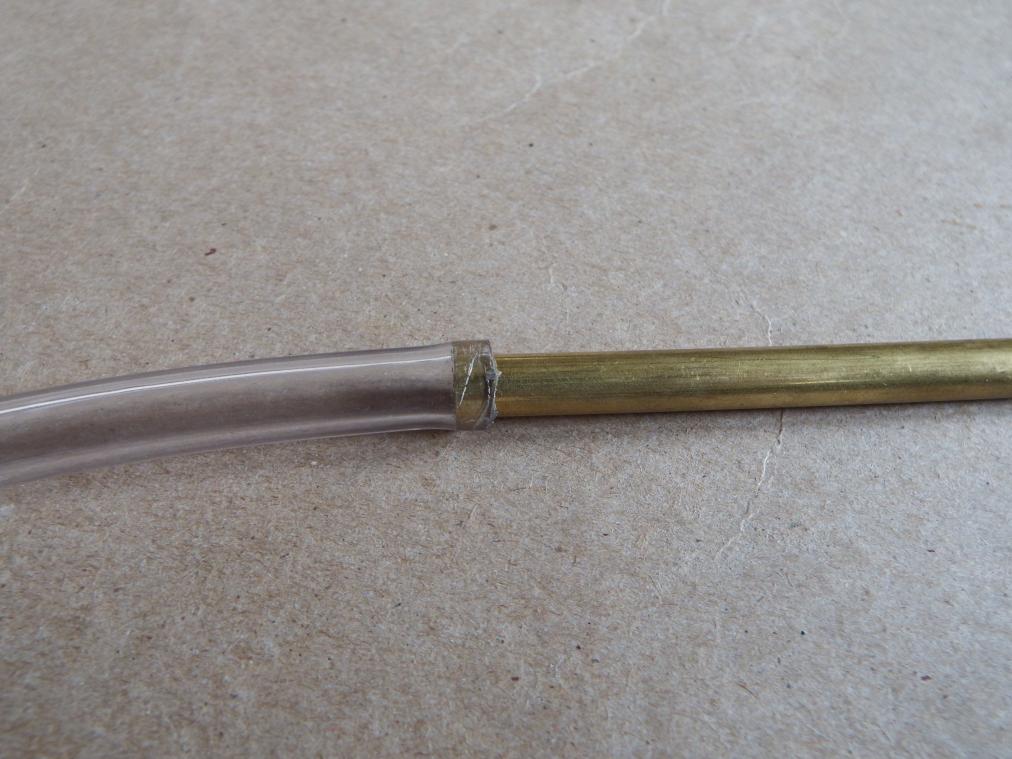

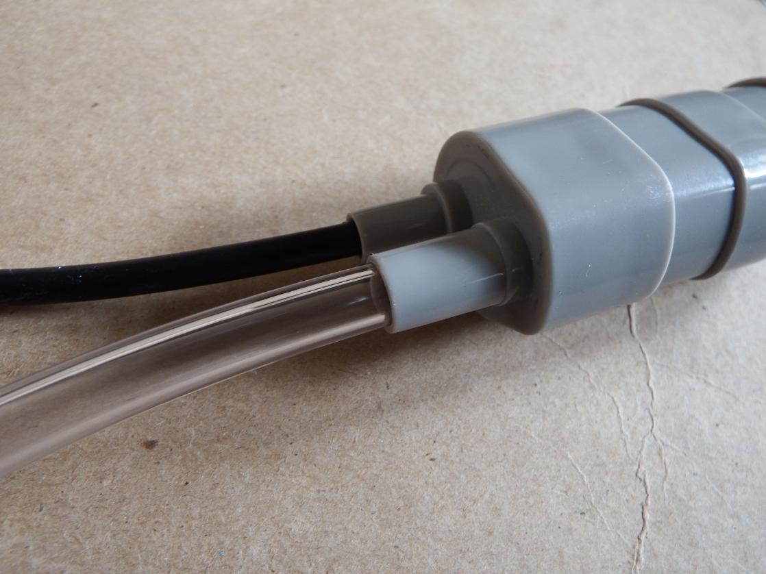

                            Thanks Gary. Here we are with the pump. A trip to Lowes yielded good results on the plumbing of this thing. I was going to buy a bunch of brass round tube that slides nicely within each other and make a reducer. It was going to cost $32 to go that route. IM NOT MADE OF MONEY............ya know. Lowes had the answer with this 3/8" nylon hose. Ill silicone it inside the pump exhaust nozzle. Its a good fit over the 9/32" Brass tube that ill use as an exit nozzle jet. Im going to set nozzles on all four corners, and use one pump at each corner. On each corner Im going to install two nozzles, one at 90 degrees and one at 35 degrees angling away from the center of the boat. I will explore the various nozzles and If the force is too high ,Ill put a resister inline electrically.Click image for larger version

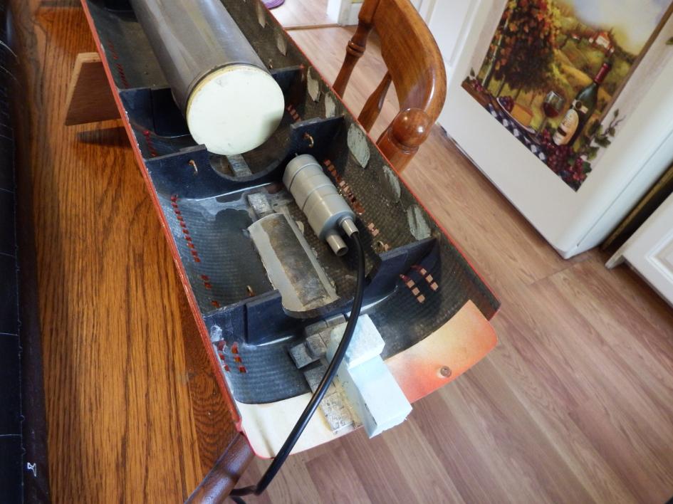

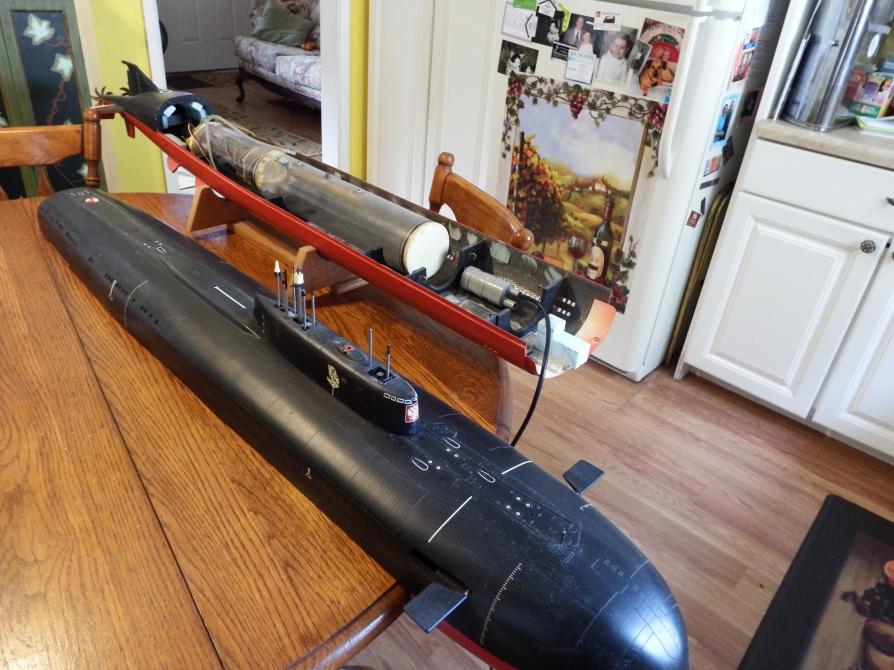

                              I dont know whats wrong with the pictures but they dont display unless you click on them. At any rate there is plenty of room to put the pumps in between the Subdriver and the inside hull wall.Click image for larger version
