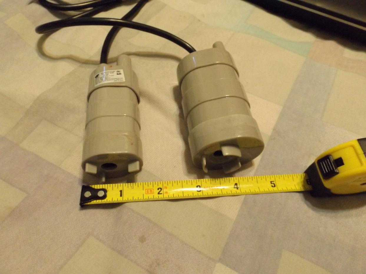

    OMG!!!!! The Kobiashi Maru finally arrived! The little Sampan showed up and dropped off these thruster motors that I have been awaiting for what seems to be an ETERNITY!!! How do they expect you to leave good feedback. I ordered these so long ago that I forgot that I had ordered them in the first place(rambling on blah blah and blah) If youll notice in the picture, the first ones I ordered a couple of years ago is shown on the left. The new ones is of course on the right. Ill be testing them today to make sure.

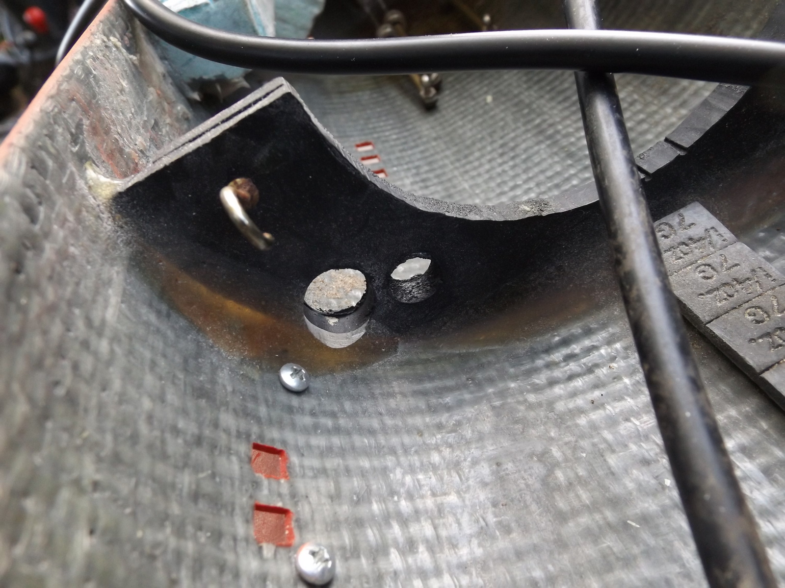

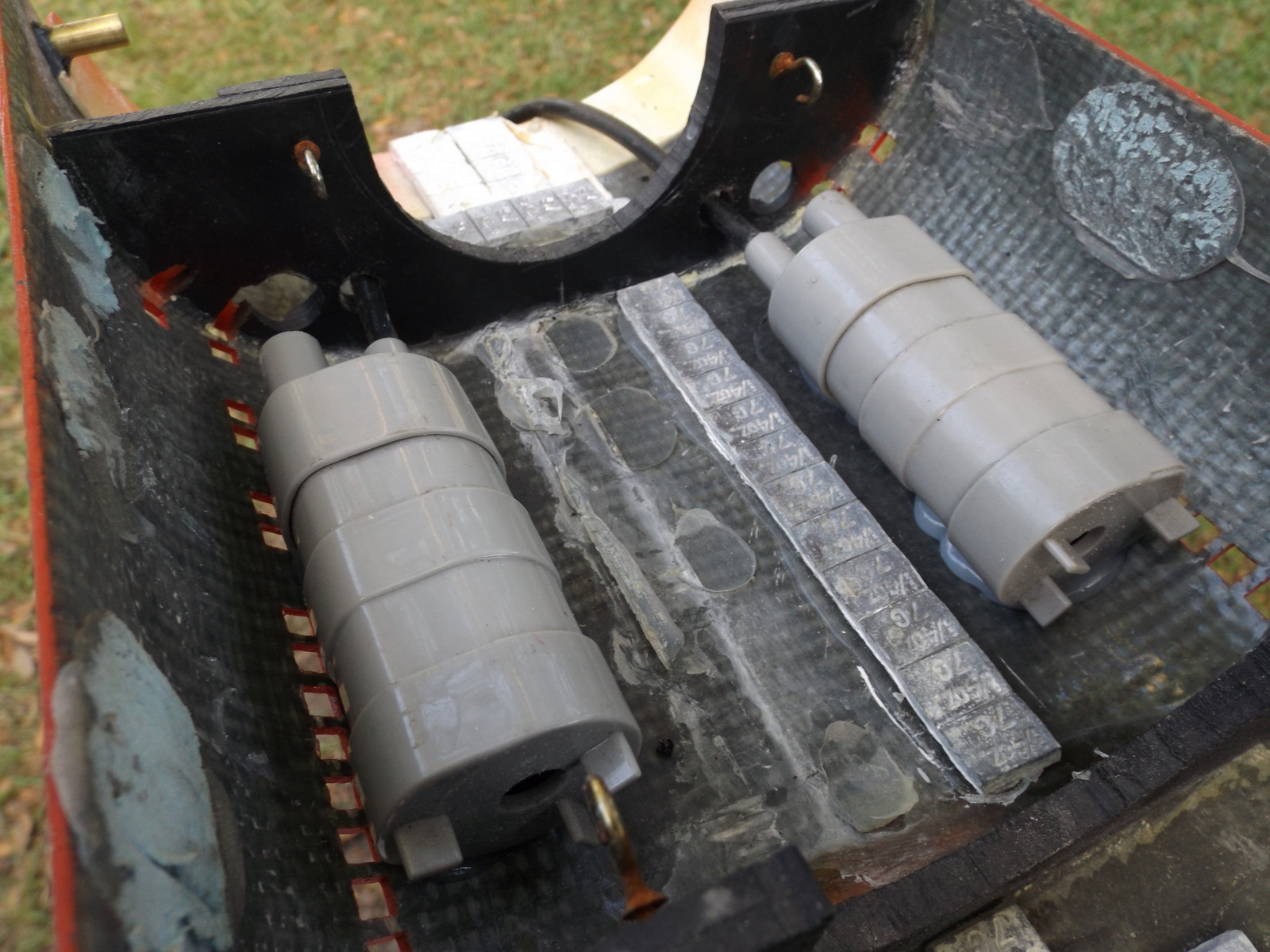

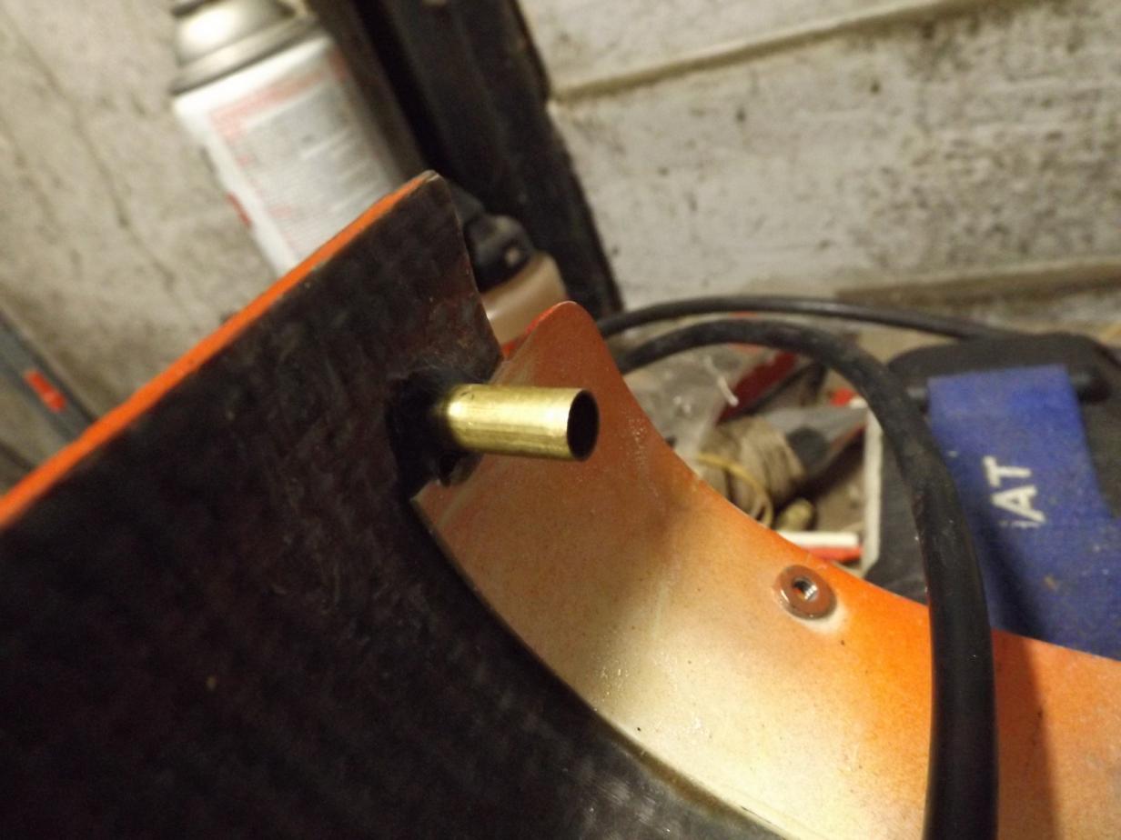

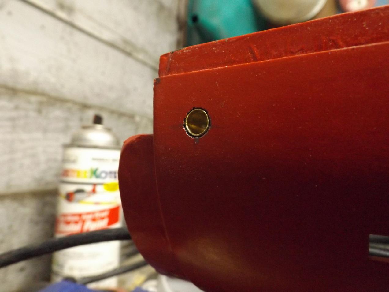

      Surprise.....surprise......Im not surprised at all! Comparing the smaller pond pump with the new larger one, I see absolutely No performance difference, yet the makers claim a tremendous increase in volume. Sorry, its all exaggerated anyway. So I decided to put the older model in the boat because they are smaller. Ive got half a mind to send the new ones back, but I think its probably more trouble than its worth. At anyrate, I determined the location of the non-scale thruster nozzles and drilled and installed the 1/4" diameter brass tube nipples near the four corners of the submarine at least a half inch below the waterline...Then I siliconed the four pumps in place after drilling holes in the bulkheads for the output hoses and the input wires. Its a start. Click image for larger version

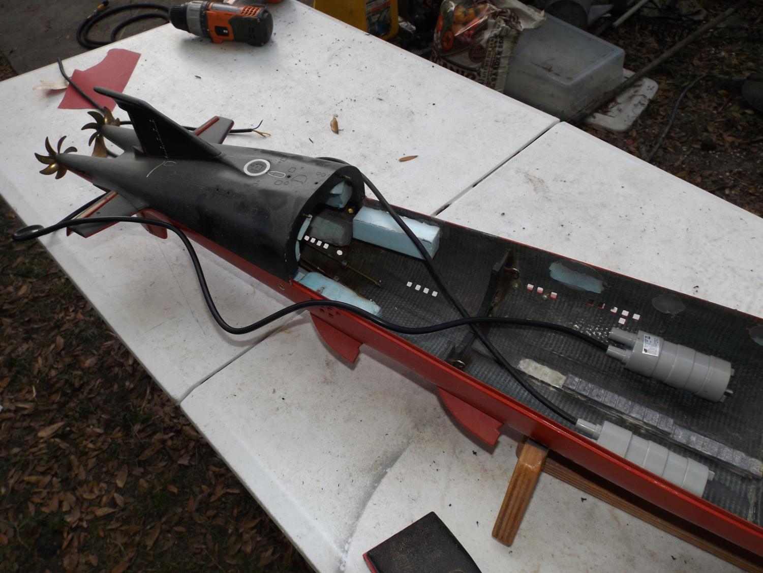

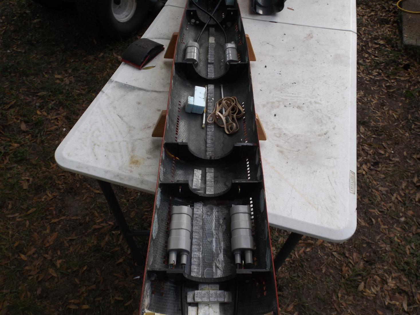

        Additional pictures
