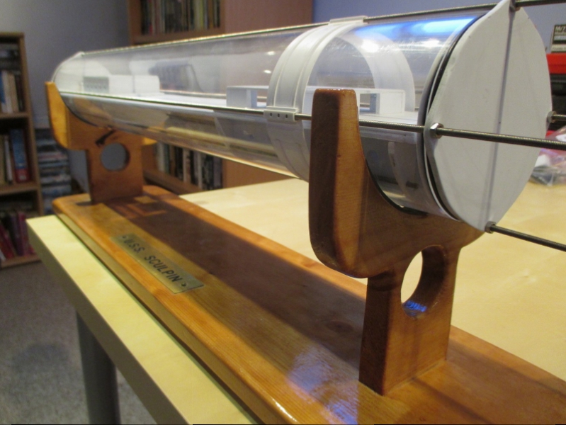

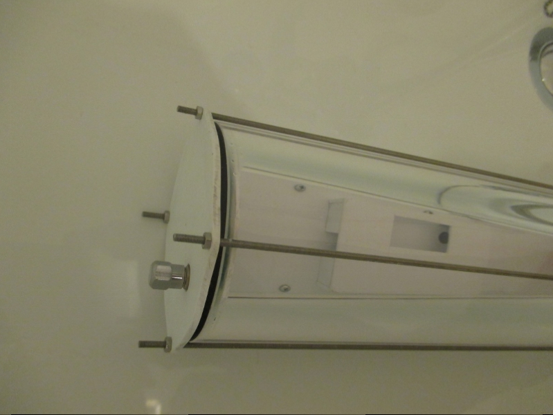

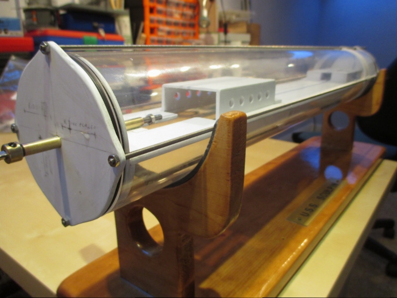

        So here is the finished article, just out of the bath from two hours immersion, totally dry inside.
        Click image for larger version  Name:	IMG_0799 (800x600).jpg Views:	1 Size:	279.9 KB ID:	119183Click image for larger version  Name:	IMG_0800 (800x600).jpg Views:	1 Size:	289.8 KB ID:	119184
        Now of course there are servos, electronics etc. etc. all to be sorted, but they are 'add ons', the WTC as a solid unit is finished bar trimming the 3mm threaded rods.
        Click image for larger version  Name:	IMG_0801 (800x600).jpg Views:	1 Size:	254.0 KB ID:	119185Click image for larger version  Name:	IMG_0802 (800x600).jpg Views:	1 Size:	223.6 KB ID:	119186
        I thought it would be worth detailing the time/cost on this, and I don't mean any offence to professional suppliers, I hope non is taken.

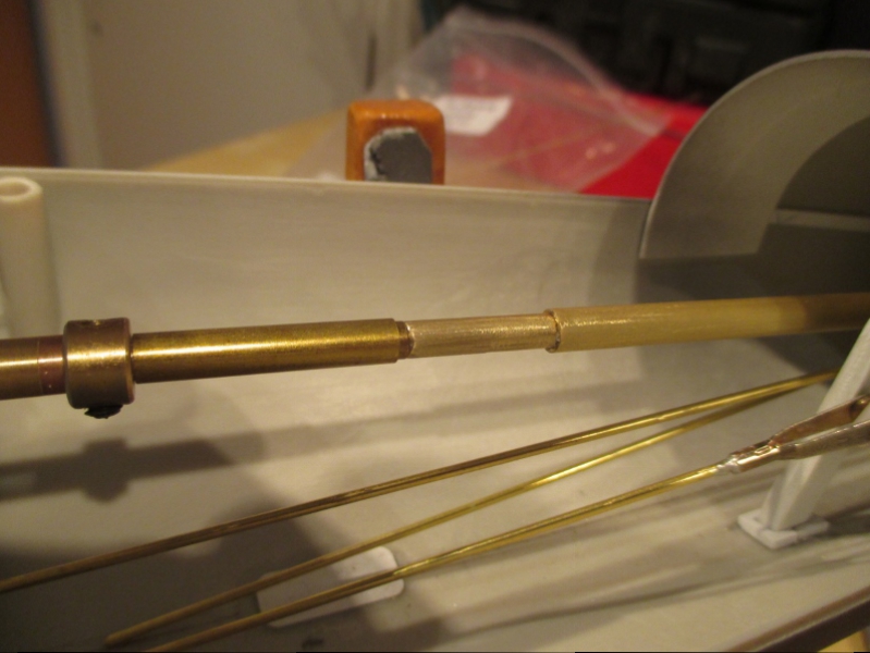

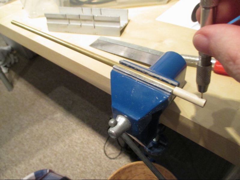

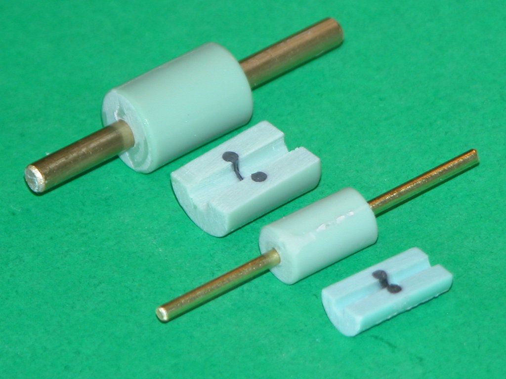

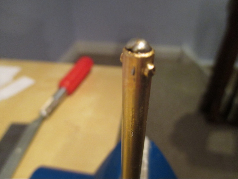

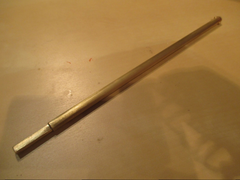

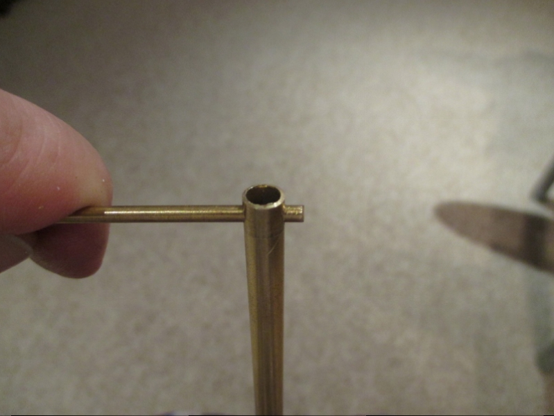

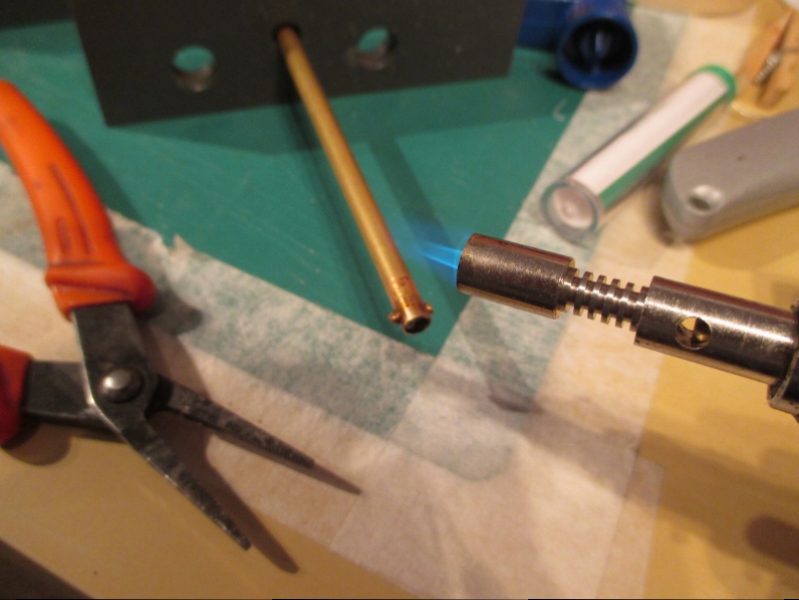

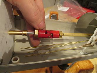

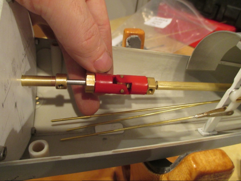

              I've built my own prop shaft, I found a tube of 6mm brass in the spare box, a tiny pilot hole was drilled from one side to the other, opened out to 2mm and a piece of 2mm rod inserted.
              Click image for larger version  Name:	IMG_0796 (800x600).jpg Views:	1 Size:	270.1 KB ID:	119191Click image for larger version  Name:	IMG_0798 (800x600).jpg Views:	1 Size:	219.5 KB ID:	119190
              The rod is trimmed to make a dogbone and soldered in place with the torch (soldering iron not powerful enough).
              Click image for larger version  Name:	IMG_0804 (800x600).jpg Views:	1 Size:	263.5 KB ID:	119192Click image for larger version  Name:	IMG_0805 (800x600).jpg Views:	1 Size:	228.4 KB ID:	119193
              The finished tube exactly cut to length with a 5mm rod inserted and glued in place, with a flat filed for the coupler.
              Click image for larger version  Name:	IMG_0806 (800x600).jpg Views:	1 Size:	240.3 KB ID:	119194
              The prop shaft is in line with the shaft from the WTC, it's so accurate I prob don't need another coupler, but will use one just to iron out any tiny misalignment.
              Click image for larger version  Name:	IMG_0807 (800x600).jpg Views:	1 Size:	252.6 KB ID:	119195Click image for larger version  Name:	IMG_0808 (800x600).jpg Views:	1 Size:	285.5 KB ID:	119196
              I never made a prop shaft from scratch before....cool.
              But I've now got four shafts, one coming out of the gear box from the motor, one through the stuffing tube, one from the stuffing tube shaft to the mini shaft on the prop with the U connector!!!!! Must fail some ergonomic rules............................

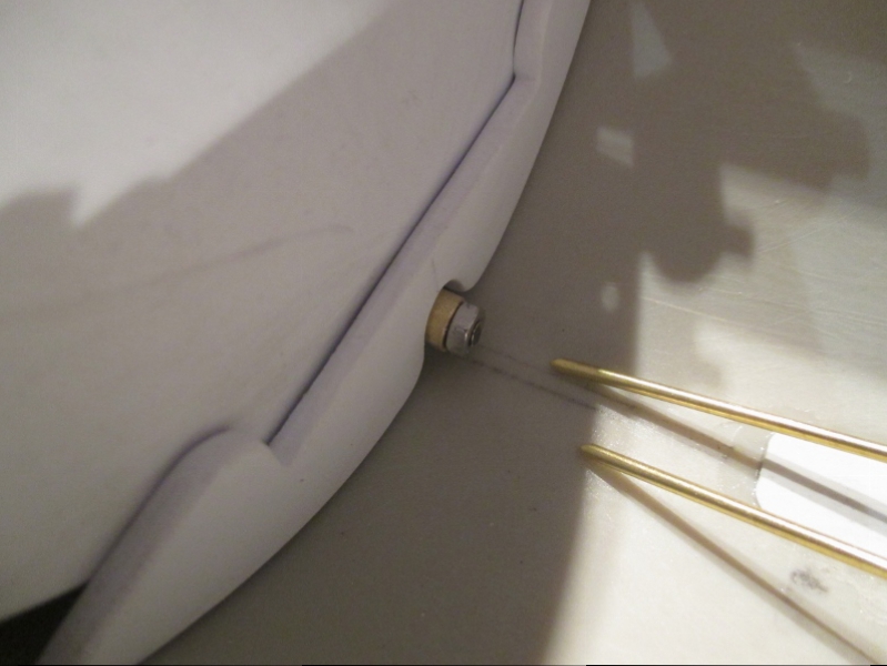

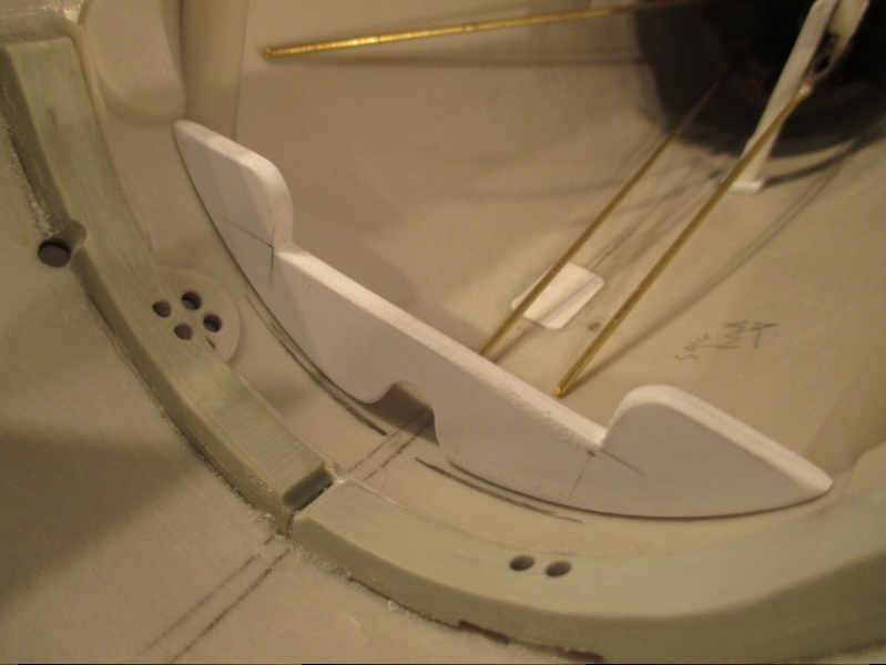

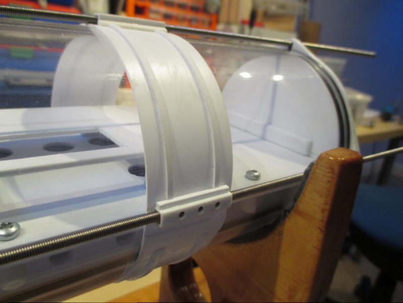

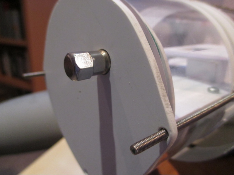

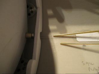

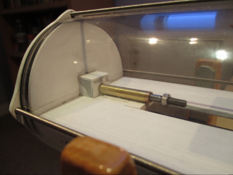

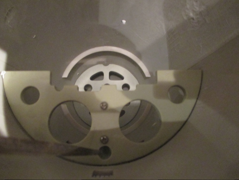

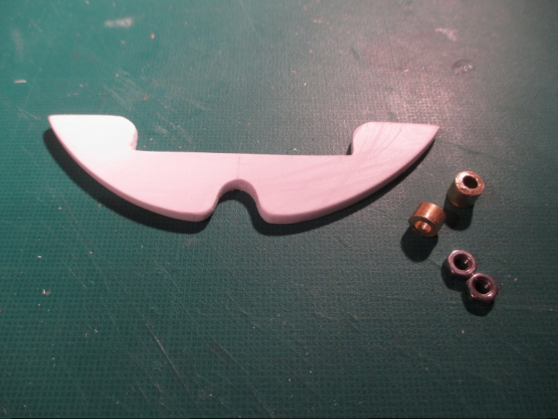

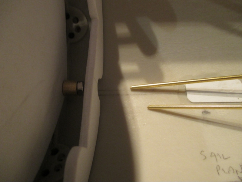

                This fitting is made from 3.2mm styrene, and with two brass bushes will hold the WTC down in the hull.
                Click image for larger version  Name:	IMG_0809 (800x600).jpg Views:	1 Size:	287.2 KB ID:	119218
                Glued to the hull, the fitting acts as a backstop to the rear of the WTC, and the 7mm hole at the bottom accepts the lower threaded rod with the brass bush attached
                Click image for larger version  Name:	IMG_0810 (800x600).jpg Views:	1 Size:	233.8 KB ID:	119219Click image for larger version  Name:	IMG_0811 (800x600).jpg Views:	1 Size:	236.4 KB ID:	119220Click image for larger version  Name:	IMG_0812 (800x600).jpg Views:	1 Size:	227.8 KB ID:	119221
                The front part of the same rod gets a brass bush and fits into this 7mm hole drilled in the Caswell fittings in the front hull.
                Click image for larger version  Name:	IMG_0813 (800x600).jpg Views:	1 Size:	242.9 KB ID:	119222
                The WTC is now anchored when in operation, pinned at the rear by the backstop and at the front by the Caswell fitting, but can slide out of both when the hull parts are separated.
                The Boattrainman

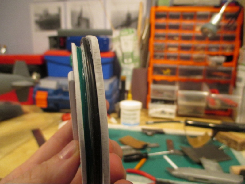

                  So pressure testing begins, the unit passed the immersion test with no pressure, it doesn't leak, big deal. But blowing down the stuffing tube, it leaked like a sieve.
                  First job was to tighten the inner O ring with a bit of tape.
                  Click image for larger version  Name:	IMG_0818 (800x600).jpg Views:	1 Size:	283.2 KB ID:	119247

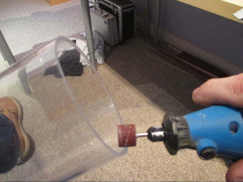

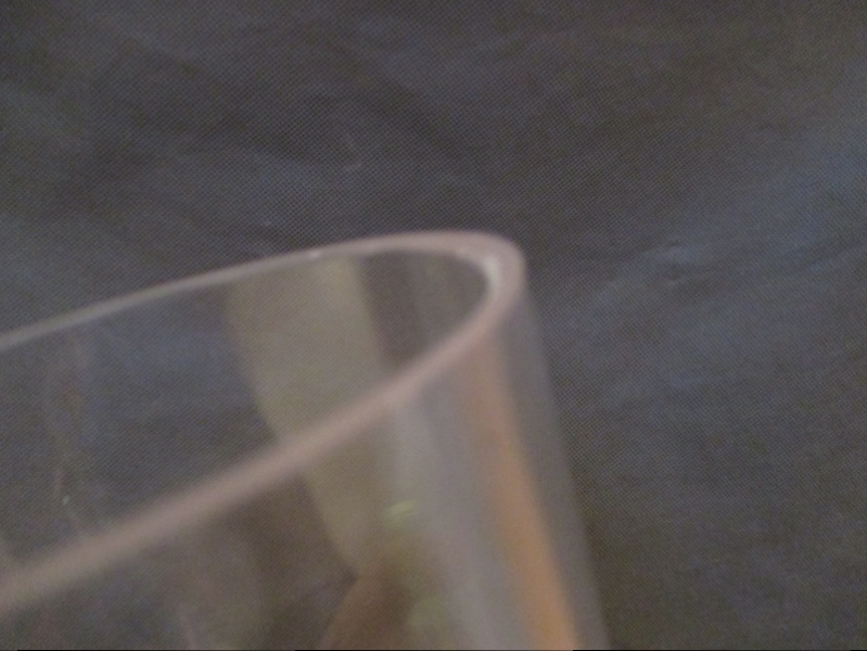

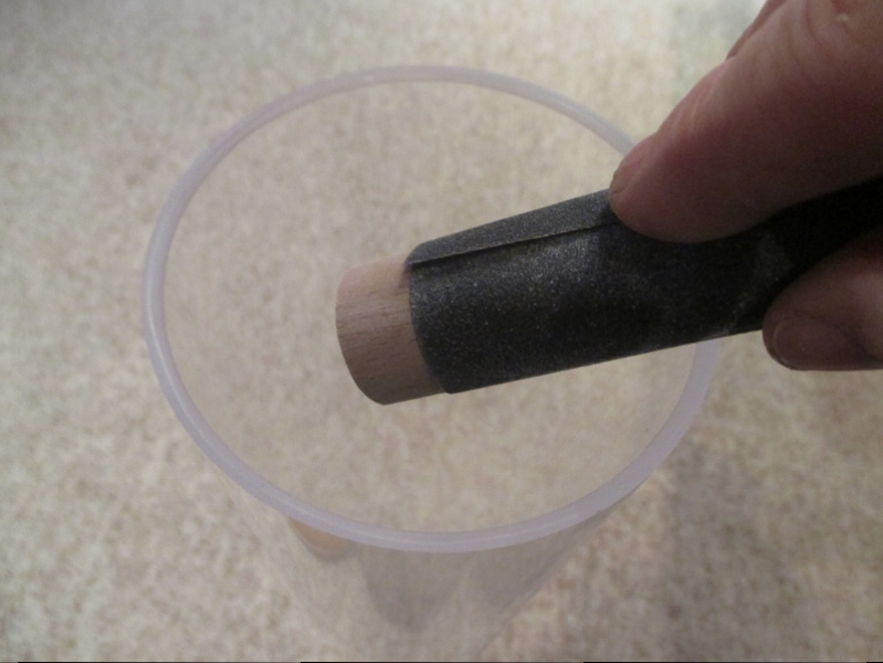

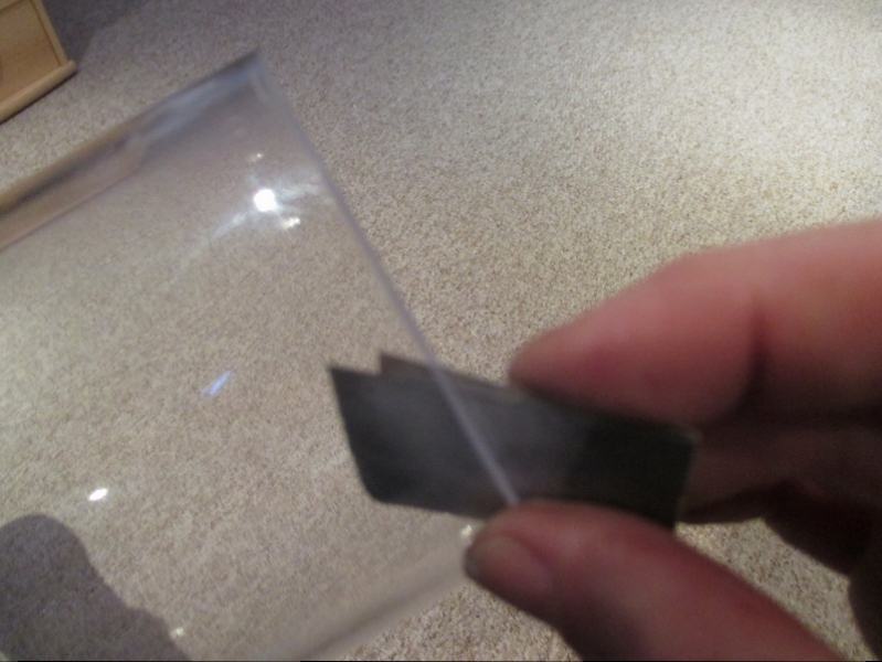

                  That sorted out, I the bevelled the edge of the WTC, not an easy job. I decided around a 30 degree bevel, and used a mini sanding drum..........
                  Click image for larger version  Name:	IMG_0814 (800x600).jpg Views:	1 Size:	295.9 KB ID:	119248
                  .....followed by 120 grit sandpaper on a round pole.............
                  Click image for larger version  Name:	IMG_0815 (800x600).jpg Views:	1 Size:	232.4 KB ID:	119249
                  .......and finally 400 grit by hand.
                  Click image for larger version  Name:	IMG_0816 (800x600).jpg Views:	1 Size:	281.2 KB ID:	119250
                  This was a tricky job, as the outer rim must not be damaged or the seal will be lost, the bit to remove is from the inner rim. The mini sanding drum does give a bit of a wavy line, the trick is to keep checking and going back over bumps.
                  Click image for larger version  Name:	IMG_0817 (800x600).jpg Views:	1 Size:	261.2 KB ID:	119251
                  Putting it all back together and giving it a good amount of air down the stuffing tube (as a trumpet player I can get a fair bit of pressure up), the seal at both ends was intact.
                  Many thanks to Trout for the tape and bevelled edge ideas, the final pressure test will be to get the WTC up to piston tank level of stress.

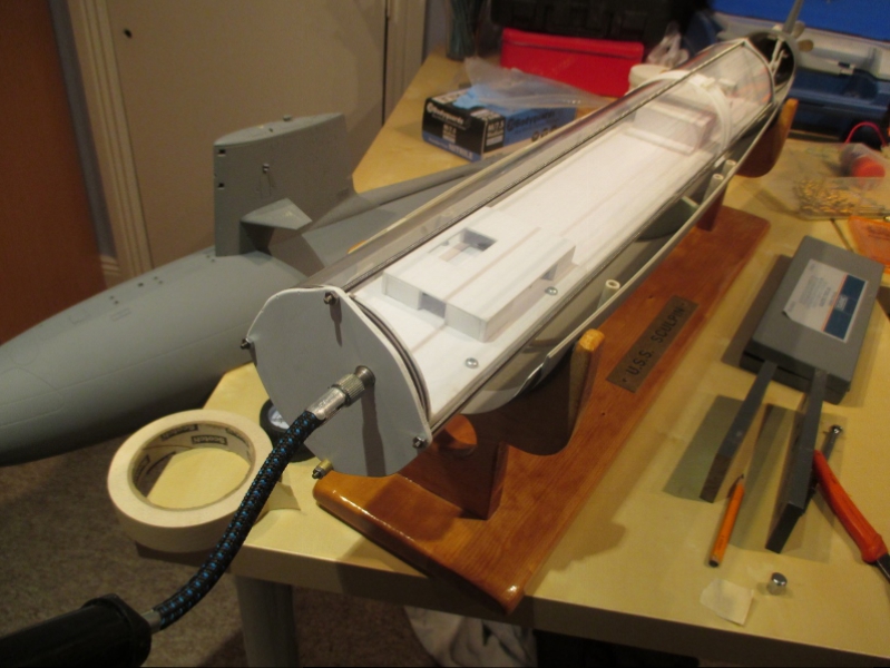

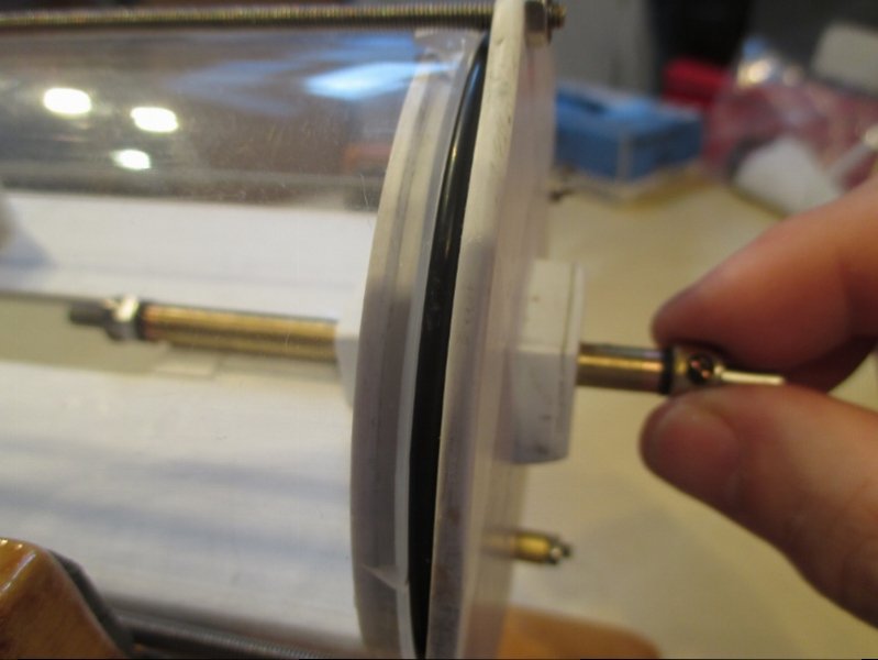

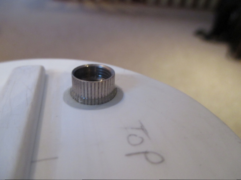

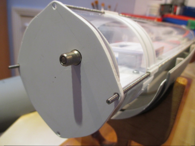

                      A bicycle valve core is epoxied into a 9mm hole.
                      Click image for larger version  Name:	IMG_0819 (800x600).jpg Views:	1 Size:	210.0 KB ID:	119300Click image for larger version  Name:	IMG_0820 (800x600).jpg Views:	1 Size:	240.5 KB ID:	119301
                      I found a nice stainless dust cap with an internal O ring that will be a bit of insurance if the valve fails.
                      Click image for larger version  Name:	IMG_0821 (800x600).jpg Views:	1 Size:	230.0 KB ID:	119302
                      The bicycle pump pushes 78ml of air per stroke, so seven strokes is over the 500ml of the piston tank (I know it's not exact as the air will compress, where the water in the piston tank will not).
                      Click image for larger version  Name:	IMG_0822 (800x600).jpg Views:	1 Size:	285.9 KB ID:	119303
                      Here is the WTC under water with seven pump strokes, the stuffing tube only has a small O ring tight up against the shaft, but still lets the shaft rotate. But this is where it gets a bit weird!
                      Click image for larger version  Name:	IMG_0823 (800x600).jpg Views:	1 Size:	211.0 KB ID:	119304Click image for larger version  Name:	IMG_0824 (800x600).jpg Views:	1 Size:	218.9 KB ID:	119305
                      Tests with inner and outer O rings in place showed some small leaks around the rim. So to remedy this, I decided to start with the outer O rings only and fix these first. However, with just the outer O rings, there are no leaks (except a tiny leak around the outside of the stuffing tube, more epoxy).
                      So it looks like I don't need the inner O rings at all..................... have to do some more tests!!!!!

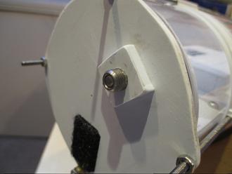

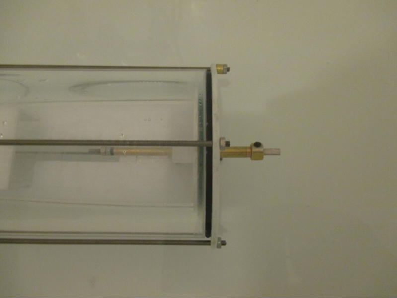

                        Here is the final arrangement, at the shaft end, the stuffing tube is filled with silicone grease and has a greased mini O ring at both ends that are compressed slightly so that the shaft still rotates. It a matter of getting the balance between enough compression of the mini O rings to keep the pressure in the tank and little enough so the shaft turns easily.

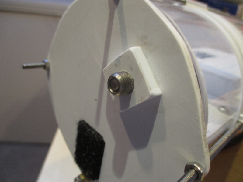

                        The forward end has the valve sealed with a box of styrene filled with two-part epoxy, that solved the tiny leak. The square of velcro acts as a bump pad against the forward caswell fittings in the top hull where the WTC rests.
                        The WTC now holds pressure with 750ml of air through the valve (50% more than the 500ml that the Piston Tank will disperse), so a good margin of safety.
                        Well pleased that it works, even though the inner WTC O rings are not required (note for the next build), on to the servos etc. which I have now ordered.
