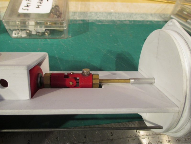

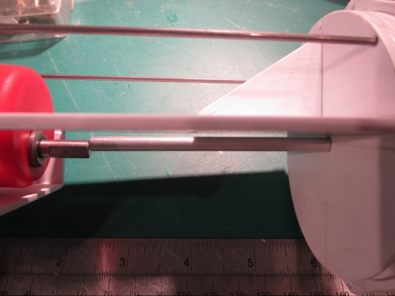

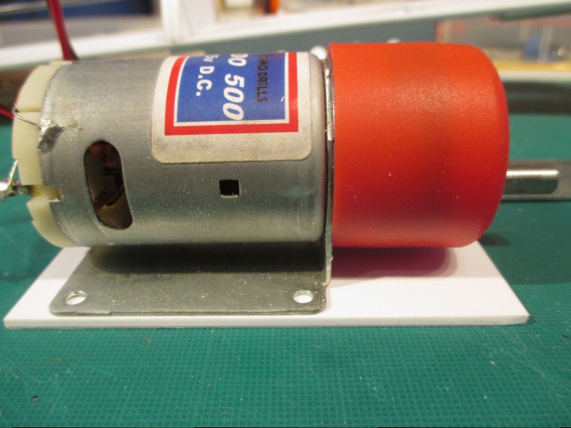

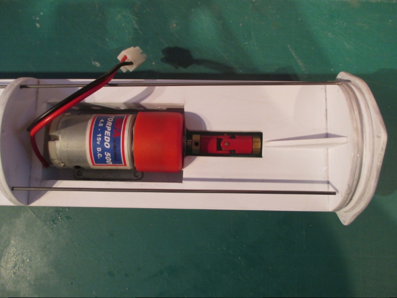

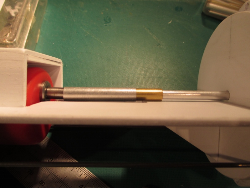

    The motor/gearbox is trial fitted, despite careful measurement it doesn't align with the shaft.
    Click image for larger version  Name:	IMG_0752 (800x600).jpg Views:	1 Size:	265.3 KB ID:	119074Click image for larger version  Name:	IMG_0753 (800x600).jpg Views:	1 Size:	244.9 KB ID:	119075
    A 2mm plate of styrene is just right to get it in line, I've made an alignment tool from short lengths of tube.
    Click image for larger version  Name:	IMG_0755 (800x600).jpg Views:	1 Size:	306.1 KB ID:	119077Click image for larger version  Name:	IMG_0754 (800x600).jpg Views:	1 Size:	228.8 KB ID:	119076

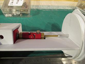

    The motor with universal coupler is now perfectly in line with the stuffing tube, and a dummy shaft is trial fitted.
    Click image for larger version  Name:	IMG_0756 (800x600).jpg Views:	1 Size:	264.9 KB ID:	119078

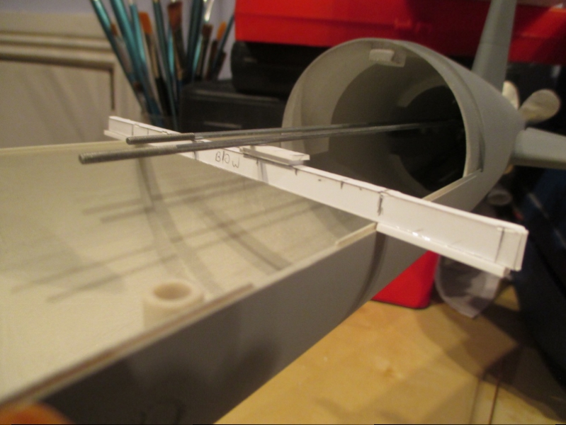

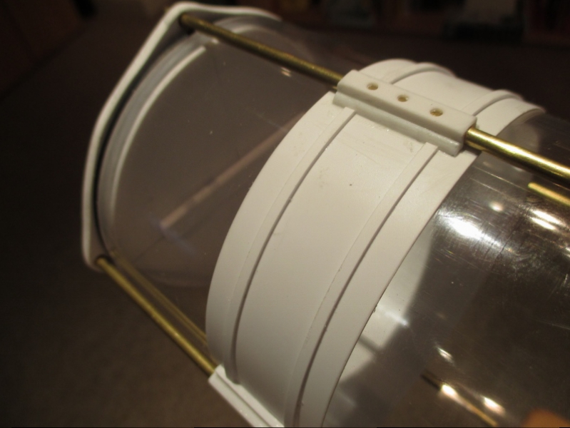

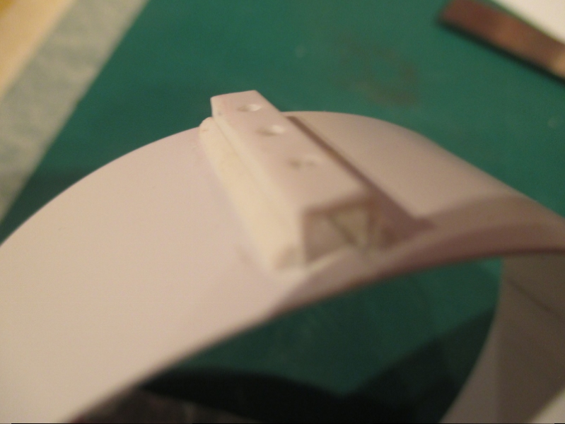

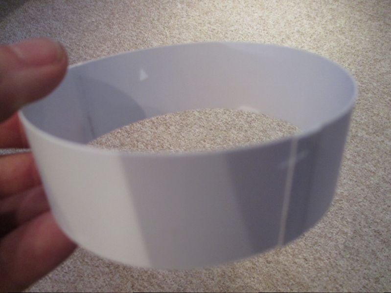

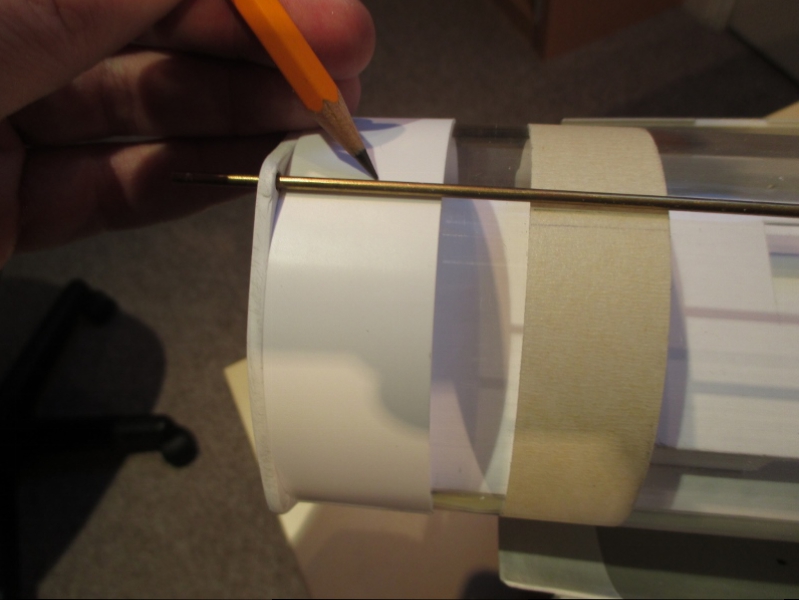

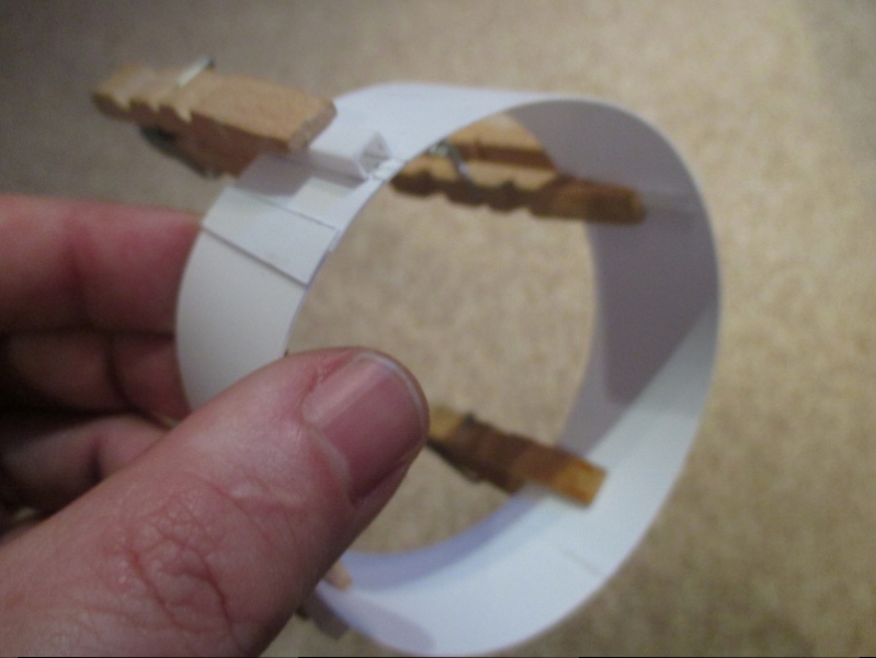

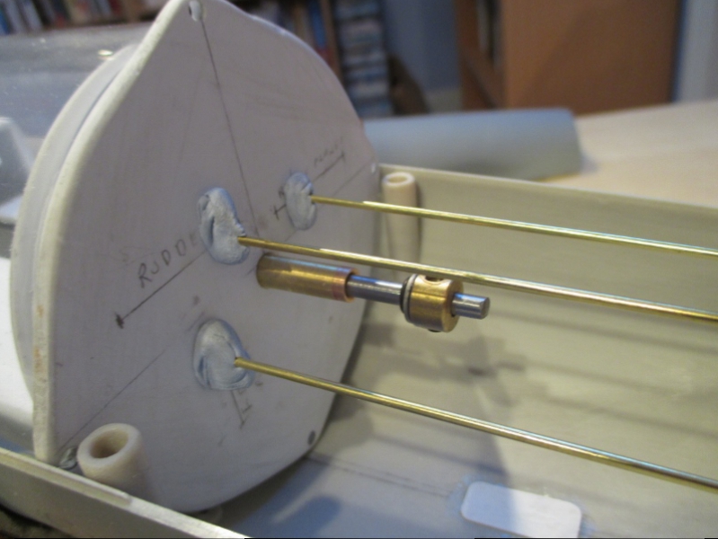

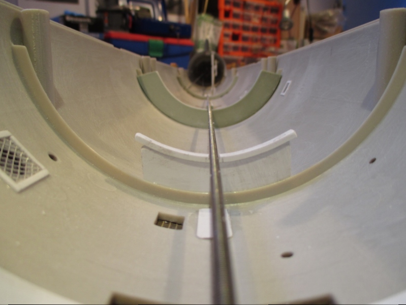

          A collar of 0.5mm styrene, 3cm wide to the outer diameter of the tube is made. The position of the outer compression rods are marked, the collar has to be so thin so it will go under the retaining rods.
          Click image for larger version  Name:	IMG_0758 (800x600).jpg Views:	1 Size:	282.8 KB ID:	119090Click image for larger version  Name:	IMG_0757 (800x600).jpg Views:	1 Size:	202.3 KB ID:	119089
          U-section strips are glued at the four points, the collar is then trial fitted to ensure all is in line.
          Click image for larger version  Name:	IMG_0759 (800x600).jpg Views:	1 Size:	229.9 KB ID:	119091Click image for larger version  Name:	IMG_0760 (800x600).jpg Views:	1 Size:	201.8 KB ID:	119092

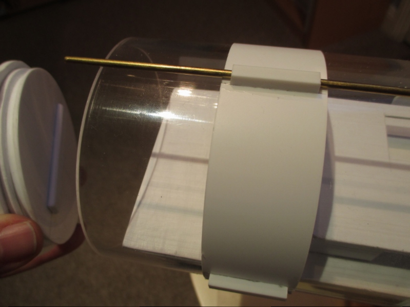

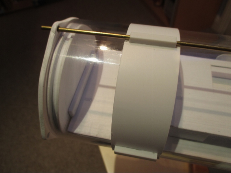

          The collar will retain the rods in position when the forward end cap is removed for charging, the retaining pieces are drilled to stop air/water getting trapped and reinforced with quarter round rod strips.
          Click image for larger version  Name:	IMG_0761 (800x600).jpg Views:	1 Size:	203.9 KB ID:	119093Click image for larger version  Name:	IMG_0763 (800x600).jpg Views:	1 Size:	213.5 KB ID:	119095
          The collar free floats along the tube and can be positioned away from resting points and fixtures, it's tight enough not to move once the rods are inserted.
          Click image for larger version  Name:	IMG_0764 (800x600).jpg Views:	1 Size:	246.3 KB ID:	119096

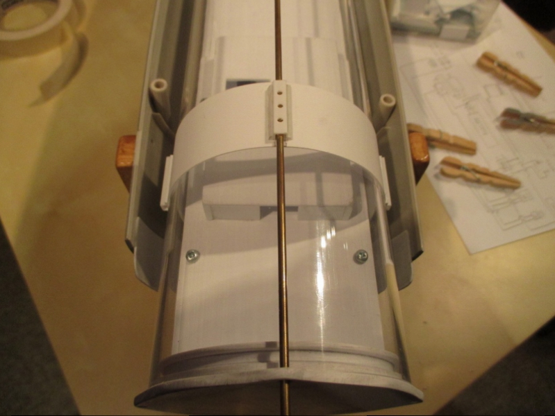

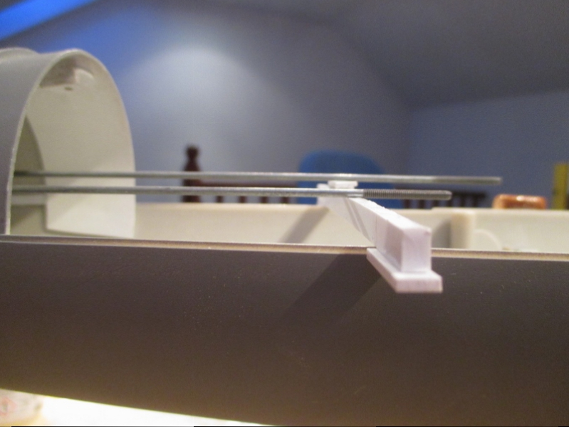

            The completed retaining collar with some 3mm X 1mm strips of styrene for strength, 3mm brass rods simulate the threaded rod (lost in the post!).
            Click image for larger version  Name:	IMG_0765 (800x600).jpg Views:	1 Size:	214.5 KB ID:	119098

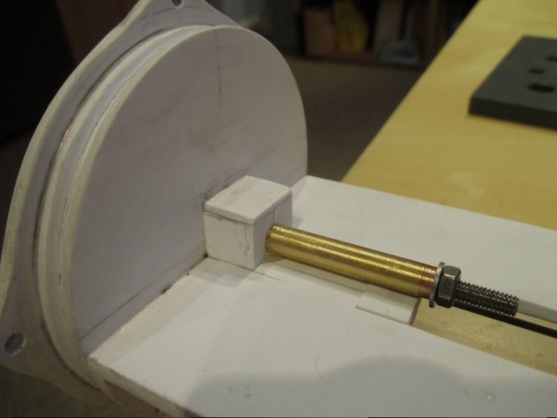

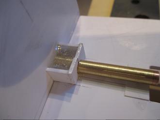

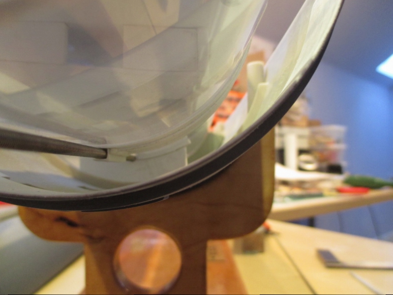

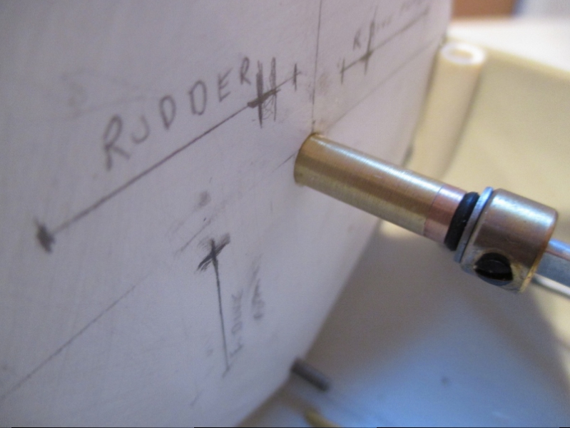

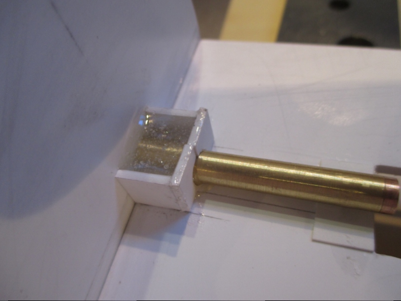

                      A stuffing tube (3 inch, the shortest I could find) is pushed into the shaft hole, a surround of styrene is filled with epoxy to seal the joint. Not my neatest work, I'll be filling and sanding this later.
                      Click image for larger version  Name:	IMG_0768 (800x600).jpg Views:	1 Size:	208.4 KB ID:	119132Click image for larger version  Name:	IMG_0771 (800x600).jpg Views:	1 Size:	228.0 KB ID:	119128

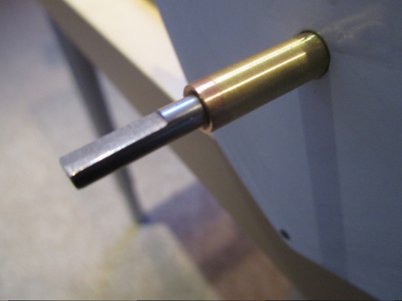

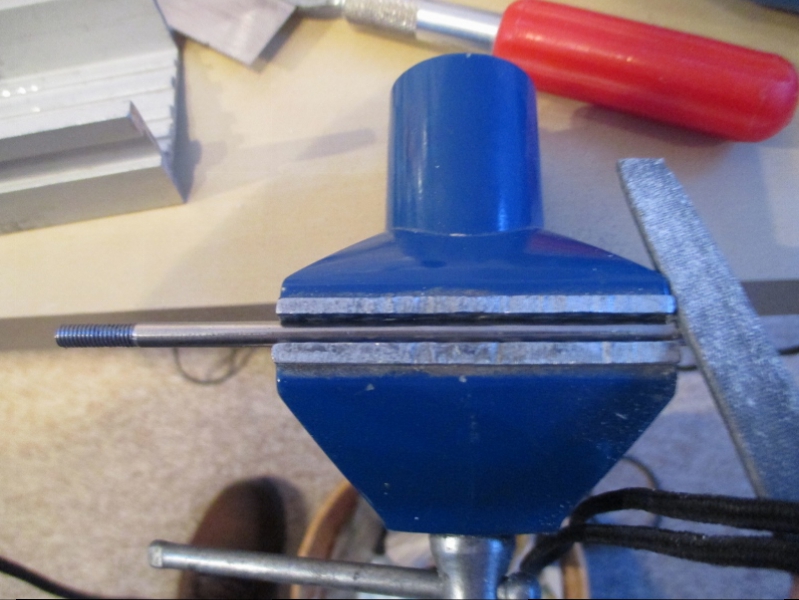

                      The inner shaft is cut down and a flat filed into it to take the outer coupler.

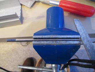

                      Click image for larger version  Name:	IMG_0769 (800x600).jpg Views:	1 Size:	270.8 KB ID:	119126Click image for larger version  Name:	IMG_0770 (800x600).jpg Views:	1 Size:	228.7 KB ID:	119127

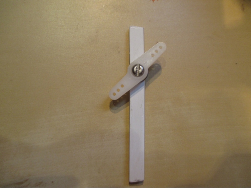

                      A plastic gauge is made from scrap styrene to set the linkages from the rudders and rear dive planes as they are on slightly different levels, in preparation for installation of the servos and linkage holes.
                      Click image for larger version  Name:	IMG_0774 (800x600).jpg Views:	1 Size:	246.3 KB ID:	119131Click image for larger version  Name:	IMG_0773 (800x600).jpg Views:	2 Size:	231.8 KB ID:	119133

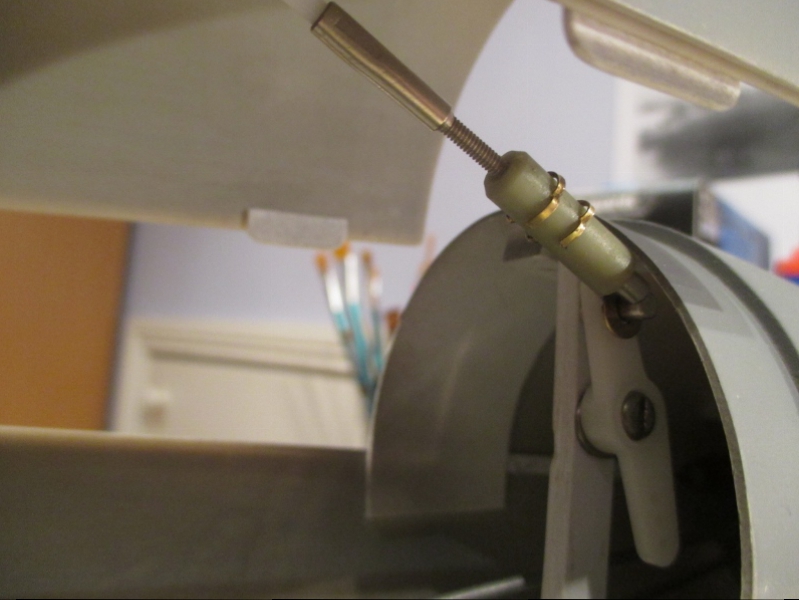

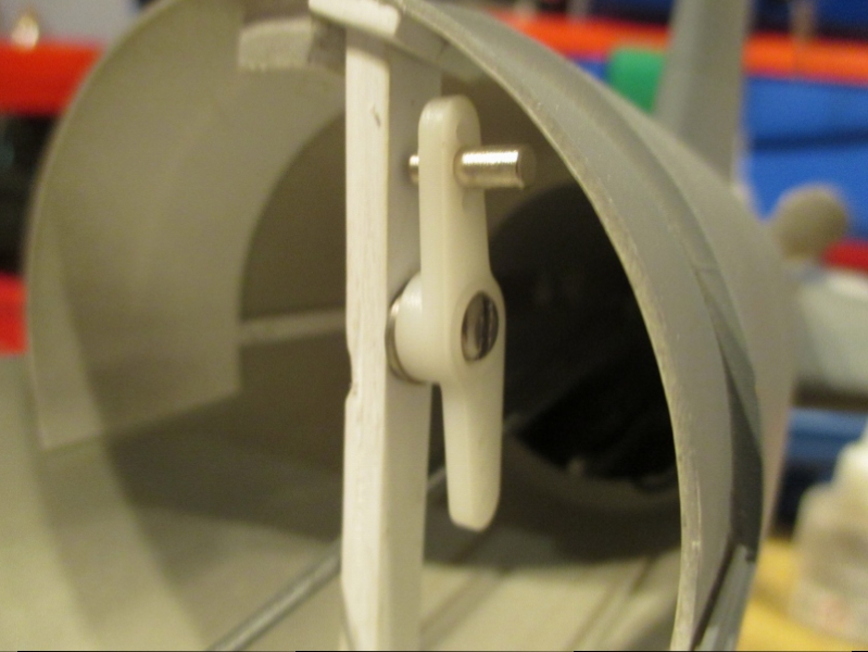

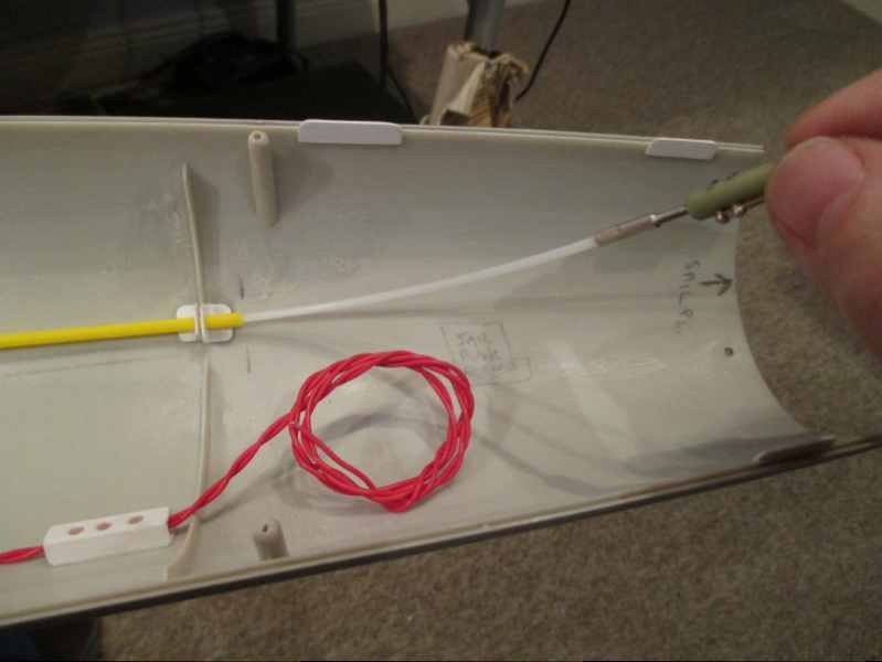

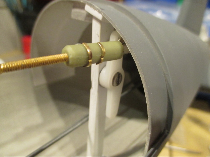

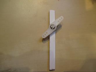

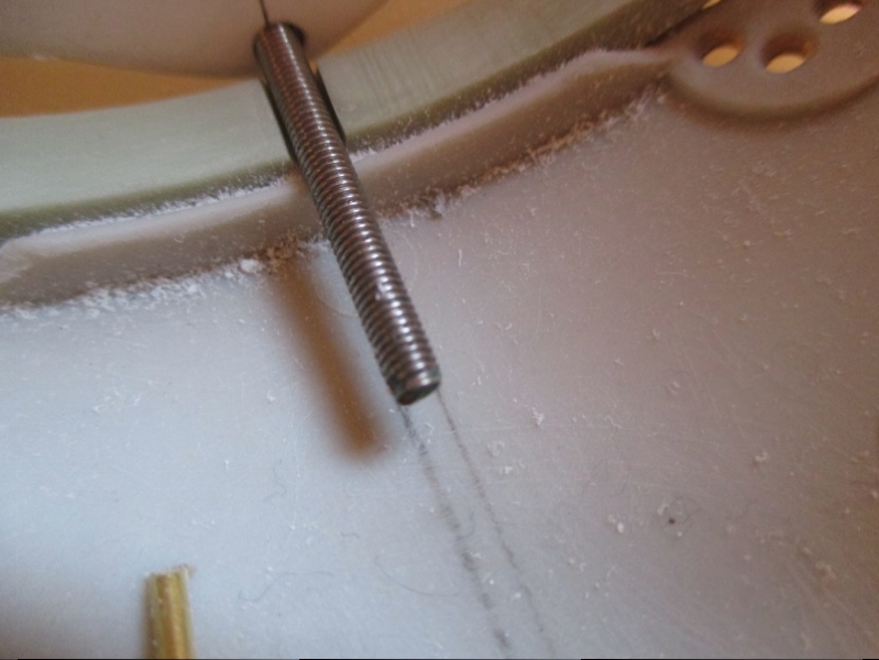

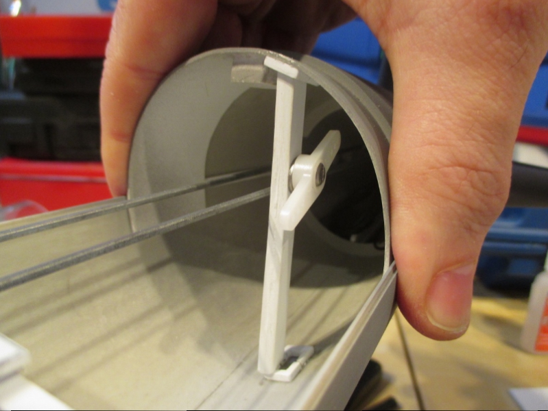

                        This fitting can now be sorted, it will carry the throw of the dive plane servo, reversing it's direction out of the WTC. It's held in place by these styrene fittings, one at the bottom of the hull another at the top.
                        Click image for larger version  Name:	IMG_0775 (800x600).jpg Views:	1 Size:	234.8 KB ID:	119154Click image for larger version  Name:	IMG_0777 (800x600).jpg Views:	1 Size:	218.5 KB ID:	119155
                        The fitting is installed and removed, by pressing the hull inwards and as it's not glued in, it drops out.
                        Click image for larger version  Name:	IMG_0779 (800x600).jpg Views:	1 Size:	259.9 KB ID:	119148

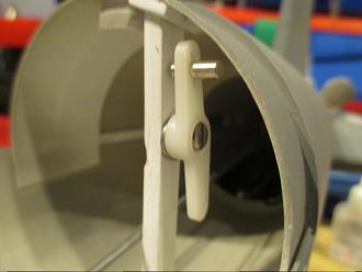

                        The Klik On magnet is installed on the servo arm, the other magnet is on the end of the snake rod going to the front dive planes.
                        Click image for larger version  Name:	IMG_0781 (800x600).jpg Views:	1 Size:	237.1 KB ID:	119149Click image for larger version  Name:	IMG_0782 (800x600).jpg Views:	1 Size:	245.0 KB ID:	119150
                        The plastic snake will bend downwards when the hull is opened up, and you just pull the magnet off (a safety ring ensures it stays on during operation).
                        Click image for larger version  Name:	IMG_0786 (800x600).jpg Views:	1 Size:	256.7 KB ID:	119153
                        This is the top hull in place , opened up at the breakpoint, the lower arm of the servo rod will go to the rod coming out of the WTC from the forward dive plane servo.
                        Click image for larger version  Name:	IMG_0783 (800x600).jpg Views:	2 Size:	233.5 KB ID:	119157

                          #162
                          What seals are in the stuffing box tube ? The piston tank is going to pressurise the etc when you dive, if that just a close clearance tube, I suspect it's going to leak badly as the tank fills.
                          • The Boattrainman
                            • Mar 2016
                            • 443
                            #163
                            Hi Albion,
                            It's a prop tube from Model Bits, I suspect you might be right, I'll stuff it with silicone grease and there will be a mini O ring compressed against a thrust washer, that's why I've cut the shaft to exact length. The photo is just for demo purposes, the O ring will be on the inside.
                            Worked for the 750ml piston tank on my Robbe U203, I just replaced the O ring every 3/4 sessions, the few bubbles coming out of the shafts told me the O ring was toast.

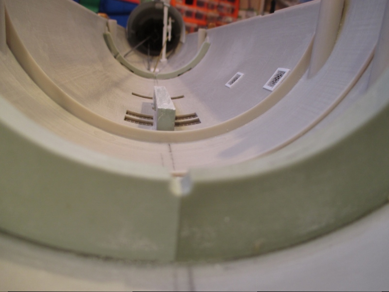

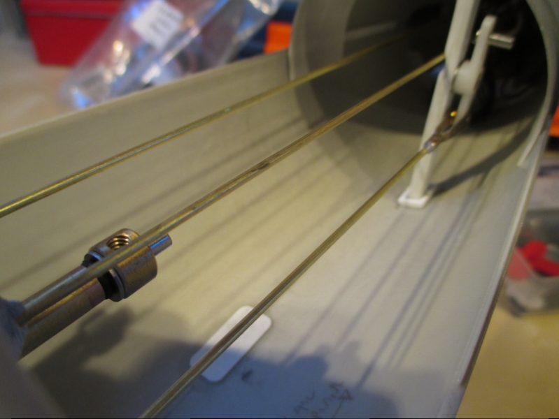

                              A 3mm slot is filed in the centre of the rest points to hold the lower outer rod on the WTC.
Name:	IMG_0789 (800x600).jpg
ID:	119167Click image for larger version
Name:	IMG_0790 (800x600).jpg
                              The lower rod sits in this groove and doubles as end cap holder and keeps the WTC in place.
Name:	IMG_0792 (800x600).jpg
ID:	119169Click image for larger version
Name:	IMG_0793 (800x600).jpg

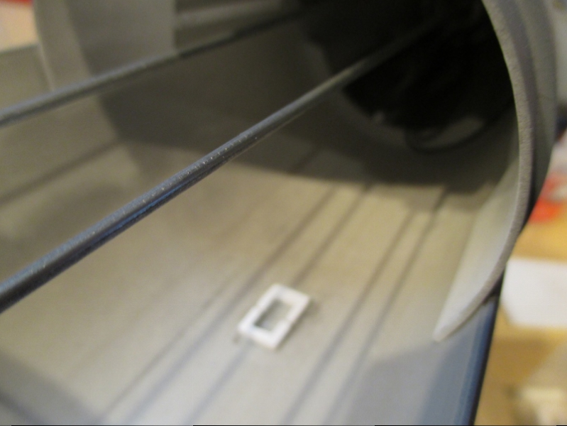

                              The steel pushrods are all replaced with brass rods and brass clevises and checked again for straight alignment.
Name:	IMG_0794 (800x600).jpg
ID:	119171Click image for larger version
Name:	IMG_0795 (800x600).jpg

                                #165
                                One question about the shaft and its sealing Are you sure the method you're using is really watertight? Because I once asked ENGEL about using that kind of drive shafts with sleeves, and the answer waas that they weren't watertight
