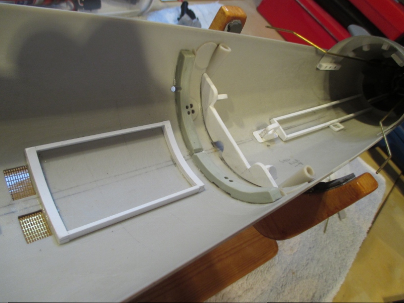

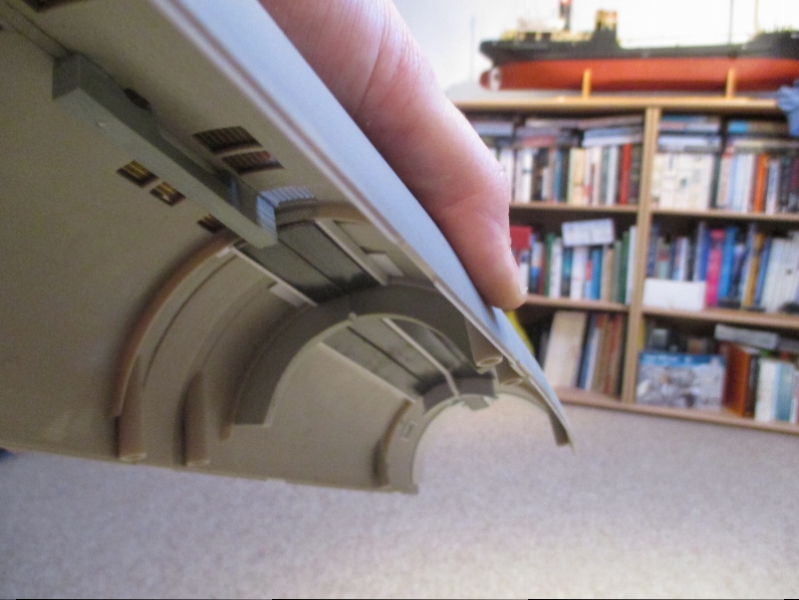

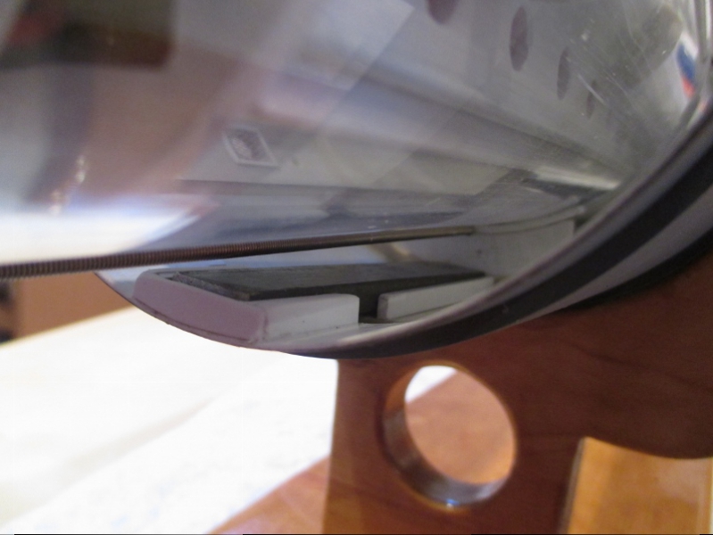

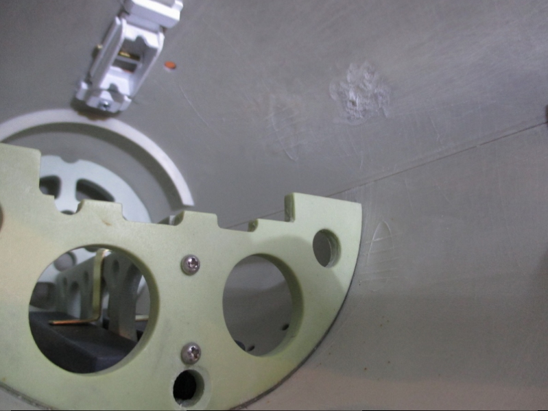

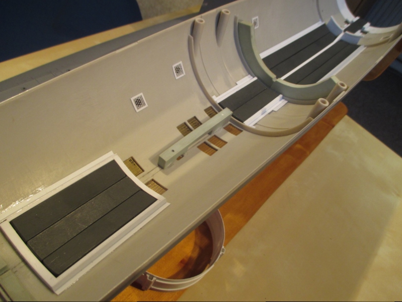

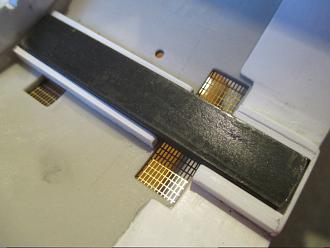

            Styrene surrounds for the ballast bars are constructed using 2 x 4mm square profile.
            Click image for larger version  Name:	IMG_0961 (800x600).jpg Views:	1 Size:	254.7 KB ID:	120989Click image for larger version  Name:	IMG_0962 (800x600).jpg Views:	1 Size:	255.8 KB ID:	120990
            Click image for larger version  Name:	IMG_0963 (800x600).jpg Views:	1 Size:	311.3 KB ID:	120991Click image for larger version  Name:	IMG_0964 (800x600).jpg Views:	1 Size:	281.0 KB ID:	120992
            The bars are held in place by the surrounds and given the unique shape of the hull, they don't even fall out upside down. No Glue! Also their proximity to the WTC means they can't come out as their's no room.
            Click image for larger version  Name:	IMG_0965 (800x600).jpg Views:	1 Size:	268.0 KB ID:	120993Click image for larger version  Name:	IMG_0966 (800x600).jpg Views:	1 Size:	223.9 KB ID:	120994

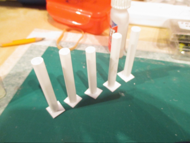

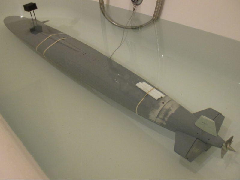

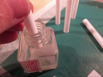

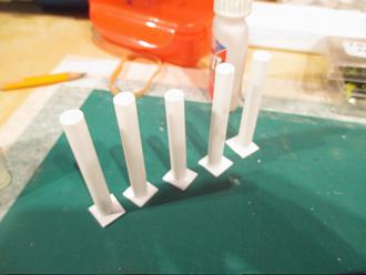

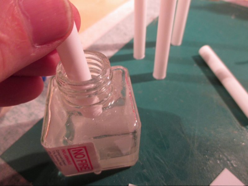

            Now I have one pet hate (two actually....decals, more on these later). I detest with a passion closed cell foam used as a buoyancy aid for submerged trim. Having used the stuff in my U-203 years ago, the constant trial and error, the fact it looks awful etc etc....I'd rather use rare earth magnets stuck to a ferrets ass!!!!
            So I'm trying a few different approaches and to start I'm making small hollow buoyancy tubes. To make the tubes watertight, they are dipped in styrene cement.
            Click image for larger version  Name:	IMG_0969 (800x600).jpg Views:	1 Size:	252.1 KB ID:	120996
            The tubes are placed onto small squares of styrene which will be cut back and sanded flat at both ends. The trick is to turn the tube down hard onto the flat plastic to ensure it melts.
            Click image for larger version  Name:	IMG_0967 (800x600).jpg Views:	1 Size:	246.7 KB ID:	120995
            Here are just three tubes holding the sub on the level at periscope depth.
Name:	IMG_0970 (800x600).jpg
            I'll need more and have to get them above the waterline inside the hull.

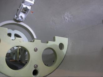

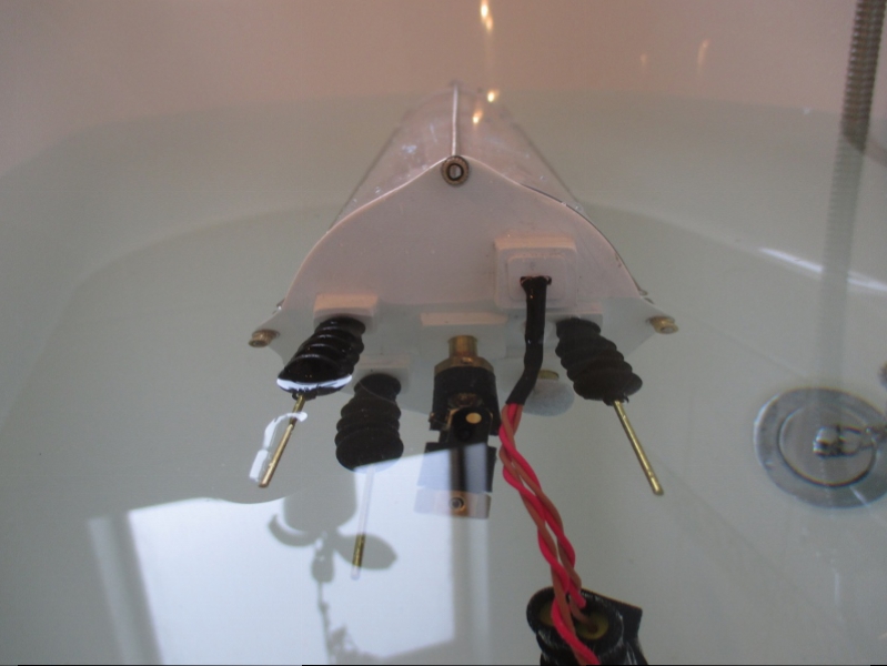

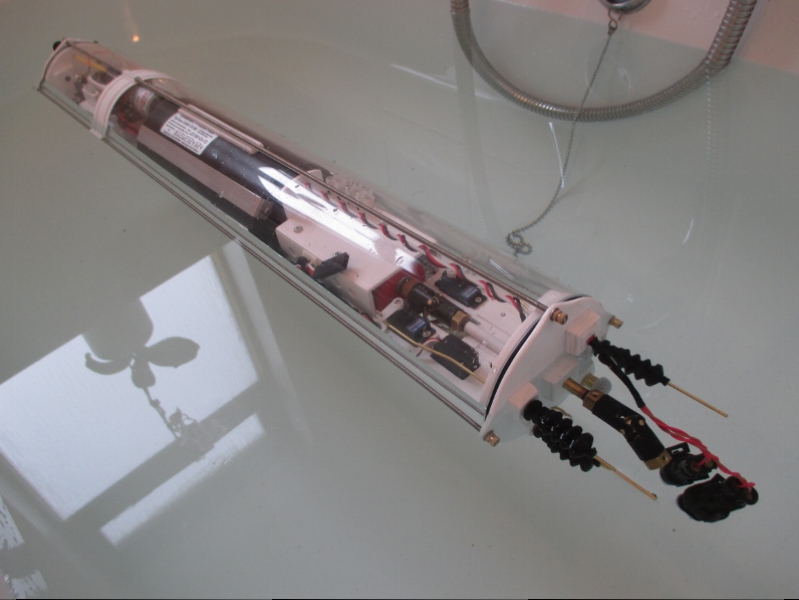

                Here is the WTC separated from the hull, the piston tank is full in this shot. By keeping the motor and battery below the half way line it stays upright.
Name:	IMG_0972 (800x600).jpg
                The WTC is perfectly level side to side with no additional ballast required, this is what made balancing the total sub much easier.
Name:	IMG_0971 (800x600).jpg
                The WTC is just a fraction off level fore to aft, a bit heavy at the forward end, this was the compromise needed to get everything inside in a good position.

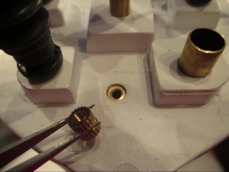

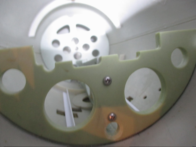

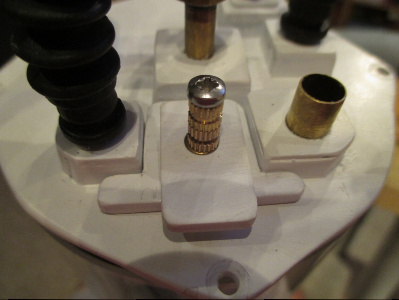

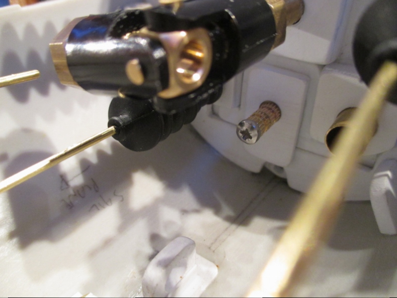

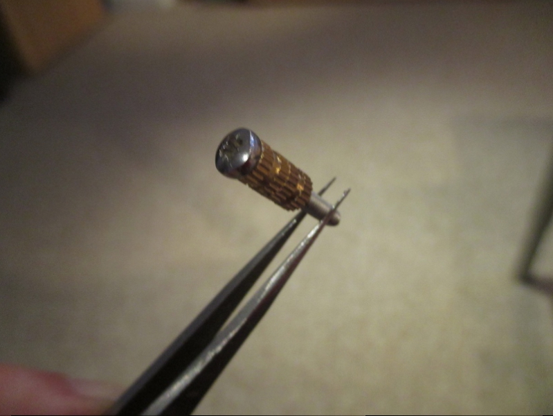

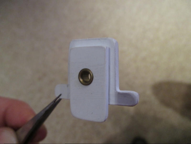

                  The immersion tests show the WTC is moving by about 1 - 2mm in the hull despite the keeper plate to the rear and the front coming up against the Caswell torpedo fittings.
                  So to set the WTC solid against the rear keeper plate, a 3mm knurled nut is set into the rear end cap and a long screw made of 2 knurled nuts and a 50mm bolt.
                  Click image for larger version  Name:	IMG_0973 (800x600).jpg Views:	1 Size:	244.5 KB ID:	121050Click image for larger version  Name:	IMG_0976 (800x600).jpg Views:	1 Size:	223.9 KB ID:	121052
                  This odd shaped fitting is made to grab the rear keeper plate.
                  Click image for larger version  Name:	IMG_0974 (800x600).jpg Views:	1 Size:	219.1 KB ID:	121051
                  The fitting has a lip which sits over the rear keeper plate, a bit fiddly but the 1-2mm shift moves the pushrods and affects the trim.
                  Click image for larger version  Name:	IMG_0977 (800x600).jpg Views:	1 Size:	240.2 KB ID:	121053Click image for larger version  Name:	IMG_0978 (800x600).jpg Views:	1 Size:	252.5 KB ID:	121054
                  I should have extended the keeper plate upwards when making it, but I didn't foresee this issue at the time, so a nod to Rube G!

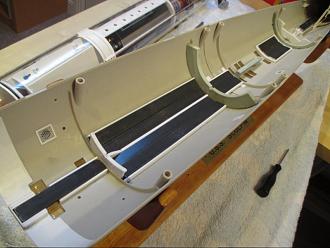

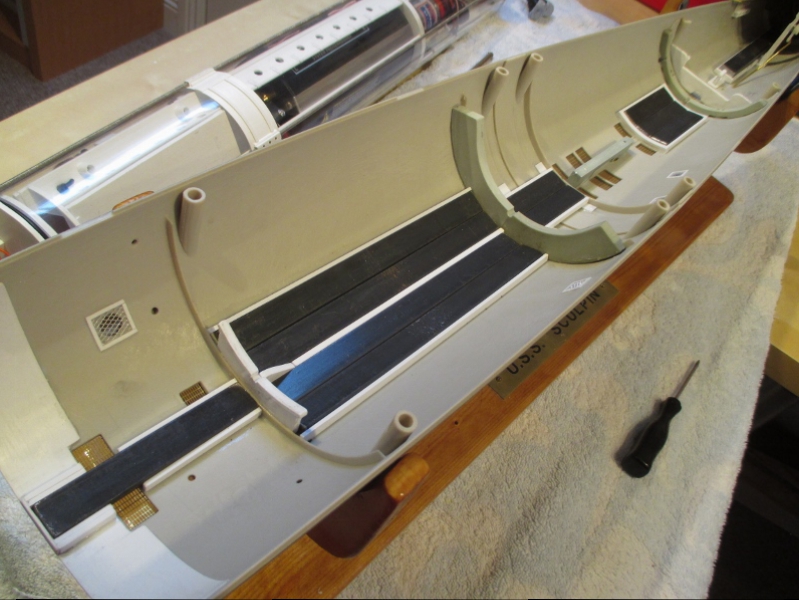

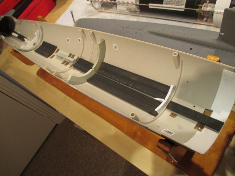

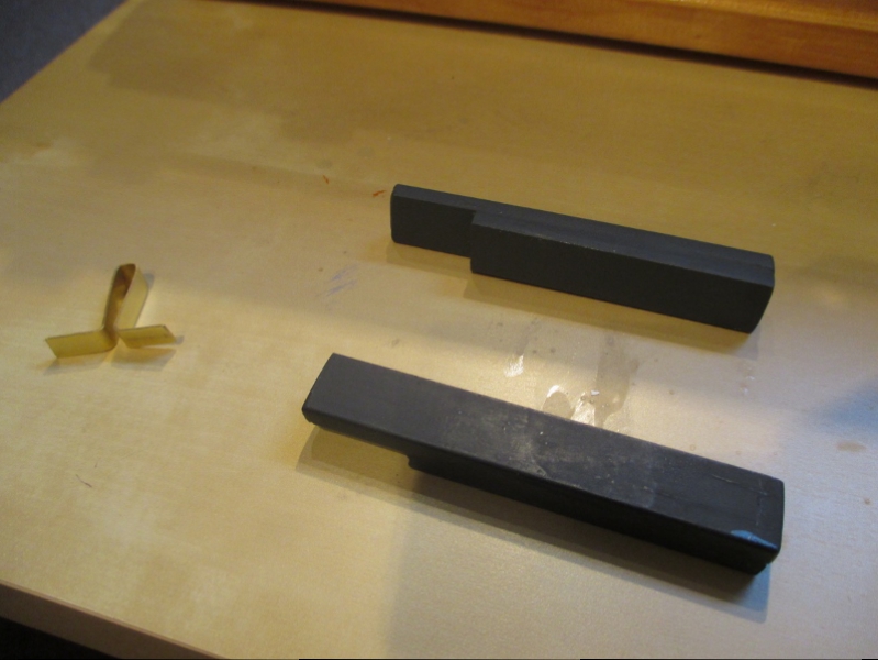

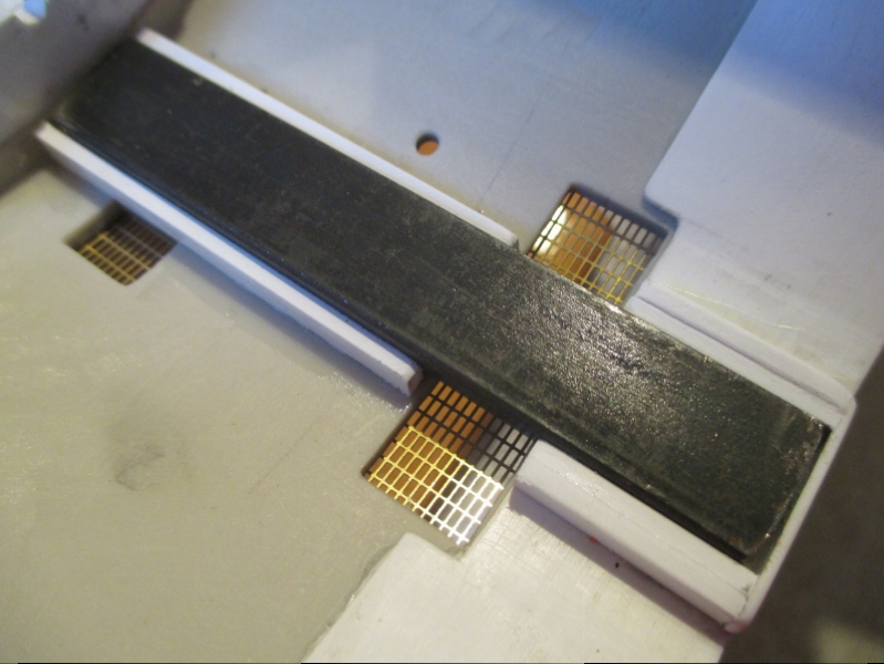

                    The ballast bars get a coat of primer and a good coat of enamel rust proofing before re-instatement. I don't want a load of rusting metal lying in the bottom of the boat
                    Click image for larger version  Name:	IMG_0983 (800x600).jpg Views:	1 Size:	263.6 KB ID:	121067
                    The forward ballast bars presented a different problem tucked into the nose, I don't want to glue them in, I dislike a lot of fixed ballast especially in hard to reach areas, what happens if I want to re-trim the model should there be, for example,a different battery used or other changes.
                    Again surrounds are made from L-shaped styrene to hold the bars from moving sideways.
                    Click image for larger version  Name:	IMG_0979 (800x600).jpg Views:	1 Size:	209.3 KB ID:	121064
                    The bars are doubled up and stuck together with a protruding piece to fit the space. A clip is made from a small piece of flat brass bar.
                    Click image for larger version  Name:	IMG_0980 (800x600).jpg Views:	1 Size:	251.7 KB ID:	121065
                    The clip is a tight fit and slides over the centre bar of the Caswell fittings, and presses the bars downward, they are now locked in place.
                    Click image for larger version  Name:	IMG_0982 (800x600).jpg Views:	1 Size:	225.0 KB ID:	121066
                    Easy to remove if there are any changes.

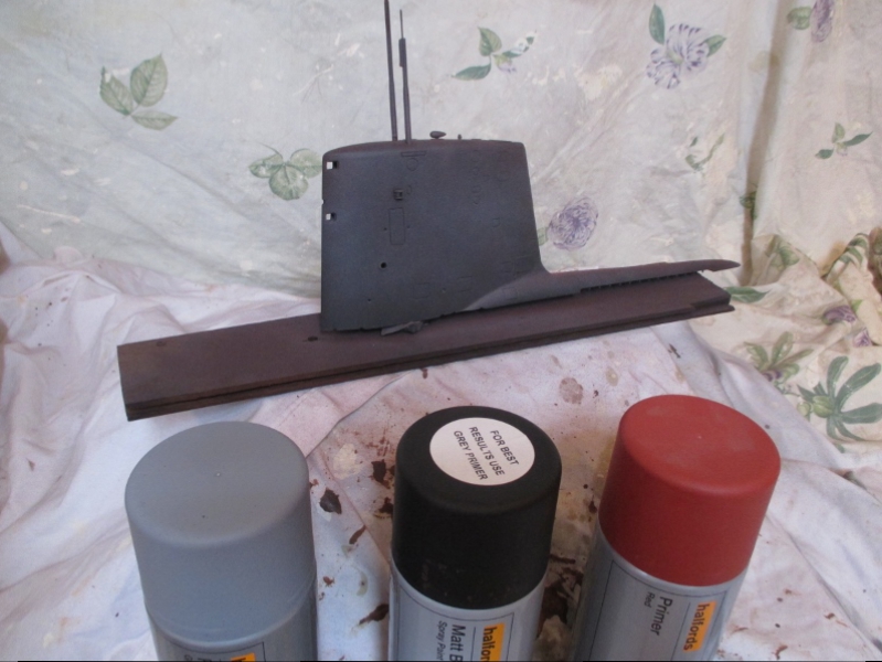

                      To get the painting started, I'm starting with the sail.
                      It begins with a bit of colour matching, Humbrol 67 (which will be used for tips and scratches) is matched to a couple of basic grey car spray rattle cans. One can is a fraction lighter and the other a fraction darker then the Humbrol enamel.
                      Click image for larger version  Name:	IMG_0990 (800x600).jpg Views:	1 Size:	313.3 KB ID:	121134
                      There are loads of ways to apply the basic hull colour, here is my method. Before the final grey's are applied three basic colours Grey Primer, Red Primer and Black are used.
                      The whole sail gets a coat of the Grey Primer, then all over Black, then a light dusting of the Red Primer, this simulates the aging process of the paint.
                      Click image for larger version  Name:	IMG_0986 (800x600).jpg Views:	1 Size:	268.3 KB ID:	121135
                      I then give the sail a coat of the two grey matched cans, spraying lightly with one shade and then the other, never using too much of either, and trying to vary the areas that I hit with more of the lighter shade at the top of the sail. I never direct the spray at the sail, just trying to 'float' the mist onto the model.
                      You get these variations of shading and It also has that slight undertone of red primer, it's fast and cheap, with about 15 minutes between coats, not bad for a few hours and a couple of cheap cans of paint. A final coat of Matt Varnish applied to seal it all in will be allowed to dry overnight.
                      A bit of light weathering will come later.

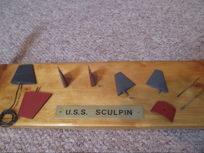

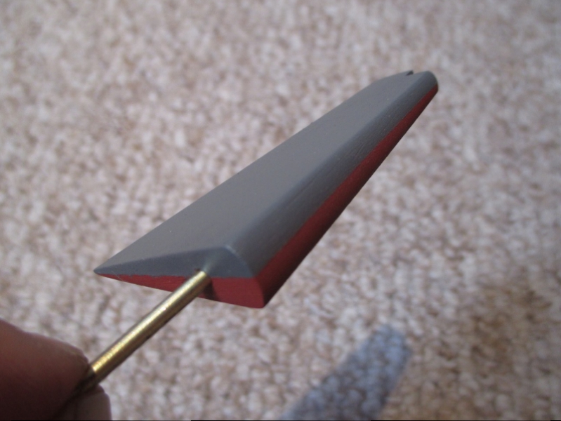

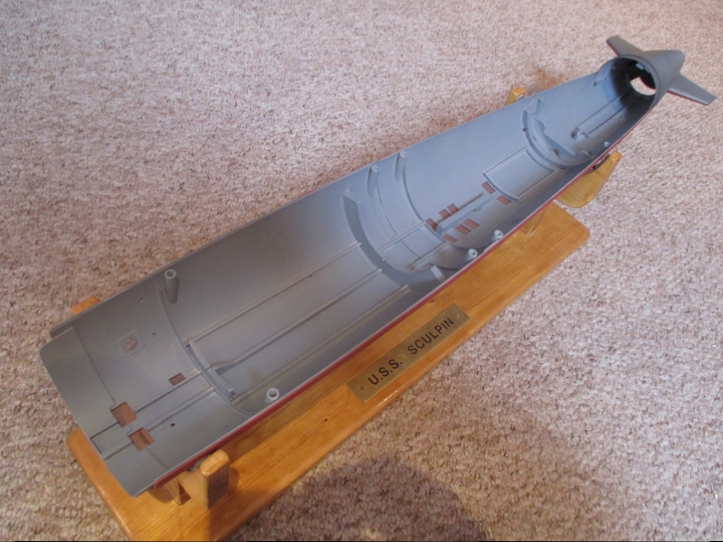

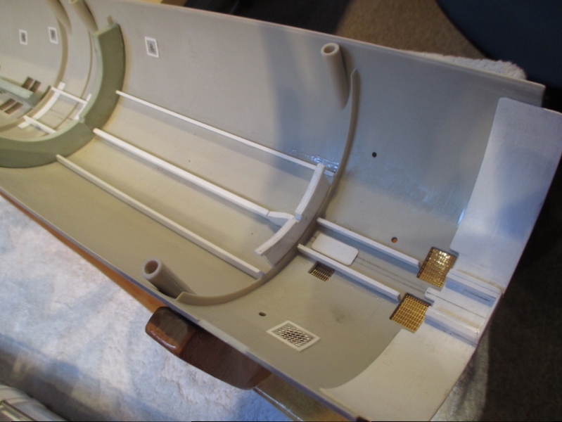

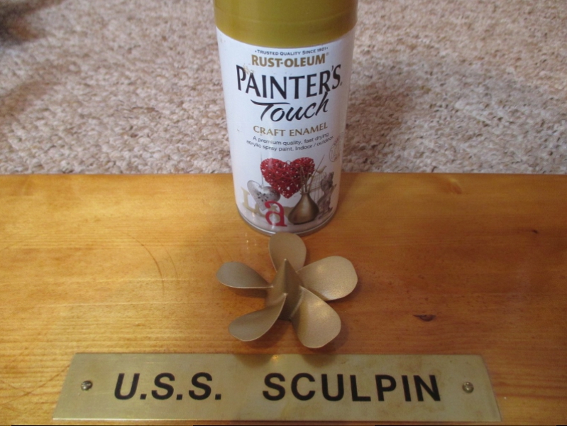

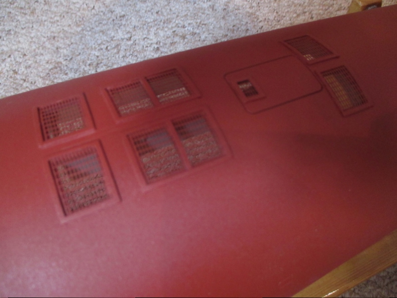

                            The finished lower hull, I gave the inside a spray of primer, and the whole thing got a final spray of clear matt Rustoleum varnish.
                            Click image for larger version  Name:	IMG_0992 (800x600).jpg Views:	1 Size:	368.3 KB ID:	121140Click image for larger version  Name:	IMG_0991 (800x600).jpg Views:	1 Size:	385.0 KB ID:	121145
                            The dive planes and rudders got the same treatment, the rear dive planes were a pig to mask and paint.
                            Click image for larger version  Name:	IMG_0995 (800x600).jpg Views:	1 Size:	344.2 KB ID:	121143Click image for larger version  Name:	IMG_0997 (800x600).jpg Views:	1 Size:	242.4 KB ID:	121144
                            To my great surprise, the prop turned out well, I boiled it in white vinegar (etch priming?), and a cheap can of gold metallic paint was used after the primer coat. It's beside the brass nameplate for comparison.
                            Click image for larger version  Name:	IMG_0994 (800x600).jpg Views:	1 Size:	309.5 KB ID:	121142
                            The gratings look good,but will need work for definition, I prob should have put the wire mesh on the the inside of the model, you learn as you go!!
                            Click image for larger version  Name:	IMG_0993 (800x600).jpg Views:	1 Size:	253.9 KB ID:	121141

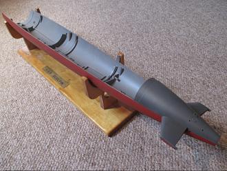

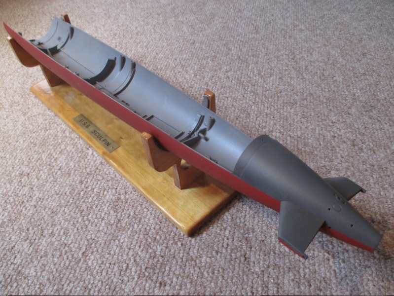

                                #240
                                Roger that Greevesman, I'll put up a full suite of photos on completion.

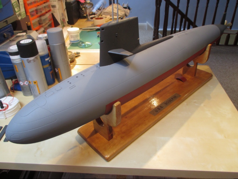

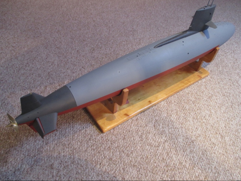

                                Here is as far as I've got, I can't paint the upper hull as I'm still trimming the model and adding flotation inside which will be painted over.
                                Click image for larger version  Name:	image_34809.jpg Views:	1 Size:	355.8 KB ID:	121148
                                I'm taking my time on the painting as with only two basic hull colours this needs careful thought or it'll look like a grey featureless tube, and with applying multiple coats to try get some variation plus drying time and then going back over blemishes it's a time consuming process.
                                Click image for larger version  Name:	image_34810.jpg Views:	1 Size:	290.2 KB ID:	121149
