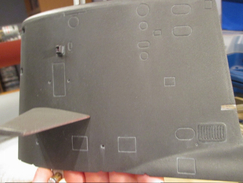

      There's not much to work with in terms of some light weathering, a bit of salt staining is applied by using a very dilute grey/white enamel.
      Click image for larger version  Name:	IMG_1003 (800x600).jpg Views:	1 Size:	247.7 KB ID:	121164Click image for larger version  Name:	IMG_1004 (800x600).jpg Views:	1 Size:	240.4 KB ID:	121165
      The dilute mix is run into the recess lines on a small paintbrush and let dribble downwards, then before it dries it is wiped downwards with a rag damped with clean white spirit. It needs to be really dilute so that it runs around the recesses, if it doesn't run it's too thick. Too much application and it can simply be wiped off (always downward) with the rag.

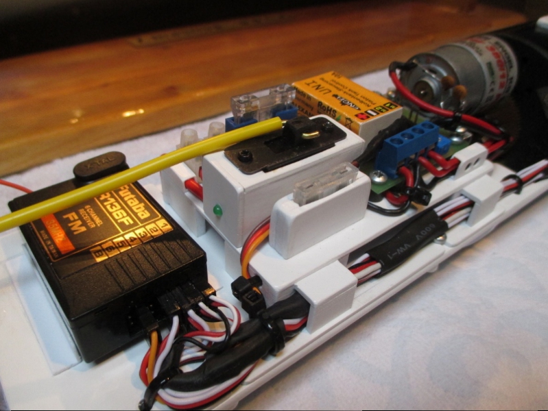

                  Here is the RX placement.
Name:	IMG_1015 (800x600).jpg
                  It's well away from any 12V circuit, plus even when the 12V is dead, I still have the twitching. No ferrite ring installed either.

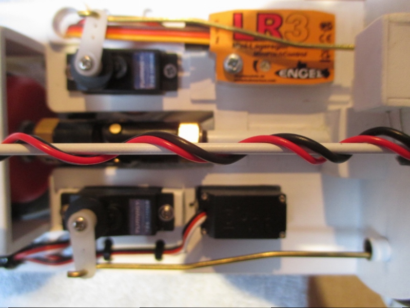

                  Here is the servo and LR3 location.
Name:	IMG_1016 (800x600).jpg

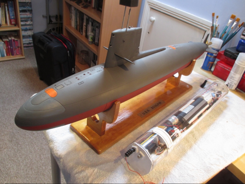

                  The painting progresses, here is the full hull painted, still lots of work still to do to blend it all in, rattle cans for the main colours and I hand painted the sonar domes and emergency buoys.
Name:	IMG_1013 (800x600).jpg

                    • 13641
                    #249
                    Too gray.
                    • The Boattrainman
                      • Mar 2016
                      • 443
                      #250
                      I think you might be right.
                      I agonised over this, the other dark dark grey I had was almost black, and it looked like a silloutte...................!
                      I'm washing it in a mixture dilute black/grey to get the colour a bit darker and also to blend the red anti foul.
                      Not going for a repaint at this stage.
