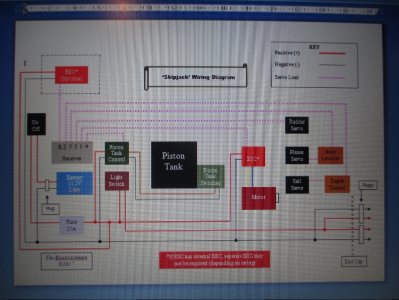

          Final version of schematics as per David's suggestion.

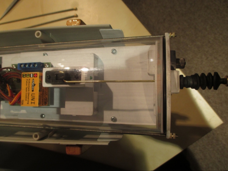

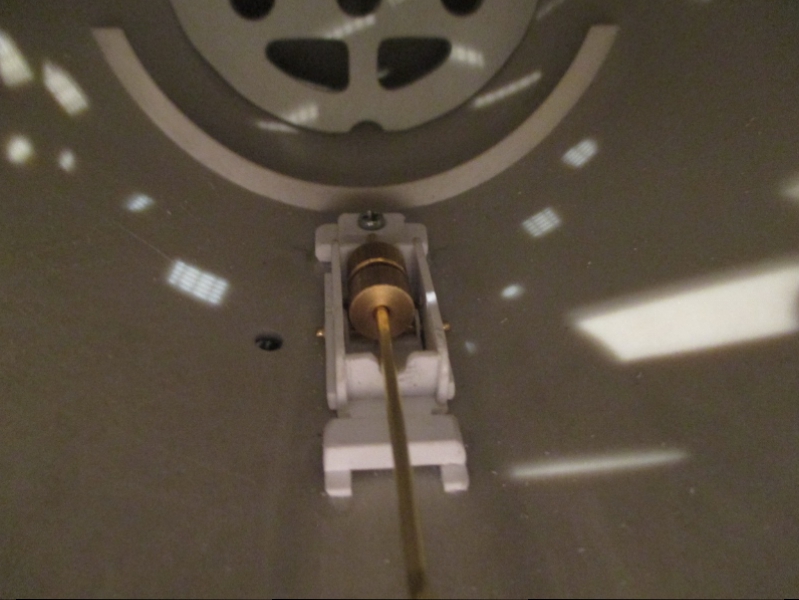

            #200

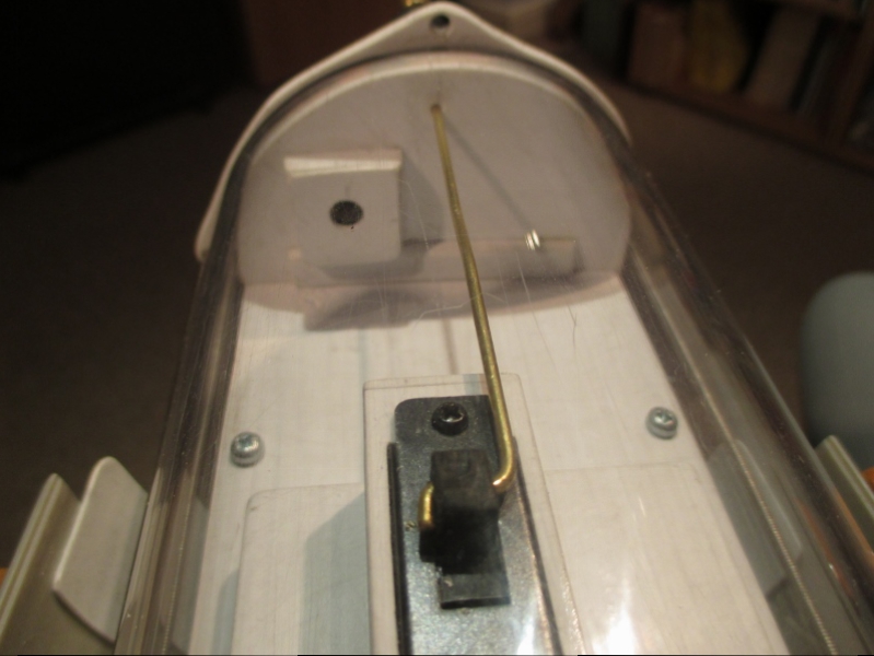

            Last picture of the On/Off switch linkage inside the hull (upside down) under the opening hatch.
Name:	IMG_0857 (800x600).jpg

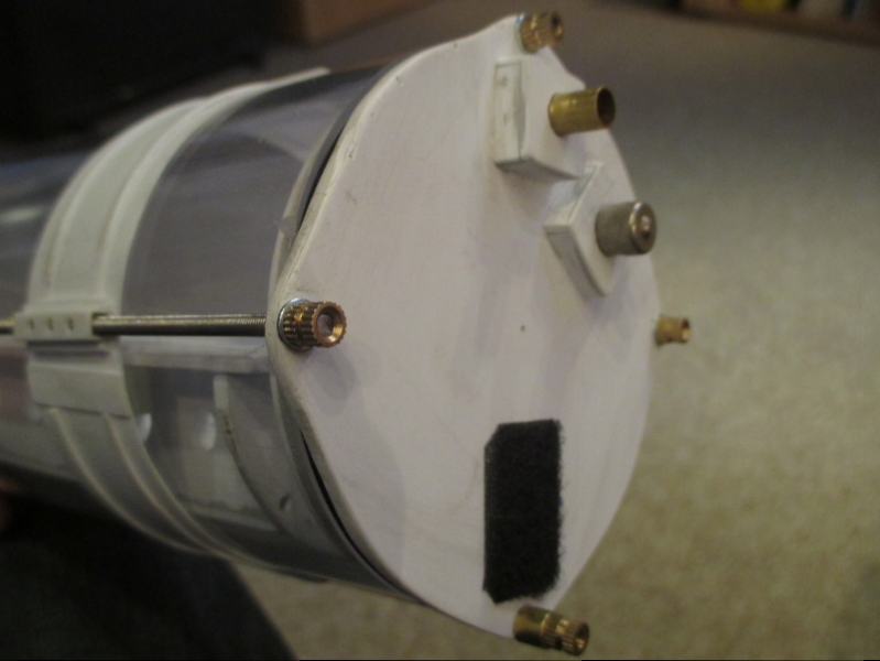

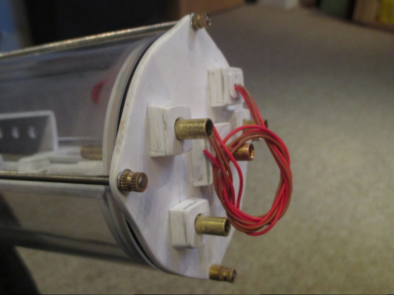

              I replaced the nuts with these 3mm knurled ones on the rods.
              Click image for larger version  Name:	IMG_0859 (800x600).jpg Views:	1 Size:	238.1 KB ID:	120049
              The ones at the servo and motor end are glued to the rods (making them 3mm long bolts).
              Click image for larger version  Name:	IMG_0860 (800x600).jpg Views:	1 Size:	220.5 KB ID:	120050
              At the forward end, the rods are cut so that they come to the end of the knurled nuts when under maximum compression so I don't have to keep figuring out is the WTC fully sealed. The knurled nuts were a real bargain at less than 2 Euros for 20, and free postage from Hong Kong!
              Up next is the Piston Tank from Engel which will arrive this week.
              The Boattrainman

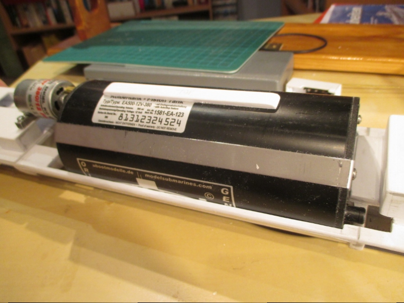

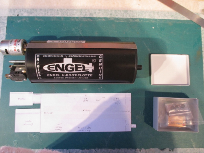

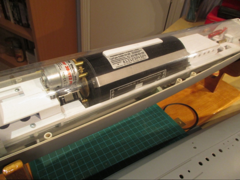

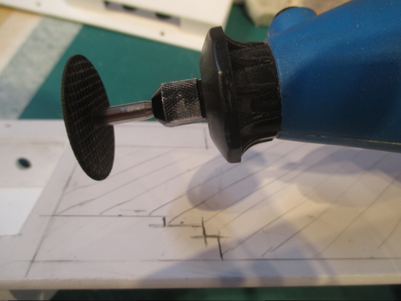

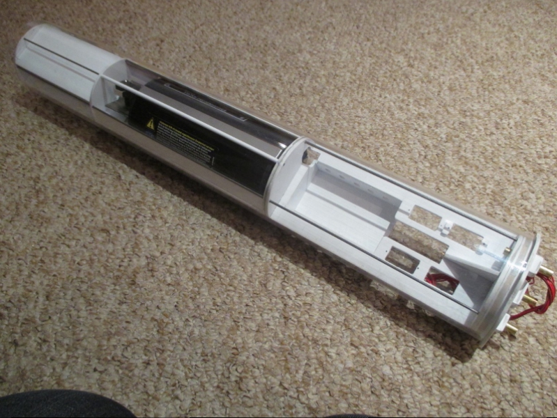

                The 500ml Piston Tank is exactly as per the dimensions on the Engel site, so my paper template was accurate.
                It came from Engel beautifully packaged and at 175 Euros seems good value to me, it's nicely engineered from good quality components.
                Click image for larger version  Name:	IMG_0864 (800x600).jpg Views:	1 Size:	273.2 KB ID:	120099

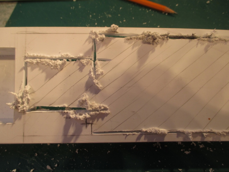

                The space on the tech rack for the tank is cut using a slitting disc in a mini-drill within the marked lines, initially it looks like it's done with an axe.
                Click image for larger version  Name:	IMG_0865 (800x600).jpg Views:	1 Size:	227.5 KB ID:	120100Click image for larger version  Name:	IMG_0866 (800x600).jpg Views:	1 Size:	241.9 KB ID:	120101

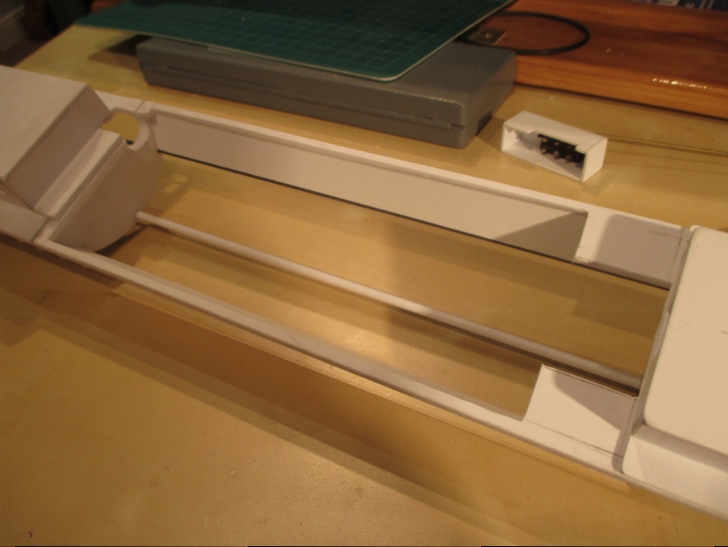

                The steel wires are now inserted through the entire WTC to add strength, 2mm sides added and a slot for the tank outlet cut.
                Click image for larger version  Name:	IMG_0867 (800x600).jpg Views:	1 Size:	240.4 KB ID:	120102Click image for larger version  Name:	IMG_0868 (800x600).jpg Views:	1 Size:	219.3 KB ID:	120103
                The tank is trial fitted, the slight overhang of the motor will be useful.
                Click image for larger version  Name:	IMG_0869 (800x600).jpg Views:	1 Size:	278.5 KB ID:	120104Click image for larger version  Name:	IMG_0870 (800x600).jpg Views:	1 Size:	278.7 KB ID:	120105
                It all fits snugly into the WTC.
                Click image for larger version  Name:	IMG_0871 (800x600).jpg Views:	1 Size:	277.6 KB ID:	120106
                The Boattrainman

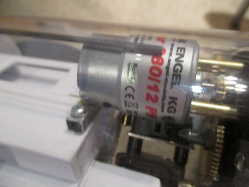

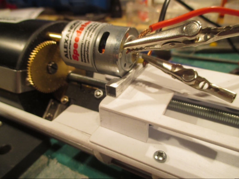

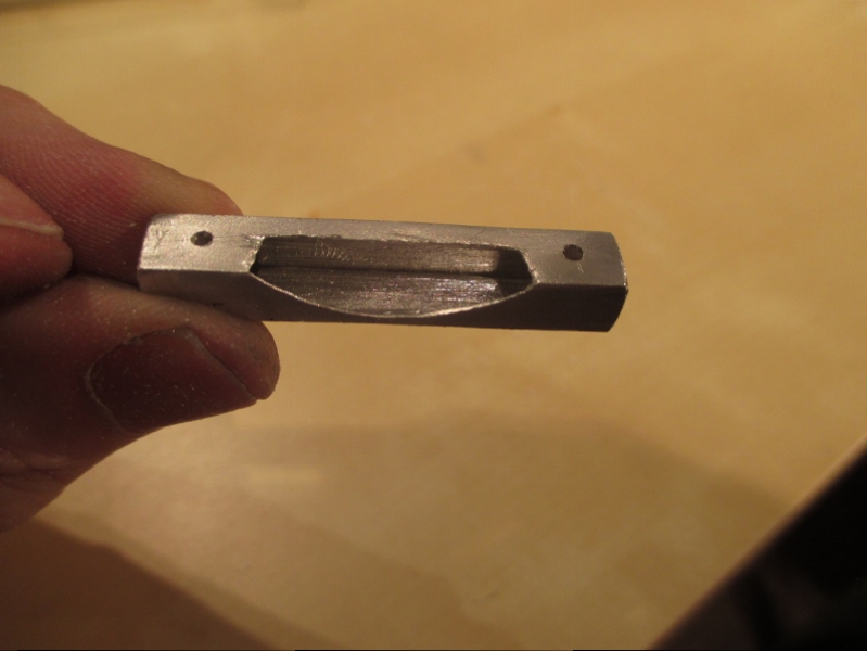

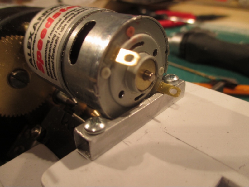

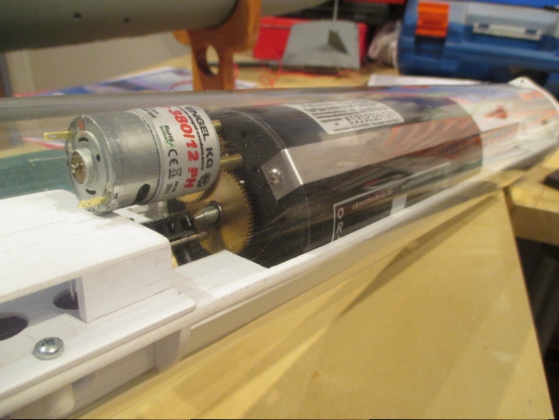

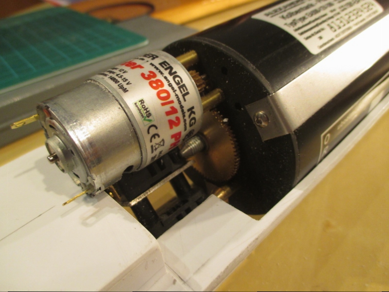

                  This aluminium fitting is made to go under the piston tank motor and also acts to keep the tank centered and in in place.
                  Click image for larger version  Name:	IMG_0874 (800x600).jpg Views:	1 Size:	214.8 KB ID:	120109Click image for larger version  Name:	IMG_0875 (800x600).jpg Views:	1 Size:	238.8 KB ID:	120110

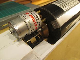

                  The Piston Tank is fired up to test the spindle fitting which runs through the holes in the styrene box over the battery.
Name:	IMG_0872 (800x600).jpg
ID:	120120Click image for larger version  Name:	IMG_0873 (800x600).jpg Views:	1 Size:	196.7 KB ID:	120108

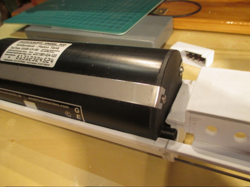

                  The forward end of the tank sits up to the drive motor housing with the outlet in it's slot.
                  Click image for larger version  Name:	IMG_0878 (800x600).jpg Views:	1 Size:	229.9 KB ID:	120113

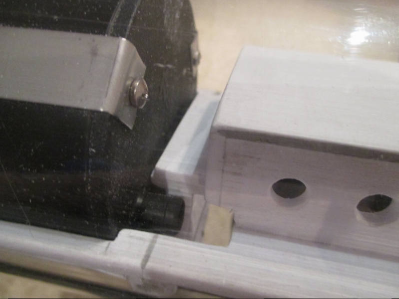

                  A single piece of 3.2mm styrene acts as a top bearer, Engel don't recommend you glue anything to the tank in case the glue/epoxy warps the plastic, so the bearer is held in place with double sided tape. The bearer presses against the upper inside of the WTC, and helps keep an air gap around the motor so it doesn't touch the WTC.
                  Click image for larger version  Name:	image_34483.jpg Views:	1 Size:	283.3 KB ID:	120117Click image for larger version  Name:	IMG_0879 (800x600).jpg Views:	1 Size:	229.5 KB ID:	120114
                  This 2mm rod inserted in the WTC shows the cooling gap between motor and WTC.
                  Click image for larger version  Name:	image_34484.jpg Views:	1 Size:	241.2 KB ID:	120112

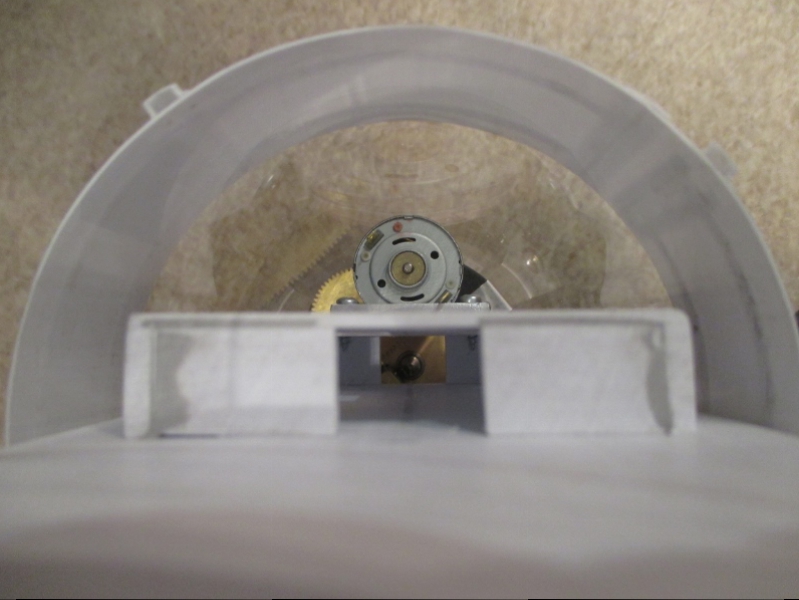

                  The tank can't move in any direction as it's compressed on all sides inside the WTC.
                  Click image for larger version  Name:	IMG_0880 (800x600).jpg Views:	1 Size:	301.6 KB ID:	120115

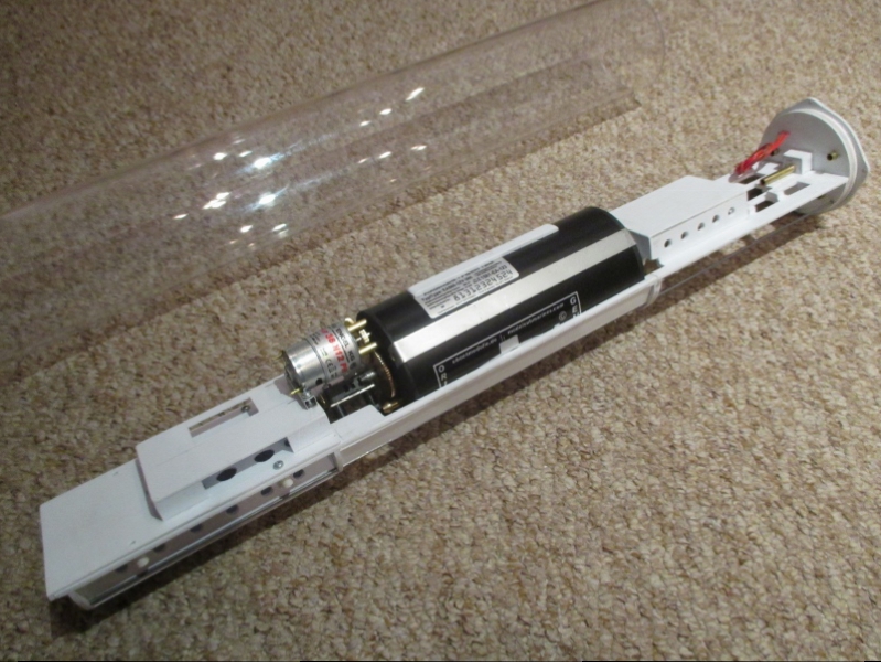

                  That's the tank sorted, there's a lot of cleaning up of the styrene to do, but it fitted without any major problems.

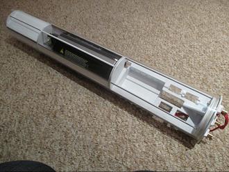

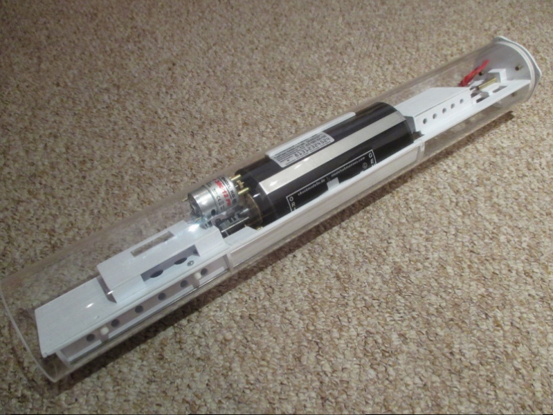

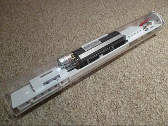

                    #204
Name:	IMG_0882 (800x600).jpg
ID:	120122Click image for larger version
Name:	IMG_0883 (800x600).jpg

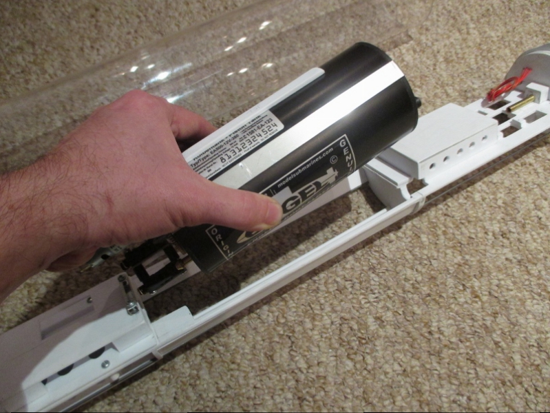

                    The beauty of this system is that once you pull the tech rack out.......................
Name:	IMG_0884 (800x600).jpg
                    ........the piston tank clear just lifts off.
Name:	IMG_0885 (800x600).jpg
                    The Boattrainman

                          The WTC build is counter intuitive in that initially you would assume the biggest 'lump' is the Piston Tank and it should be sorted first, and the rest of the electronics built around the installation.
                          However, there is no room for variations given the limited size of the space, and as the PT is the known quantity thanks to the dimensions on the Engel website (all Engel PTs regardless of capacity are 75mm in diameter), it stands to reason that the spaces for the servos, ESC etc. have to be sorted first. These electronics can be sized to fit the spaces available, micro servos, mini ESC. Also, there was no point acquiring the PT unless the WTC itself can withstand the internal pressure of the compression when it is filled with water.
                          Finally, if I had done the PT first, I would have to work with a very flimsy tech rack, given most of the centre is removed to fit the thing. I would almost certainly have broken it drilling and sanding the various openings.

                            #208

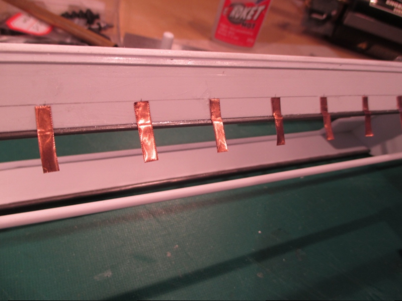

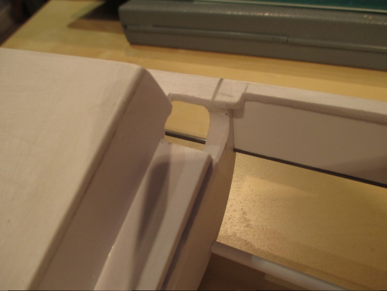

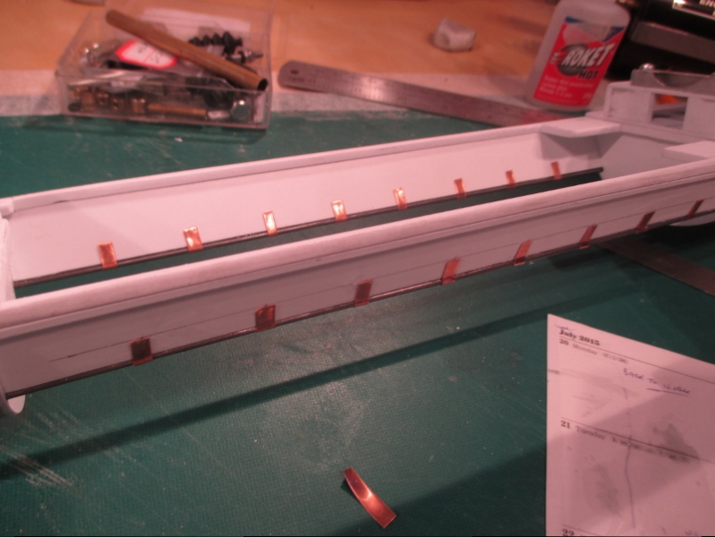

                            The sides of the WTC where the tank sits is reinforced with small pieces of brass sheet between the steel rods and plastic sides.
Name:	IMG_0886 (800x600).jpg
ID:	120161Click image for larger version
Name:	IMG_0887 (800x600).jpg
                            They hold the plastic tight to the steel rods as gluing these together would be hard.
Name:	IMG_0888 (800x600).jpg

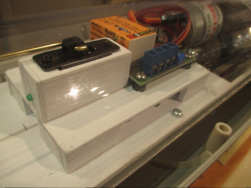

                            I can position the Main Switch now the PT and the PT switch unit position is fixed. I had to cut the Main Switch housing down a bit and re-site the indicator LED to the front.
Name:	IMG_0889 (800x600).jpg
ID:	120163Click image for larger version
Name:	IMG_0890 (800x600).jpg

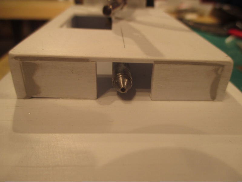

                            The rod to the On/Off switch exits through a small hole to keep it from moving outside the WTC.
Name:	IMG_0891 (800x600).jpg

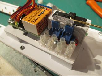

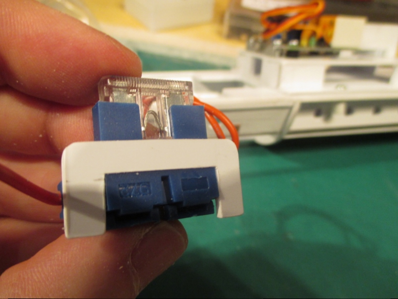

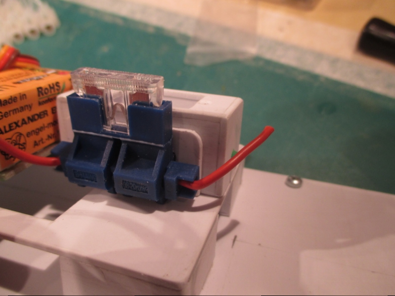

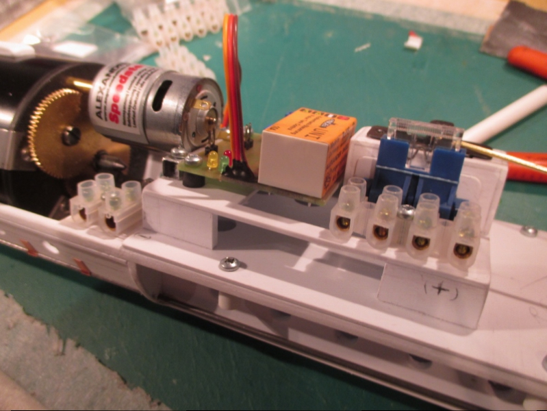

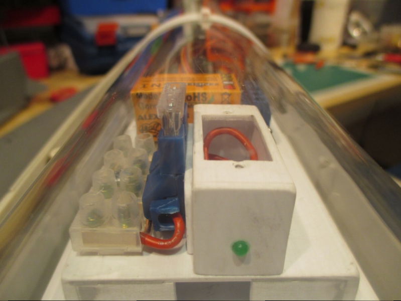

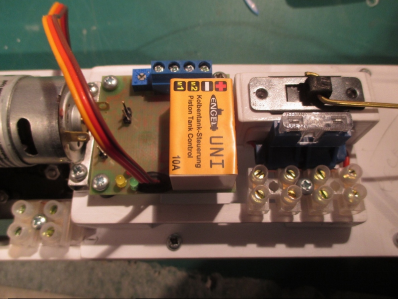

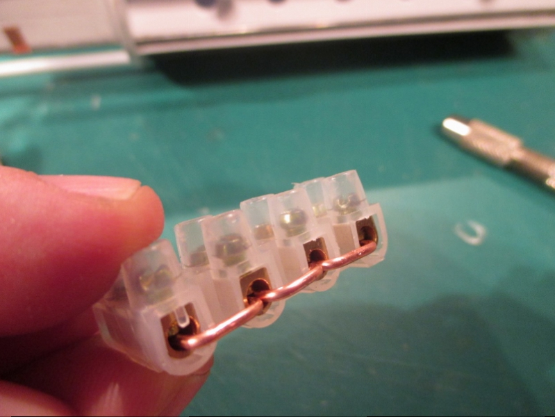

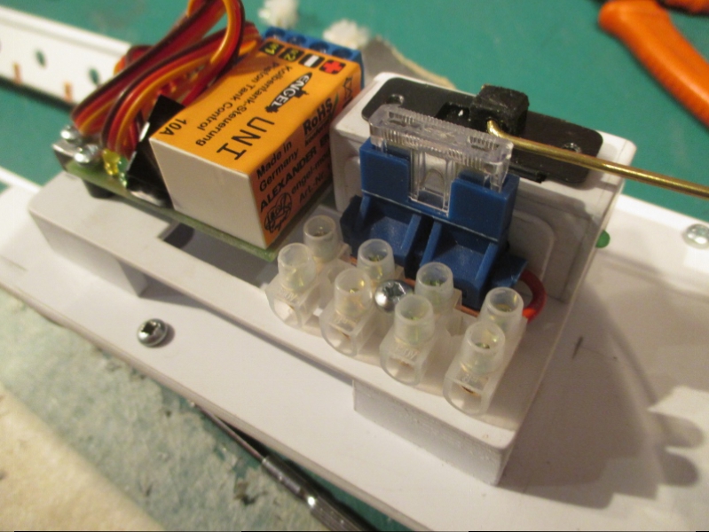

                                Sorting out 12V power distribution involves installing a fuse and holder and simple connectors. I'm contradicting myself here as I previously stated that I'm not a fan of fuses in a model sub, but I'll give this one a shot.
                                A U-shaped piece of styrene is used as a keeper plate, it glues to the side of the main switch housing.
                                Click image for larger version  Name:	IMG_0892 (800x600).jpg Views:	1 Size:	255.9 KB ID:	120208Click image for larger version  Name:	IMG_0893 (800x600).jpg Views:	1 Size:	235.8 KB ID:	120209
                                A set of four connectors will distribute positive (+) power using 20 Amp single core jumper wires, they are screwed up tight to the fuse holder to keep it in place against the keeper plate. Wiring between the main switch, fuse and connectors will be mostly hidden but still accessible.
                                Click image for larger version  Name:	IMG_0894 (800x600).jpg Views:	1 Size:	245.2 KB ID:	120210Click image for larger version  Name:	IMG_0895 (800x600).jpg Views:	1 Size:	293.0 KB ID:	120211
                                The small tab I left near the piston tank motor holds two connectors that will distribute the negative (-) power.
                                Click image for larger version  Name:	IMG_0896 (800x600).jpg Views:	1 Size:	280.1 KB ID:	120212Click image for larger version  Name:	IMG_0897 (800x600).jpg Views:	1 Size:	282.4 KB ID:	120213
                                It's easier to see the fuse holder setting in this shot, no screws or glue needed to keep it in place.
                                Click image for larger version  Name:	IMG_0898 (800x600).jpg Views:	1 Size:	254.8 KB ID:	120214
