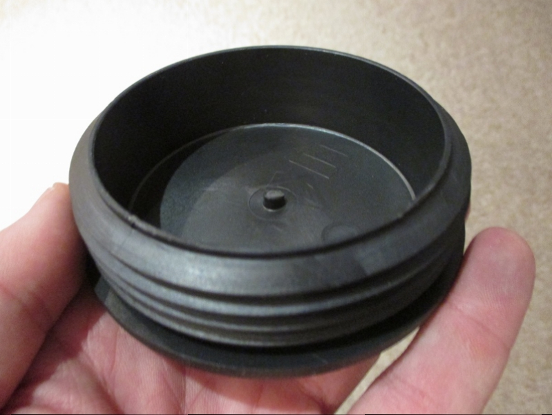

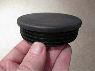

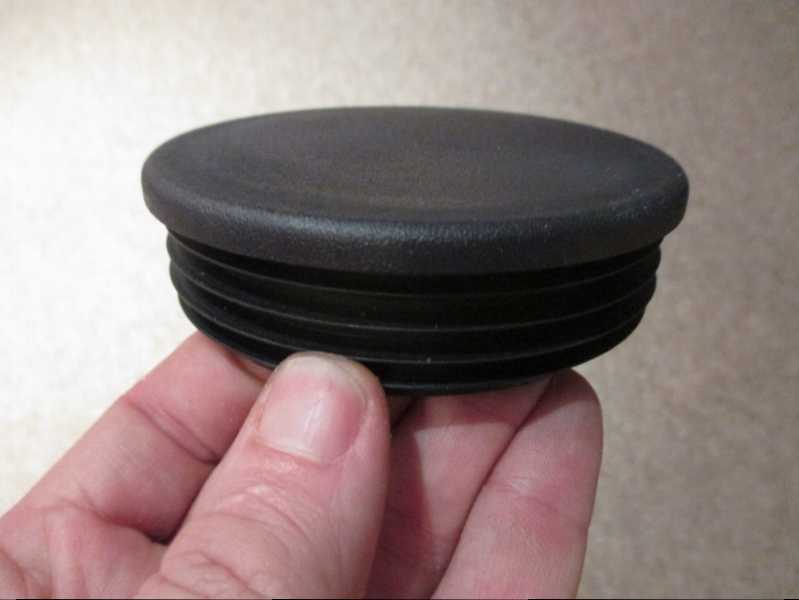

      I also found these on Ebay, they would work as end caps with some work. Two of them for 5 Euro!
      Click image for larger version  Name:	IMG_0729 (800x600).jpg Views:	1 Size:	232.4 KB ID:	118855Click image for larger version  Name:	IMG_0730 (800x600).jpg Views:	1 Size:	235.9 KB ID:	118856
      They are marketed as furniture leg protectors, they are 90mm in diameter and could be adapted for the 3.5inch/90mm tube, sheer stubbornness has me making my own caps.

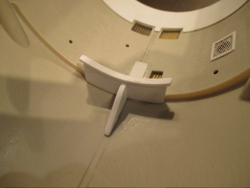

      I made this small fitting as an extra resting point in the hull for the WTC, there are only two fittings with the Caswell upgrades, now there are three resting points in total
      Click image for larger version  Name:	IMG_0728 (800x600).jpg Views:	1 Size:	236.5 KB ID:	118854

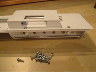

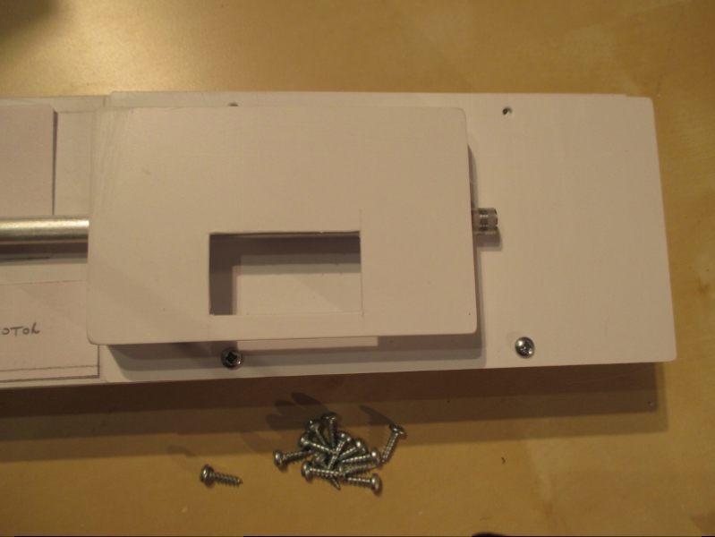

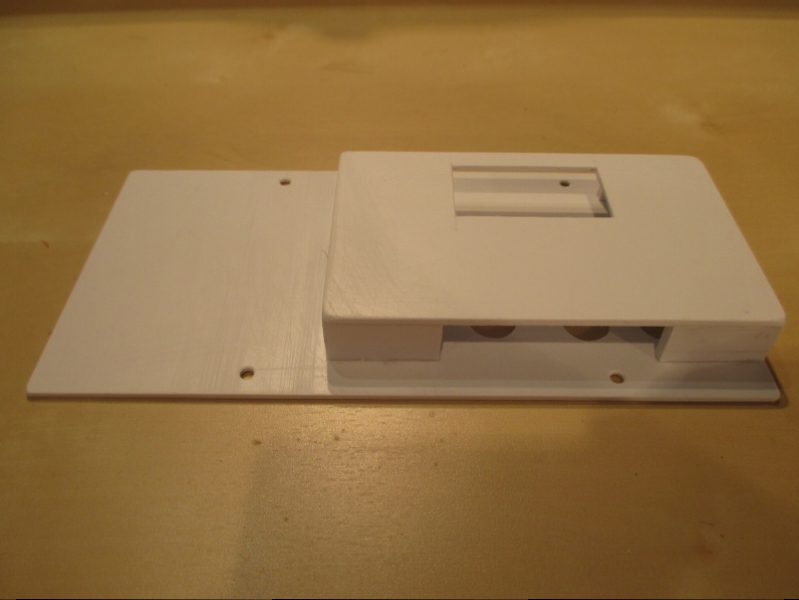

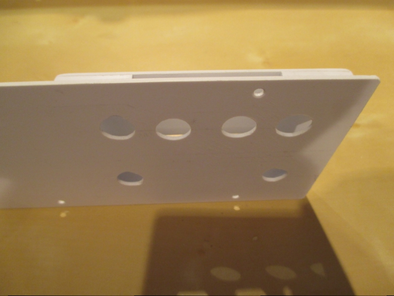

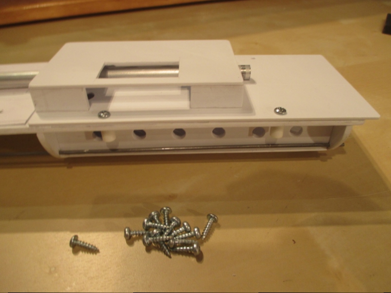

          This odd shaped piece will go over the battery box, it is just two square pieces of 1.5mm styrene. The round holes are to let some air around the battery and the slot in the side and top will take a 'push-to-break' switch for the navigation lights, which be activated by the piston tank spindle.
          Click image for larger version  Name:	IMG_0731 (800x600).jpg Views:	1 Size:	212.2 KB ID:	118878Click image for larger version  Name:	IMG_0732 (800x600).jpg Views:	1 Size:	223.4 KB ID:	118881
          There is an opening at either end for the piston tank spindle (simulated by the metal rod in the picture).The piece is screwed to the battery box with four M3 self-tapping screws, I use this screw and no other for all mounts etc, inside my models, so if I drop one or lose one I've a large batch. The screws are covered by short lengths of plastic tube to cover the exposed points.
          Click image for larger version  Name:	IMG_0734 (800x600).jpg Views:	1 Size:	213.4 KB ID:	118880Click image for larger version  Name:	IMG_0733 (800x600).jpg Views:	1 Size:	231.2 KB ID:	118879
          This area will hopefully hold the piston tank controller on top, the receiver (Rx) in front of the piston tank spindle and if there is enough room the pitch controller.

            #125
            I like the idea of using the spindle shaft to turn the lights off.

              #126
              Thanks HardRock,
              Just trying to keep this as simple as possible, the nav lights will light when the main switch is activated and go off during the dive (via the switch on the spindle). One less radio channel!
