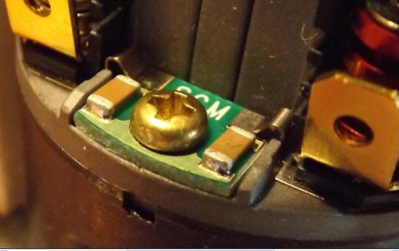

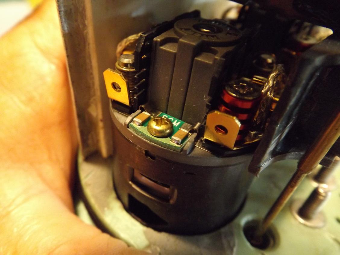

    I started thinking about motor capacitors for these things....and guess what. These have built in SMD(surface mount device) boards already installed. So I wont need them. Just as a side note, its my understanding that motors used in a model that uses a 2.4 GHZ radio, dont need any type of motor suppression.Click image for larger version

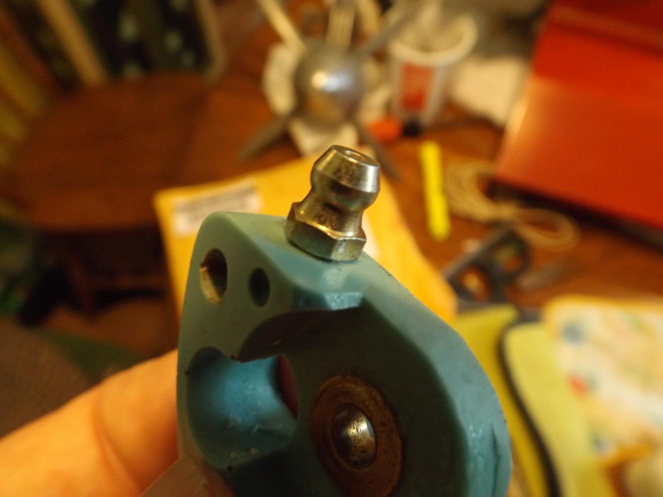

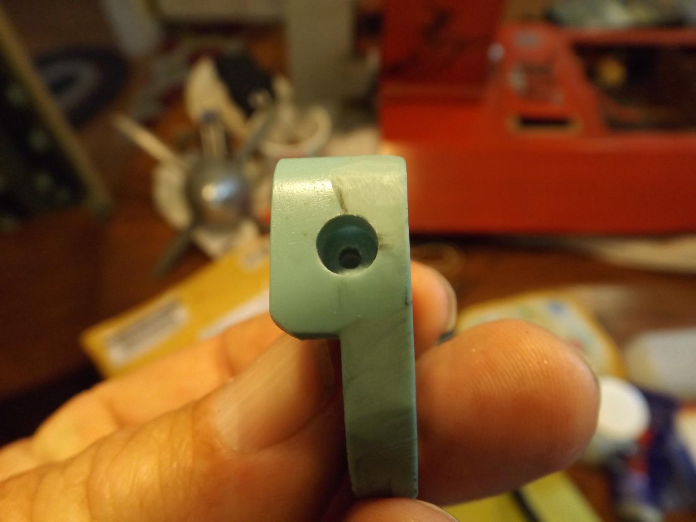

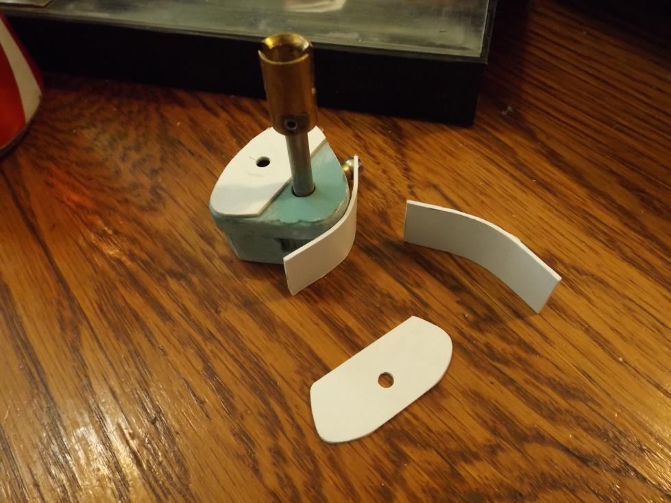

          At any rate, here are some pictures of the gearboxes that Im modifying to accept grease.The reason for this is, I guess all the motor swaps on this thing, I must have damaged one of the seals, because on the last test, there was way more water in the Subdriver than I wanted to see. This should keep it high and dry. This will pack waterproof grease down around the seals and not let any water into that area.Click image for larger version
