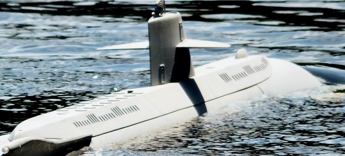

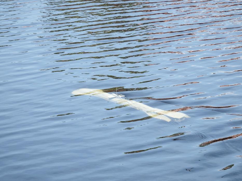

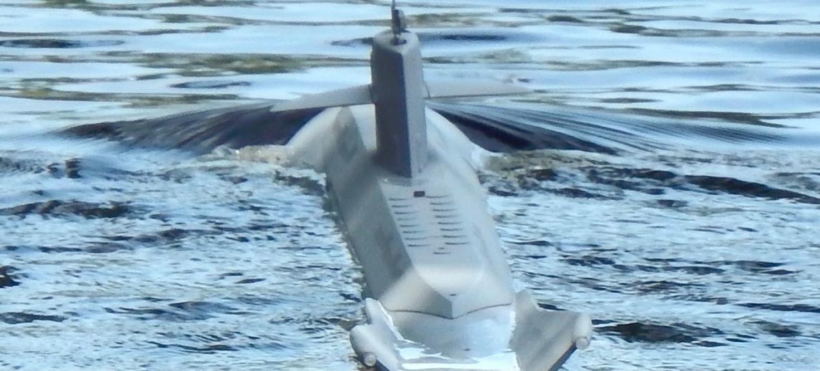

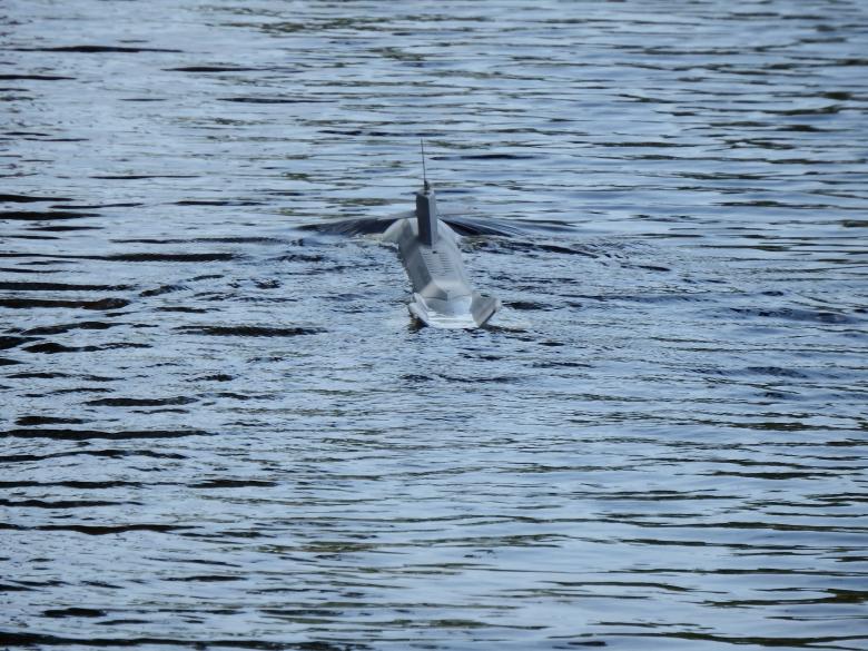

      Here are a few visitors that I received today at the sub pond. I forgot the names but the man works at the Jewelry store overlooking the pond. He said that he has seen me out there before. Since he is such a Seaview fan, when he saw that was what I had brought with me today, said he just had to get a closer look. Then, later he returned with his big black friend. I am terrible with names but hes definitely a Great Dane. Both were very pleasant with many well wishes and a few questions. I want to thank my brother Perry for being there to do the photography. Thats him there on the left in the second picture with the blue shirt. The ducks were none too pleased but they didnt make a fuss.

        Well done, Mark. You have worked long and hard to get to this point. Success! You have tamed the Beast, sir. Well done. Excellent photography too. Man, that thing looks so neat running submerged. We gotta hook-up one of these days, pal.

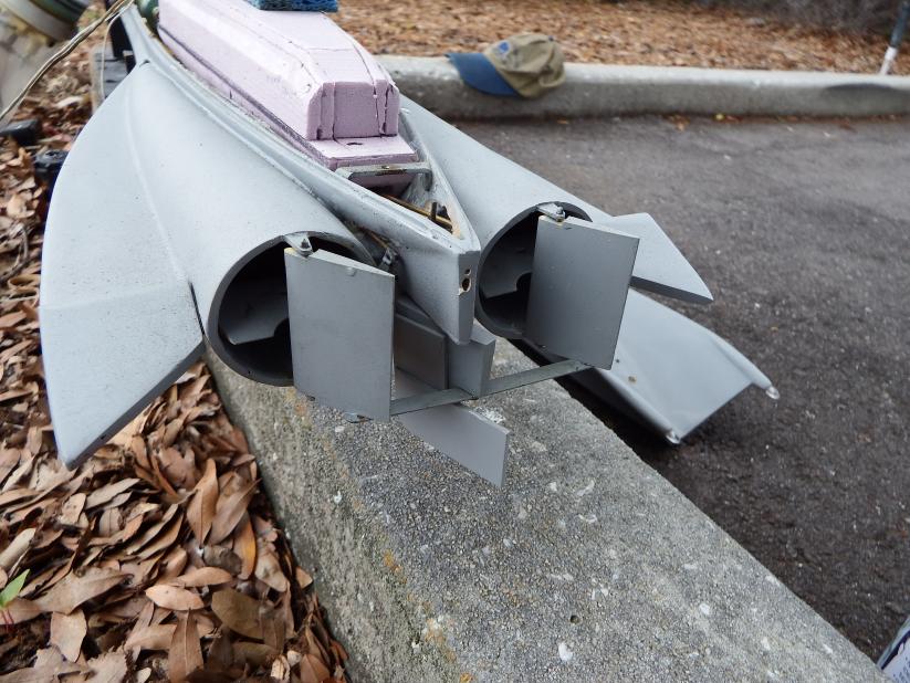

          I dont quite understand what happened...................exactly................ ....well sort of. You see I dont have this particular sub fitted with a lipo guard. Well, it started slowing down and then stopping. Just like a Lipo guard would cause it to do. Got back to the house and hooked up the Lipo to the charger and it was right at 3 volts per cell, right about where a Lipo guard would shut it down. In this sub I have two Mtronics 20 amp ESCs but their website says that this ESC is not Lipo safe. Then there is the UPC pitch controller but I dont see how that could interupt power to the ESCs. Then the 5 amp Caswell BEC but the same with that. Finally the Sombra SL-8 same with that. So it must be that the Mtronics ESCs are shutting this thing down at 3 volts per cell even though its not advertised to do so.
          Also I had a small leak that I couldnt find in the subdriver. Well I finally found it. The two screws that hold the motor plate on to the rear bulkhead. They go all the way thru to the outside. Water was slowly creeping in there. Ill get those stopped up for next time. A very sucessful outing. Ill get those videos up one at a time over the next couple of weeks. CHEERS!

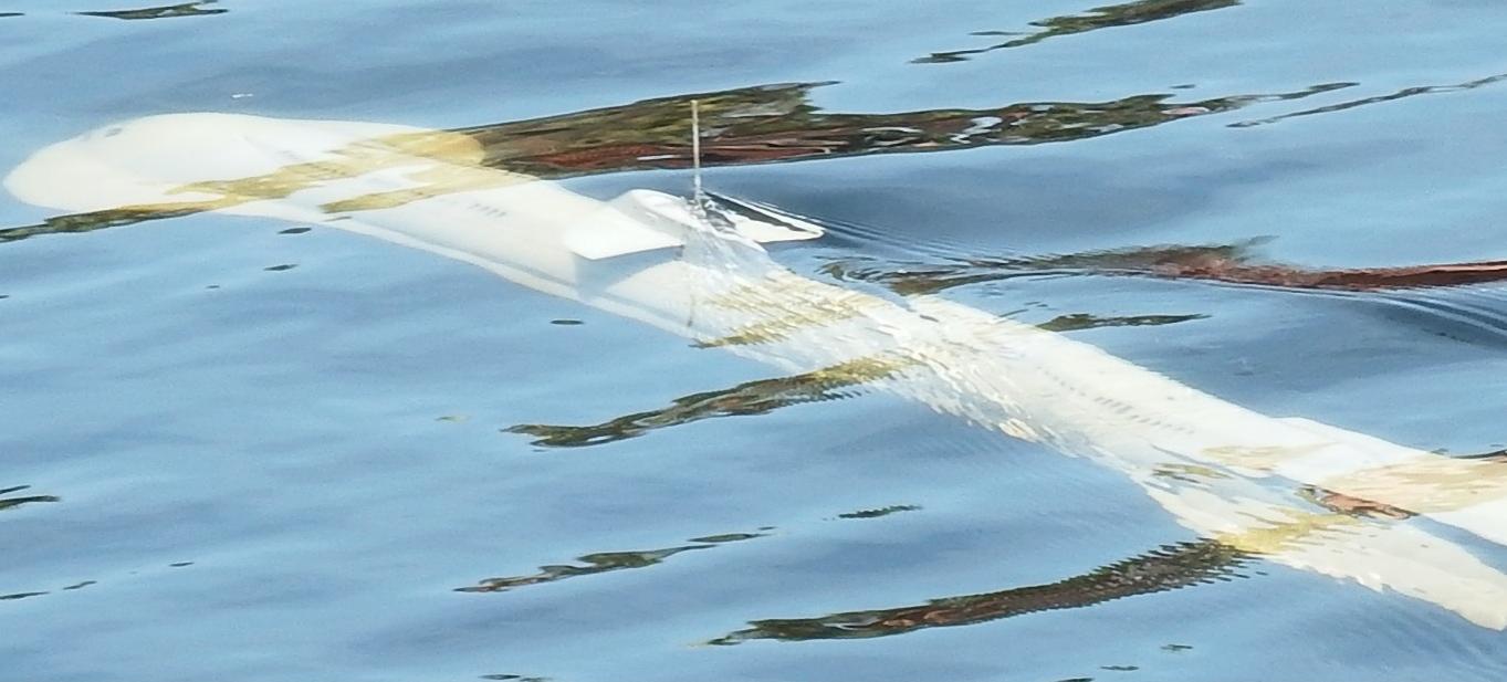

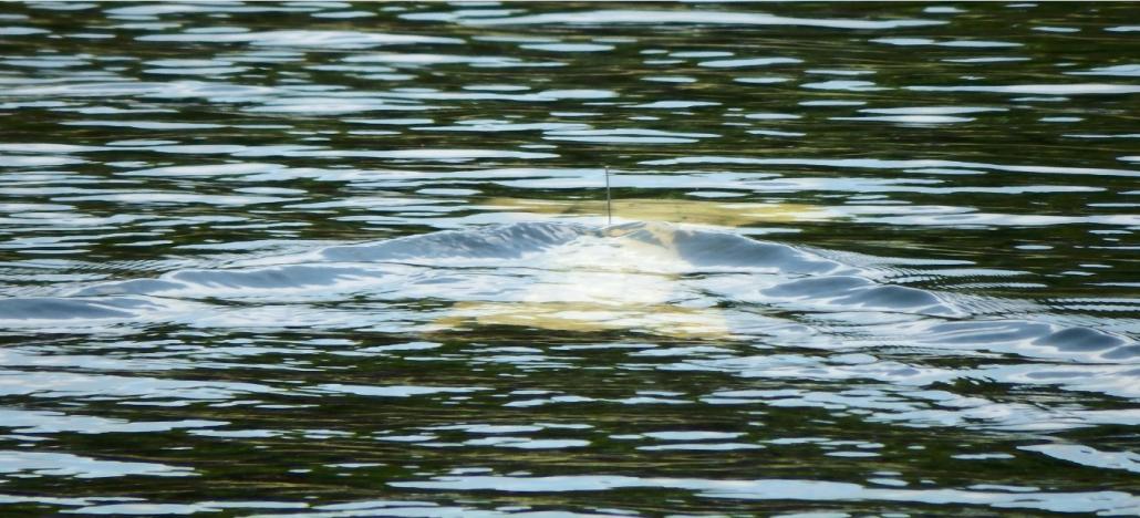

              A few picture enhancementsClick image for larger version
