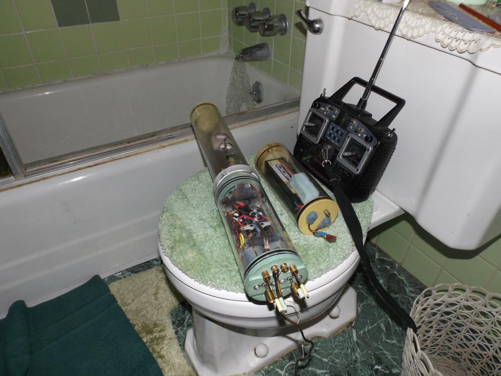

    Now on to the Hydrostatic pressure chamber test tank. Please note all the scientific equipment clearly in evidence and the numerous Diplomas casually displayed about the area.Click image for larger version
Name:	Fuji transfer 735.jpg
ID:	91066Click image for larger version
Name:	Fuji transfer 737.jpg

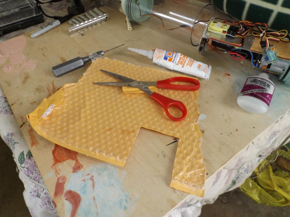

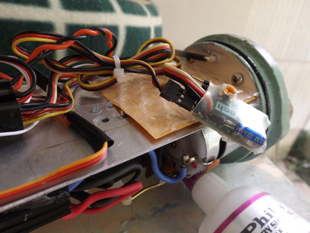

      Now on to the process by which I am trying to reduce the vibrations affecting the APC. I took a shipping envelope that has the bubble wrap applied to the inside. From it ,I cut a large piece and siliconed it down to the equipment tray. Then I took the APC and did likewise. When it drys it will be attached and floating on top of the air bubbles.Click image for larger version
Name:	Fuji transfer 739.jpg
ID:	91068Click image for larger version
Name:	Fuji transfer 740.jpg

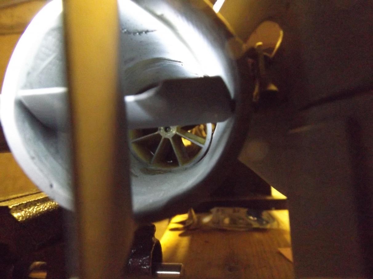

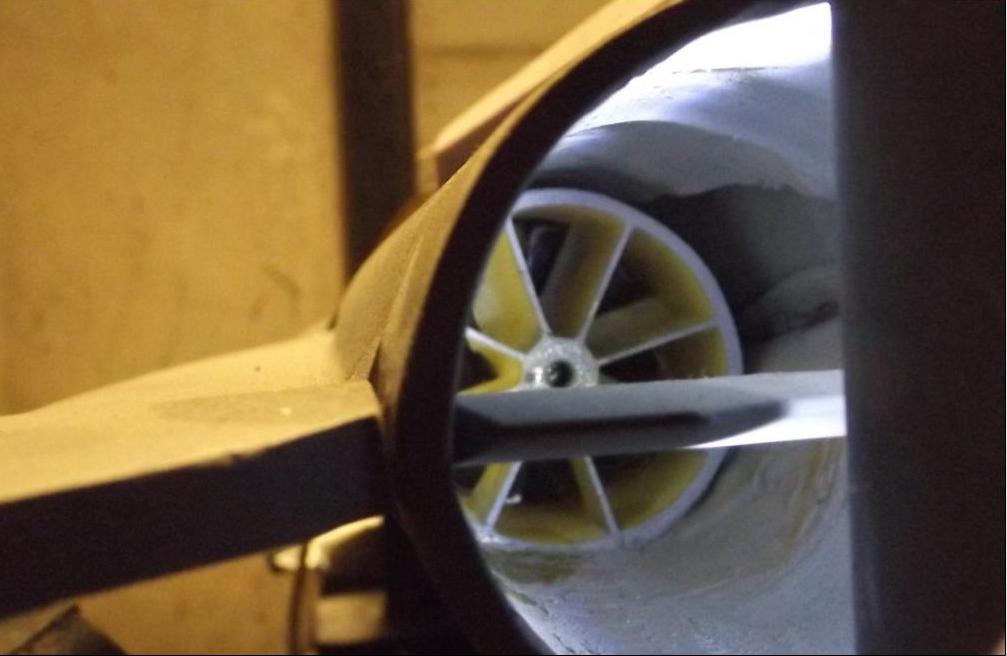

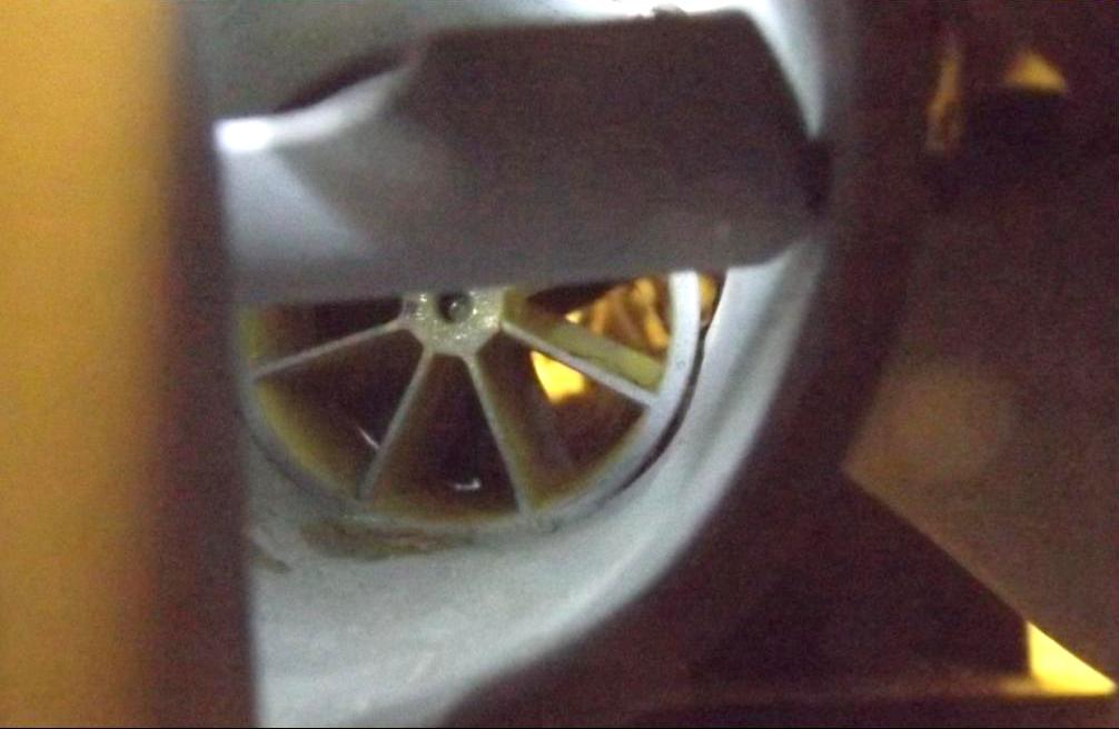

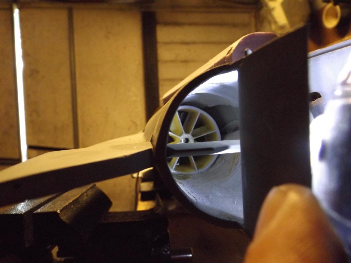

            Dave, take a look at the empellor swirl fins. Does it look like Ive got them in backwards? Click image for larger version
Name:	Fuji transfer 734.jpg
ID:	91116Click image for larger version
ID:	91117Click image for larger version
Name:	seaview exhaust 1.JPG
ID:	91118Click image for larger version
Name:	seaview exhaust.JPG
              • 13982
              #171
              You got 'em in right, Mark.
                #172
                Thanks Sir!

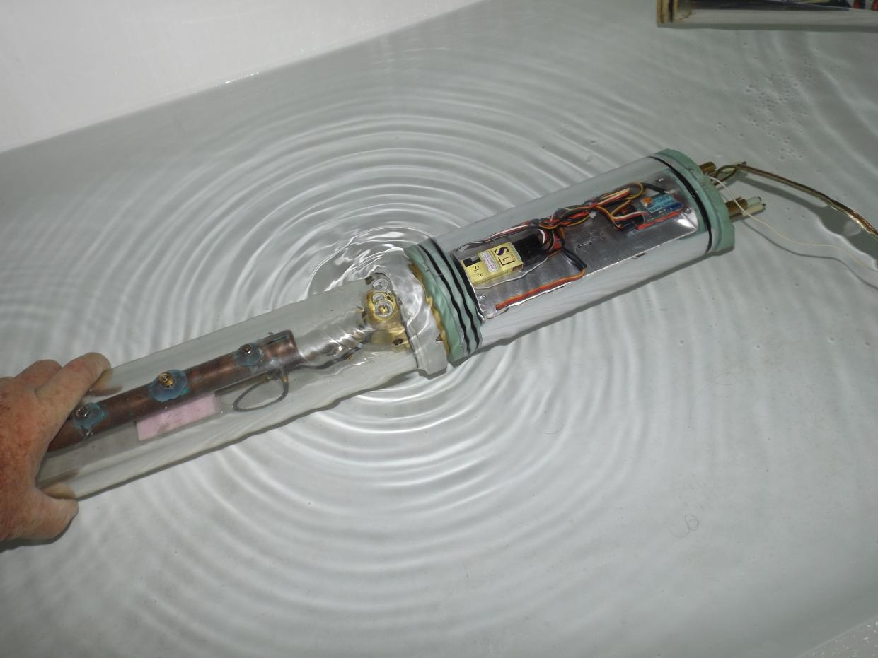

                  Got it in the water today. Yep, well definitely have to go with gear reduction. The 20 amp speed controls keep cutting out at anything above half throttle. That tells me that those motors will burn up. So, im looking into a 2 to 1 gear ratio, to start with. Details later. Also, Im going to follow Daves lead once again. Im going to buy me a kiddie pool. That way I can trim my two large subs at the house without a long drive.

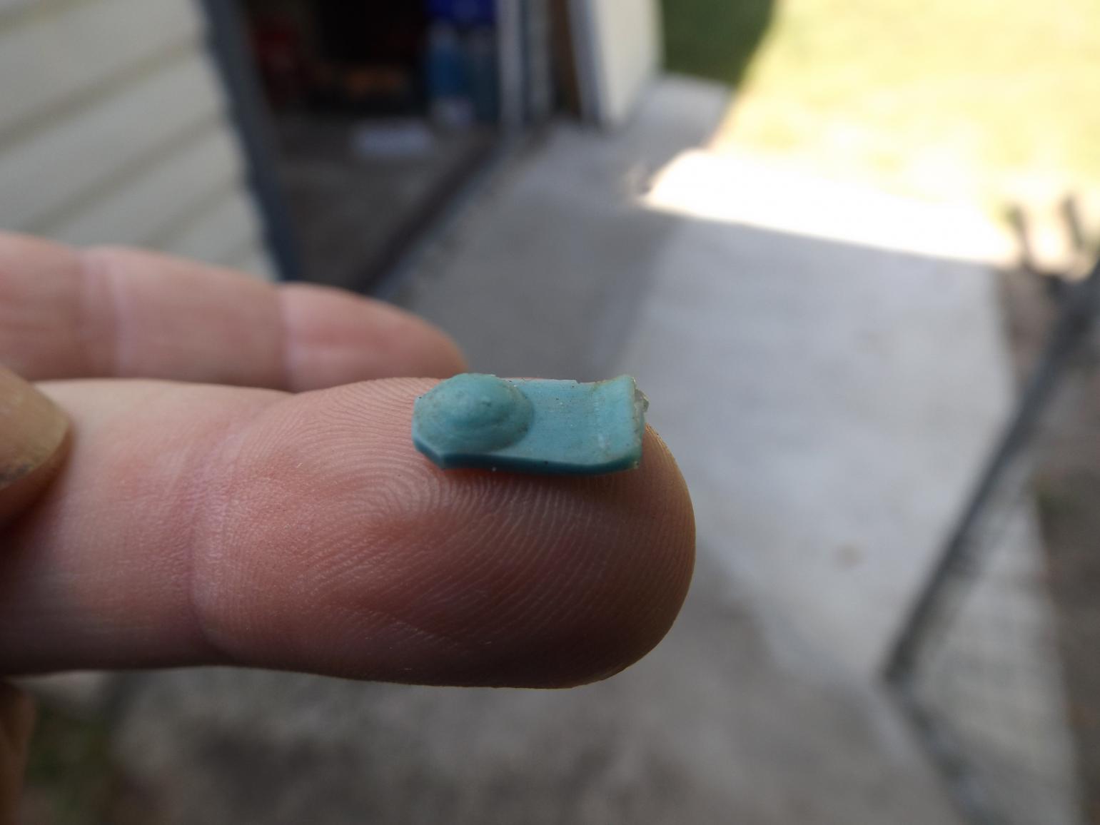

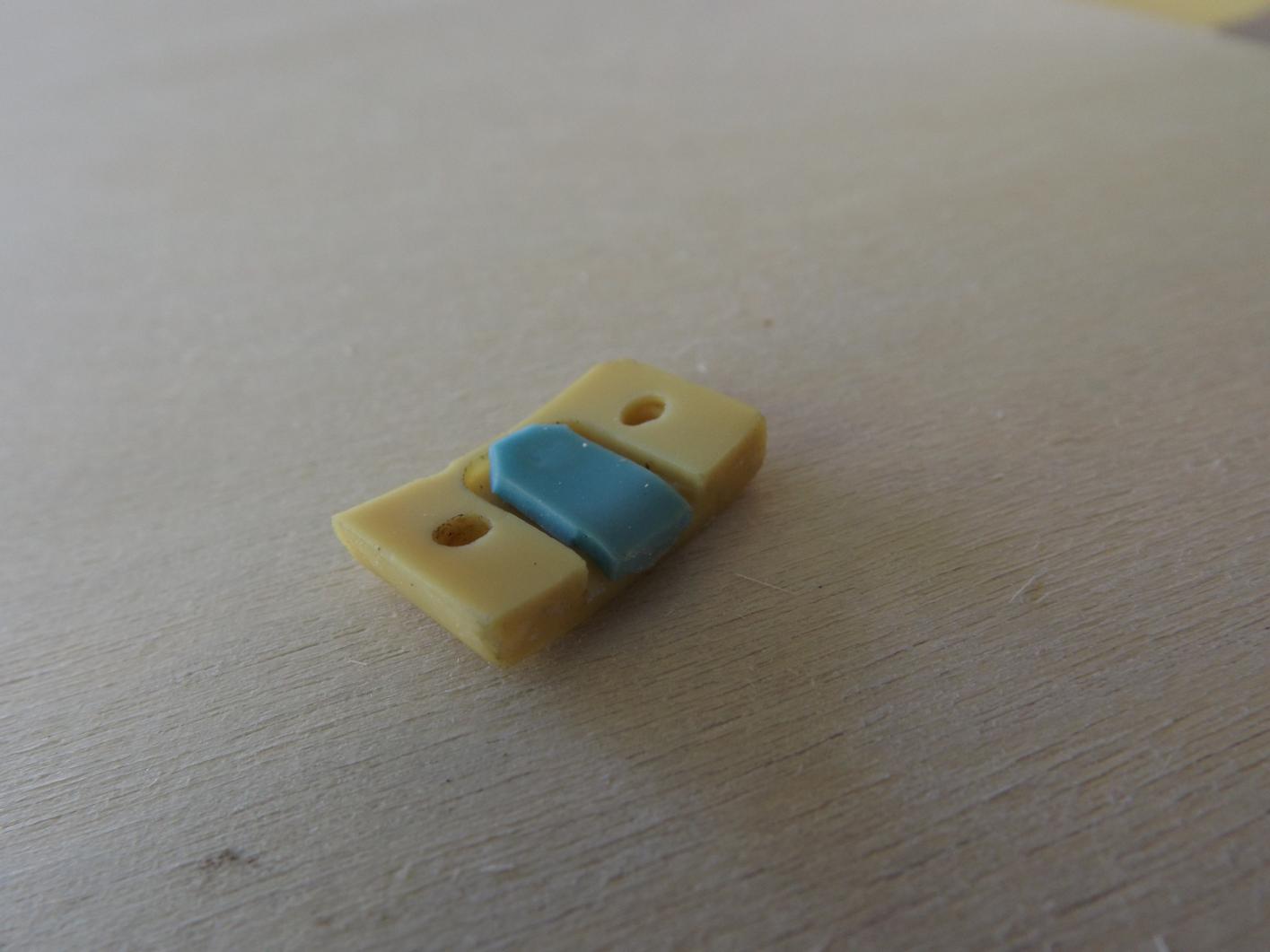

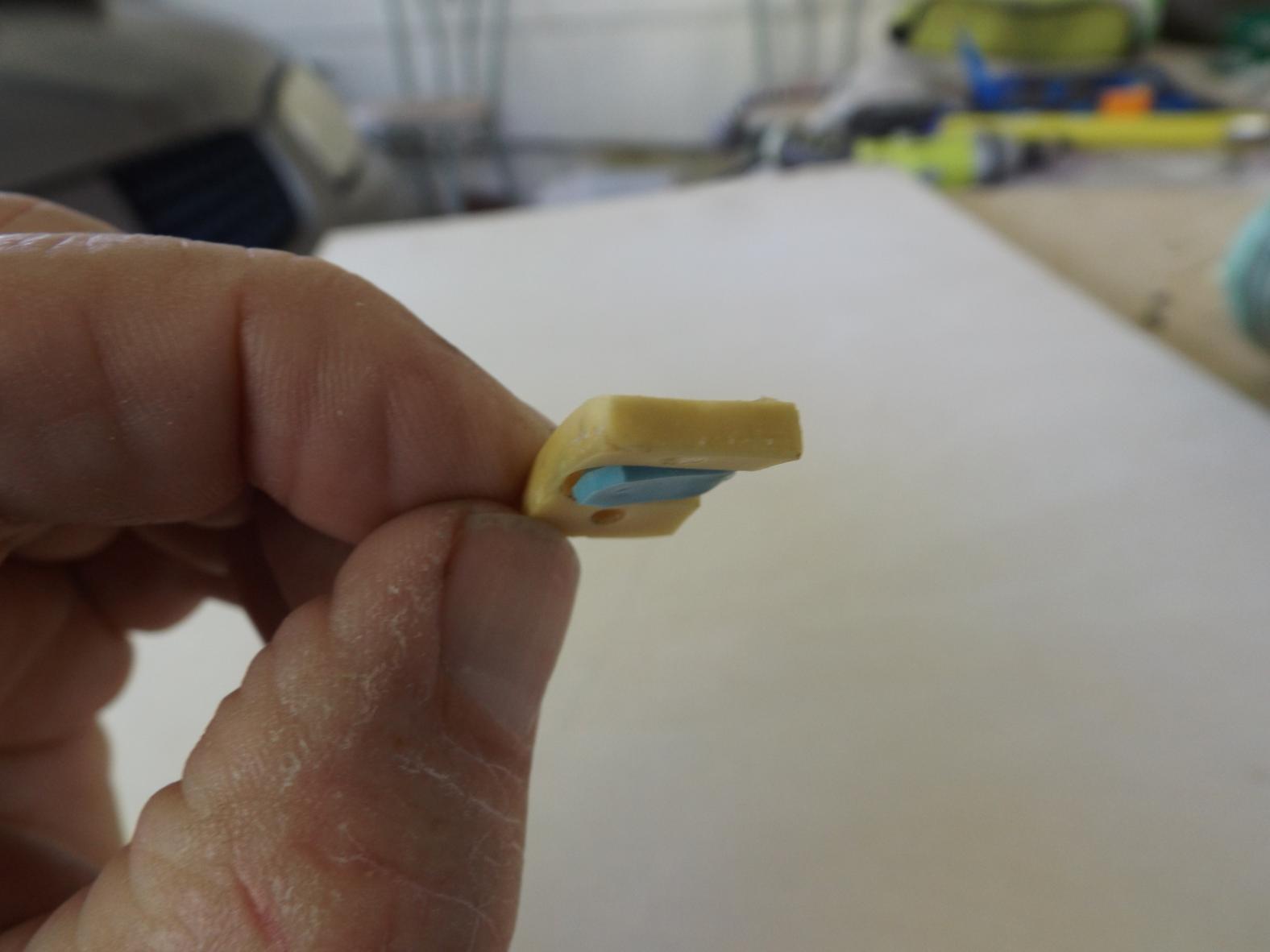

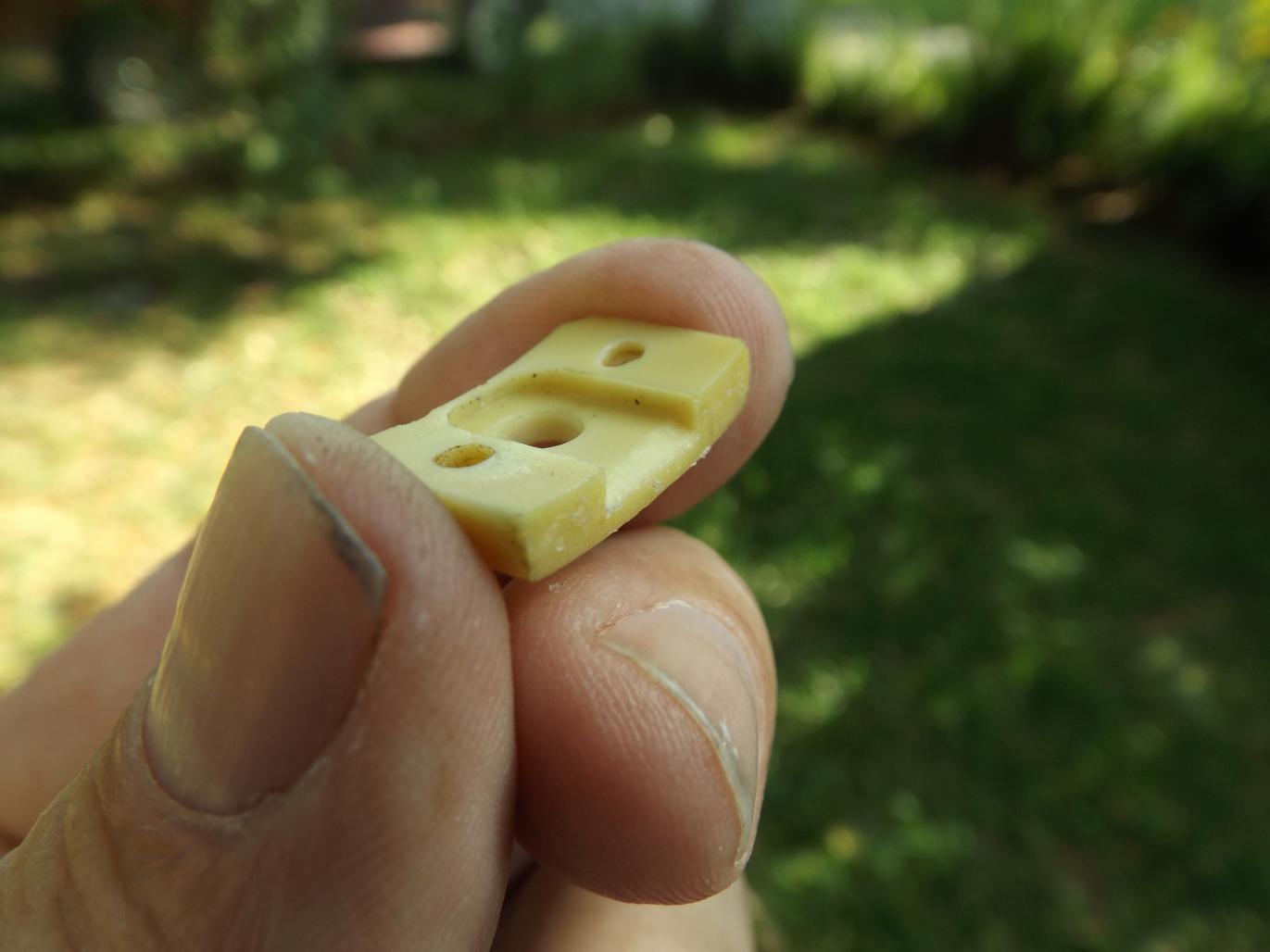

                            Needed to do a little work on the old style vent valve. I cant speak for the new style. Ill do what I did on the Oscar and it worked great. I drilled out the factory hole that was 5/32" and increased it to 3/16". In order to do that I had to remove the flapper valve. To re install it ,note that there is a chamfer on the front side of the housing and a built in chamfer on the flapper. Carefully make sure that whatever adhesive that you use holds those two areas together so that there will be tension pulling the flapper open when you hold it up. I used gap filling CA so that I could control where the CA went and could then "Freeze" it where I wanted. Just a little dab will do ya.Click image for larger version
Name:	Fuji transfer 813.jpg
ID:	91132Click image for larger version
Name:	Fuji transfer 814.jpg
ID:	91133Click image for larger version
Name:	Fuji transfer 815.jpg
ID:	91134Click image for larger version
Name:	Fuji transfer 817.jpg

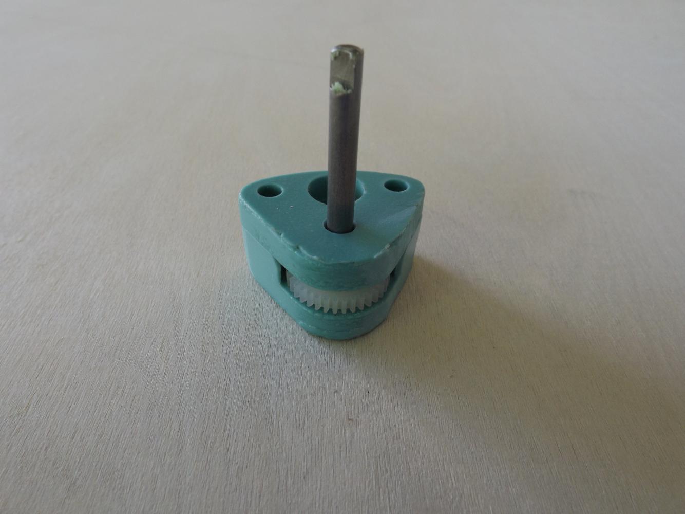

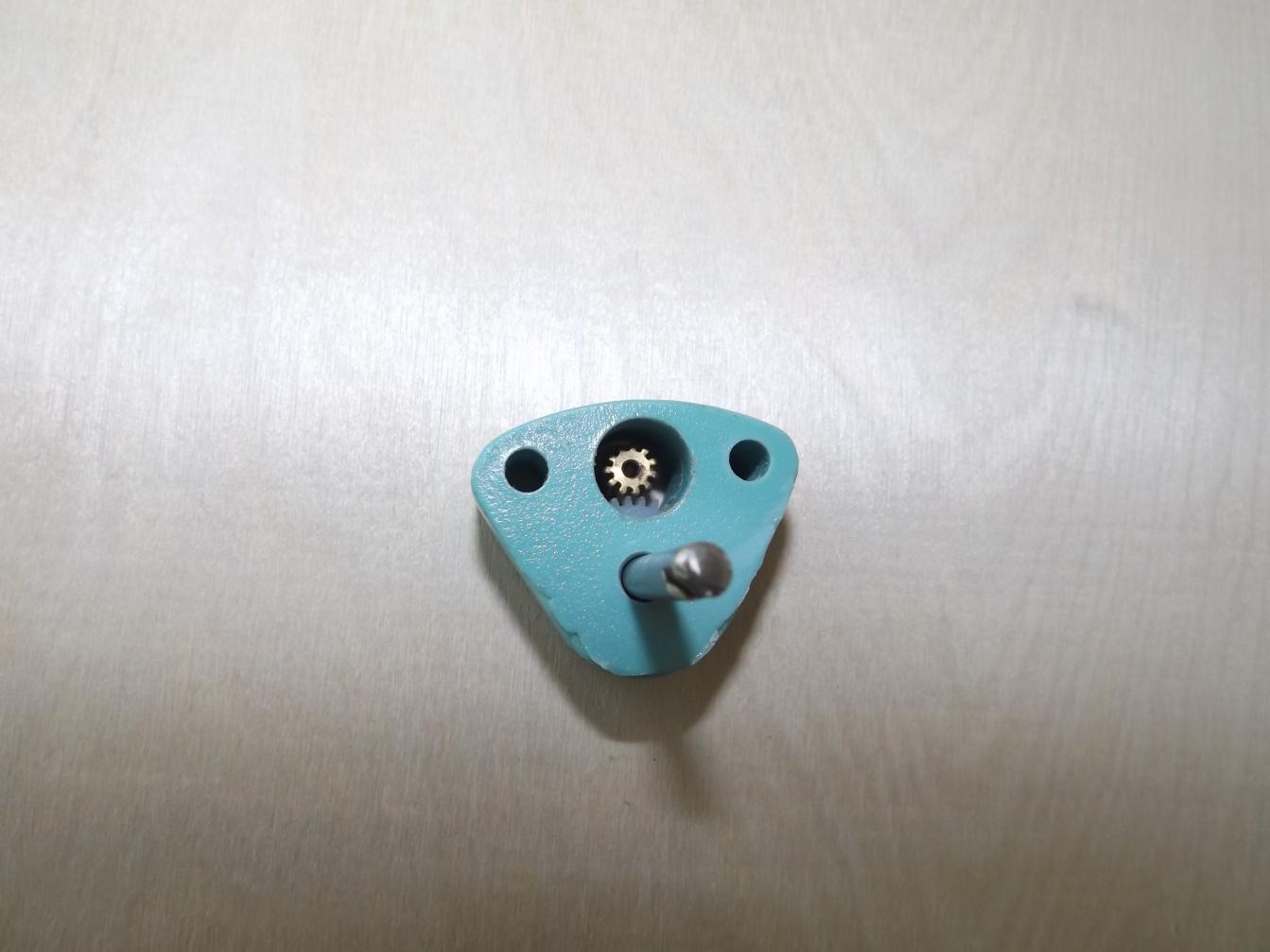

                                Now on to gear reduction. The older style 3&1/2" Subdrivers came with outside mounted gear reduction units. I think that they are great because you can get right to them, and that allows you some flexibility as you will see. At any rate, they come set up for 3 to 1 gear ratio. Since we started out this mod with going direct drive, I think I will start from there and move up the ladder so to speak. From 1:1 we will go to 2:1 and note the improvement. The gear housings are mounted using screws that also hold the motor in......perfect.
                                Problem, you have to hunt for your own gears and also the center to center of the gear housing is fixed, so be prepared for some mods to the housing to make it work. Ill settle on a couple of gear sets shortly and Ill post a link to them.Click image for larger version
Name:	Fuji transfer 818.jpg
ID:	91136Click image for larger version
Name:	Fuji transfer 819.jpg
ID:	91137Click image for larger version
Name:	Fuji transfer 820.jpg
