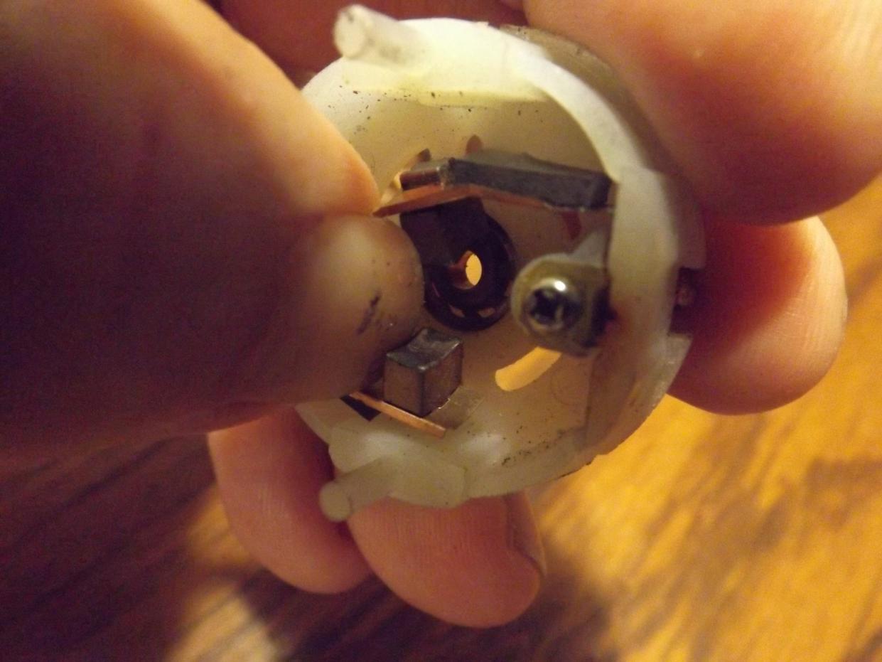

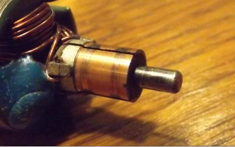

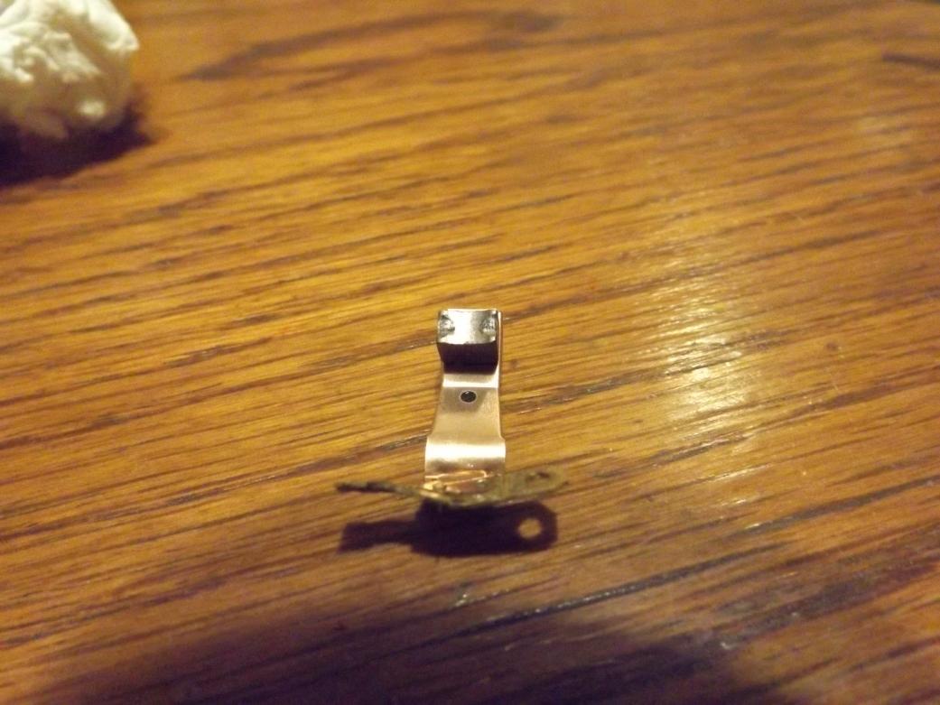

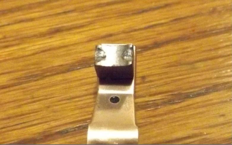

                        I just have a hard time understanding why those 12 volt motors have such a hardtime turning those little empellors, especially at 3 to 1. I took one of the motors apart and looked at the brushes. You can see where the brushes were only touching the comm. in two small places. That has to effect motor operation. Maybe I just need to break in the new Caswell 12 volt motors and install them and note the improvement.Click image for larger version

                          #222
                          That is looking familiar, happened to me with my balance device inside the type VII, was trying to run a12v motor on 6 volts, it did work for some time, only eating away the brushes.
                          It has to do with the current, power is voltage times current, for example, your motor has 60 watt of power, the current at 12 volt will be 5A, at 6 volt this will be 10A, this high current will eat away your brushes.
                          Always try to get the voltage of your battery as near as possible to the pecs of your motor, 7.2 volts will kill your motor on the short term, unless you use a 6v motor.
                          Replaced my 12v for a 6v motor and it is still running great, done this 5 years ago.
