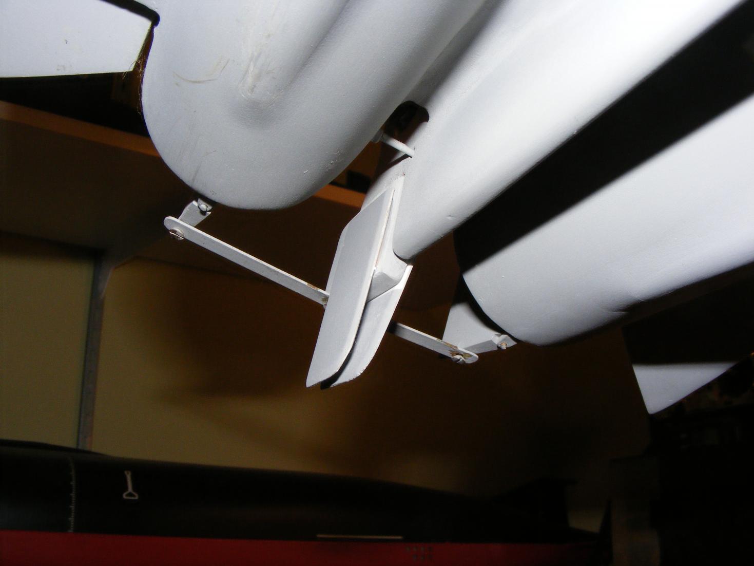

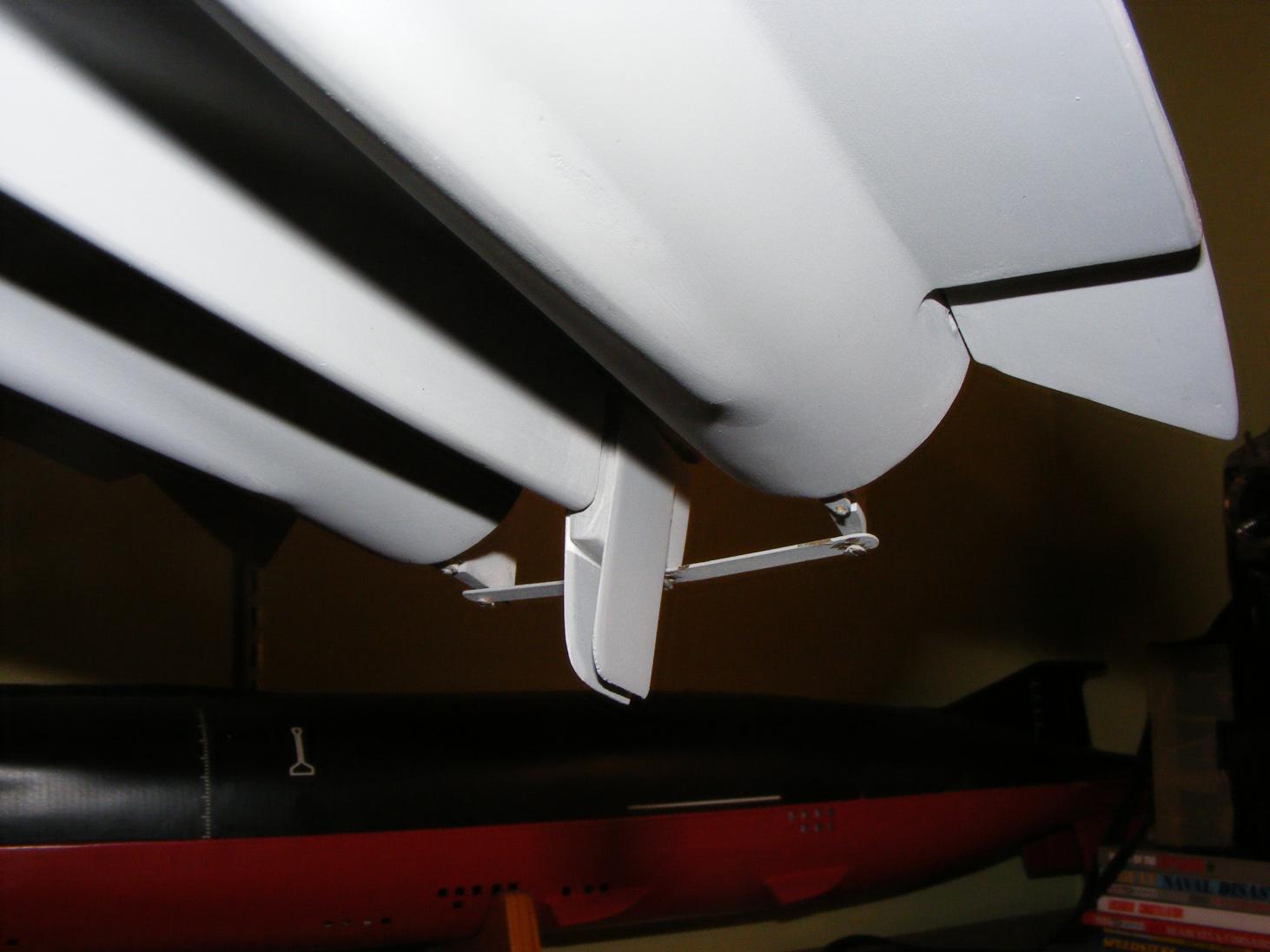

    I managed to get the rudders installed. Because of the shape of the original rudder, these new add on rudders dont run parallel to each other. Perhaps it will create a ventura effect and increase their effectiveness. We will see.

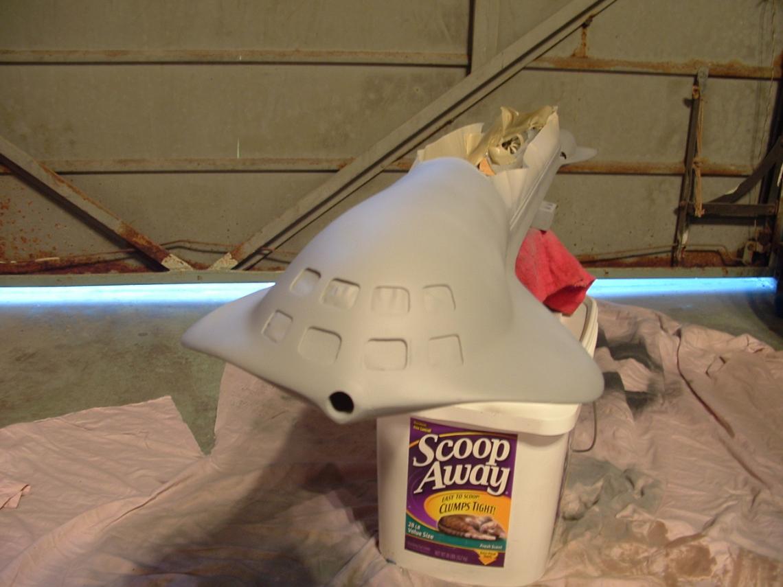

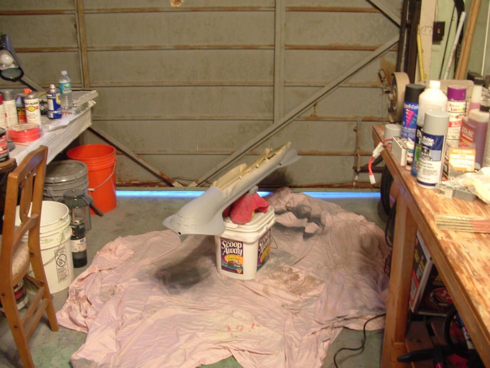

      Just found some long lost pictures of the Seaview in its early stages. Here she is in my makeshift paint booth using one of the bosses old sheets to keep paint off the garage floor.

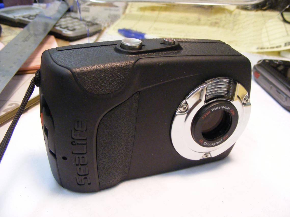

                                I bought this underwater video camera a while back and have never used it. Tomorrow will be the day.
