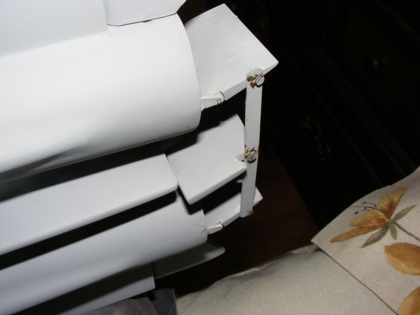

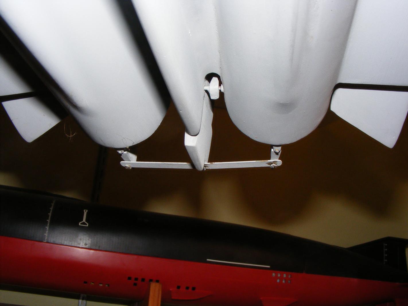

                          The time has come to help the turning radius of this boat. Im going to make two add on rudders sized 1&3/4" long and 7/8" wide. They will be CAed ,one on each side of the central rudder underneath. By installing two of them it will form a trough that should increase their effectivness. The only downside, other than not being part of the original design, is that they will hang down below the keel a little bit. So unless I want to plow some furrows, Ill need to keep it up off the bottom.

                                As can be seen from the pictures, this boat is steered by the action of the water coming from the props over the rudders behind the propulsion tubes. As those rudders are configured now ,only part of the water stream can act on the rudders. If the rudders were hinged in their centers, then the rudders would be affected by the entire water stream. The center rudder is very small and pretty much hidden by the hull to the flow of the water. What I am doing is extending that rudder down into the flow of water beneath the hull where they will do more good.
