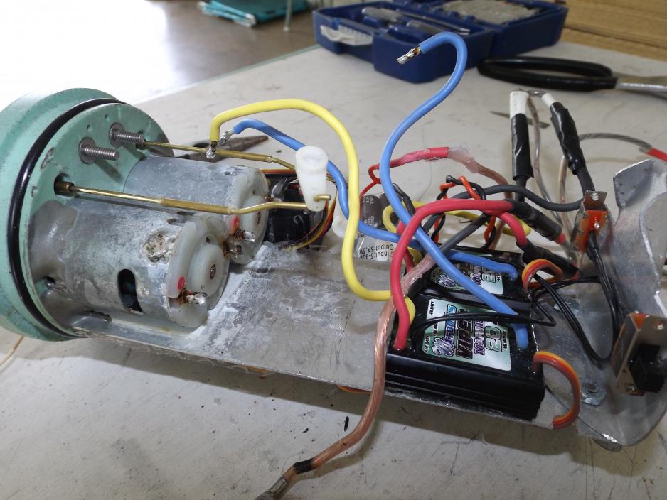

              WHAT A PAIN! Digging out the old motors. I had them in there good.Click image for larger version

                #202
                I need to reuse the small drive gears on the shaft. They are glued on there with Permatex Green Sleeve Retainer. So, I took a water hose on low and let it run over the shaft to cool it while I wacked off the motor shafts, just behind the gear. Im trying not to melt down those white Teflon shaft seals on the same shafts. Then Ill take those gears and heat them up with a torch and push out the old shaft remnants. OH CRUMS!!!Click image for larger version
