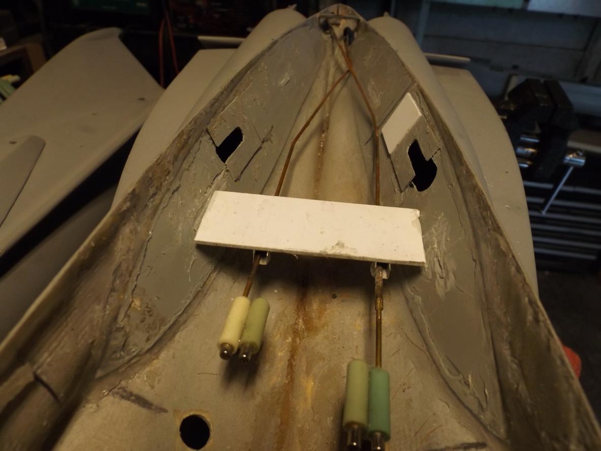

      Yesterday, I got her back together briefly for a test. With the new (broken in) motors installed, it showed a 15% increase in thrust. Cool!
      So then I opened up the impeller pods to get at the impellers themselves. As you can see from the pictures I posted yesterday, I am installing longer shafts and the thrust bearings. Ill get it closed and sealed back up in a couple of days for another test. Ive got a 540 motor builder called "Team Brood" looking into the cost and feasibility of custom building me a couple of motors for this thing. If I like them Ill get two also for the upcoming Albacore repowering project. They are High Torque low speed 27 turn handwound motors with a long un-machined shaft. Full bearings, adjustable timing and standup brushes.

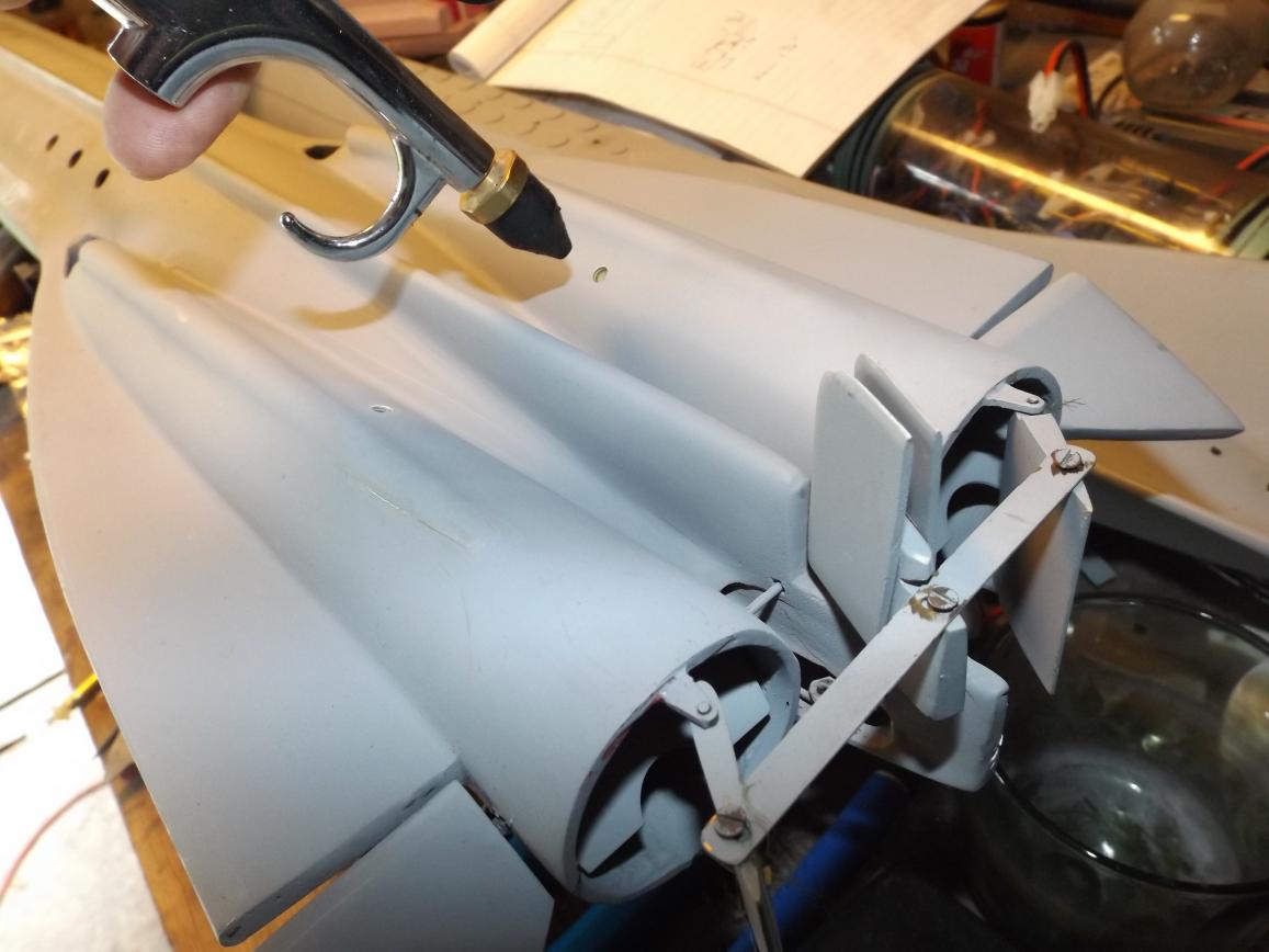

                I did order those motors by the way. Two week lead time. Also I drilled two holes for easy access to the thrust bearings so that I can blow out the water and inject "Blaster" and light weight oil to lube. This of course is on the bottom. In the upcoming test in the kiddie pool ill see how much water is coming out of the holes to determine if I will cover them by some means or not.
                Impellers and thrust bearings in, and covers back in place.Click image for larger version

                        How much difference did the Thrust bearings on the Impellers make? Are you ready for this???? A almost 50% increase was realized in todays test. Not only is that going to make her faster, its also going to help keep the temperature of the motors down. Just to recap a couple of days ago, I installed two new 12 volt motors from Caswell and took the time to break them in first. That situation netted a 15% increase in thrust over the previous 12 volt motors from Caswell that were not broken in.
                        So the original Speed 400 motors and 4 bladed impellers in this thing, from 5 or 6 years ago, gave me 3 ounces of thrust. It moved it but you had to run full throttle to make you feel that you were going somewhere, you know.....like saving the World. At Davids suggestion I cut two blades off the impellers, and that got us up to 4.5 ounces. When I moved up to the 540 twelve volt motors, it put us at 8 ounces of thrust. With the Thrust bearings, we are now at 15 ounces. Not bad. We will run it like this next week and see how she does as well as monitor the temperature of those motors. From there we will decide whether or not to install the new superwind motors that I have coming. I can always put them in the Dual prop Albacore.
