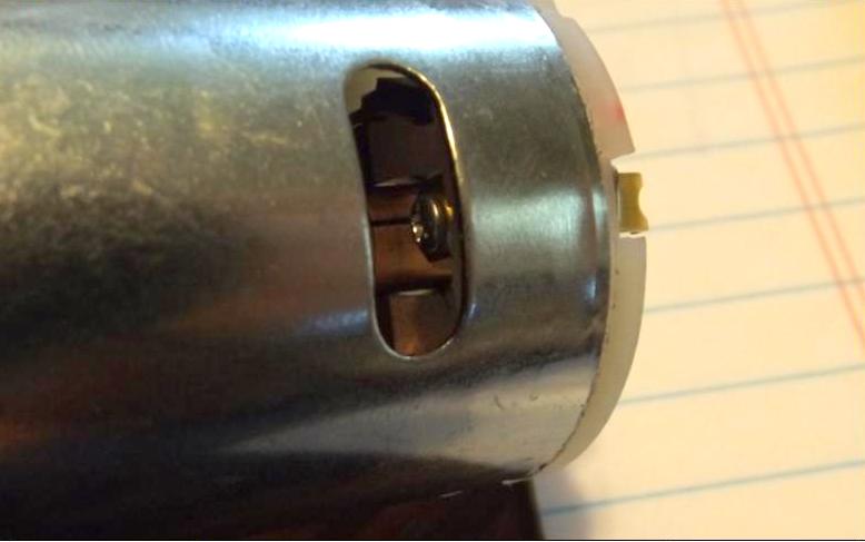

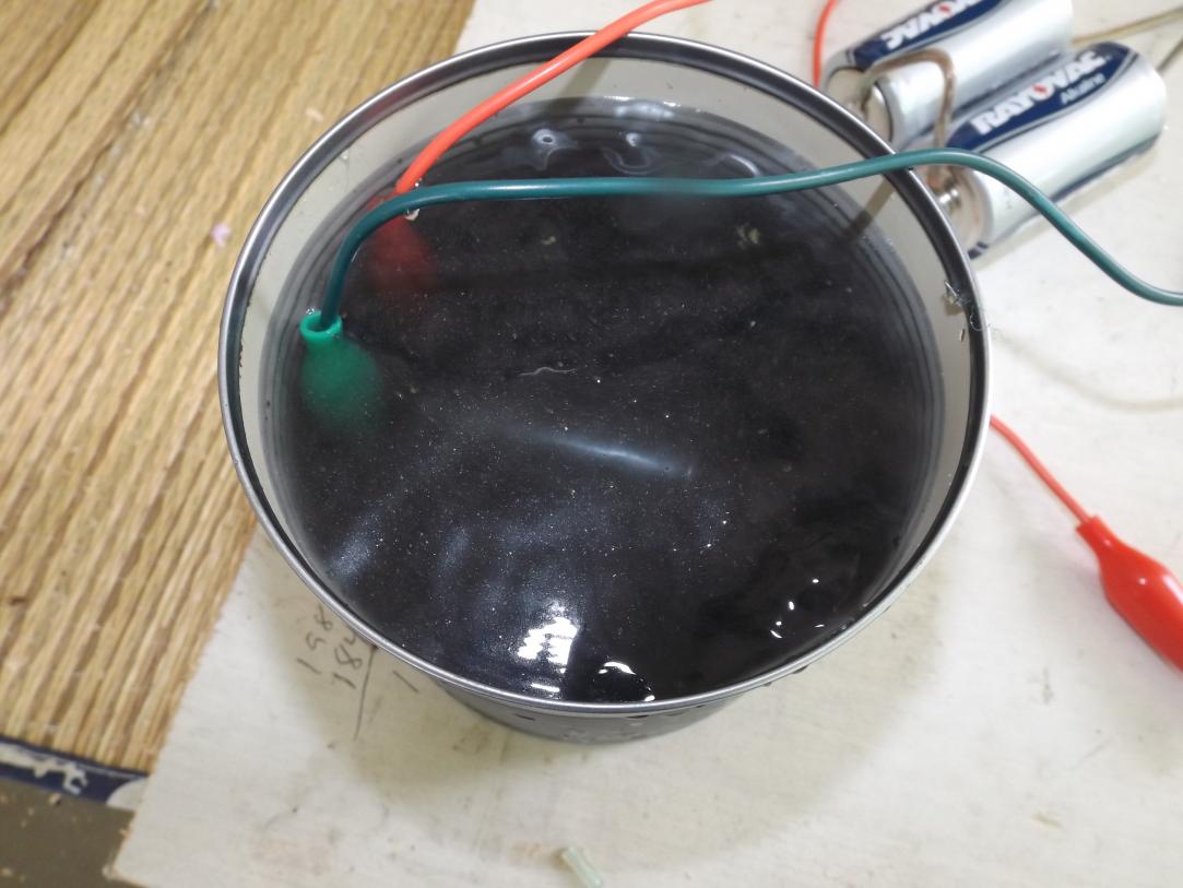

            Way over my head. OK so I took some new 12 volt motors that I got from Caswells and decided to try to break them in a little better. I took two D cells , glued them together and soldered them up in series. Next I took a can of water and dropped the motor in it. Within 2 minutes the water had turned black. I let it run for at least 45 minutes and then blew it out with compressed air. I let it run too long because when I checked the brushes.......they were all gone.
            Ok, so lets not let them run so long. The next two I did the same way except I only let them run for three minutes. That did the trick. Now the brushes appear to fully conform to the commutator. Should see an improvement.Click image for larger version
Name:	Closeup brushes.JPG
ID:	91500 If you look in at the brushes you can see light shining thru between the brushes and the commutator. Not Good. After the break in procedure, that went away.

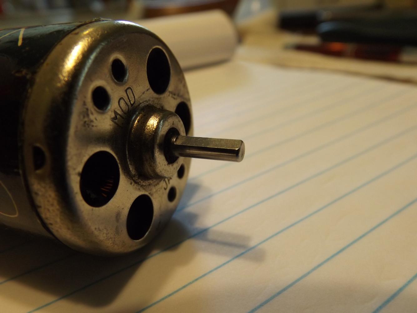

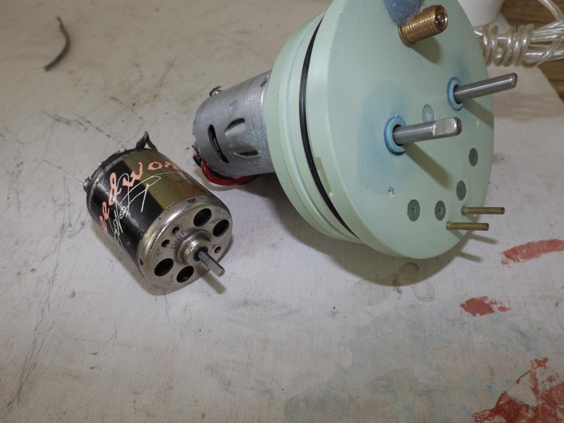

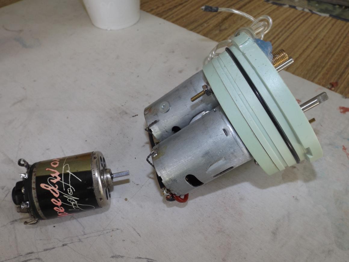

              Also, the aftermarket modified motors, for the most part are not useable in this situation because the shaft is too short and its got a flat running all the way up it so that a shaft seal wont work on it.Click image for larger version
Name:	Fuji transfer 1010.jpg
ID:	91501Click image for larger version

                However, if you use this style 3.5" bulkhead with internal gearing then you can use the aftermarket motors because you dont have to worry about a shaft seal on the motors.Click image for larger version
Name:	Fuji transfer 1019.jpg
ID:	91504Click image for larger version
Name:	Fuji transfer 1021.jpg

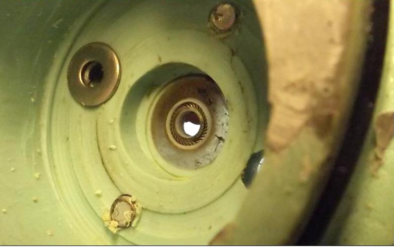

                  Heres a picture from inside of the motor mounting locations that I cut in with hole saw and Forestner bits. Note the spring loaded teflon shaft seal.Click image for larger version

                          By the way, after you break in your motors using this water method, make sure after you blow it out with compressed air, you run and lubricate it . DUH.................

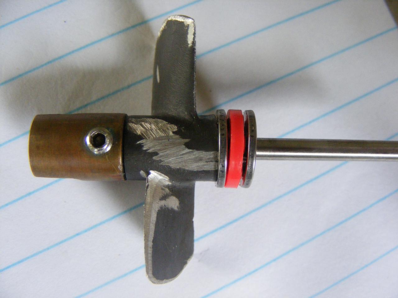

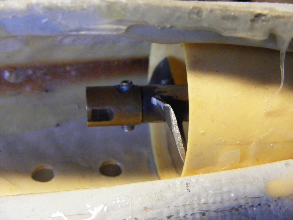

                              OK Dave, what kind of problem is this going to create? By adding a thrust bearing between the impeller and nozzle, it moves the impeller blades forward, partially out of the nozzle. I can cut down the hub but it will only move the impeller back 3/32", not all the way. Is this any big deal?Click image for larger version
Name:	Fuji transfer 1029.jpg
ID:	91514Click image for larger version
Name:	Fuji transfer 1030.jpg

                                #240
                                Good enough. Get to it!
