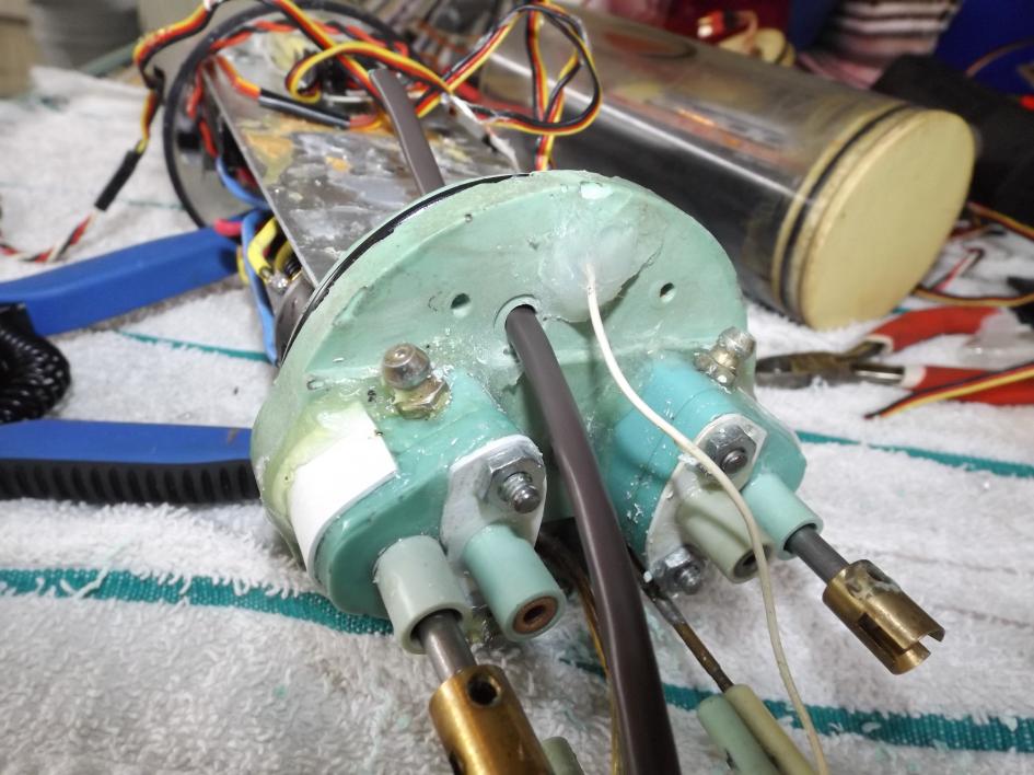

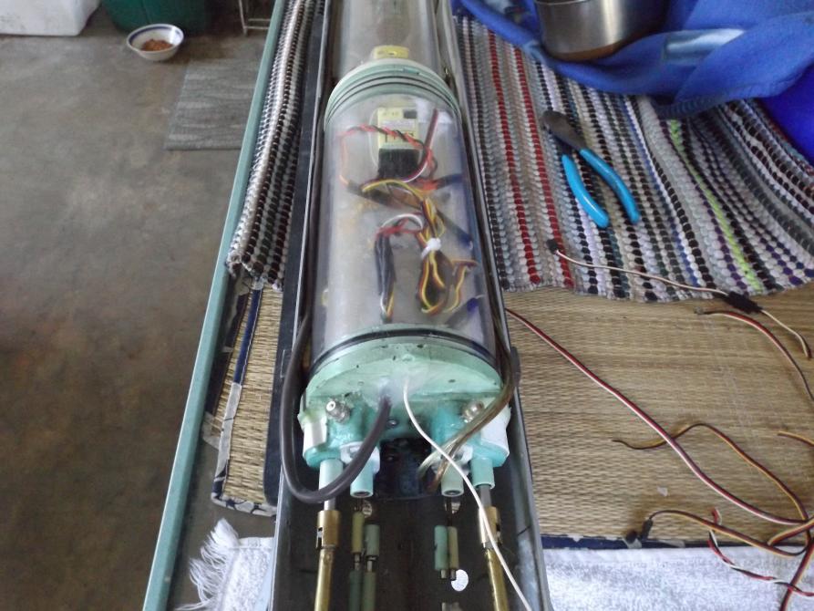

    Just to let you know that im not dead. Coming along on this modification. Im about 3/4 of the way thru it.Click image for larger version

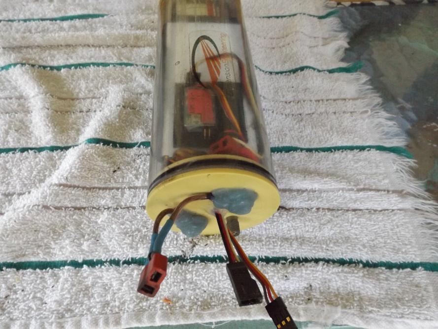

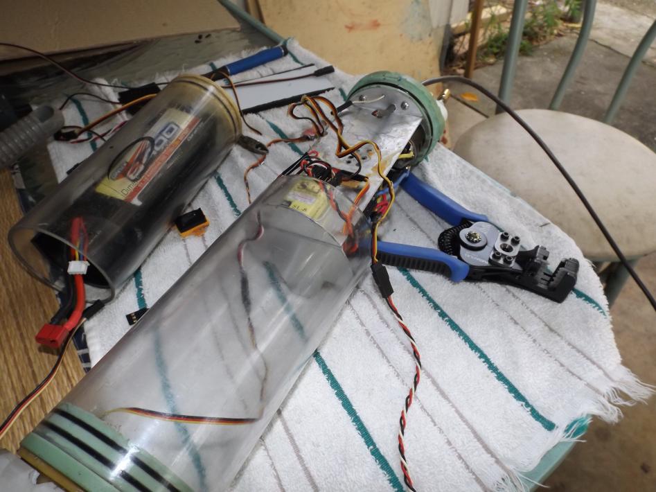

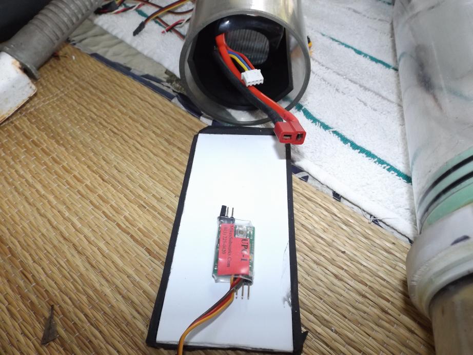

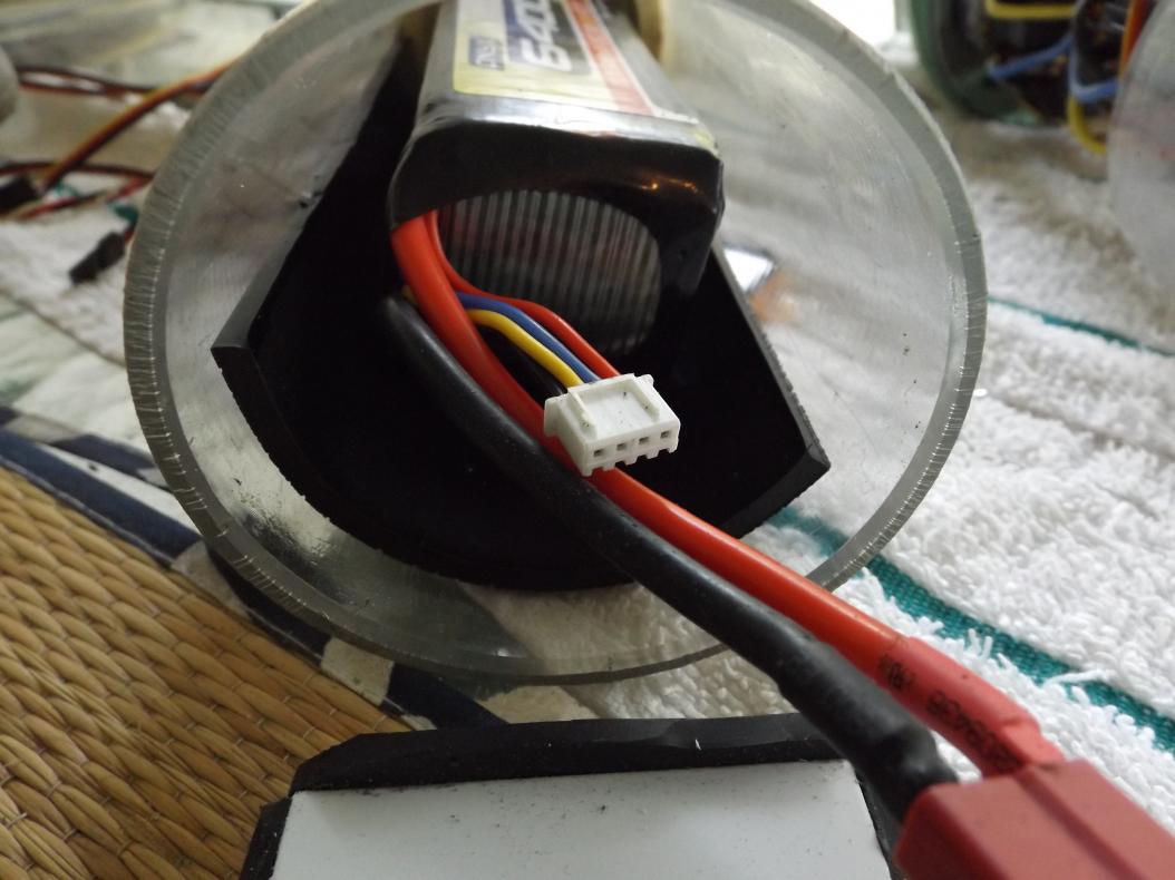

      OK, here we are , all done. Tomorrow we shall test in the kiddie pool. The reason why Im going to all this trouble is because the Seaviews stern planes are connected to the thrust nozzles. If the thrust nozzles are rapidly going up and down, because of APC jitter, then as you can imagine, you are losing a lot of thrust. Its not being directed back away from the sub in a straight line along its axis, but up and down and all around. The potential speed of the boat can never be realized. Plus being able to run and maintain periscope depth will not be possible.Click image for larger version

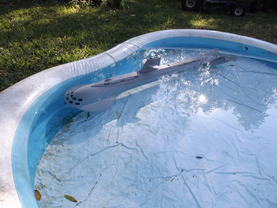

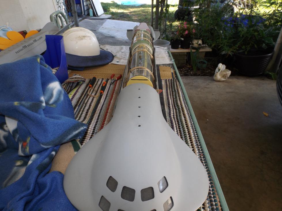

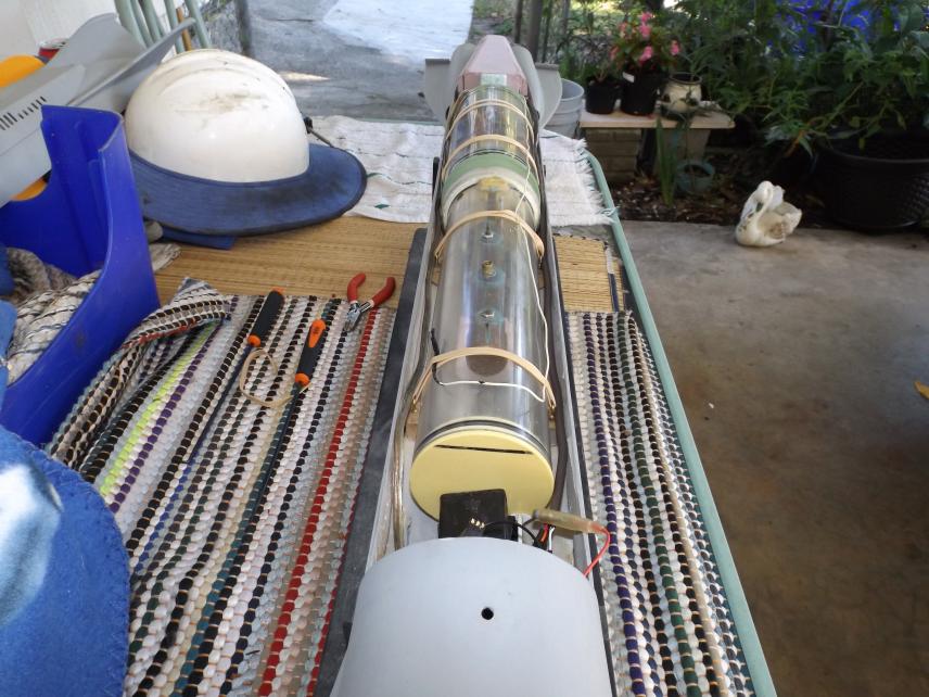

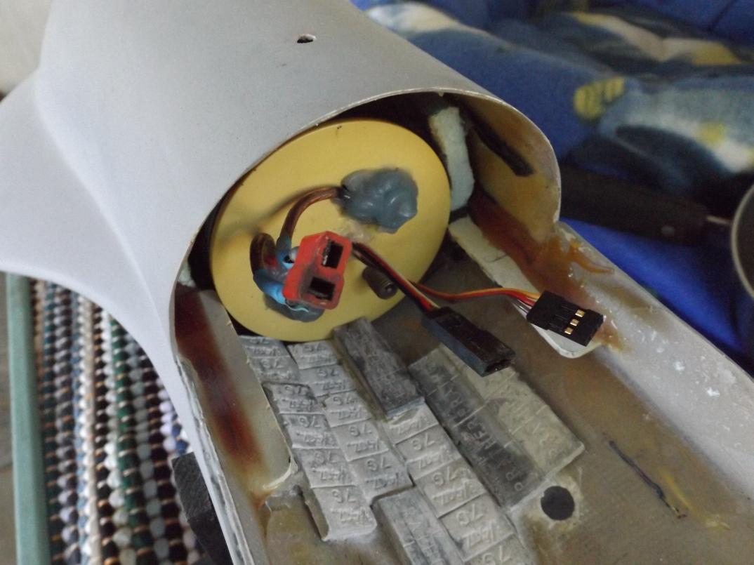

        Ok so in to the kiddie pool. Im happy to say that not a ripple was generated by the stern planes. Steady as a rock. But.....................by adding all that sorbothane inside the battery WTC up in the bow.........shes way too bow heavy. So I am now trying to jam all the foam that I can get into the bow.Click image for larger version

          The removal of all sternplane flutter is quite a feat. I attribute 60% of it to moving the APC away from the source of the vibrations by putting it inside the battery WTC and insulating it with Sorbothane. Using a setting on the APC that is less sensitive to vibrations I attribute 20%. Curious enough that setting was the middle of the three options. Both the least sensitive and the highest setting transmitted too much flutter. The final 20% I attribute to a 3300mfd capacitor plugged into a spare channel on the receiver to tame some unknown mystery noise in the electronics. I wish that you could be here to see this thing. Its as if the APC were not connected at all. And yet it functions perfectly. I dialed in the trim today. Im surprised. I hit the nail on the head the first time. Stay tuned for some open water testing.
            #305
            Howdy all! This new job is taking too much of my time. Not enough time left over for my favorite Hobby. My goal this weekend, among other things is to get the final trim right on this thing. It sits in the water leaning somewhat to the port. I have been moving weight and foam inside of the boat to get things on an even keel. My brother is back down for a visit so I hope to get some operating video of her , soon.

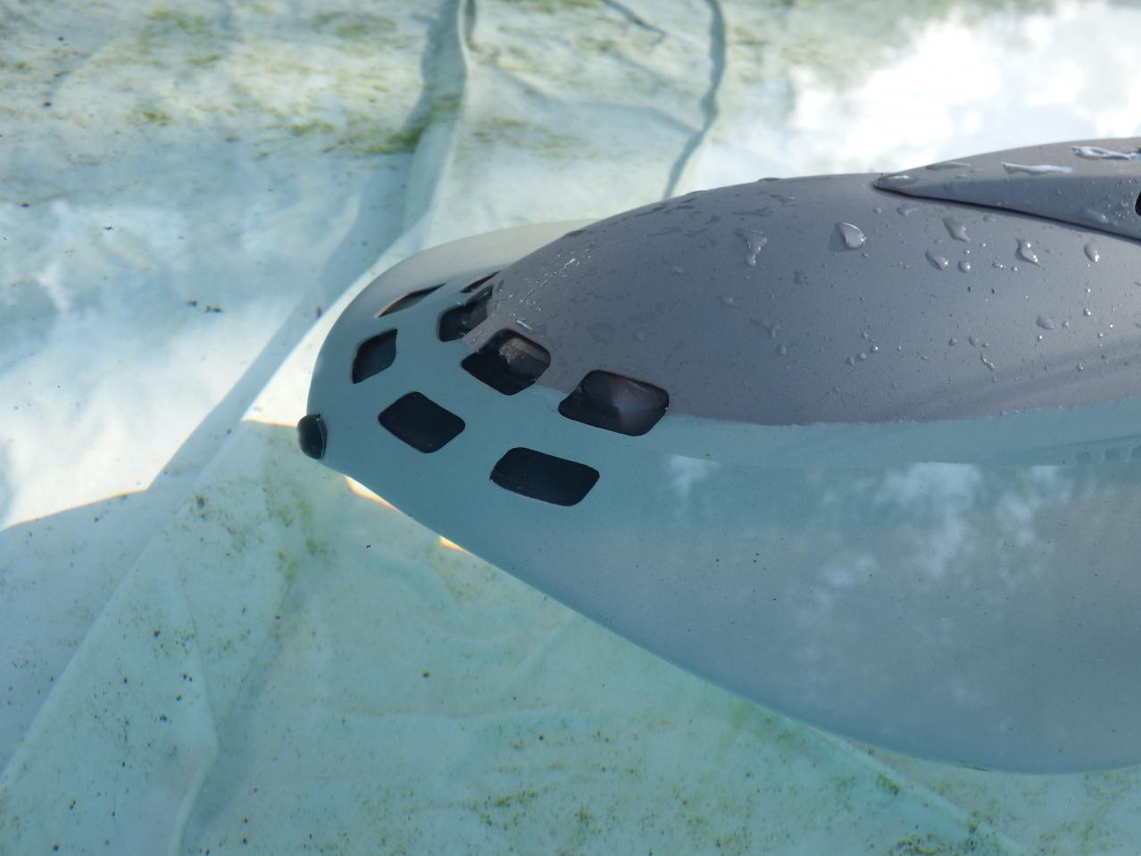

              #306

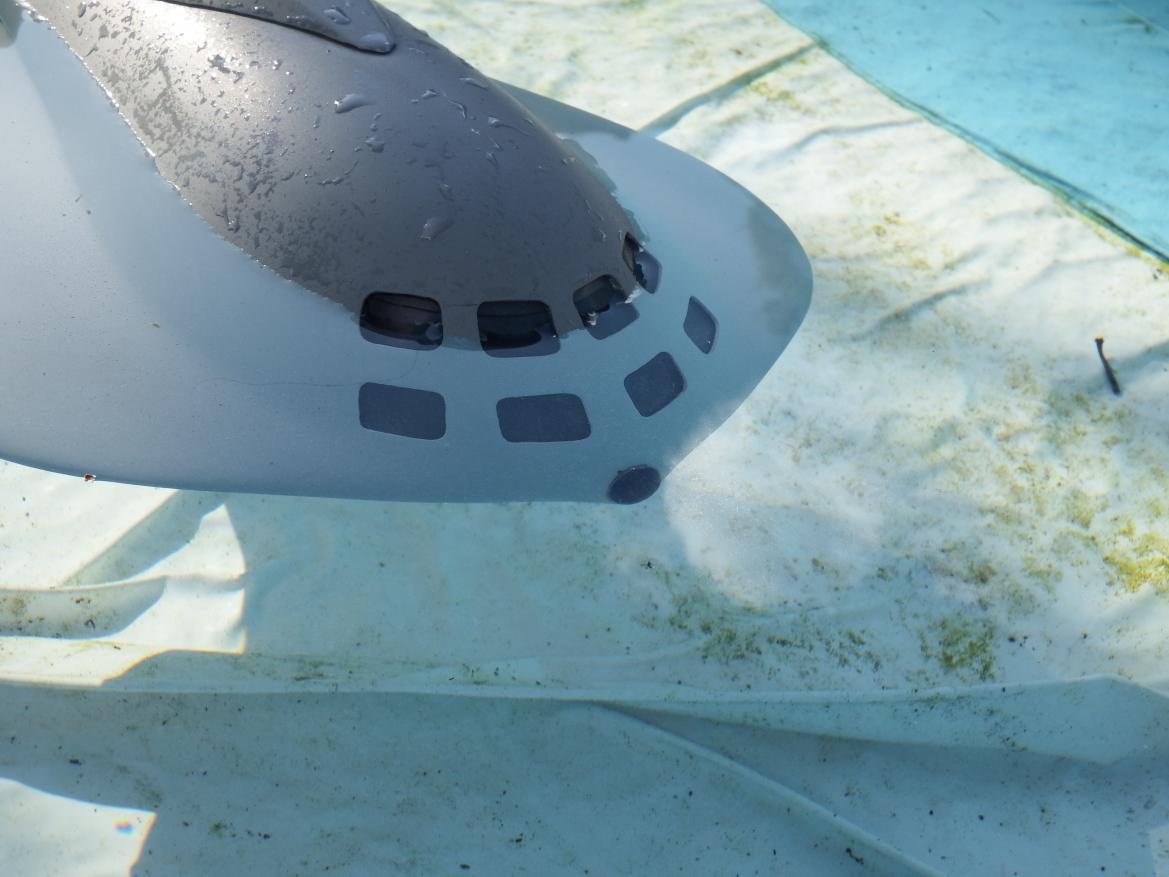

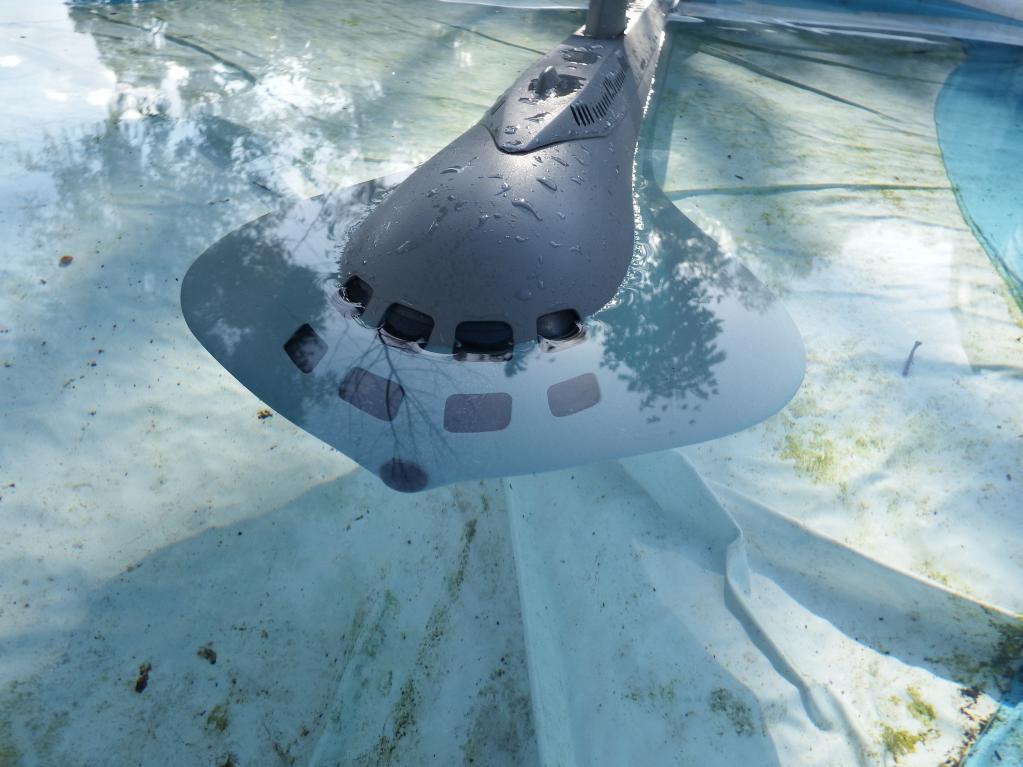

              Ok we got it. It sits right well in the water. As you can tell from the pix. Water line surfaced is roughly midway below the top of the top row of windows. Submerged water line is right under the sail planes. I added a semi circular piece of foam to the front of the battery WTC. Unfortunately you can see it thru the front windows. So I painted it with this(see pix). This paint will not melt the foam like so many others. Being flat black, it should make the foam invisible.
              In a couple of weeks we will have some operational video.

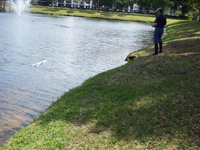

                            Gentlemen, at long last, I have fulfilled my recent promise to get her back into the water. I used to live in Clearwater, only a couple of miles from my favorite Submarine/Duck pond. Well, that has all changed. Since my divorce, I now live in Zephyrhills, about 60 miles away from that pond. So getting all packed up and over there, is not as easy as it used to be. Therefore, I only go once in a while.
                            Todays trip was to test three things:
                            (1) the boats speed with the new motors
                            (2) to test the new ADF mounting system, recently moved up into the seperate WTC that houses the battery. We were looking for much improved periscope depth keeping
                            (3) reduced turning radius due to modifications to the rudders.

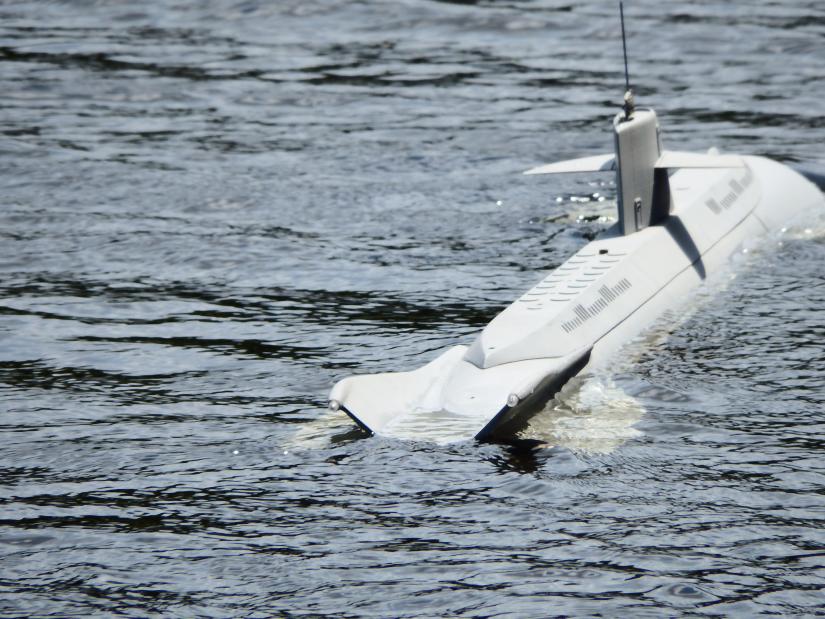

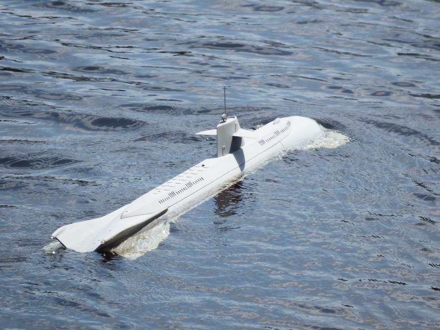

                                How did it go? I am very pleased! First..........speed. She really moves out now. No, its not a Skipjack or a Albacore but it was very impressive. You will see that in some of the videos. As far as the ability to set her depth, she stays put right where I set it. No up and down garbage. My right joystick on the radio is detented on ch.2, the one I use for the dive planes. Just one click and it moves a proportional amount. I can set the control so that the base of the periscope is visible. Just one click down and the middle of the scope is visible.One more click and the scope just barely disappears. In my view this is excellent control. And the best part is.....set it and forget it. Except in the turns. When you take a turn when submerged, it wants to dive, so you have to haul back on the ch.2 stick to keep it in sight.
                                As far as reduced radius, yes ,it is much tighter. So here are a few shots from the outing. Ive got quite a few videos to go thru and get them up on Youtube, before I can post them.
