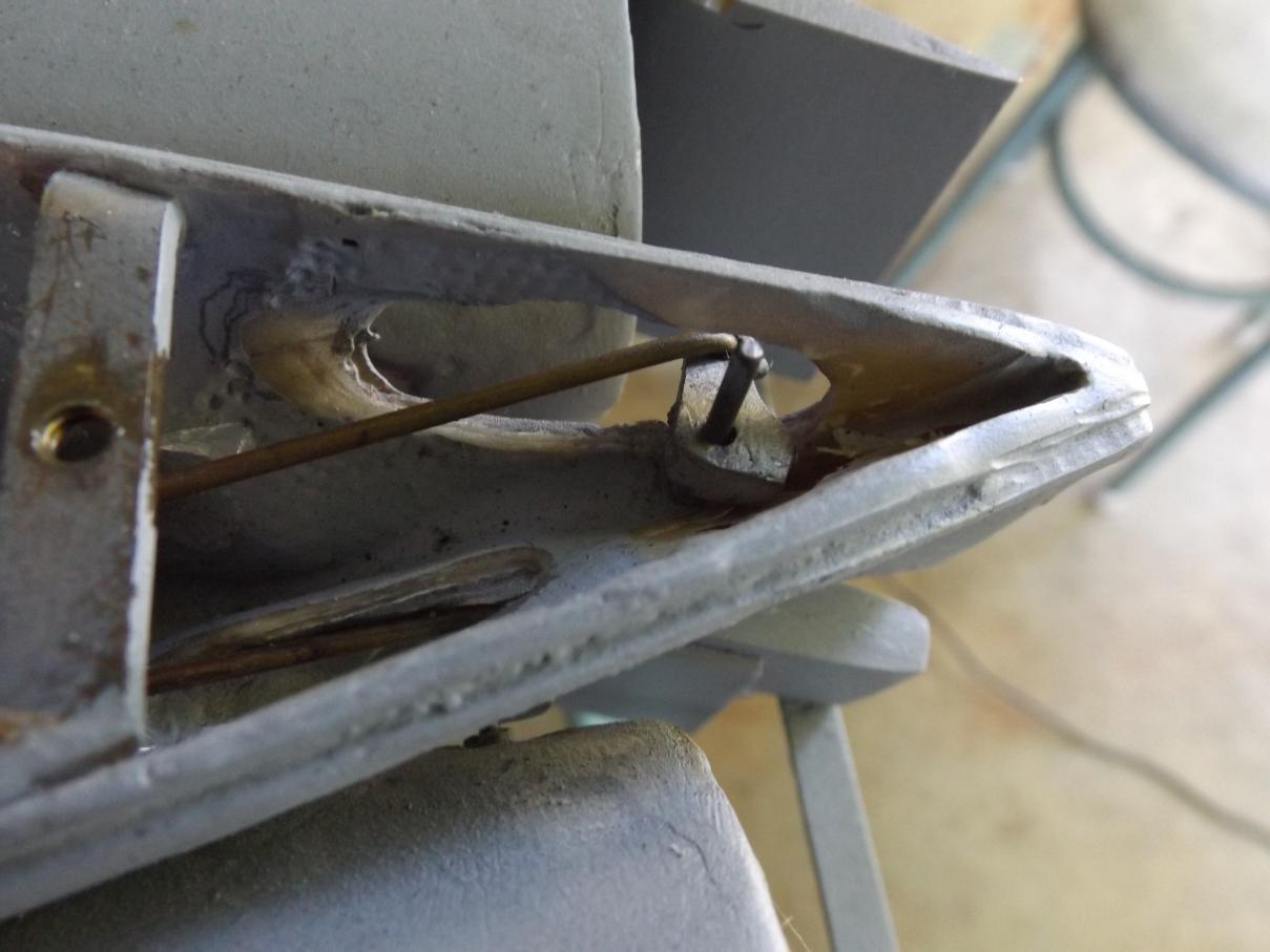

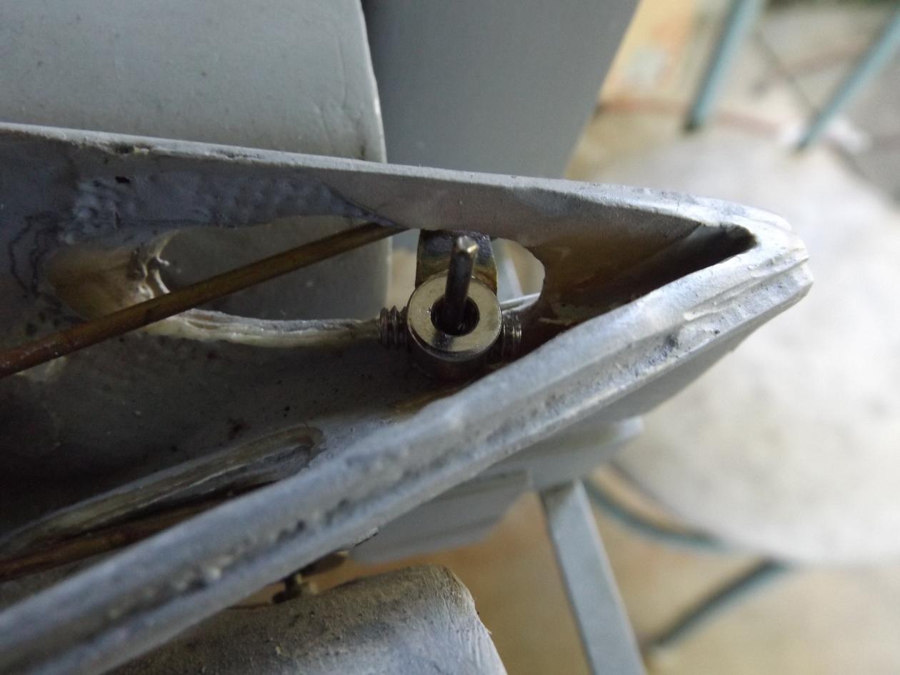

      I got the sorbothane sheet ordered. Does that count for anything? Ill have the new "greased" gearboxes in tomorrow and be ready for a "Kiddie pool test" on Sunday. Im going to have to make a new rudder tiller arm as the old white metal one wont hold anymore. Ill make it out of a small Dubro locking collar and add two set screws and solder on a brass arm for pushrod attachment. Thatll fix er. The rudder axle is 1/16" brass wire.

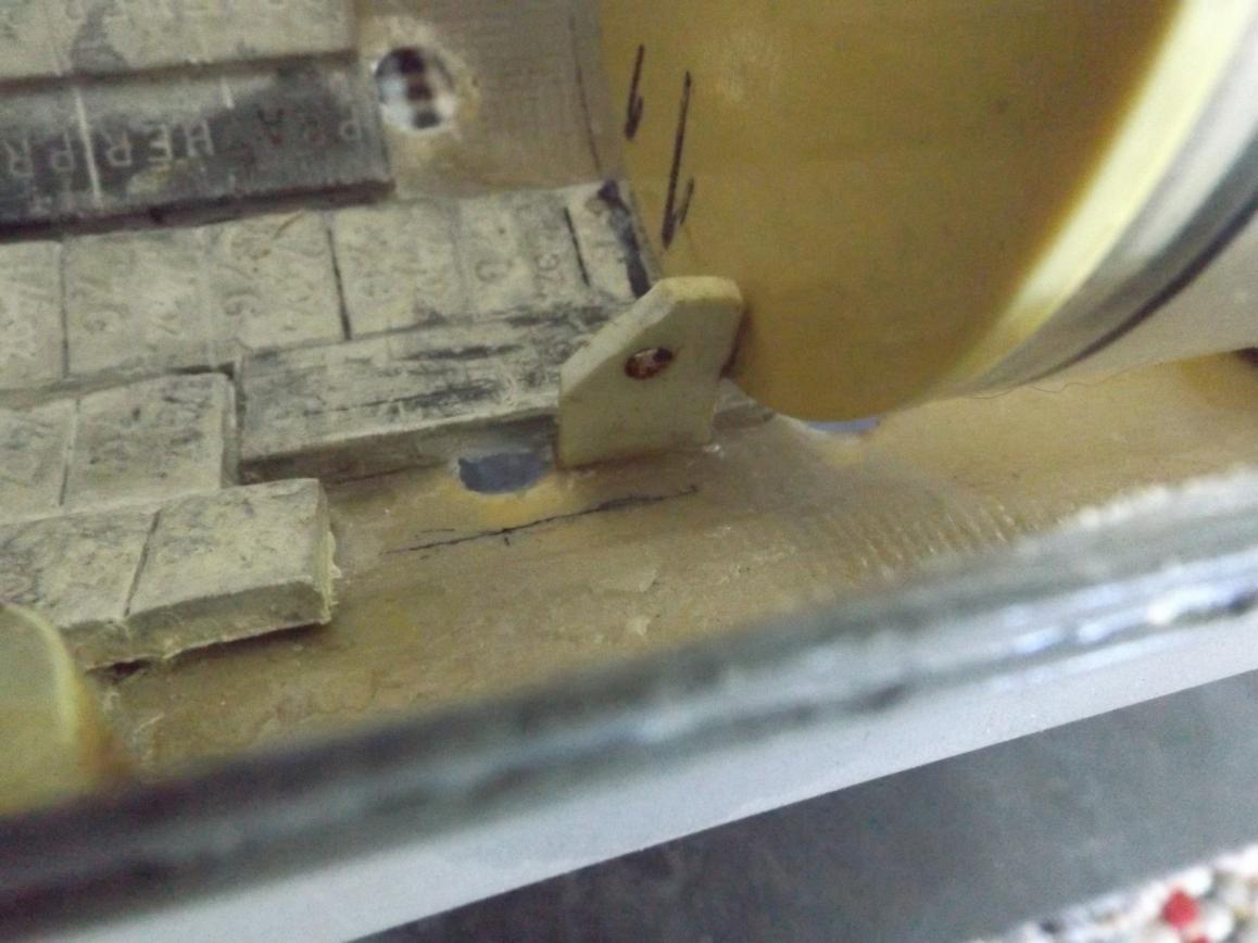

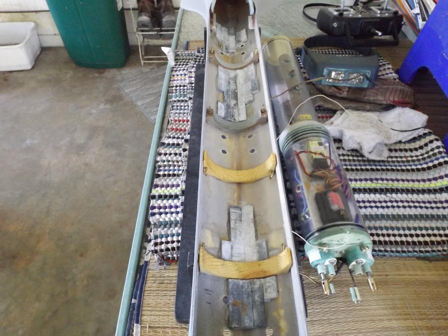

                              Yeah, this new job is taking some getting used to. By the time I get home, Im too tired to do anything. Well, today I did get a few things done. I installed the seals on the drive shafts and the motor shafts. The seals on the motor shafts I put on backwards because the shafts were too short to extend all the way thru the seal body. It doesnt matter though, all I want it on there for is to keep the grease inside the gearbox proper. I also installed the new home made rudder bellcrank. Also a positive block in front of the WTC to keep it from moving forward.
                              Im making up another rudder extension to give me greater maneuverability. Im still not happy with the APC/dive plane jitters. Next time out Ill see if its any better. If not, Ill disconnect the APC and drive it that way. If Im not happy with that Ill proceed with my plans to install the APC up front in the battery WTC. In the pictures youll notice how much weight I have installed in the bottom of the hull. Its there to keep it stable. Anything less and the sub trys to turn on its side under any kind of throttle. Keep in mind this thing doesnt have counter-rotation.Click image for larger version
