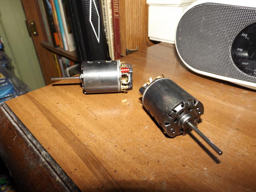

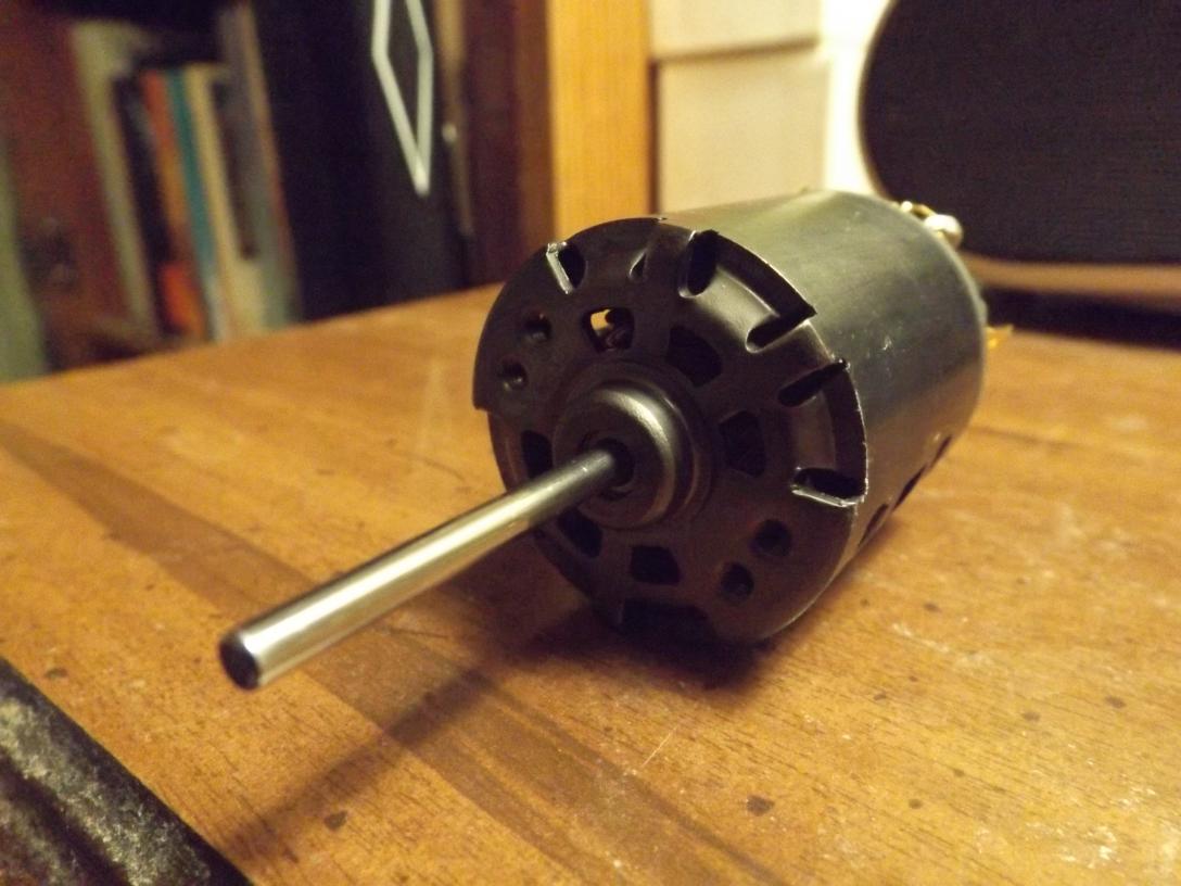

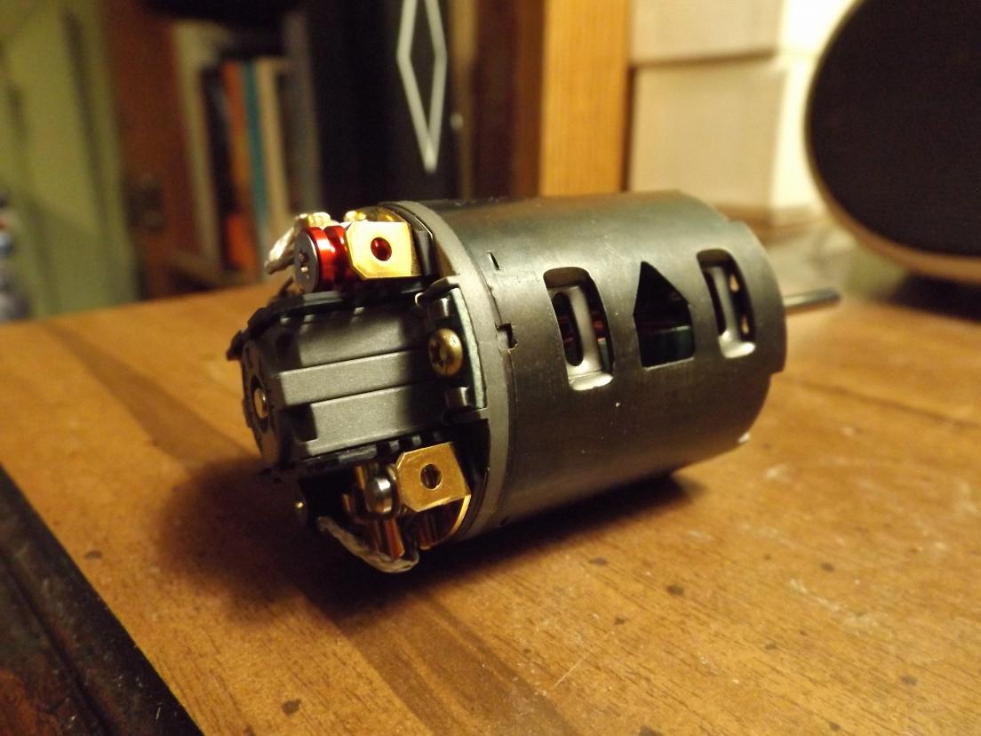

          GUESS WHAT I GOT???!!! My two custom wind motors. Designed specifically for my Application. 27 turn, long shaft(1")super magnetized, extreme heat resistant, stand up heat resistant brushes.
          However, it seems to me that if you run anything wide open for too long its going to get hot. My next step will be to use the existing Caswell 12 volt motors as they are and change the empellors to the 4 bladed ones. If I can generate some more speed then we can afford to chop the throttles and run at a lower throttle setting. Then we can see if we can keep the motors from overheating.http://www.teambrood.com/store/home.php Eddie does nice work and he keeps in touch during the process with continual updates.

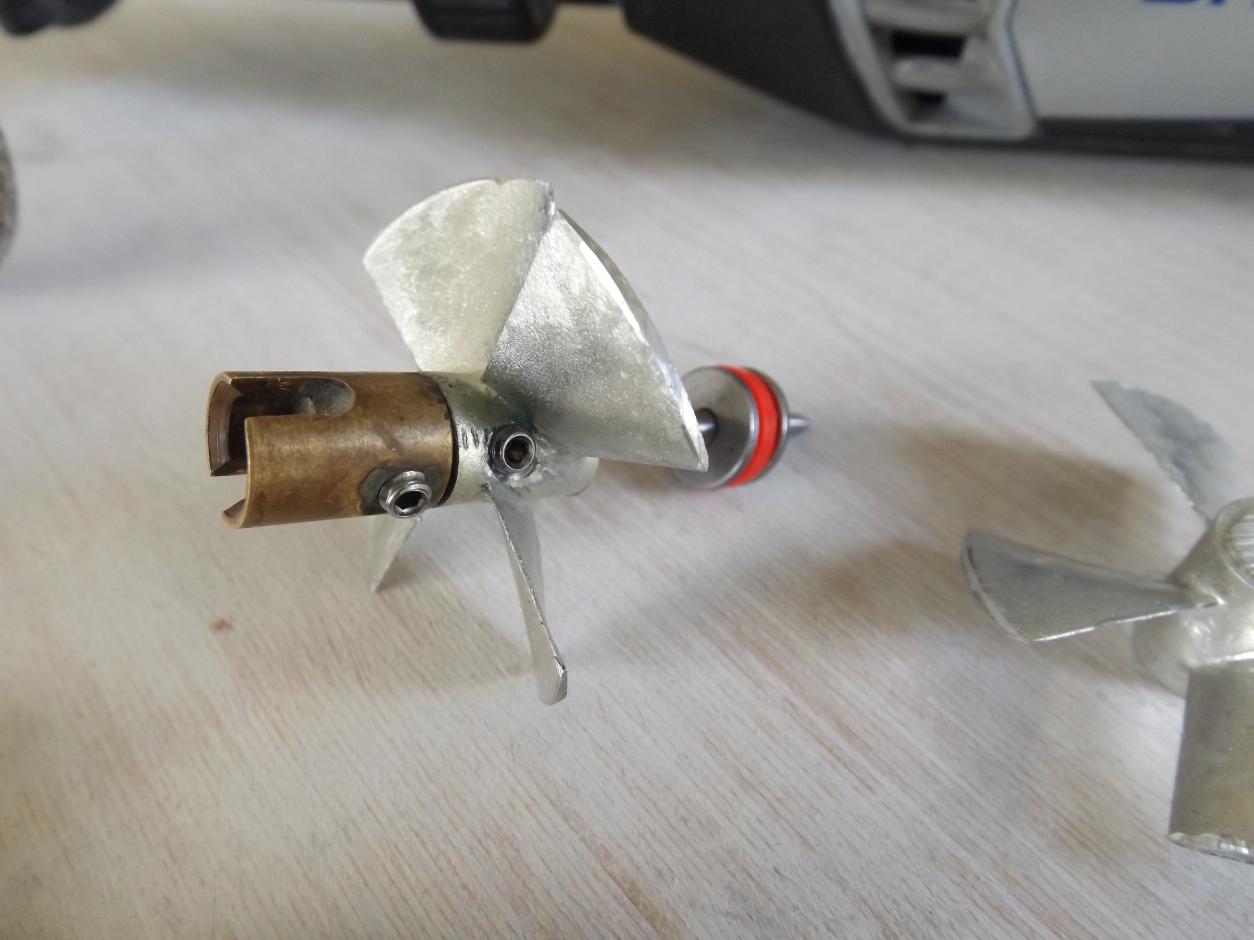

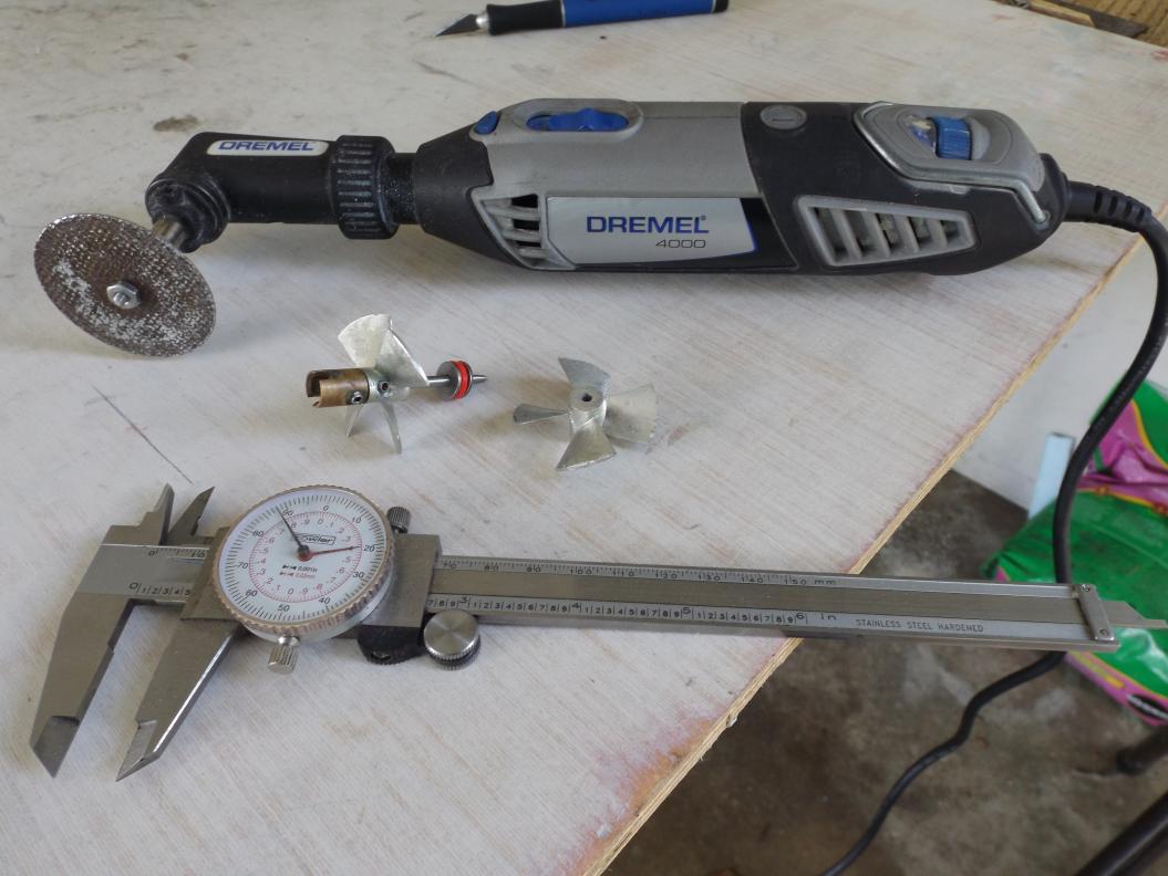

              Gentlemen................and I use the term ...........loosely. The next phase was to remove the two bladed empellers and install 4 bladed ones. These are nice bits Dave sent me. What a nice guy! They were, however, larger in diameter and the hub length also was longer, so a bit of backyard machine work was called for. At anyrate....they are going in as we speak. I hope to get a test in this weekend. Im looking for improved thrust numbers. This will tell me that(using the existing motors) the thrust numbers of previous, were limited by RPM capability of the motors@3 to 1 gear ratio and not solely dictated by the motors torque limitations. So the question will remain....Can these motors produce the thrust that I need at a reduced RPM, without overheating? At that point I will know whether or not to upgrade the motors or leave them as they are. Cheerio!Click image for larger version

                make sure the curved face of the blades point forward.
                  #263
                  Yep....Gotcha. This camera angle distorts the view. Its right as is.

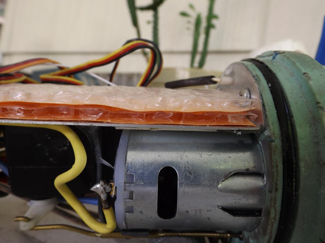

                        In order to install the new APC, as has been my recent custom, I put down some bubble wrap first, to try to reduce vibration feedback to the APC. I found out that silicone seal dissolves the bubble wrap into a very hard substance that will Cut you, if you are not careful. That will also transfer vibration, instead of cancel it out, so we dont want that. So, instead of using silicone this time, Im using this stuff(see picture). So , I cut two pieces of bubble wrap and installed them, one on top of the other, and glued them down. Now for the Apc, right on top of this mess.Click image for larger version

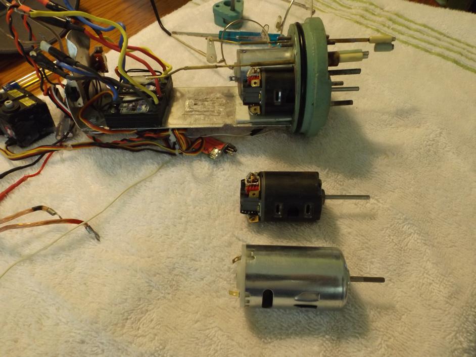

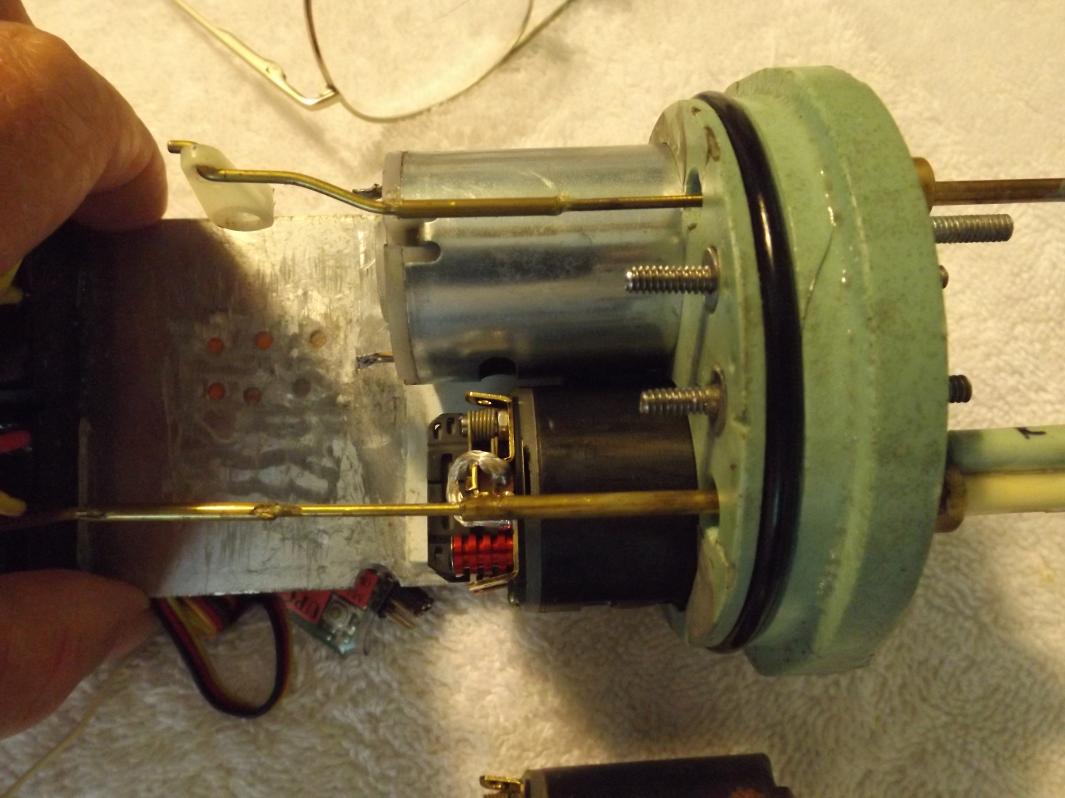

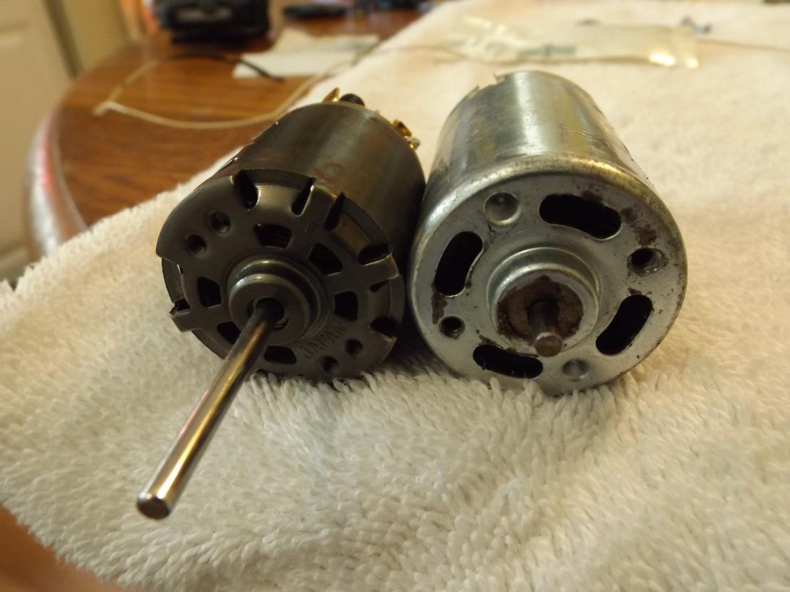

                            KO......I mean OK. Tearing it apart again and installing the new motors. The motors req. a 3mm screw. I didnt have any so I used 6/32 last time......I think. At anyrate last time I re threaded the motor screw holes with a tap. I didnt want to do that this time so I was on a hunt for 3mmx.5mmx10mm countersink head screws. No go at Lowes or homey depot so I had to order some good ones. 316 S.S. from Mcmaster&carr. Take a couple of days. Anyway here are a few shots. The armatures are definitely shorter on these 540s compared to the 550s.Click image for larger version

                              A little here and there. To get the old motors out I have to cut the shaft. This because the brass gears are "sleeve retained" onto the shaft and the only way to get them off is to heat them up. That would ruin my high tech shaft seals. So I cut the shafts just behind the gear, then pull out the motors after de-burring the shaft left sticking out of the motor. Then a propane torch on the gears will cause the epoxy to release. Then, just a matter of cleaning out the old hole and re-sleeve retaining the gears back on. I hit the new motor shafts with the edge of a Dremel blade to rough it up, preceding the application of the Permatex stuff. Works great. I still dont know if the 20 amp Mtronics ESCs will handle the new motors now that I have 4 bladed empellors in place. We may be looking at making a swap. Ive got two 40 amp Jomars on standby. If I dont need them they will go into the Portofino, thats in drydock awaiting modifications.
