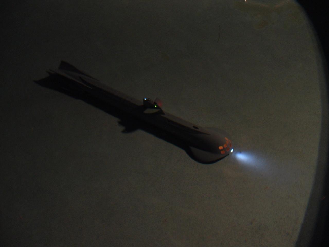

    Heres an old one in the pool , testing out the lights.

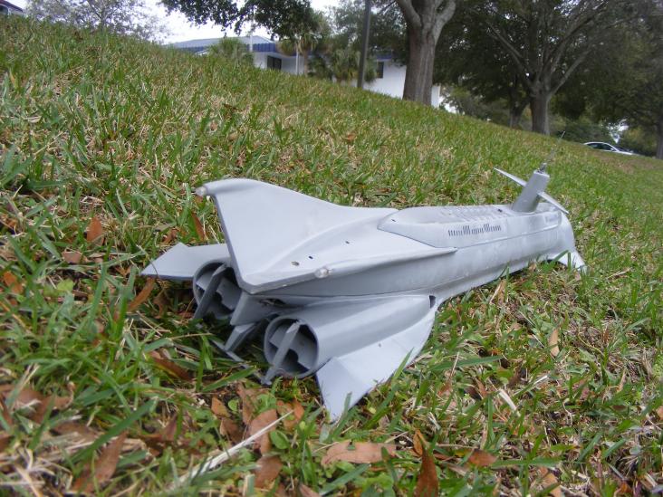

                        Tommorow, I have an appointment with the Seaview at the pond. I want to operate it as is so that I can see the present state of affairs before the modifacations commence.
                          #117

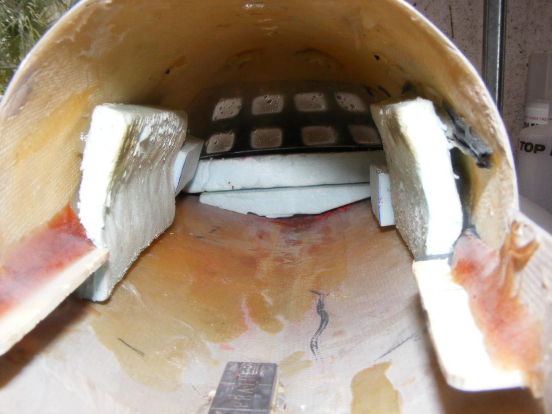

                          After running the Seaview the other day, it occured to me that , with some reconfiguration of weight and foam I could probably realize some more freeboard and thus it will float higher in the water. So that has been some of my focus today. I gutted the forward section and packed her with some more foam. I had determined at the pond how much more I would need, front and rear. It should be real close. Also at the pond the port side ESC refused to work, You see Murphys Law kicks in and allows me to drive 60 miles, and then find out it doesnt want to work. It worked fine the night before. Oh well, it gave me an excuse to go by "Lovins" and get some WINGS. So I had a spare ESC that I am installing. So the goal is to get back to the pond on Monday, along with the Scamper for more tests.

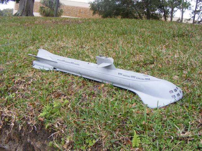

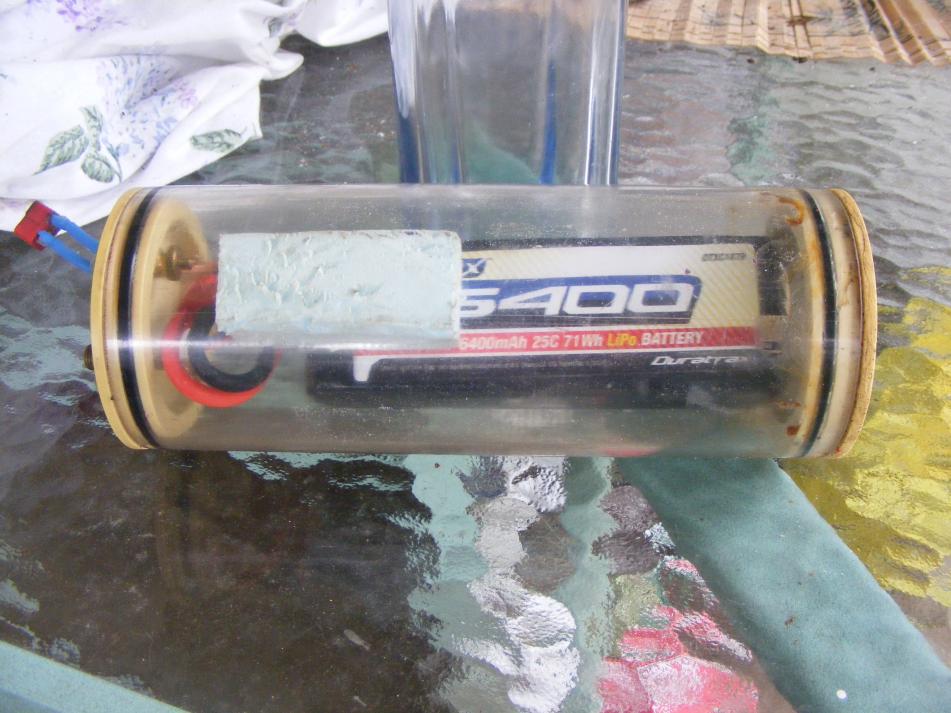

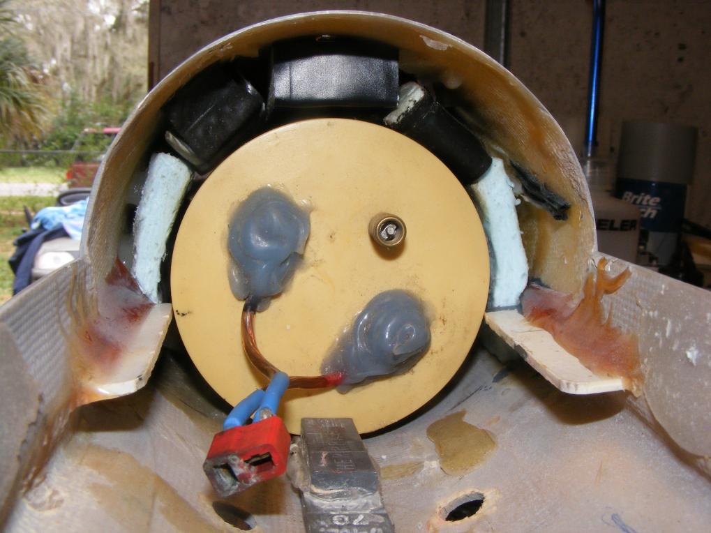

Name:	Fuji transfer 162.jpg
ID:	89877Click image for larger version
Name:	Fuji transfer 164.jpg
ID:	89878Click image for larger version
Name:	Fuji transfer 167.jpg
ID:	89879Click image for larger version
Name:	Fuji transfer 170.jpg
ID:	89880 Notice that the stern is packed full of foam. Thats no easy trick. Also, the Battery WTC for the LIPO. I realized a tremendous advantage by using it. I am able to do this because the three inch Subdriver has a huge ballast tank on the order of almost 12" long.

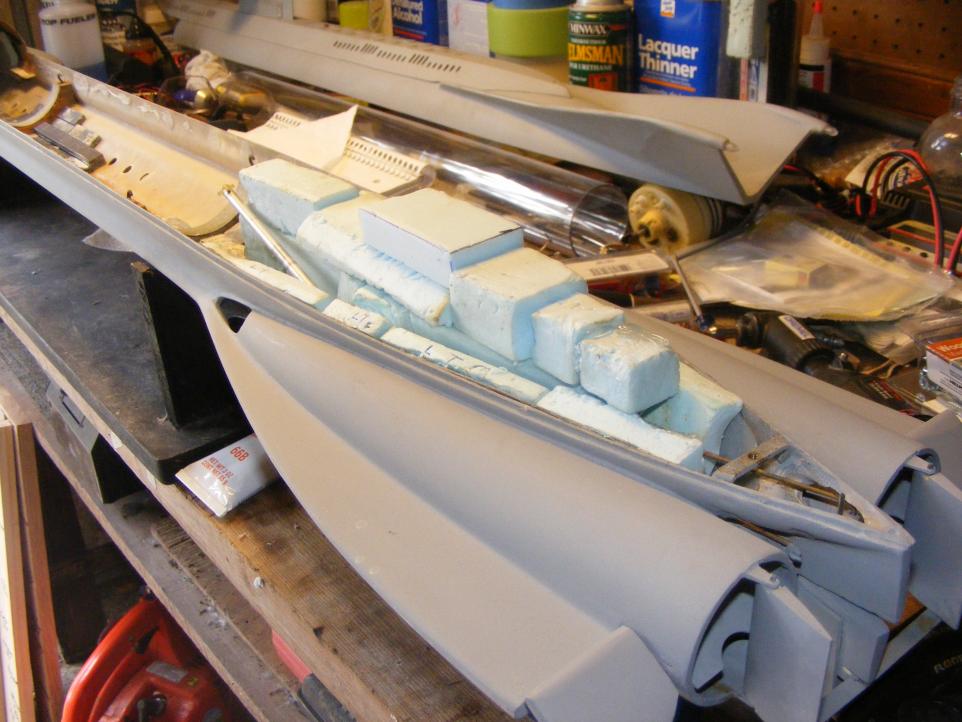

                            #118
Name:	Fuji transfer 157.jpg
ID:	89881Click image for larger version
Name:	Fuji transfer 158.jpg
ID:	89882Click image for larger version
Name:	Fuji transfer 159.jpg
ID:	89883Click image for larger version
Name:	Fuji transfer 160.jpg

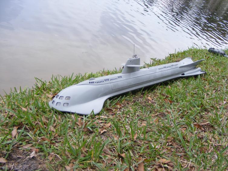

                              #119
                              Got her into the water today and drove up and down the lake three or four times, submerged(DUH). I found out what I needed to know. I can now order my 3&1/2" tube and start preparing my motor bulkhead and equipment tray. This things got a lot of drag. Each of those eight windows is recessed. In other words, there is a piece of clear lexan behind those window openings. Therefore as the water hits the bow it goes into those windows and is then forced back out, spilling out over the edges, therefore, unwanted drag. I could take out the flat lexan but , having it in makes it look more real. So we need more ponys to push this thing, thus the 3&1/2" motor bulkhead and its 540 motors. The 400s in the 3", just wont cut it.
