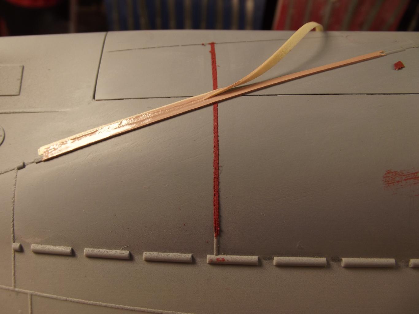

          You might try thin strips of tape to represent the welds. When you paint the hull the tape will show up as a raised line. If you're not happy with the look you can always sand off the tape. Might be worth a try.
          SSBN659
            #110
            SSBN659
            Thanks for the idea. I use Baking Soda and CA. I am not too worried about the details, I will recreate them.
              #111
              May I suggest styrene half round stock.
                #112
                I have half round stock, some will bath it with liquid glue and put a texture in it. I am not going to discount any of the ideas until I get to the point when the details can be added back.

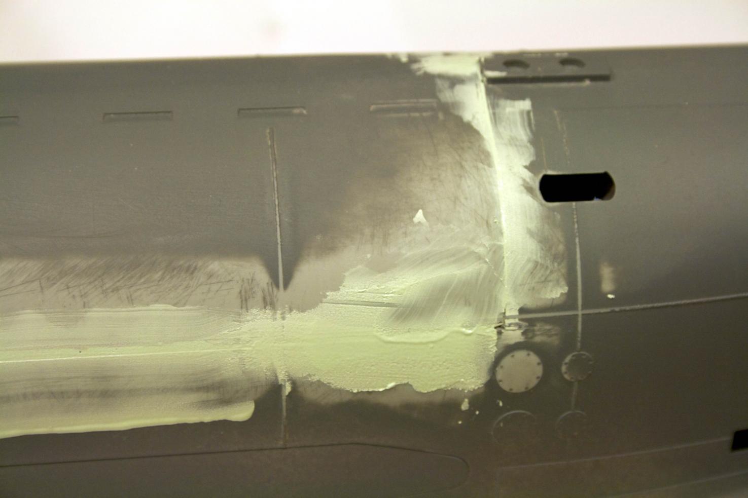

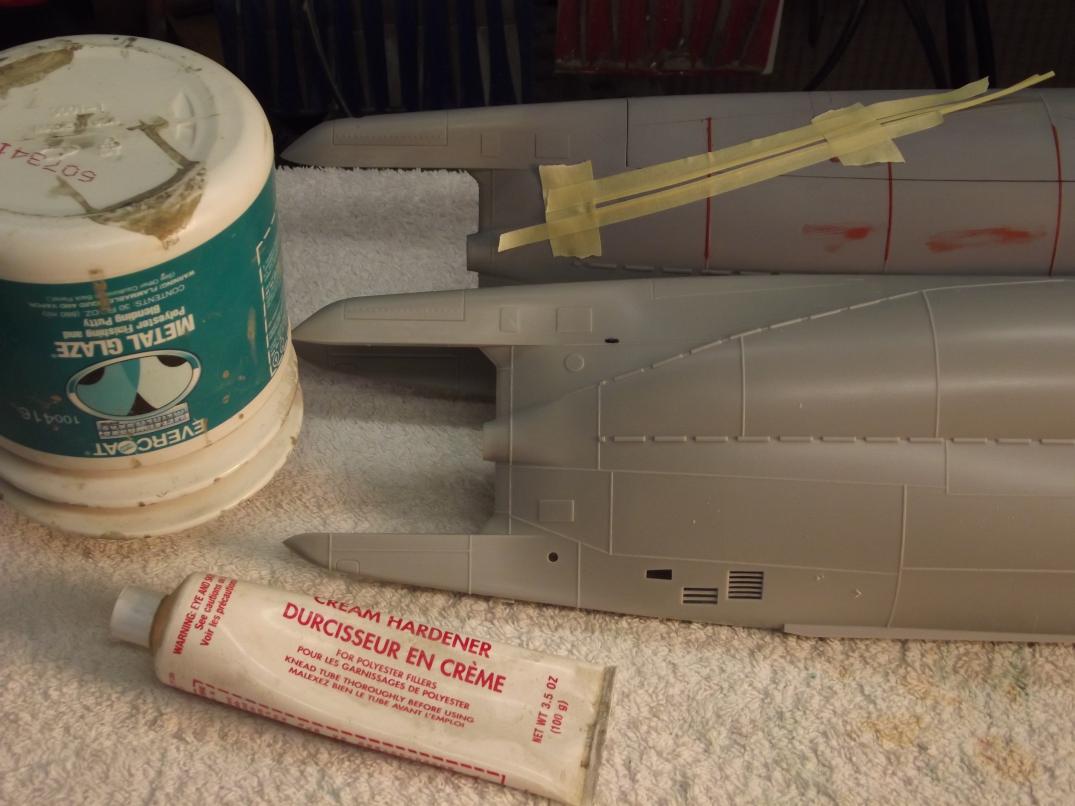

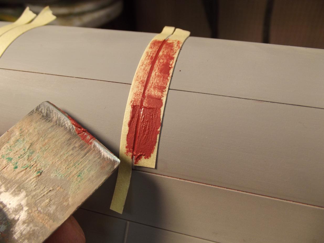

                    Worth remembering that a weld bead on a hull is likely to only be about an inch wide (prepares to be corrected), so thats going to be 1/32 inch on this model boat. Dont overkill the lines.
                    On my Koryu i sprayed some paint into a pot, allowed it evaporate for a while, then daubed the gloopy paint mix onto the hull, after similar masking tape tracks were made

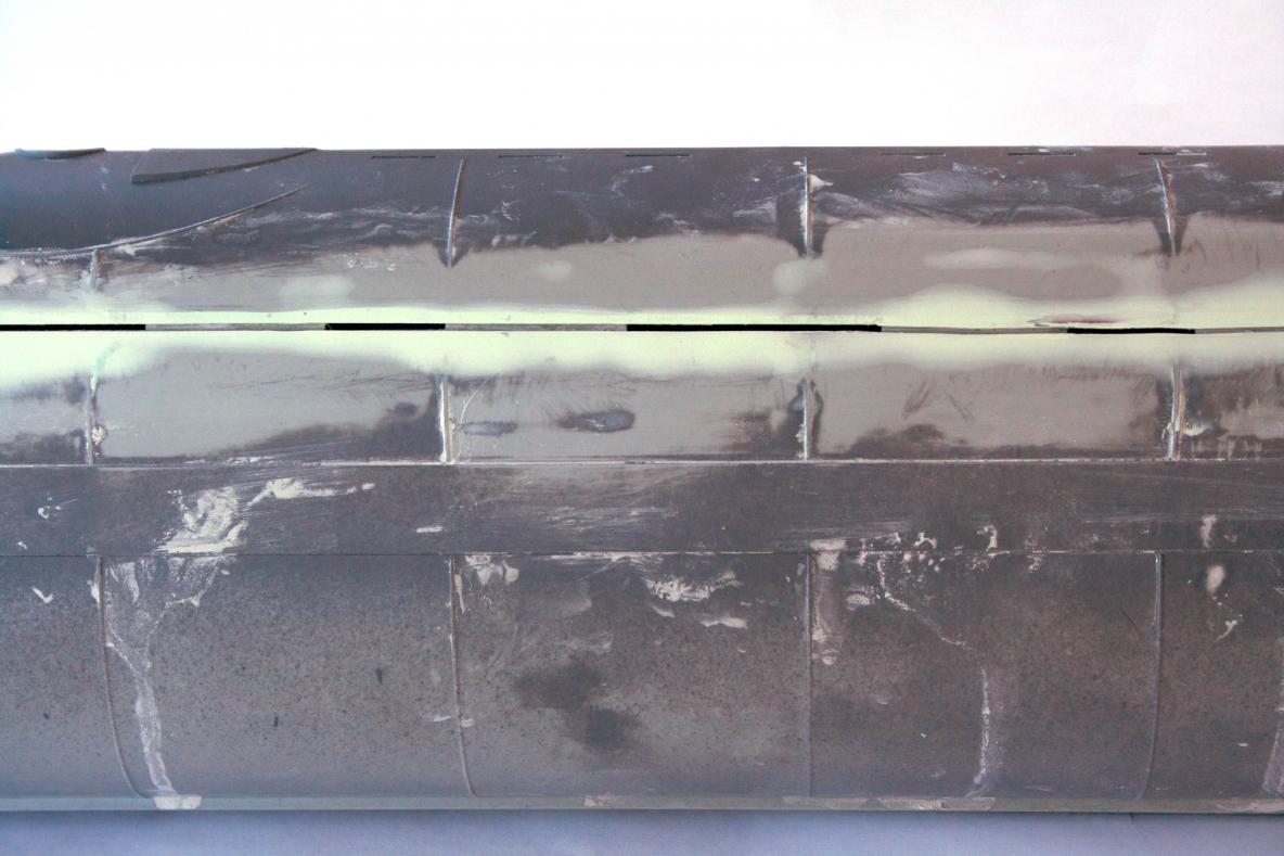

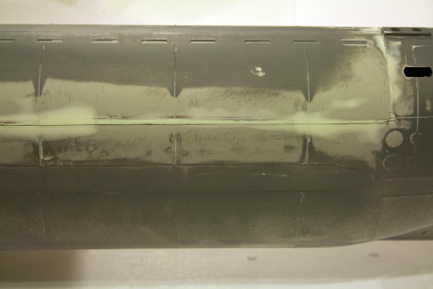

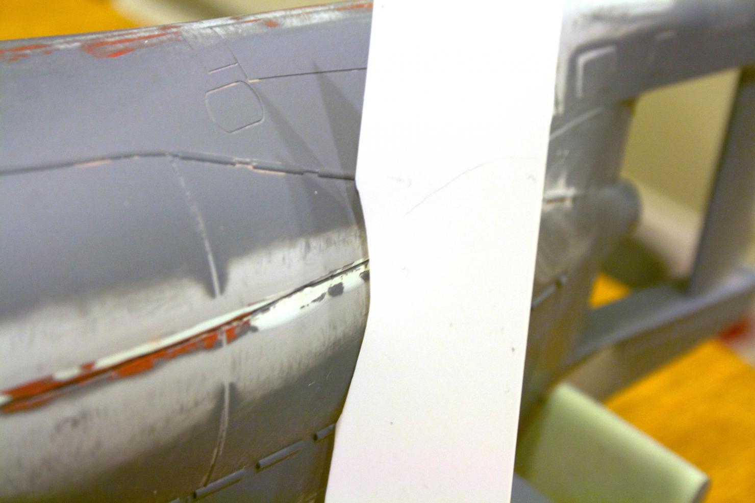

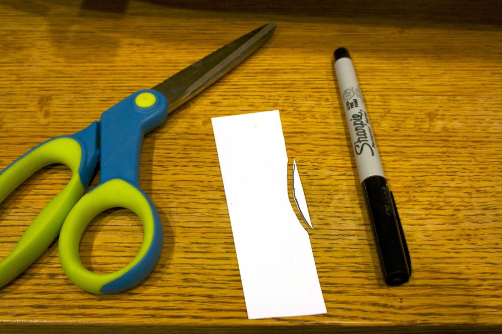

                      Made a screed for the hull by holding the plastic card perpendicular to the hull, laid the pen against the hull and drew the hull's profile along it. Then cut it out.
Name:	Bronco Type 23_235.jpg
                      Checked the shape against the hull and it fit very nicely. The aft end fit with a slight downward shift in the screed.
Name:	Bronco Type 23_236.jpg
ID:	89694Click image for larger version
Name:	Bronco Type 23_237.jpg
                      For the most part it went on smoothly.
Name:	Bronco Type 23_238.jpg

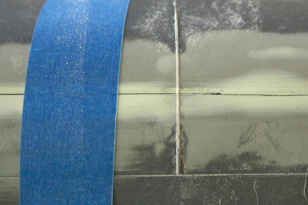

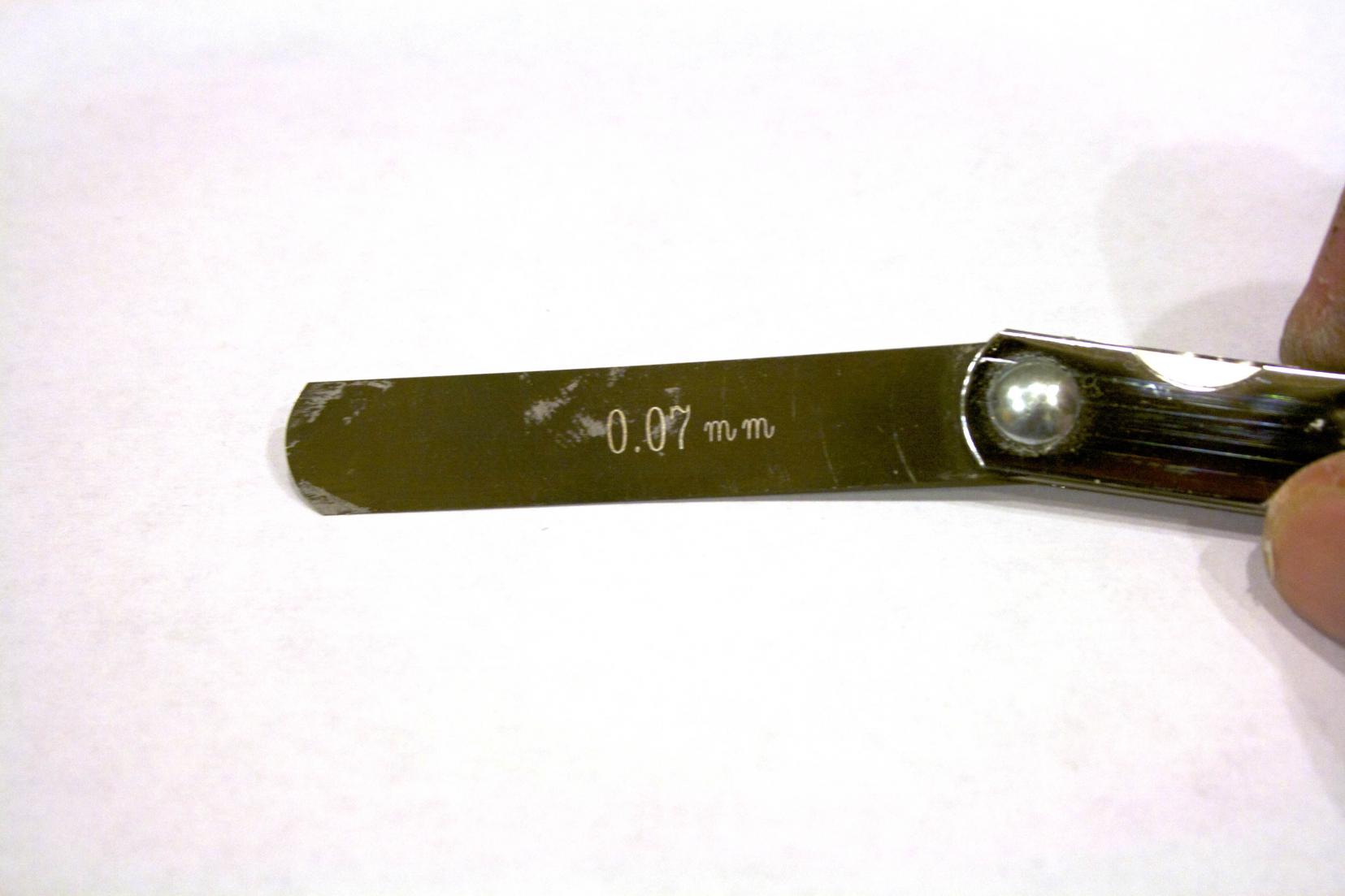

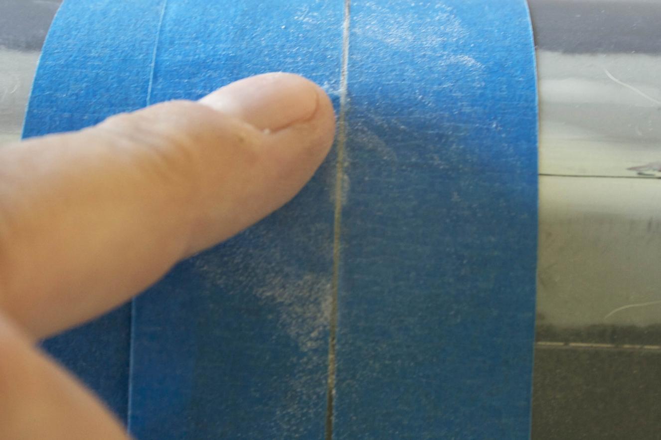

                      Then I ran a feeler gauge through the setting resin, it is a .07mm, for the seam.
Name:	Bronco Type 23_239.jpg
                      It made a really nice thin line.
Name:	Bronco Type 23_240.jpg

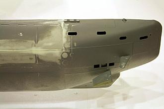

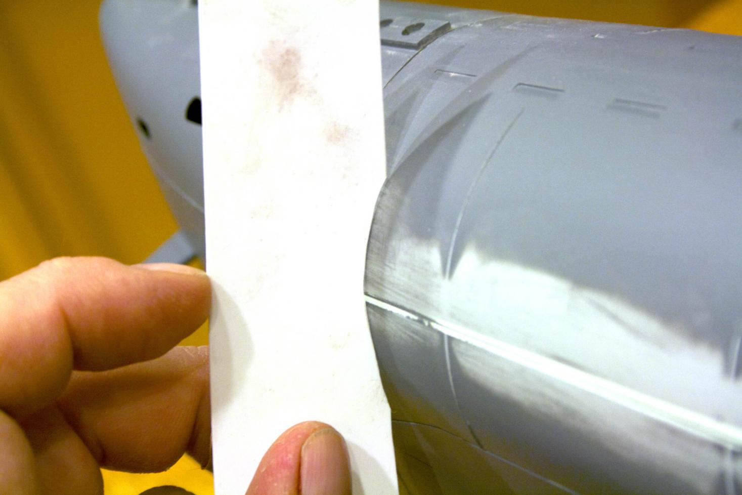

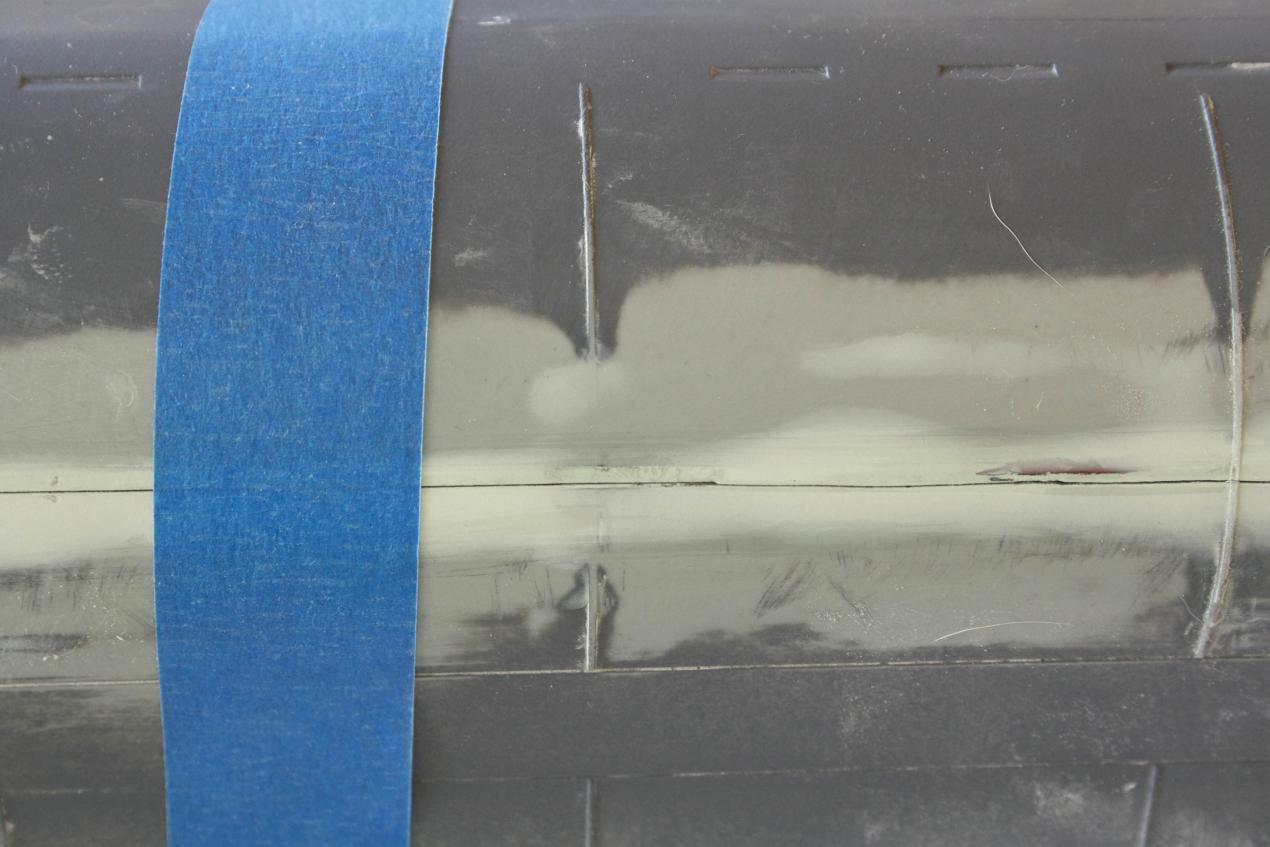

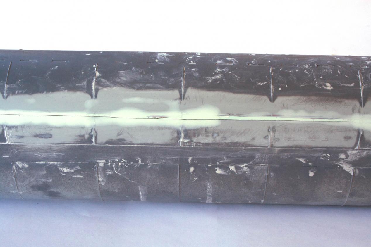

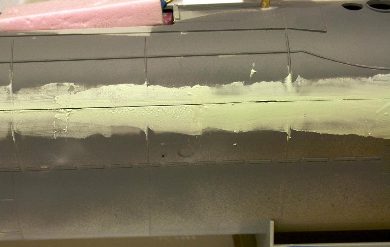

                      During sanding I took it outside on the patio. While sanding, the seam got wider and wider. I thought it was being pinched and caused the deck bow. The deck felt warm (the sun was shining, it was mid 60's) and I had a theory.
                      I apologize for the color, I did not change the white balance on the camera. So as a test, I put the sub inside to let it cool. The deck flattened out. Then took it out in the sun again and as I was holding it I could see it slowly bow out.
Name:	Bronco Type 23_241.jpg
ID:	89699Click image for larger version
Name:	Bronco Type 23_242.jpg
                      Knowing that, I sanded in the shade and out of the heat of the sun.
Name:	Bronco Type 23_243.jpg
ID:	89701Click image for larger version
Name:	Bronco Type 23_244.jpg

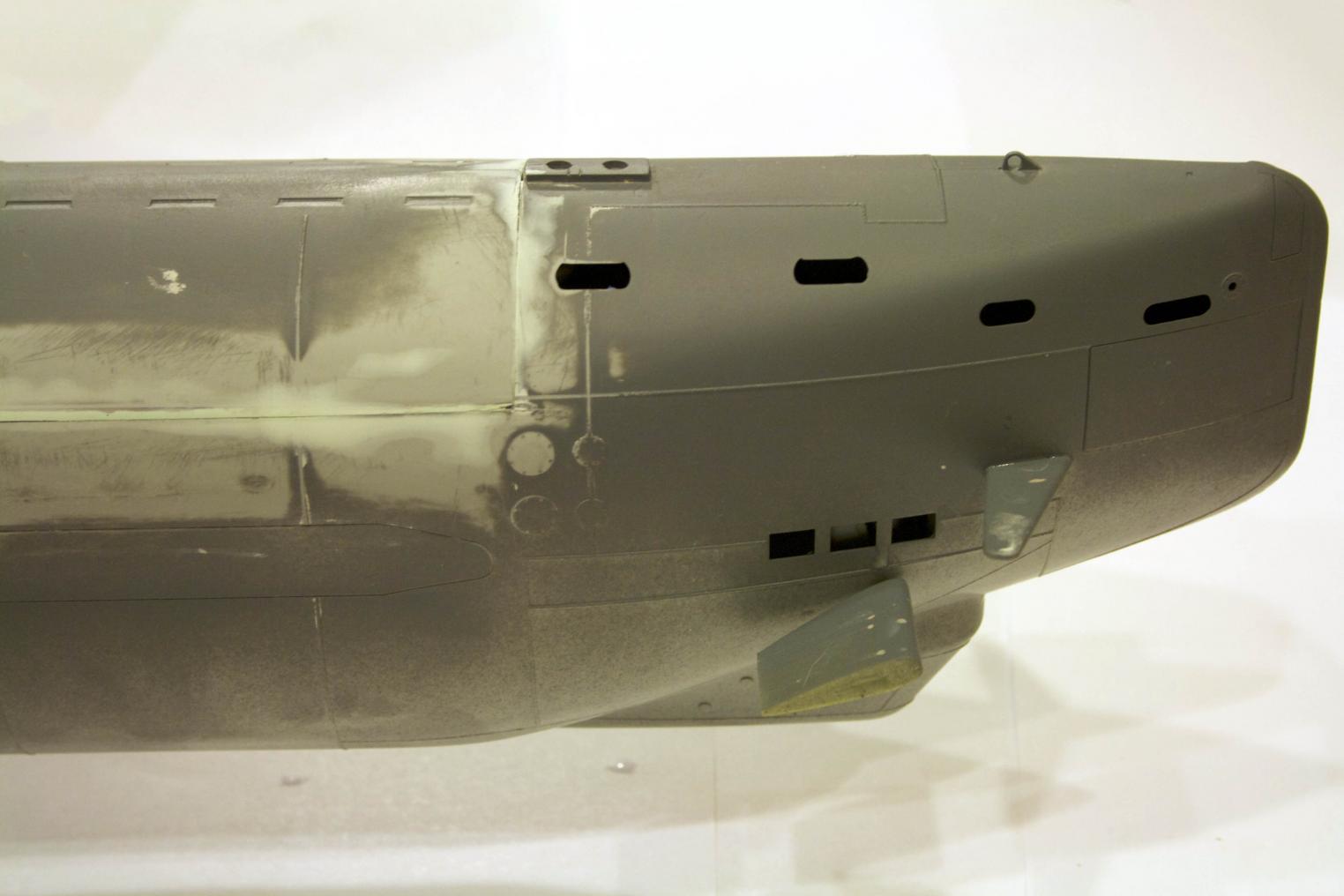

                      I will let the sub dry after the washing and will put some CA on the edges.

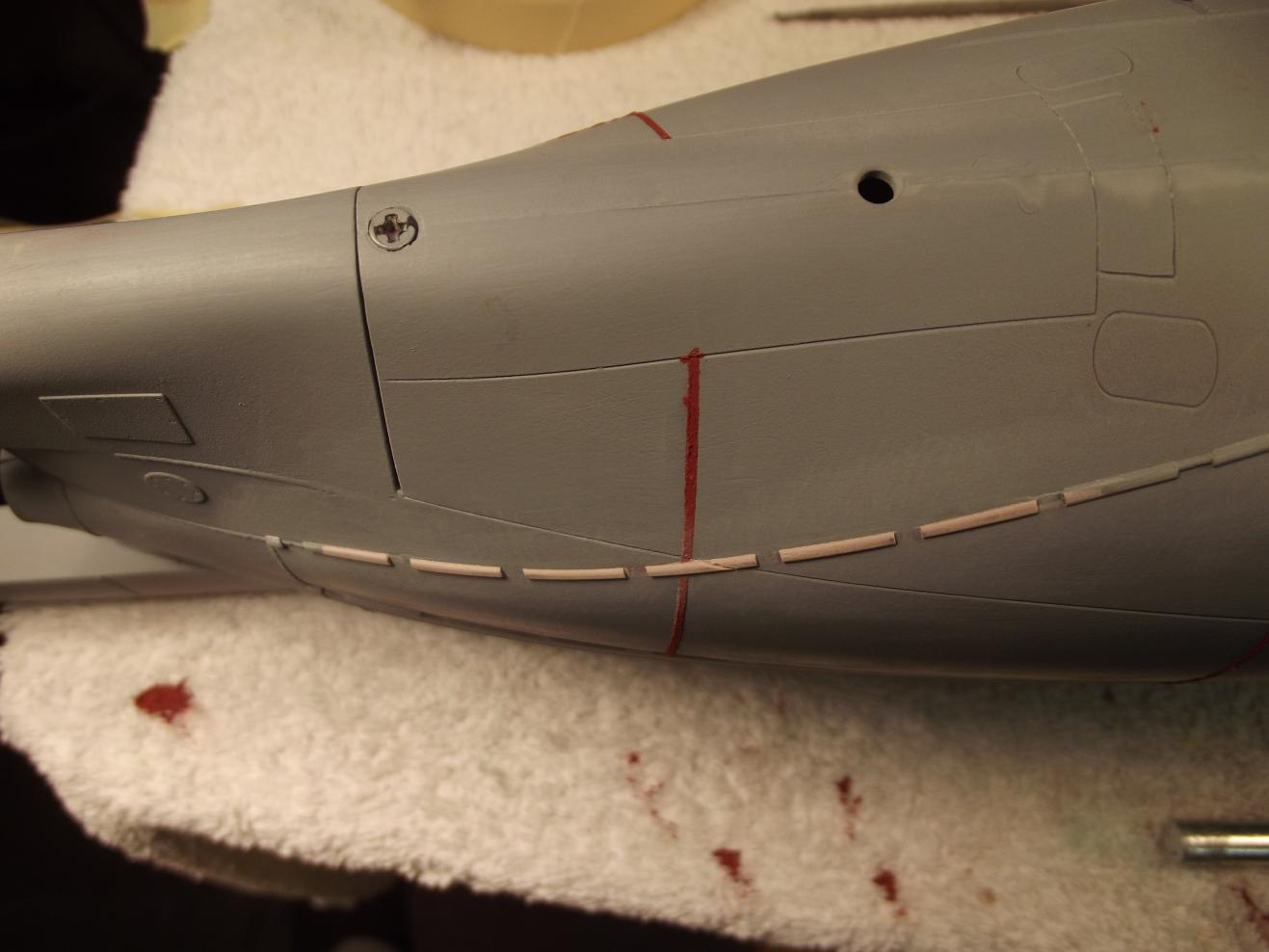

                              #119
                              Not sure why your print does not work. I have not tried to print from the forum.

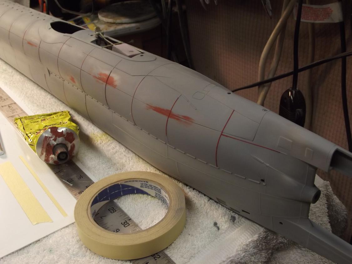

                              Today I did a test on weld lines.
                              Here is the erased section.
Name:	Bronco Type 23_245.jpg

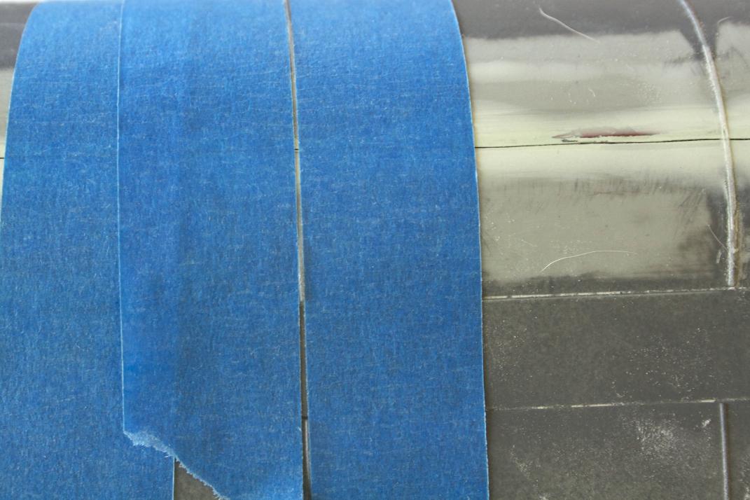

                              Placed tape so that it matched the missing weld line width.
Name:	Bronco Type 23_246.jpg

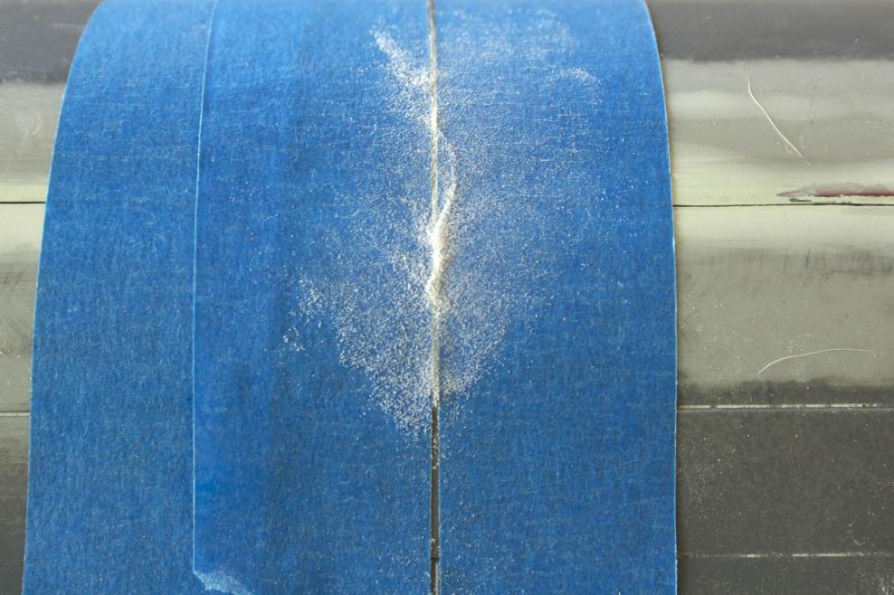

                              Sprinkled in some baking soda and rubbed it into the gap.
Name:	Bronco Type 23_247.jpg

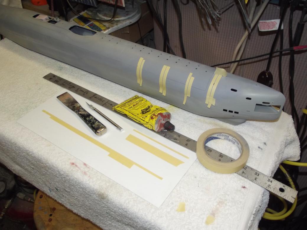

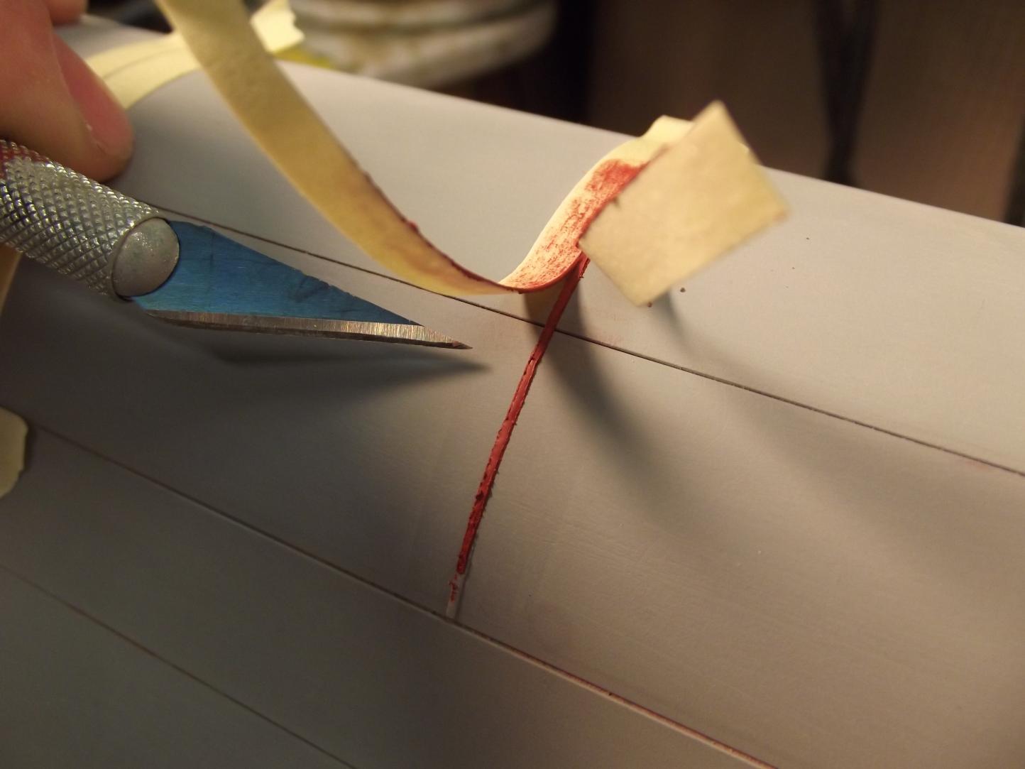

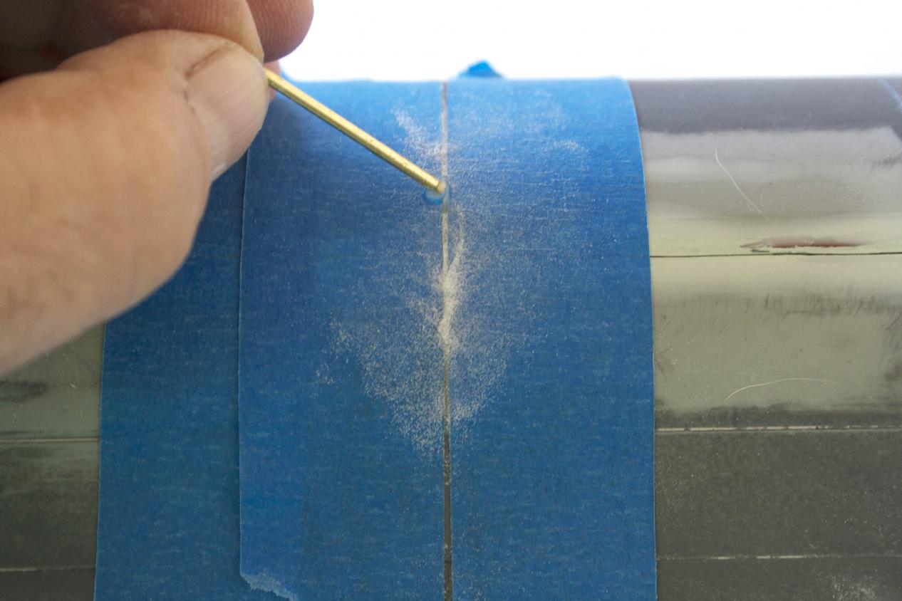

                              Using a brass wire touch the CA to the baking powder weld line.
Name:	Bronco Type 23_248.jpg
                              Rub any loose baking powder into the weld line to soak up any CA not cured.
Name:	Bronco Type 23_249.jpg

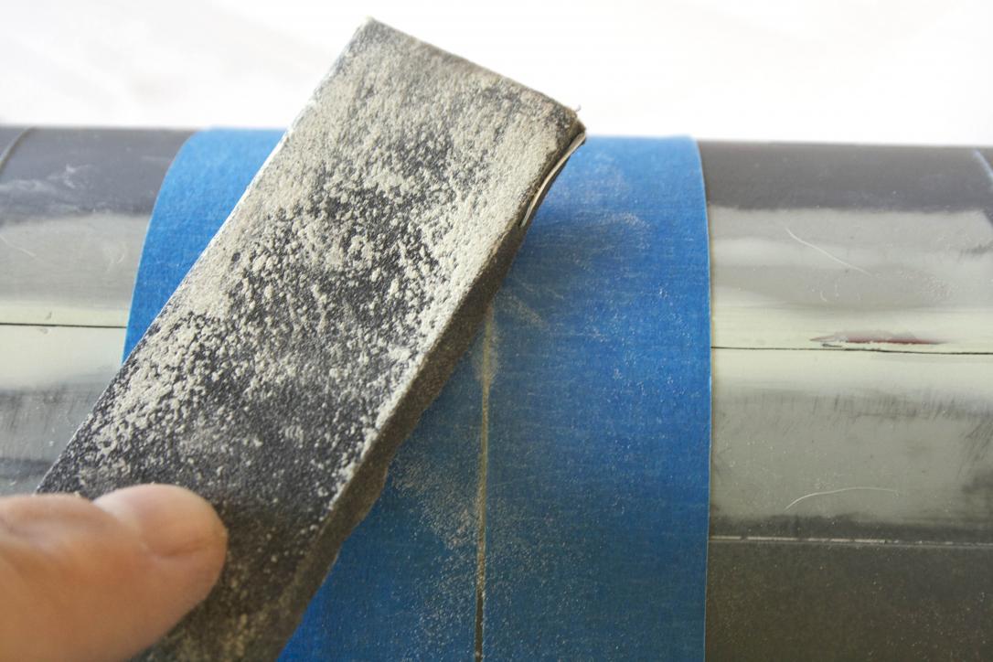

                              Take a sanding stick and sand it down to level the weld line to the tape (or slightly higher).
Name:	Bronco Type 23_250.jpg
                              Peel the tape off and there you go a weld line that looks pretty close to the original.
Name:	Bronco Type 23_251.jpg
                              I did not want to glue the top to the bottom, so I opened up the top and it split at the seam, perfect. I think I will continue with this.
