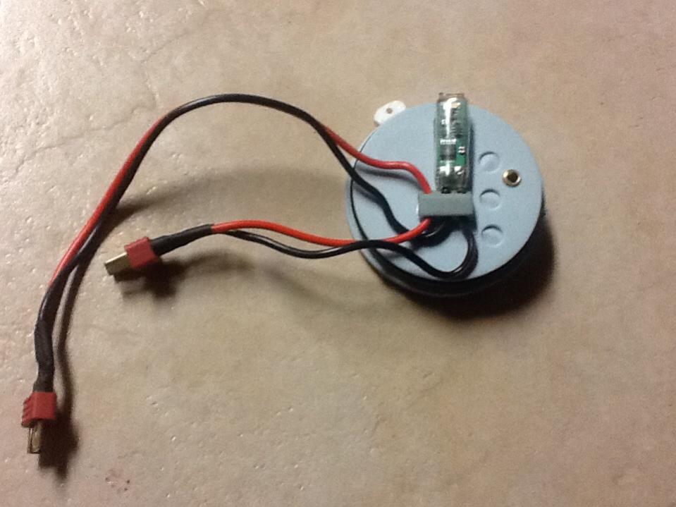

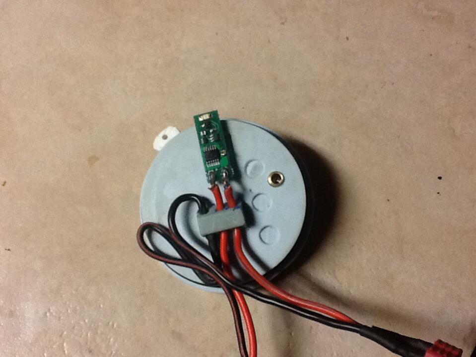

          Posting some pictures and allowing another set of eyes to see what you have done will help in diagnosing the issue.

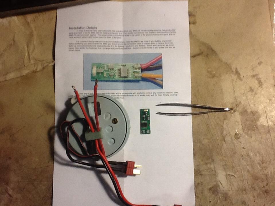

            #125
ID:	98187Old way switch in the ground circuit. Now switch in the hot wire, as per instructions with the input from the battery on the right side tab on topClick image for larger version
ID:	98188Click image for larger version
              #126
              Looks like you've got it half right, both times. You have to connect BOTH the ground and active. There are two pads on the bottom side of the unit for the ground circuit. I've fitted three of these things and they work just fine.
              • jenels4
                • Oct 2014
                • 44
                #127
                Aha, I see the probem with your circuit, looks like Hardrock says it, but this is it.
                Place your magnetic switch with the lED facing up. The soldering pad to the right battery connections, red (+) on this side and black (-) on the other sid of that red (+) connector directly behind it.
                Then your switched power will be on the bottom of the facing board with the red or + on the LED side and the negative terminal (-) of the switched side on the back.
                Your LED facing circuit board should have red (+) sides on the facing your and on the otherside should be the neg (-) sides of the circuits. Top will be Battery terminals and the bottom will have the switched circuit.
                Clear as mudd
                  • 3768
                  #128
                  Not that I can add that much more than what was said,but it looks like you need to add just the black wire to the board. If you cut your black (- negative) and solder it to the pads on the opposite side of the red wires, you should be set.
                    #129
                    Thank you kind sir,and a bravo zulu 2 U. all good!

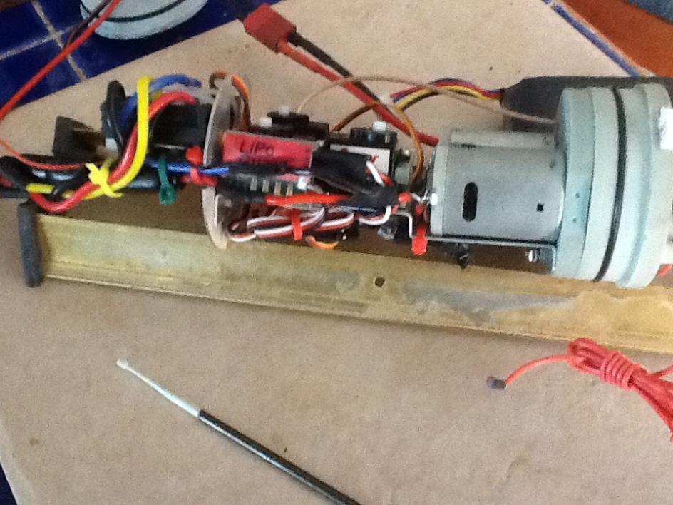

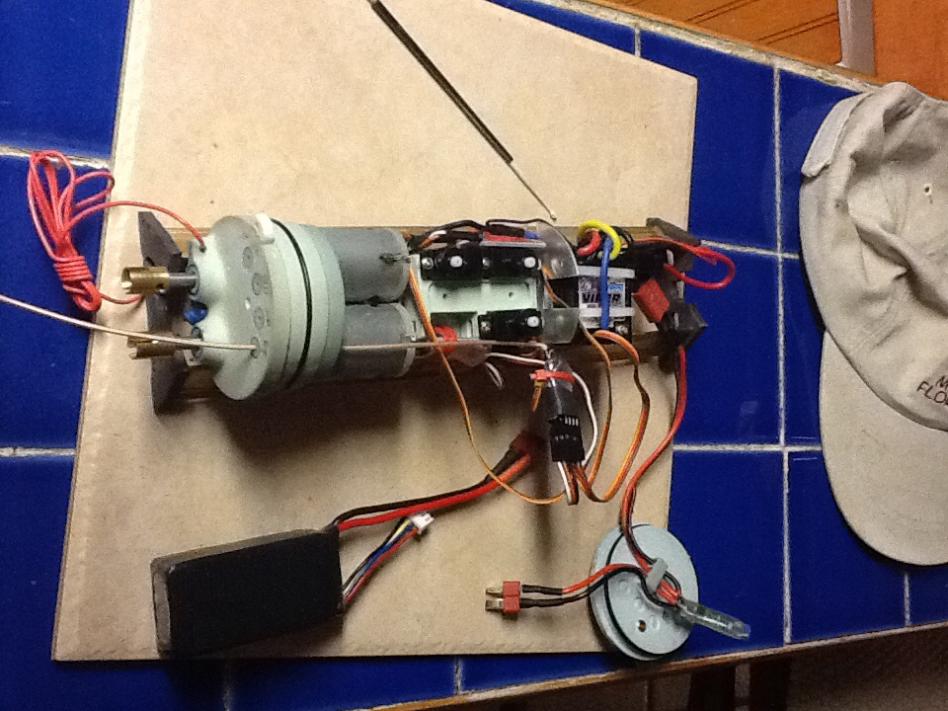

                    Now on to the set up I have a stand for the driver so I can access all the stuff out of the lexan tube.Click image for larger version
ID:	98190Click image for larger version
ID:	98191Click image for larger version

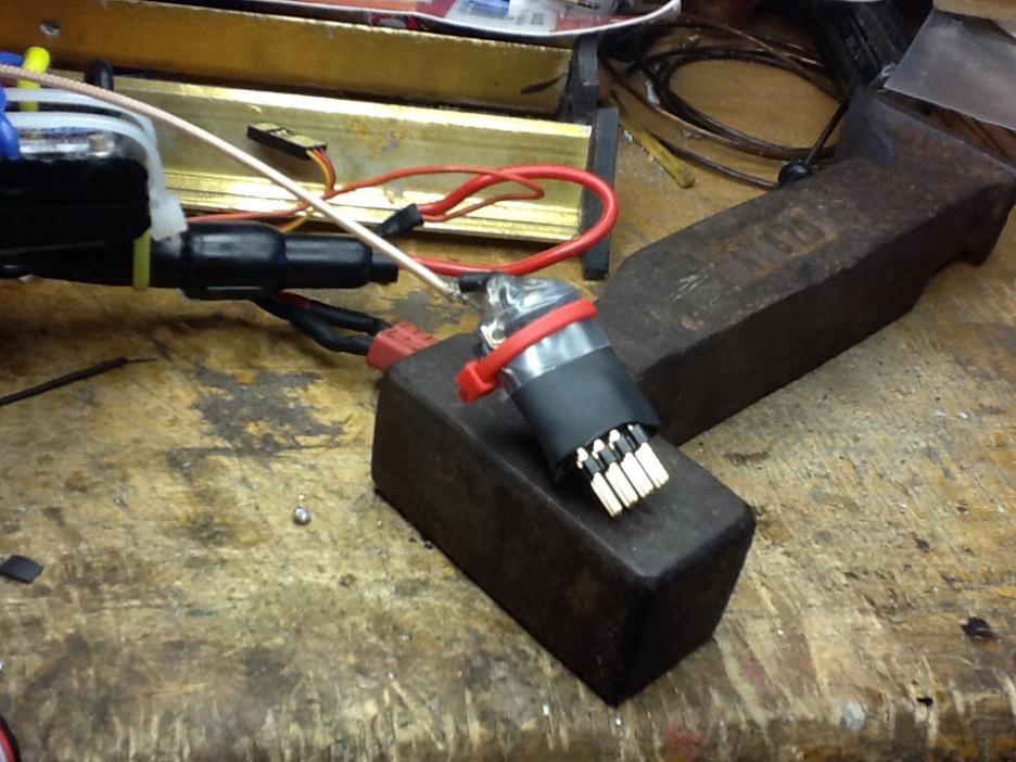

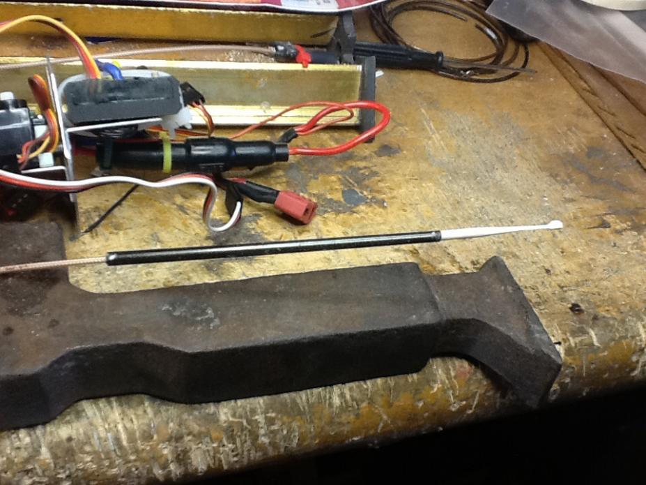

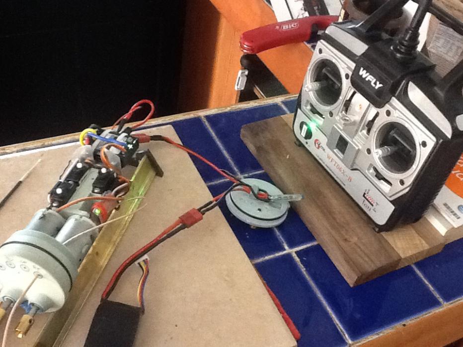

                      OK on with the show. Had to step away from this project for a bit, due to to many irons in the .... ect/ Mostly personal commitments other than foolin around with the models. I had some issues with the reciever and transmitter. after looking, found the problem with the jumper ground had cold solder joint and not a solid connection. put in a new jumper and shrink wrapped it. Had to use marine black, thats all I had. used a small piece of clear on the end with the LED so I can see it. then a zip tie for a redundent, retainer.Click image for larger version
ID:	98301going to start from scratch hooking up the servos. The Wyfly4 channel transmitter isnt made for subs, so some interpilation of the channel and function assignments is required. The other end of the coax, I hollowed out the 1 1/4' tip of the plastic revell scope and stuck the heat shrunk tip of the coax in the tip. the scope housing is a carbon fiber fishing pole tip so no metalic interfereance.Click image for larger version
ID:	98302my question for today which toggles on the transmitter to use for what function on the EZ. All suggestions welcomed guys.

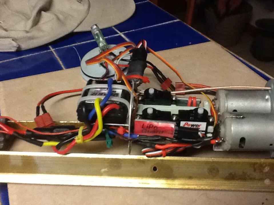

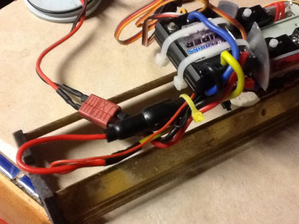

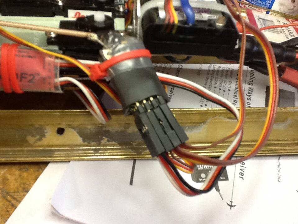

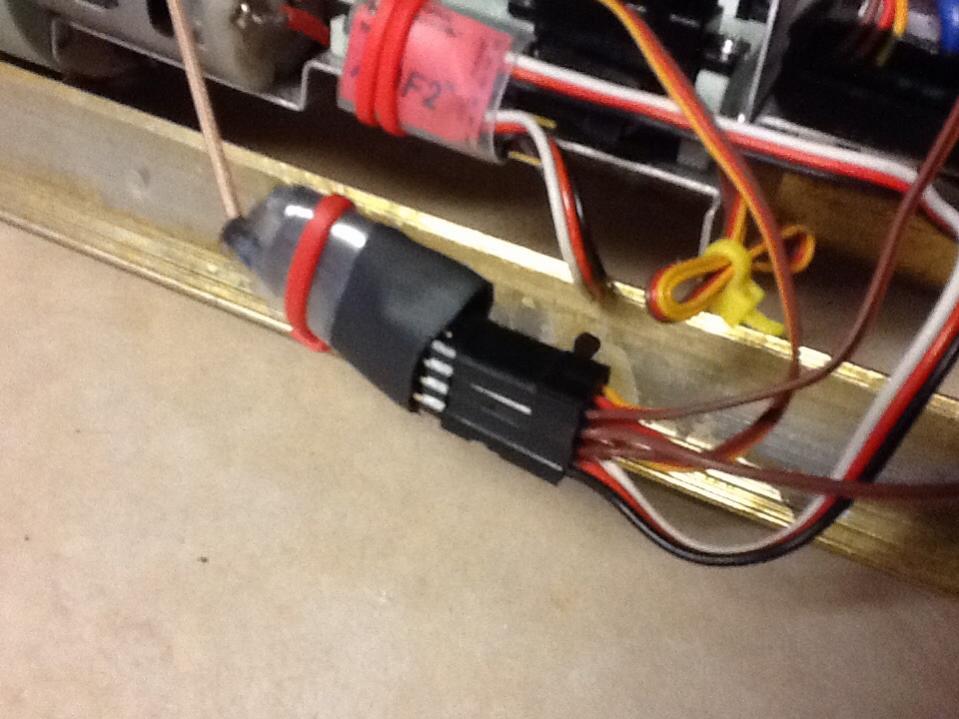

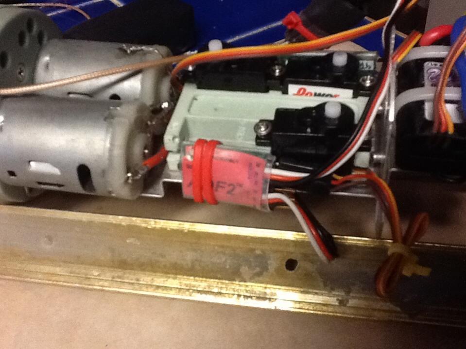

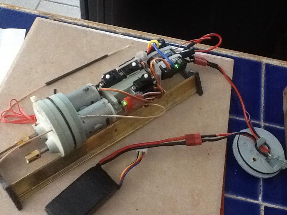

                                Ok guys, I got pictures. My wife thinks I talk in code as well. Once a crypto always a krip. My Daddy always said. I assigned the channels as per Dave. The issue now is, when I turn on the power, I get a steady red on thr viper, where as before, the blinking red and green for a few seconds. At that point I pushed the set button,while still blinking and the motors and servos shut off. Went to step 2 and set theadf/fail safe button an did the throttle recognition steps. That's as far as I got, when I checked the receiver and found the cold solder ground jumper to the pin problem. Now when I turn on the power the steady red on the viper, and no lites on the fail safe or the Lopo guard or led on the receiver. Mr Holmes? Dr Watson? Click image for larger version
ID:	98304Click image for larger version
ID:	98305Click image for larger version
ID:	98306Click image for larger version
ID:	98307Click image for larger version
ID:	98308I took off most of the wire ties to show the routing. I suspect a polarity issue at the Rx plugs, but not sure. If that is it. As pictured the top is the led side and facing the camera.Click image for larger version
ID:	98309orange facing inward acording to instructions.
