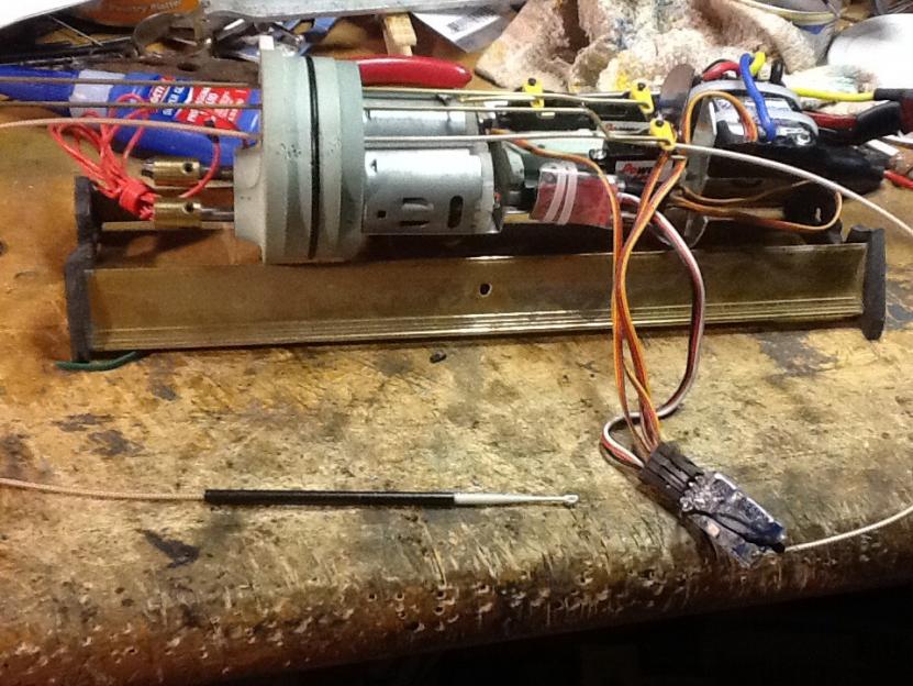

    Coax/jumper soldered, routed. Antenna tip in plastic perriscope with carbon fiber housing. All systems G2G.Click image for larger version
ID:	98381this is the new Rx, I scrapped the first one with the larger gage jumper, and just used the OEM antenna wire from the already programmed Rx. Like recommended in the.......shudder the thought... Instructions. Whoda thunk it?
      • 13901
      #167
      SEAR instructor, master snake eater. sushi style, no fires. You have to be tough if your going to be stupid. "Yesterday" wasnt that easy, either. Phil Bucklew was wrong. RIP Philip. Riddle me this, The old RX original antenna was re positioned to the ground the shield of the coax to the Gnd pin on ch 1. The only thing I did was not use the old antenna wire for a jumper. Being its just a ground, I used a piece of wire. Didnt think that would make a difference. [ATTACH=CONFIG]31152[/ATTACH] Evidently, there may lay the problem. The coax was routed thru an unused push rod packing gland. Is that not acceptable? Nuttin fancy there.
      You Cave-man, you!
      Sure, any conductor to run the shield to ground will do. And, yes, make use of an unused pushrod seal body port for the stuffing gland.
      However, you have to shorten the distance between board antenna pad and coax conductor -- too much is showing and will act as an antenna, de-tuning the detector. Butt that shield right up there, but making sure none of it shorts against the pad.
      Nothing fancy.

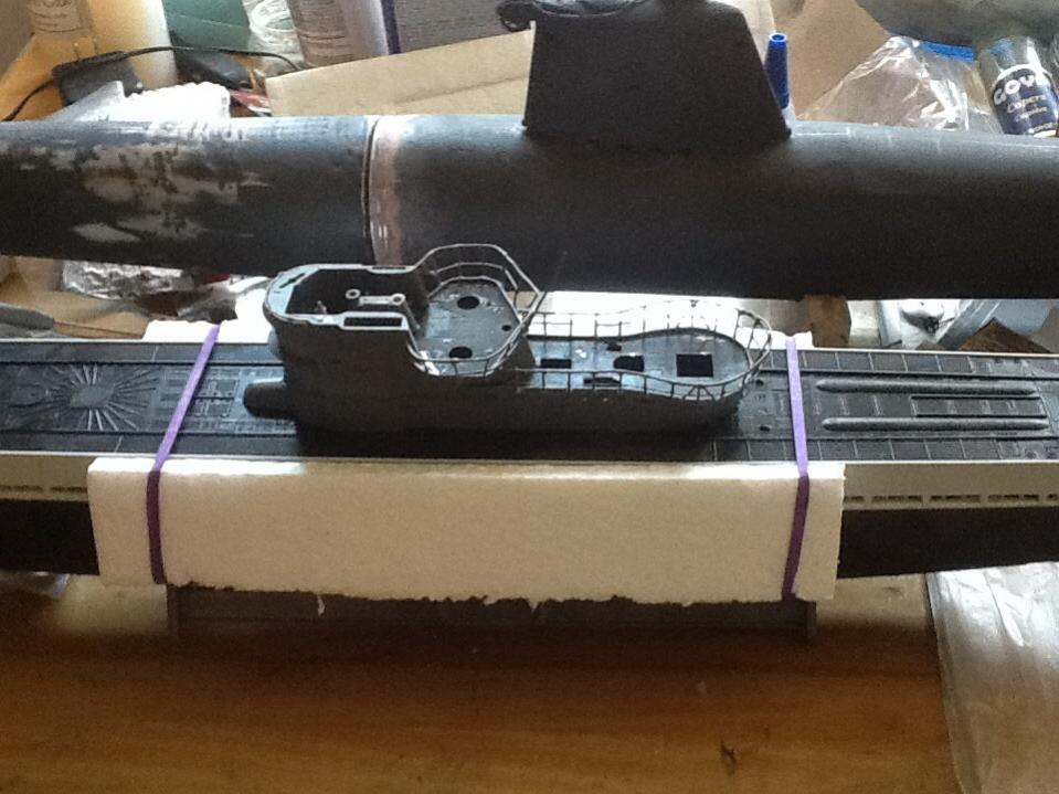

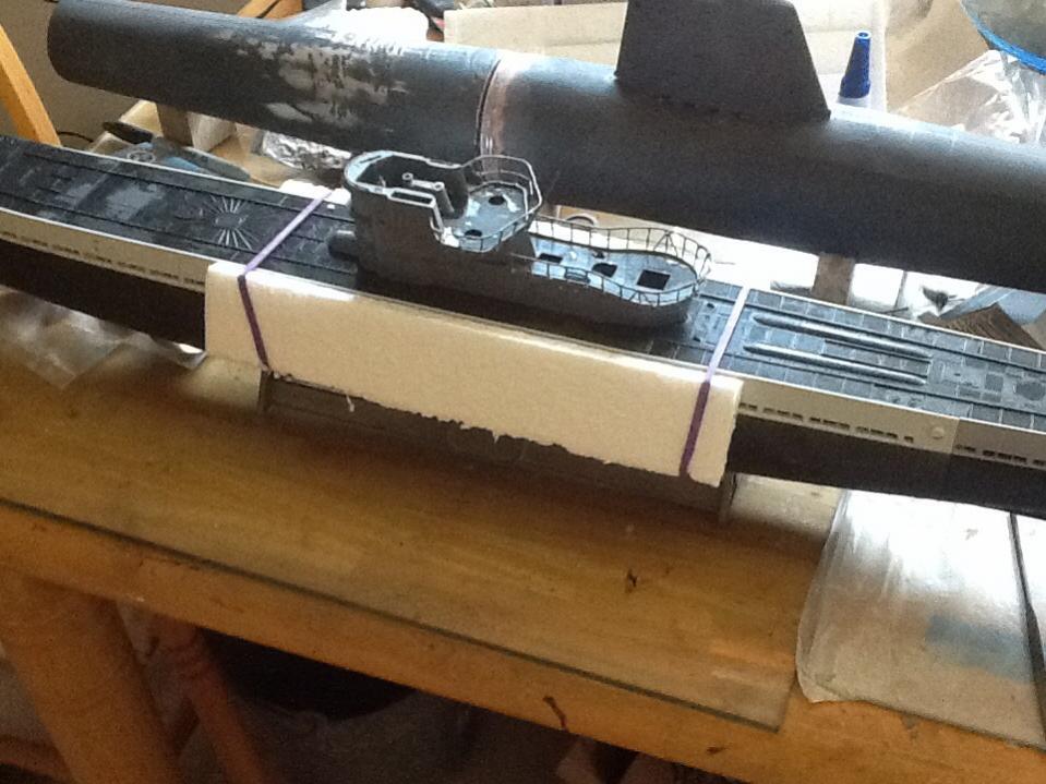

                            Wet feet 09:55 balast check empty boat. Packed the keel 300grams of zinc, cut two pieces of foam, hung them centered with the WTC perammeters and bingo first test boat level waterline half way up the tower, just bairly flooding the bridge deck. Fresh water, in the tub. Sea water may have a slight increase in buoyancy but that may not matter, Click image for larger version
ID:	98399Click image for larger version

                                Wet feet 09:55 balast check empty boat. Packed the keel 300grams of zinc, cut two pieces of foam, hung them centered with the WTC perammeters and bingo first test boat level waterline half way up the tower, just bairly flooding the bridge deck. Fresh water, in the tub. Sea water may have a slight increase in buoyancy but that may not matter, [ATTACH=CONFIG]31179[/ATTACH][ATTACH=CONFIG]31180[/ATTACH]
                                Well done, sir.
