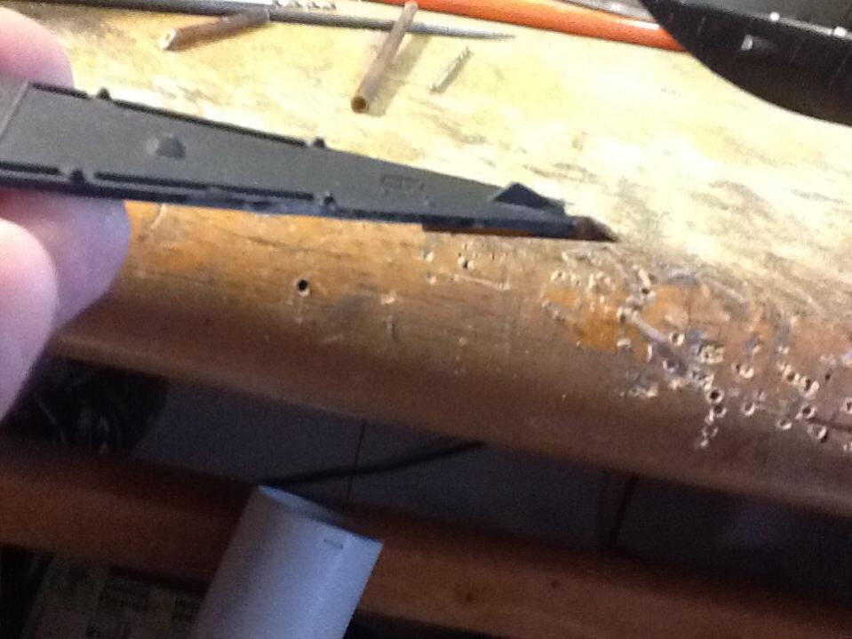

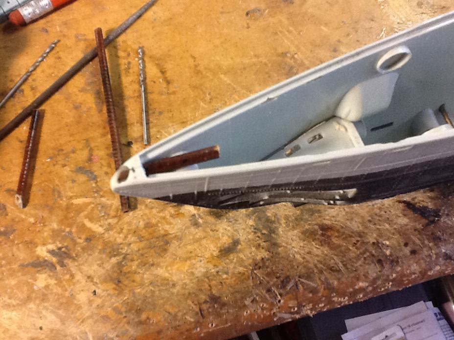

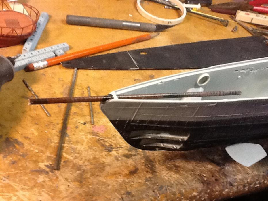

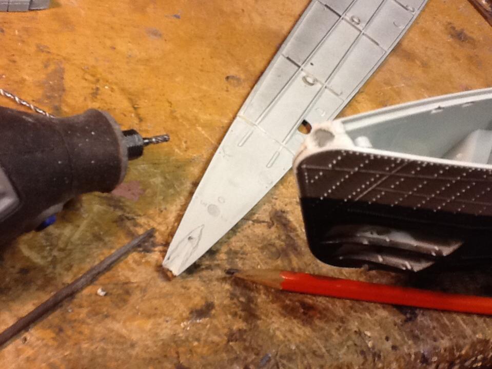

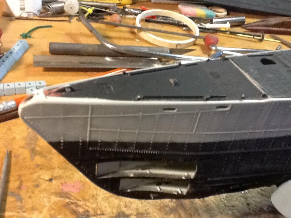

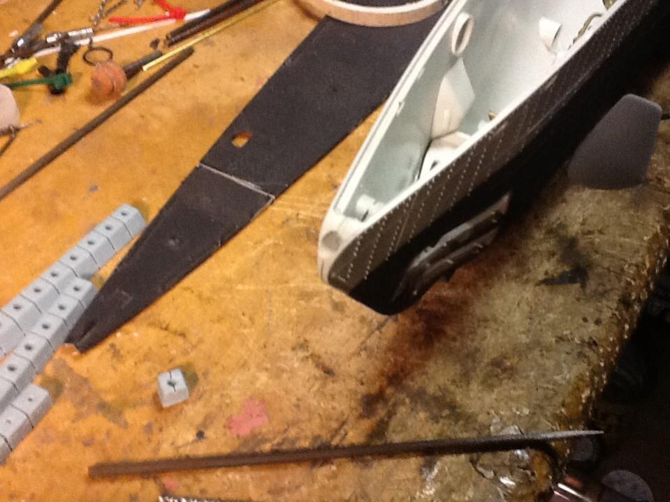

                      Back in the bunker and starting to detale this mess, finally the fun part. Starting at the bow, the Revell boat, just doesn't look right. The hole in the tip is too small and the top is too flat and sharp chine. So a little grinding and some filling and fileing, is in order. At this point I will incorporate a deck securing point, other than a magnet.Click image for larger version
ID:	98427Click image for larger version
ID:	98428Click image for larger version

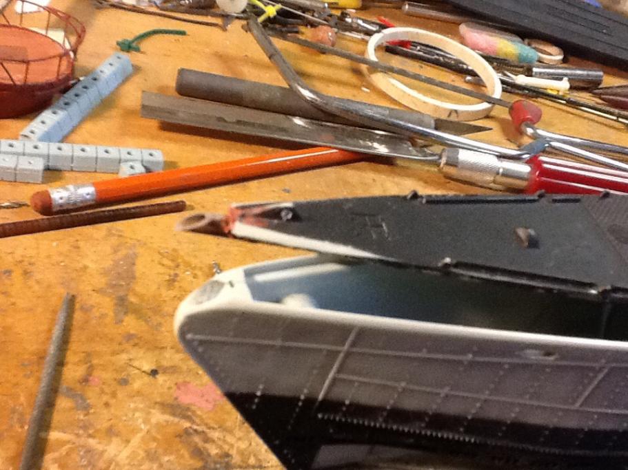

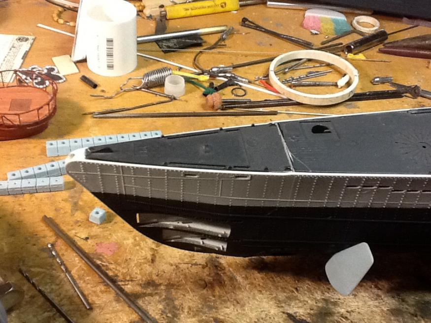

ID:	98429using the wallorisating instruments, I wallered out the hole area at the hull tip and under the deck. Fiberglass fishing rod tip, slight tapered section, inserted and marked for trimming.Click image for larger version
ID:	98430Click image for larger version
ID:	98431Click image for larger version
ID:	98432Click image for larger version
ID:	98433incerted in the hull,some ca and place the foredeck until dry,fill and file contour and slide in to secure, ready for paint.Click image for larger version

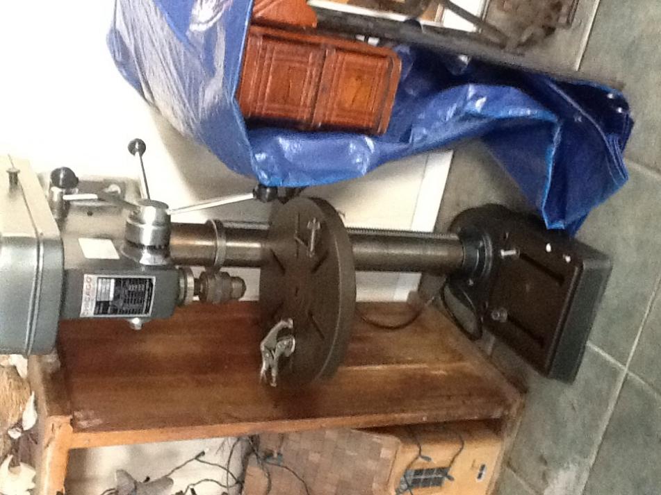

                            One other little gizmo to add in the tool box now. Should be able to drill a few things with a little more precision.Click image for larger version

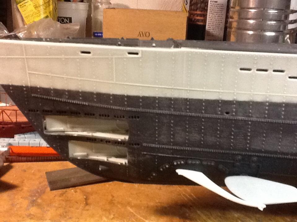

                              Detailing this model, is where I will have to decide on the perameters of how much detail. Since this is a "toy" so to speek and subject to use and abuse, I dont want to spend the money for the brass PE stuff that will brake or fall off. I figgure the salt water on the brass will compromise the CA, and those little wheels, cross hair sights, and hinges on the little guns will be Neptunes plunder. The first thing is to tone down some rivetts. Not as much as they should be, to look to scale, but I always thought Revell's were too large and pronounced. If you look at some of the close up pictures of the U-505 they are hardly visible in compairison with the weldseams being dominate. I put a scale sailor next to the rivetts and noticed they were bigger than his eye and pronounced, as deep as the socket. So some light sanding on the large rivetts, taking care not to hit the small double seam rivetts or the weld seams to much. Initally I painted the waterline down flat black primer for deffinition. Final color scheme for this boat is still undecided. I have done quite a bit of research on what boats were painted what colors at different periods of service. Cammo is always a dynamic dazzeler for the GP. Period correct may be boaring to some. Late war just about everything was black or schwartzgrau Dark grey. Schliktgrau was widely used on type IXs after 44 in most theaters of operations. That is dark grey with some olive green tint. Up in the Baltic and North seas the splinter 3 tone grey was common. AMP has a really good PDF on U boat paint colors and markings as a guide. The true colors are going to have to be interpilated, because the old color pictures arnt Kodakrome or anything like it. But its a good place to start.Click image for larger version
ID:	98489Click image for larger version
ID:	98490Click image for larger version
Name:	505 rivetts.jpg
ID:	98491Click image for larger version

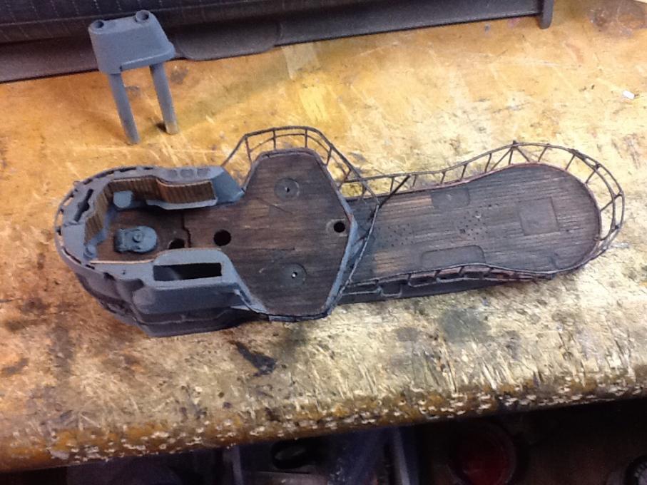

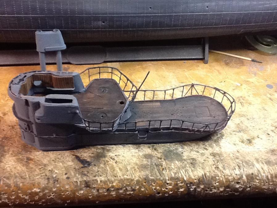

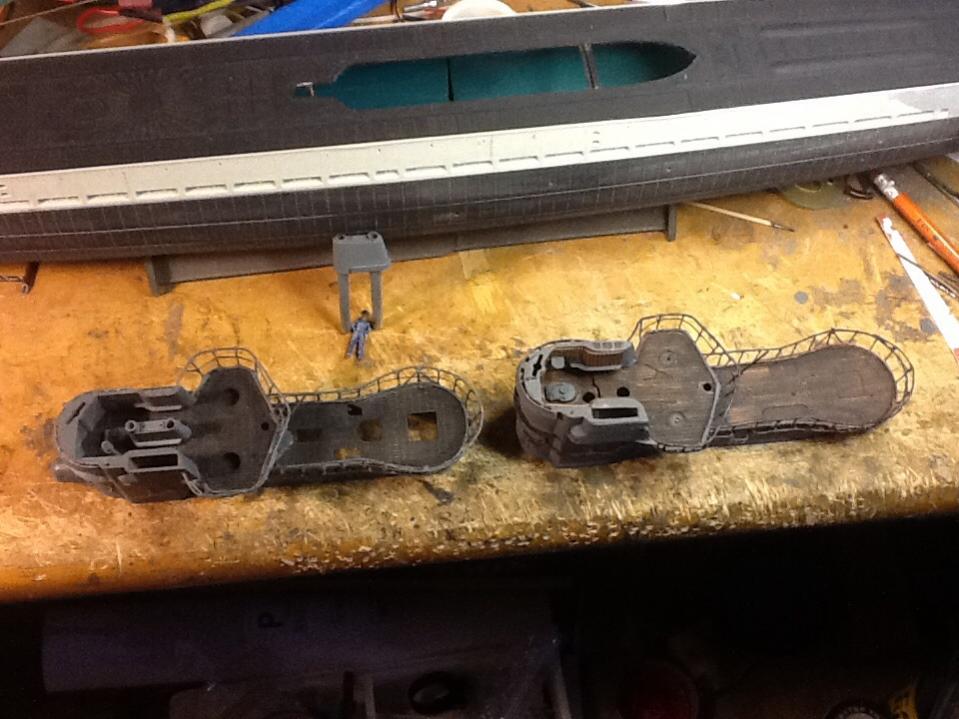

                                Decided to use the scratch built tower, rather than the Revell. The scratch built is mostly aluminium sheet and copper and brass wire. The original, has the PE deck. They are interchangeable, so it isn't a big deal to swap them out with the other boat. Samo Samo samo with the EZ driver. Click image for larger version
ID:	98510Click image for larger version
ID:	98511Click image for larger version
ID:	98512First thing was to weather the deck. I used the Revell piece for a template and cut a piece of mahagoney sheet that I milled off of a 3 x6 board. This is the base of the lower gun deck. I used the sticker back vaneer tower decks that was supplied with the Nautilus wood deck set for the type IX. This was meant to stick on the plastic decks supplied with the Revell kit, to simulate and augment, the real wood hull deck. I don't know why the Nautilus company did that. The wood hull deck is an excelant piece of PE work, and the tower decks are just fancy stickers. I am saving the wood hull decks for a display boat, but was going to toss the stickers. If they get compromised when they get wet, it's no problem, since they aren't worth saving to begin with. So, they look ok, but needed some wear. I stained them first with colonial maple, to give them the look of skotz pine. That's the type of wood used on almost all U boats. The little teak that was imported early in the war, went to the Bismark and Trippetz battle ships, U bootarm didn't get squat. The decks of the U boats were treated with a mixture of coal dust and diesel fuel. This was a preservation process, as well as camouflage. Preservation from alge growth, which made the decks slippery, and other marine life that would attach itself to the boat. Cammo wise, it helped somewhat due to the fact the light colors of the raw wood just under the surface show up a bright lite green visible for miles from the air. I took some charcoal, artist type not Kingsford, although that might work, with the instant light kind, and give it authentic smell, as well. I mixed it with some linseed oil to a paste and brushed it all black. While still wet I rubbed it off slightly to bring back some wood color. Then rubbed harder with a clean dry rag where there would be foot traffic by the ladders and guns.
