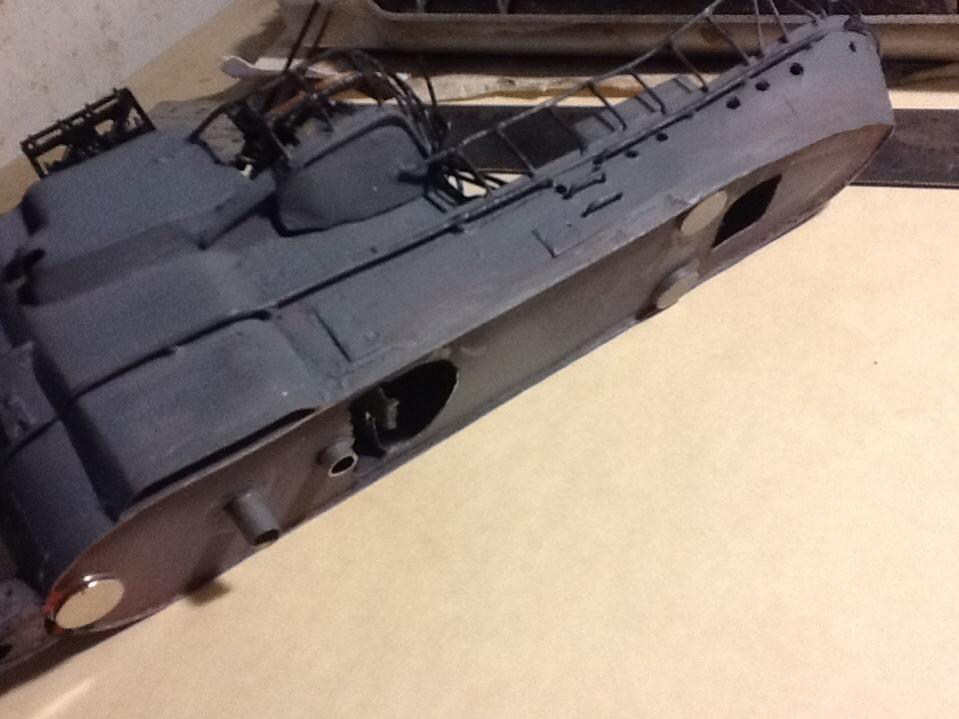

    Cut some holes in the aluminium tower's floor to make it free flooding and added some powerful flat magnets Click image for larger version

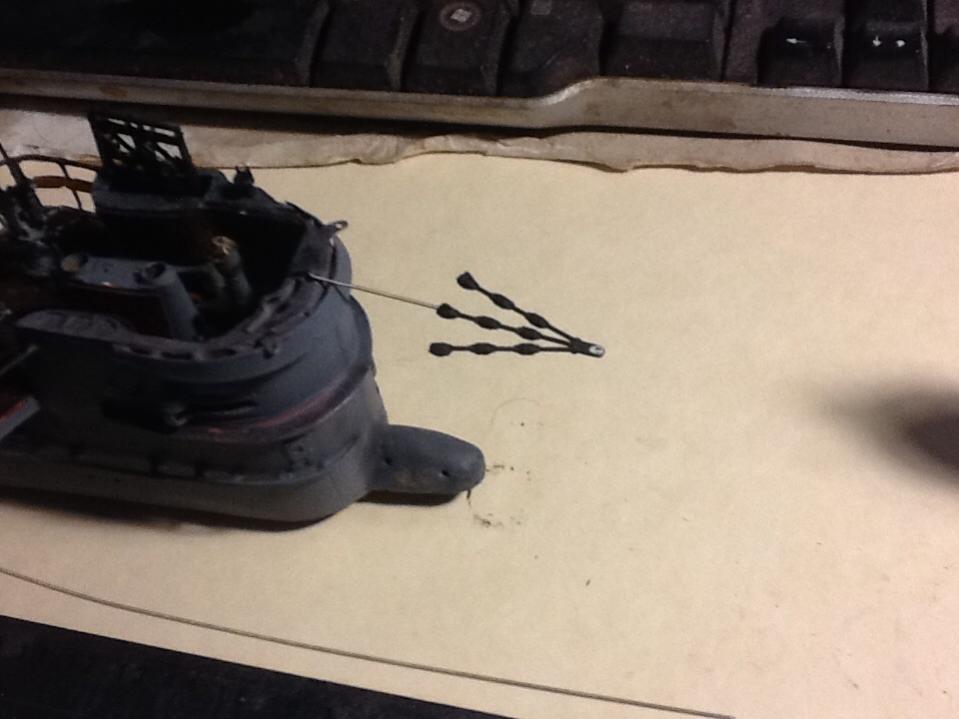

      Added a couple more deck magnets, and started to hook up the jumper cables. After some serious thought, about usingClick image for larger version

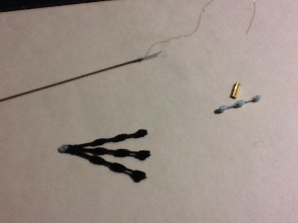

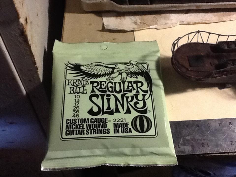

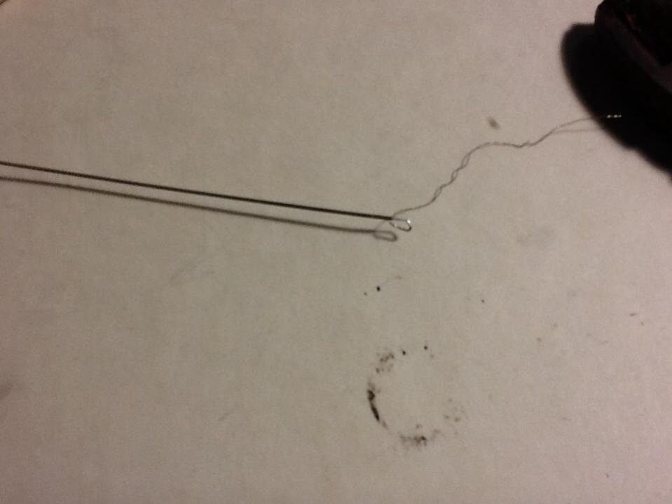

ID:	98664 elastic thread, and finally finding a close by source, I talked with the lady that has the boat covers and sail shop, who recommended not to use it in the sun or salt water. And also some power boat guys that had used rubber bands and hair ties to secure stuff, said the elastic brakes down quickly in the hostile environment. Since, my usual choice for display models is various types of guitar strings. I would venture to guess, not many of you guys are guitar players and aware of the wide variety of sizes, material,ect of what is available. In this case, I will try to show, how and why, I will use some different strings for various usage. The Revell insulator blocks have a cable between each insulator that are comparable to the wound G string .017 on one of my electric guitars. These strings have a steel core of about .010 and are wound with very thin nickel wire. They hardly flex and are quite stiff and the nickel does not rust.Click image for larger version
ID:	98663wire pictured here is the same string from an acoustic guitar, that has a bronze wire warping. Either nickel or bronze will work, it's just I have an abundance of both. They will get paint protection. I glued 3 pieces about 20mm between the block and tower for a secure point, for the magnet that will connect the single cable to the bow.Click image for larger version

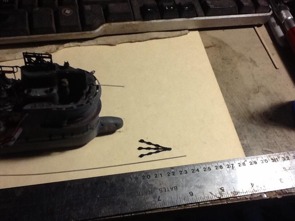

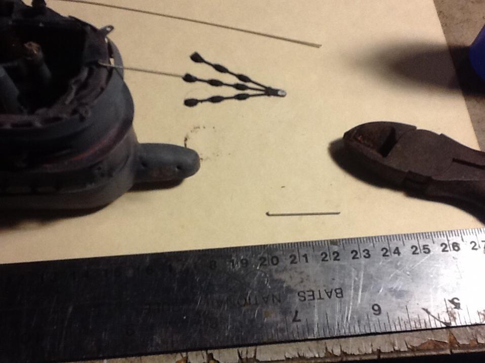

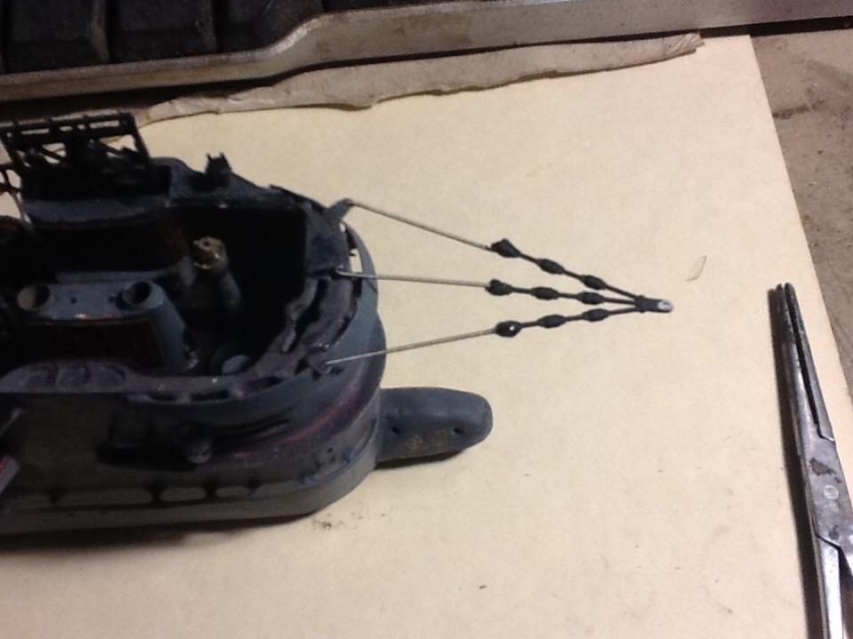

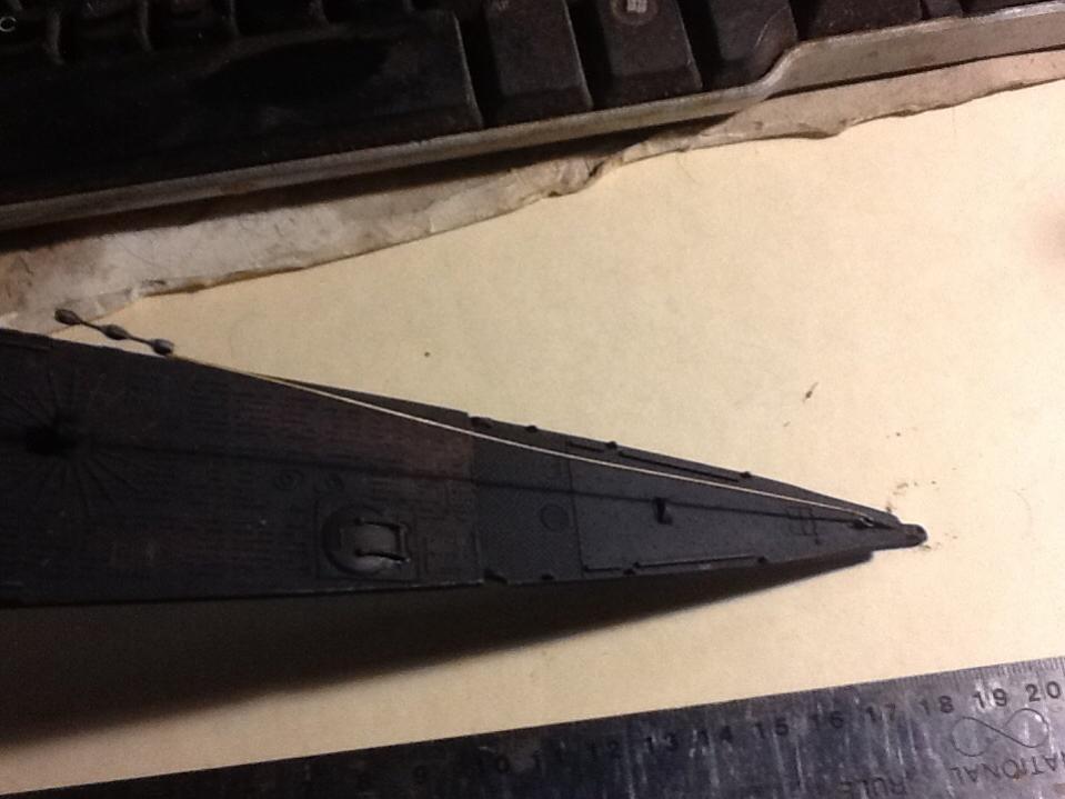

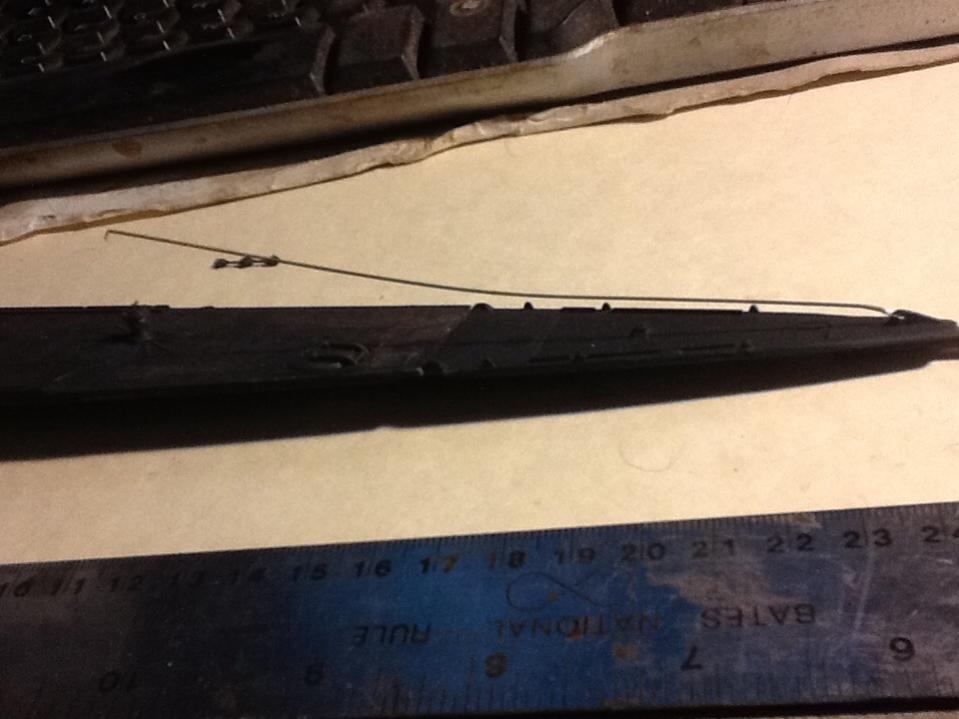

ID:	98668using a stiff wire for the cable, that is secured to the bow will insure there won't be any trailing loose ends going back to fowl in the screws. The magnet separation point forward of the tower.Click image for larger version

ID:	98671securing the wire to the platic blocks ia a simple matter of unwraveling some of the covering, snipping off the core, leaving the covering hanging. Then pull the strand thru the hole in the block for the thread and snug the butt end up to the bloclk with a dab of CA, and then wrap the tag end of the bronze or nickle cover around the wire glued to the end of the block.

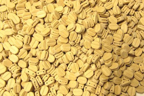

                    Well, I broke a plastic block, at the plastic cable that separated them, foolin' around. I knew that that was the weakest link in the system, but I found these2mm resin, single purchase blocks. Click image for larger version
                    Now I can start all over and have enough to make all my 1/72 U boats new rigging. Uniformly, and secure.And they look almost correct, unlike the beads I have used in the past. Perhaps a little more labor intensive to re rig, but, like they use to say, yesterday was the easy day, finding these.

                      #220
                      Maybe drill a hole through blocks and thread them on the wire like beads?
                      Then add the wraps/ropes to make them look like they are what's holding everything together?
                        Scott T
                        Exactly what I was planning to do. The steel core isnt interupted except at the magnet connection at the yoke by the tower. No worries about braking anywhere inthe line. Since Im operating in the open ocean, sea weed is going to be my worst obsticle. It floats in and out of my canal, on the tides. Probbably the biggest fear is the fish that come in loking for their easy dinner. Some of the big barracdas that lurk around here, eat fish whole, twice the size of this little boat.
