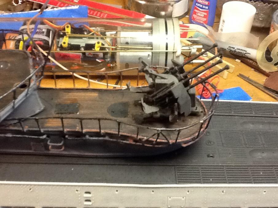

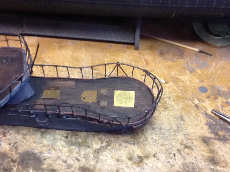

    The hatches in the Nautilus sticker deck are not so dynamic, so some PE stuff will be used. I went crazy when the type IX kit came out and ordered all the various PE stuff available at the time. I ended up with a lot of duplicate hatches and stuff, from Eduardo, white ensign, model brass, CZ! Otto ect. I have 3 type IXs, so it's not going to be wasted. Click image for larger version
ID:	98513Click image for larger version
ID:	98514Italeri 1/72 flakzwieling that is part of an anti aircraft battery kit. Instead of the single 7.5cm.Click image for larger version
ID:	98515 Brass PE parts are available for this gun from the Griffon 1/72 Shnellboat, accessories set, but I am saving them for a display model.Click image for larger version

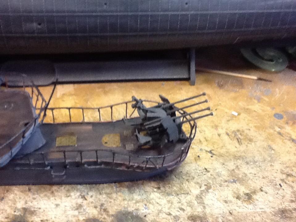

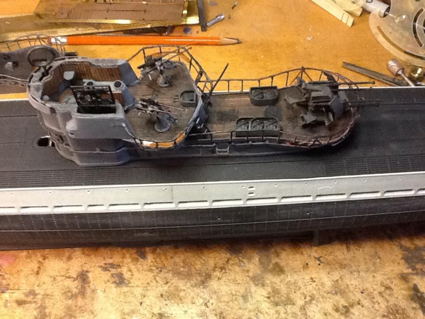

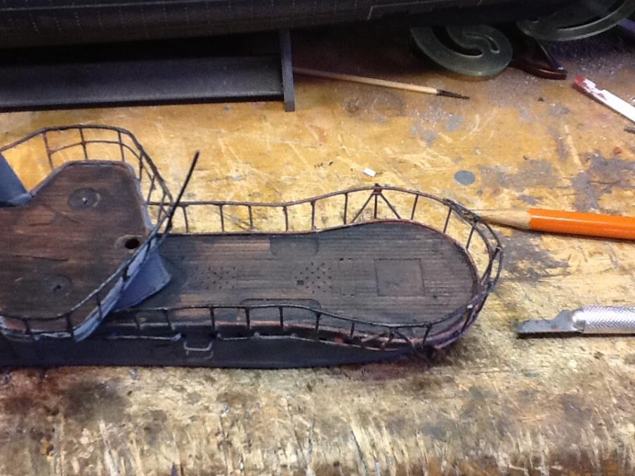

      Added a few more tid bits todayClick image for larger version
        #198
        Todays question is about the rigging and the removable tower and decks, situation. I would assume, the tower will have the rigging perminately affixed and have the fore and aft jumper wire secure points detachable, somehow. I see some people dont even use any, just for the simplicity of the operation. More stuff to get flotsum and jetsum.(thats seeweed and old fishing line and bird feathers,and poop.) that floats on and under the water. Any good ideas? magnets, jewelry clips or something clever? I will be using electric guitar (e) first string which is steel .010 gage for the jumper. I have contimplated securig the tower to the center deck section perminately. Using the bow deck section and stern section as secure points for the wires. Basiclly a 3 piece, interlocking deck all tied together with the jumper, that can be removed, as a unit and stashed for hull maintainace, or driver access.

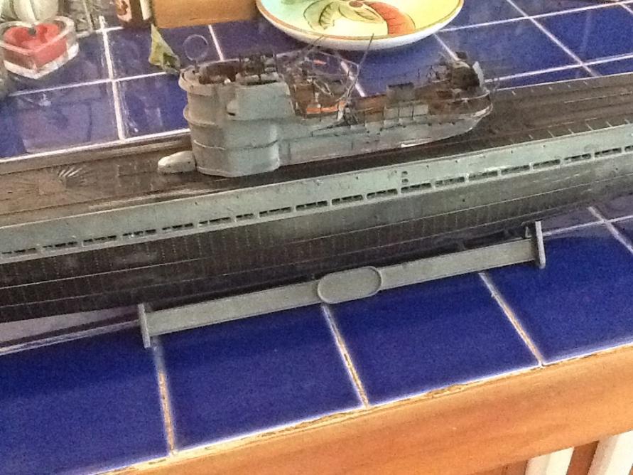

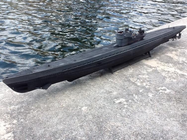

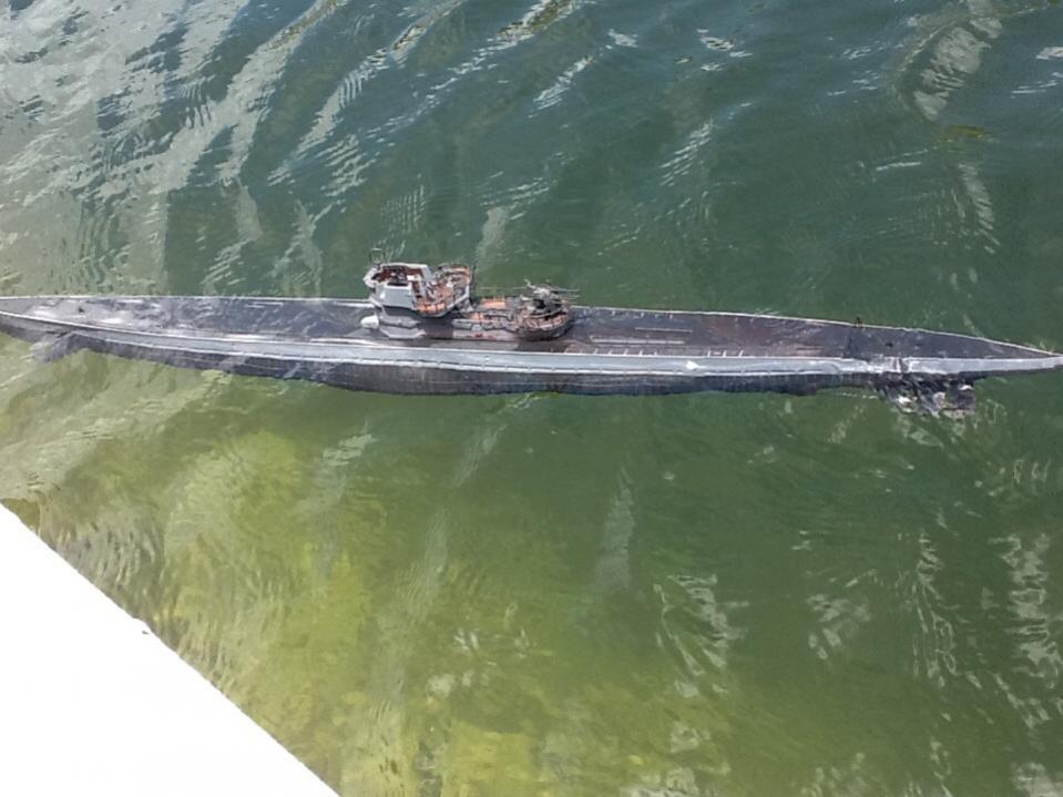

                    Salt water shake downClick image for larger version
ID:	98586Click image for larger version
ID:	98587Click image for larger version
ID:	98588balast trim test. First novice mistake was, forgot to put the antenna up thru the scope housing. Didnt make much differance.it was laying down just under the plastic deck visible thru the limber holes. Everything worked. Some rudder trimming issues, not sufficent starboard travel. but I wasnt ready for the throtle response and she took off. bow planes pitched down real well. Had to stop taking pics. Soon as the tower went under it was swept away with the center section of the deck. Water temp today is about 78 up on top. Its a little cooler 20 ft down. That light green under the boat is about 7 ft the green beyond is 20. Tower was still on the 7 ft ledge with the quad gun a few inches away, right under where she went down. hull popped back up but the main deck was a good 30 feet away out in the middle of the canal. Took a little bit of searching to find it. No aparent leakage in the WTC, but it didnt go under more than a foot, so not much pressure on seals

                      Salt water shake down[ATTACH=CONFIG]31386[/ATTACH][ATTACH=CONFIG]31387[/ATTACH][ATTACH=CONFIG]31388[/ATTACH]balast trim test. First novice mistake was, forgot to put the antenna up thru the scope housing. Didnt make much differance.it was laying down just under the plastic deck visible thru the limber holes. Everything worked. Some rudder trimming issues, not sufficent starboard travel. but I wasnt ready for the throtle response and she took off. bow planes pitched down real well. Had to stop taking pics. Soon as the tower went under it was swept away with the center section of the deck. Water temp today is about 78 up on top. Its a little cooler 20 ft down. That light green under the boat is about 7 ft the green beyond is 20. Tower was still on the 7 ft ledge with the quad gun a few inches away, right under where she went down. hull popped back up but the main deck was a good 30 feet away out in the middle of the canal. Took a little bit of searching to find it. No aparent leakage in the WTC, but it didnt go under more than a foot, so not much pressure on seals
                      Ram water through the open shutter doors raised the pressure in the hull, and that popped your deck. Blank off the torpedo tube muzzles. And stick a few more magnets on the superstructure and deck pieces. Yeah, you got two geard 380's in that thing -- dial the throttle WAY down, pal.
                      I was about to ask how you knew it got colder at 20-feet ...
                        • 3672

                        That looks really great in the water! Aside from blowing the doors off and some minor adjustments, you are there! Look forward to seeing more photos.
                        My brother lived in the Keys and I miss the channels. The clear water should give you ample opportunities to get some great underwater photos. Really excited for you sir.
                          #207
                          Never thought about the open torpedo doors.Good point. I figured a couple more magnets, were in order. for the decks and tower. Which, by the way is the scratch built and is semi boyant. By that I mean the space between the bridge deck and space under the gun deck is not drilled out for limber and the few small holes for the scopes dont let water flow fast enough. Sure is a high speed surface craft, but I just had a heavy thumb, first time. Yeah Dave I thought the casual mention of water temp, was better than saying I had to dip for the boat on the cherry run. I dont have a go pro yet for the underwater pics, but thats not far down the road. All in all, it was fun. Next time I will have a camera operator instead of trying to do it all

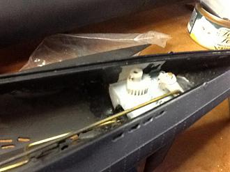

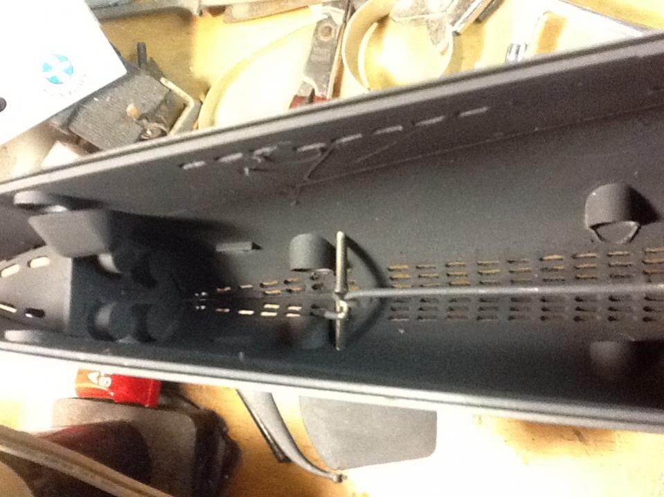

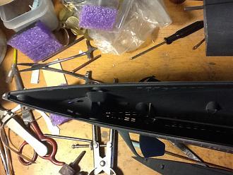

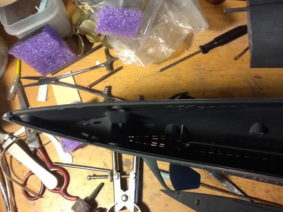

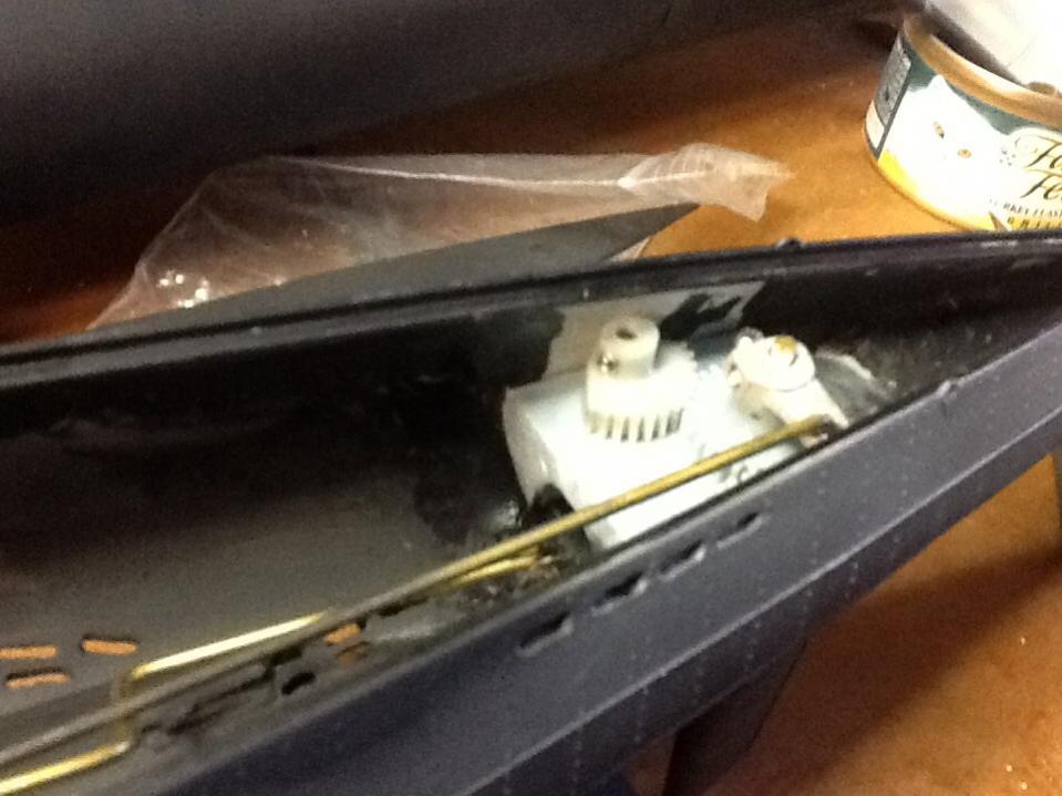

                                should be fun. I started addressing the issues with the type IX. Temporarily capped the tubes from the water induction Click image for larger version
ID:	98617 Click image for larger version
                                the rudder binding on the hull issue was relieving the hull wall and sanding the gear a little more on the back of the cut section. Click image for larger version
