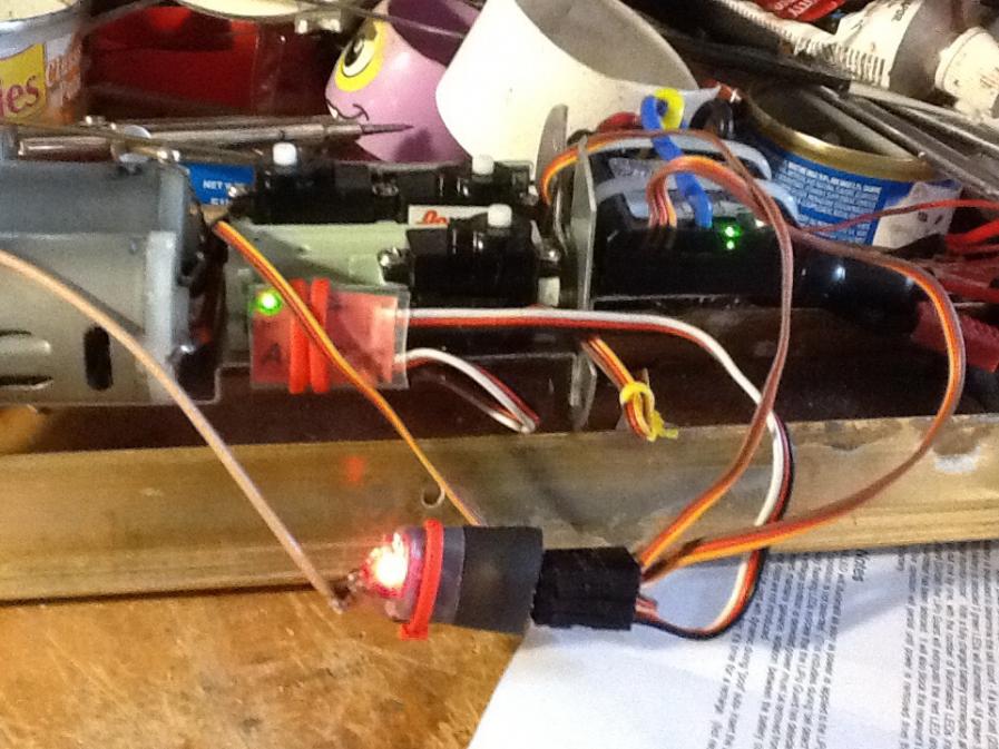

    HOOO YAH!! just decided to flip all the rx plugs and boom All Good. Just like the first parachute jump after packing your own chute that you put together from parts. You'll never know if it works unless you grab ahold of yer balls and step out the door, of a perfectly good aircraft. I got lites and bells and whistles all over the machine now. The servos and shafts go crazy. Press the viper set button within the two second blinking time. Green lite on th ADF2 solid red on the transmitter no lights on the lypo guard, at this point.Click image for larger version

                              I retraced the power wires for the Lypo and re soldered them to the battery after the power switch instead of the post fused power to the motor connection previously. Everything lights up now with the switch.Todays delema is the set up priority. Code matching, would be the initial, I assume. What is confusing is your suppose to turn on the TX prior to the RX. I did this, then the Viper did the flashing routeen and I set the button before the time limit. The rx red LED lit up and I pressed the set button on the rx and the orange and red started flashing. Dont know what that means. Tried to set the throttle to no avail. The failsafe setting instructions say turn on the receiver first then turn on TX wile holding set button. Recognition green on the TX is suppose to blink. Not. The other delima is the sensitivity adjustments on the transmitters lower right. Dont undersand how they function. They look like sliders but dont move with a stylus. I didnt want to force any so I only lightly tried to move them. Suggestions?
                              • jenels4
                                • Oct 2014
                                • 44
                                #150
                                I think you are confusing yourself on setup, turnon and binding. I fly airplanes and basically use the same equipment. When we bind a TX to a RX we need the battery plugged into the battery and a plug (shorting wire for simplicity) into another channel !!consult your instructions!!. Your RX will be "ON" as soon as the batterry is connected. The TX will then be turned on and the RX will lock to it after a few seconds, by indication of LEDs. Now this my "bind" your RX only to this TX, and model number but all functions will work. Now that you did this lets set up:
                                After you did the above.
                                Setup: You turn on your TX first and then your RX. There are a lot of beeps and sounds come from the RX and soon after they are done beeping I move my servo leads to see what moves. My TX and RX appeared to be talking to each other as soon as I went to setup. I only had to change direction of a servo to make it correct for one of my servo movement. The ESC was correct at turnon and needed no adjustments. Reason to turn on TX first is so that you dont have your throttle servo on takeoff position, if you turned on your RX first it would literaly take off! Until the TX slaves it to cutoff, by this time it would be to late and a few dollars in the trash.
                                You should not have to bind again, unless you get another TX, RX or just want to.
