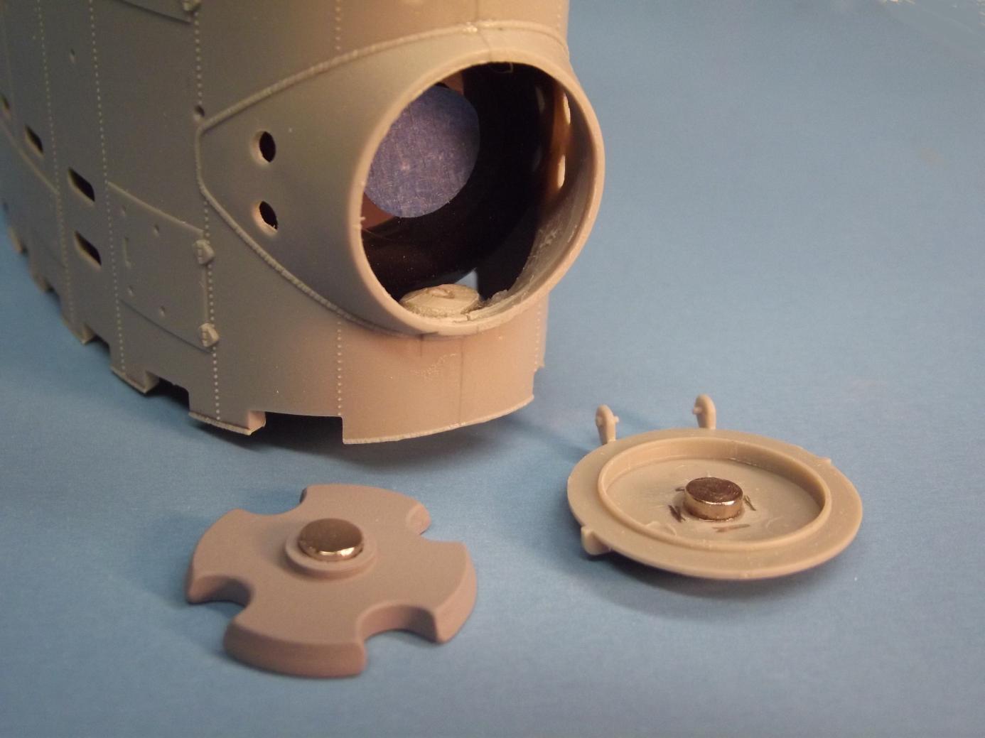

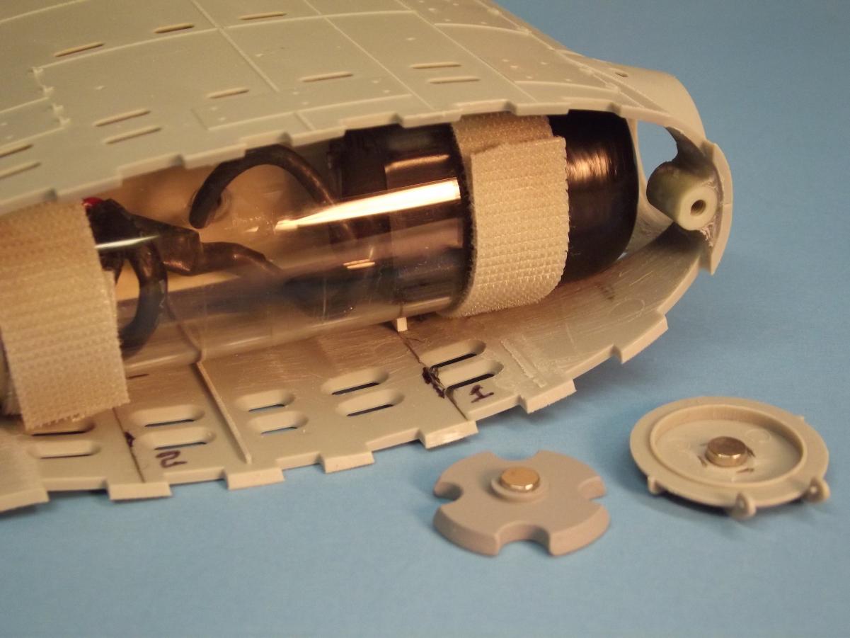

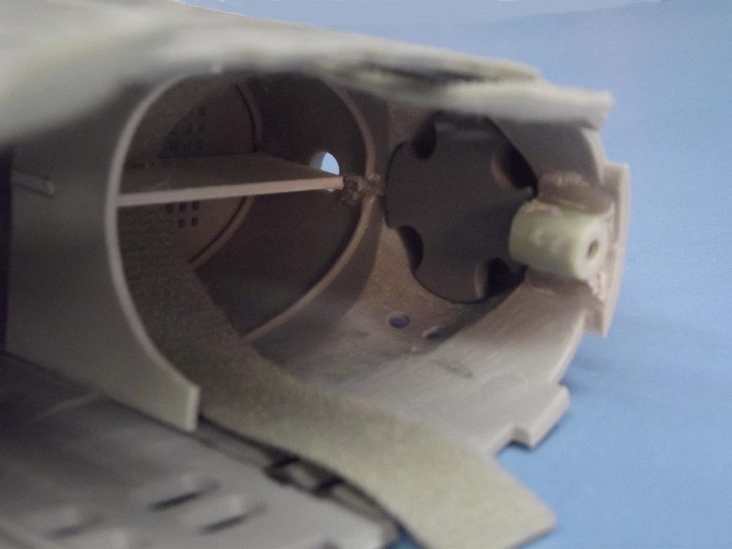

      Ever since Romel got me to make the kit adaptable as a camera platform I was stuck on the problem on how to hold the removable line-locker door in place -- doing so in such a way that did not ruin the scale 'look' and was also easy to achieve. Magnets to the rescue!
      The circular strong-back on the inside of the sail jams into the taper that transitions into the circular flange on which the line-locker door seats. Put a magnet in the center of the strong-back, put a magnet in the center of the doors inboard side, and you're in business!
      When using the video camera-transmitter you take the strong-back and line-locker door and put them in safe storage so the camera can shoot through the resulting hole. Operate without the camera-transmitter and you make up the strong-back and line-locker door. Simple

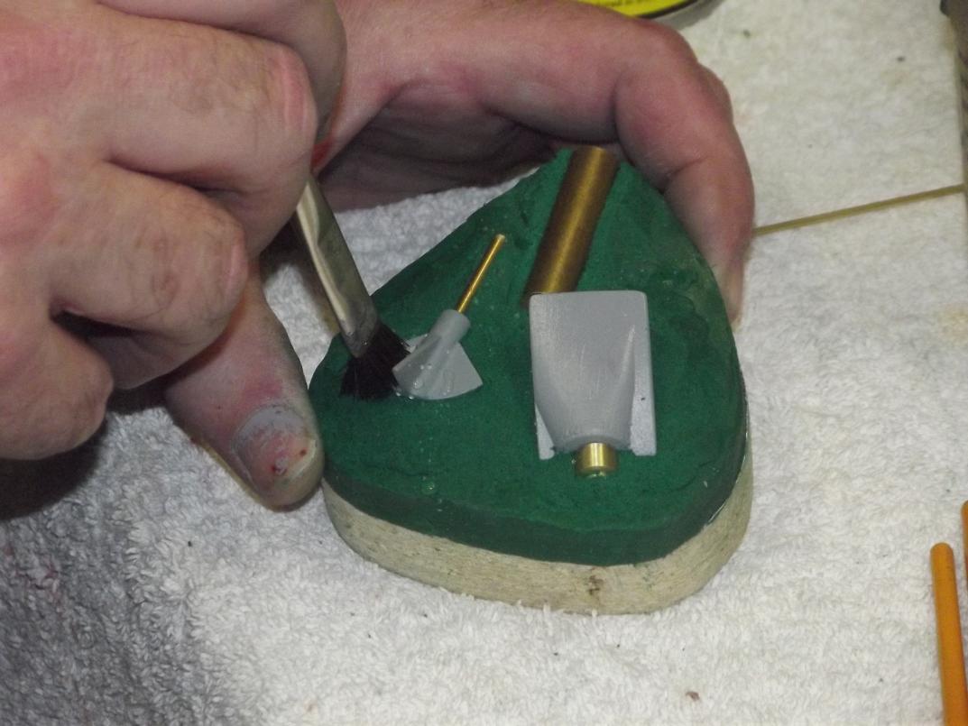

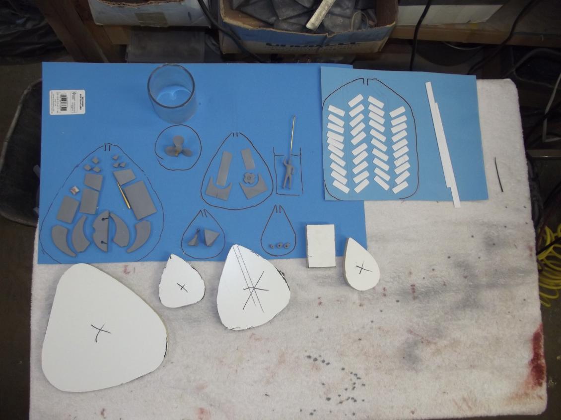

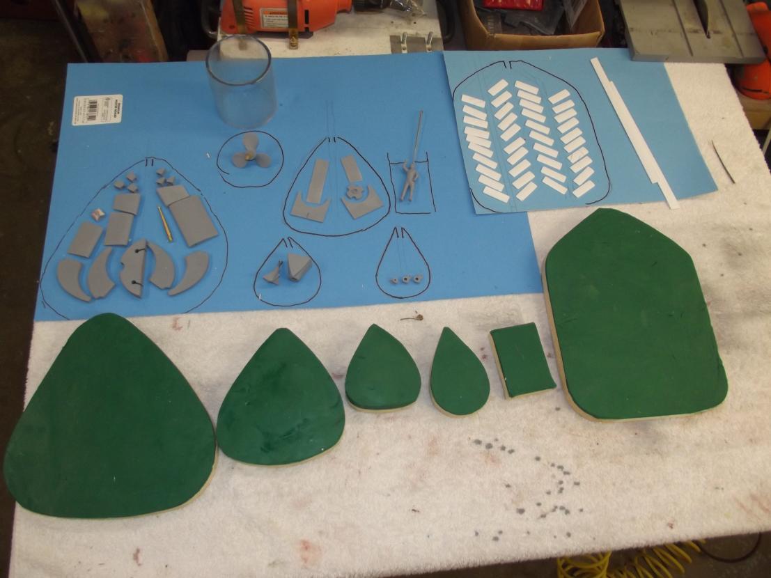

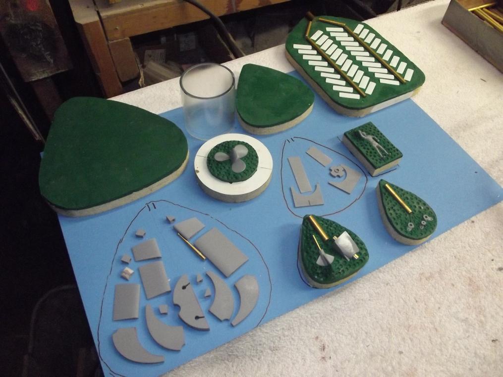

      So, when Ellie does not have me playing Plumber, I'm claying up the Bronco 1/35 Type-23 fittings kit masters. I'll finish that work tomorrow. Rubber should be in by Friday and I want to be ready for that.

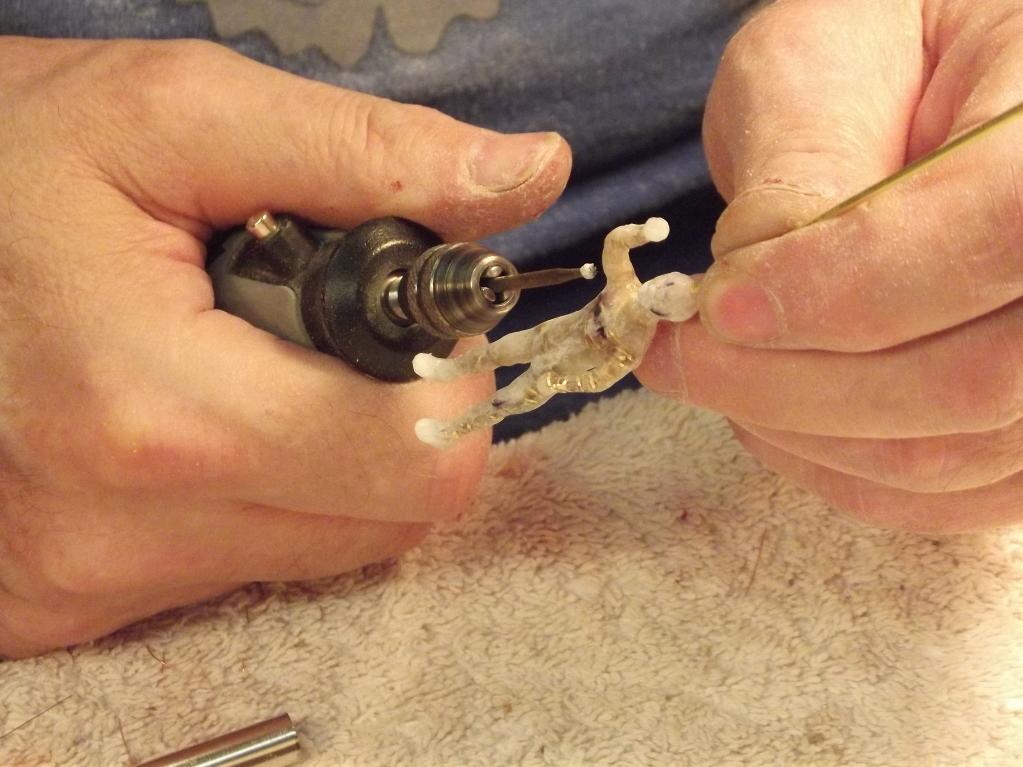

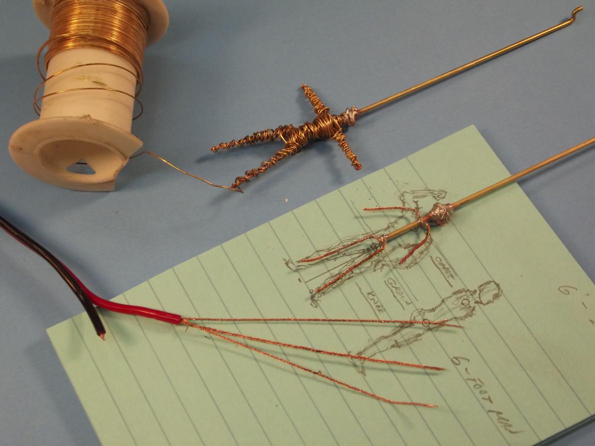

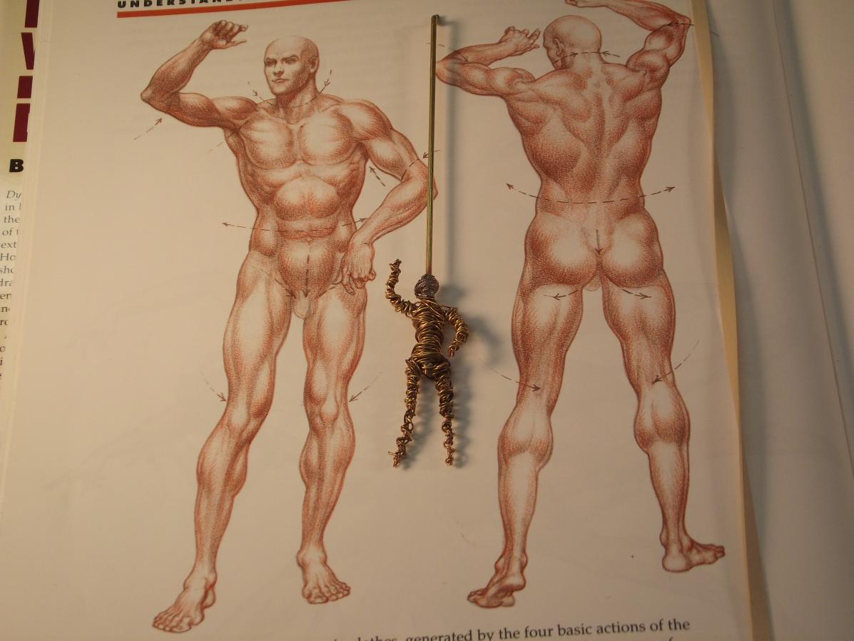

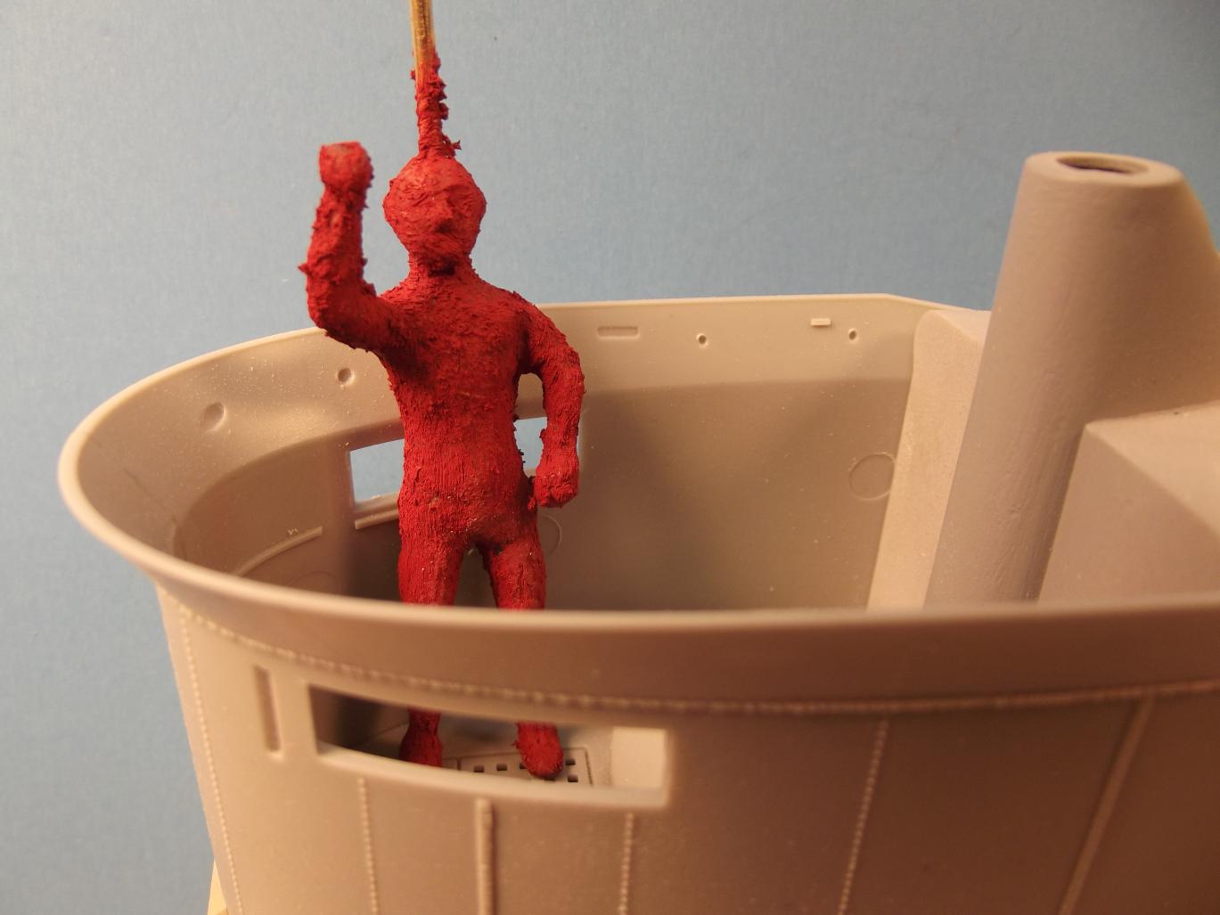

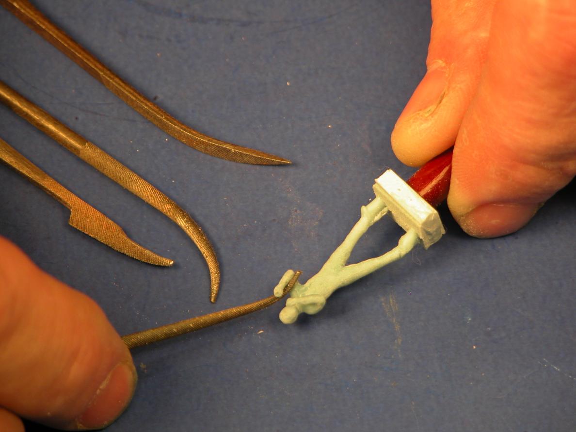

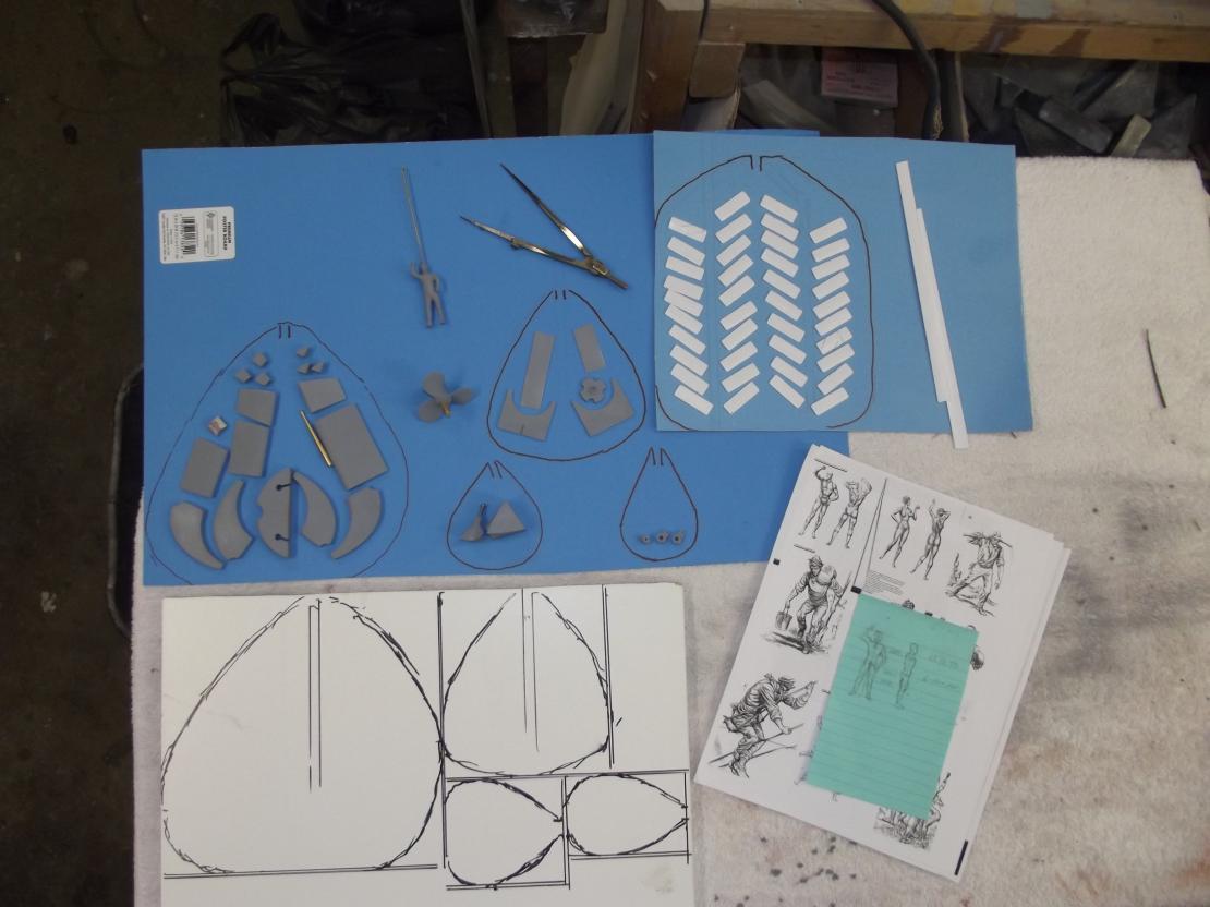

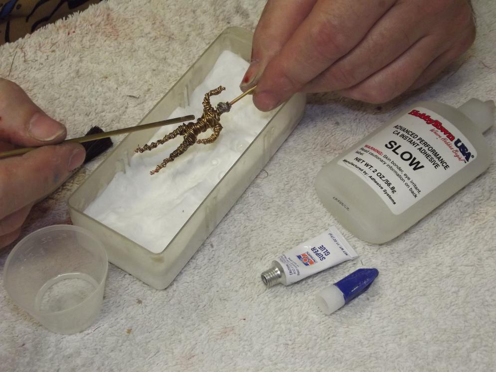

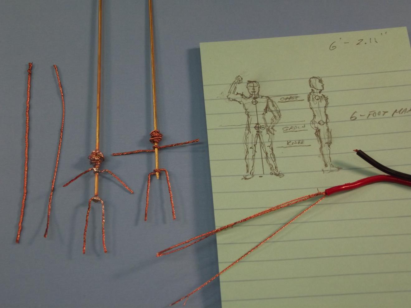

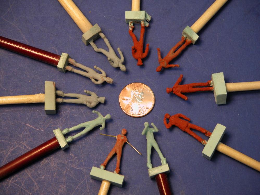

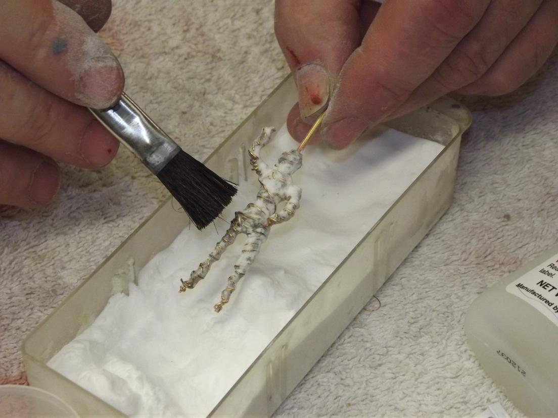

      And I'm working up a 1/35 'generic' figure. From that tool I'll cast up a bunch of blanks -- those little figures will be dismembered, reassembled, and detailed to represent a proper bridge crew at work up high in the sail. Time permitting, some deck-hands.

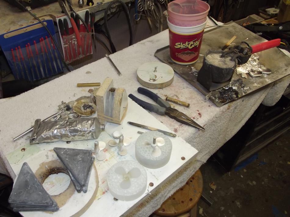

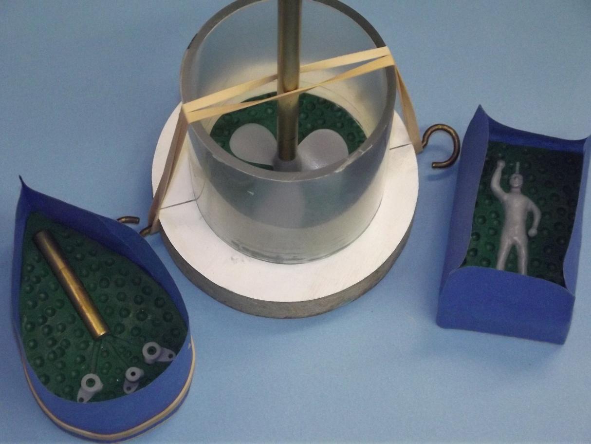

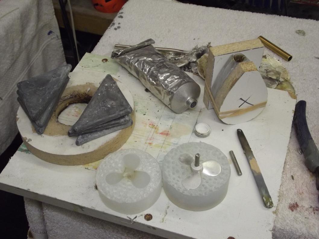

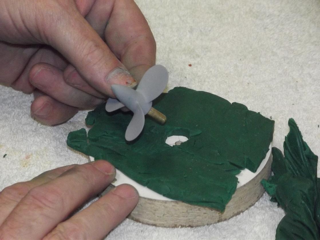

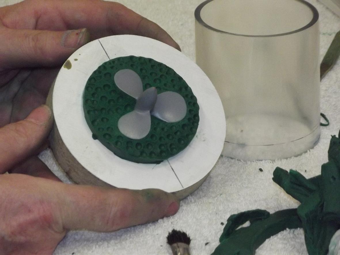

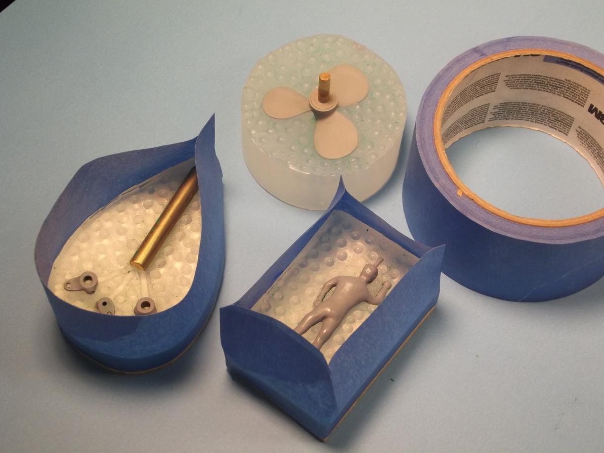

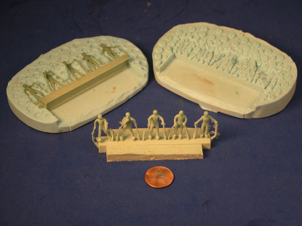

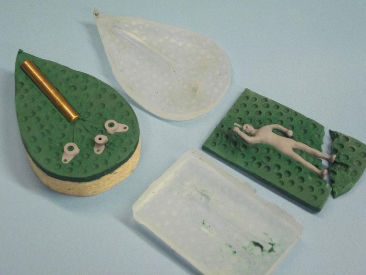

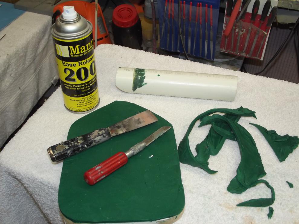

                While awaiting the big order of mold making rubber from BJB, I took what was left here to make the metal casting tools for the propeller and bell-cranks, and the tool needed to cast up a bunch of resin 1/35 U-boat crew figures -- from those castings I would individualize each in either in the winter officer or enlisted garb appropriate for a late war German submarine crew. Once I have a hand-full of Type-23 ruffian's I'll use those to make the final crew production tool.
ID:	76906Click image for larger version
ID:	76907Click image for larger version
                As an example of the figure work yet to be done on the blanks, I submit these shots of the work I did in support of the aborted 1/72 FOXTROT effort. Gotta tell ya: it's a lot easier working 1/35 figure masters than 1/72!!!
ID:	76909Click image for larger version
ID:	76910Click image for larger version
ID:	76911Click image for larger version

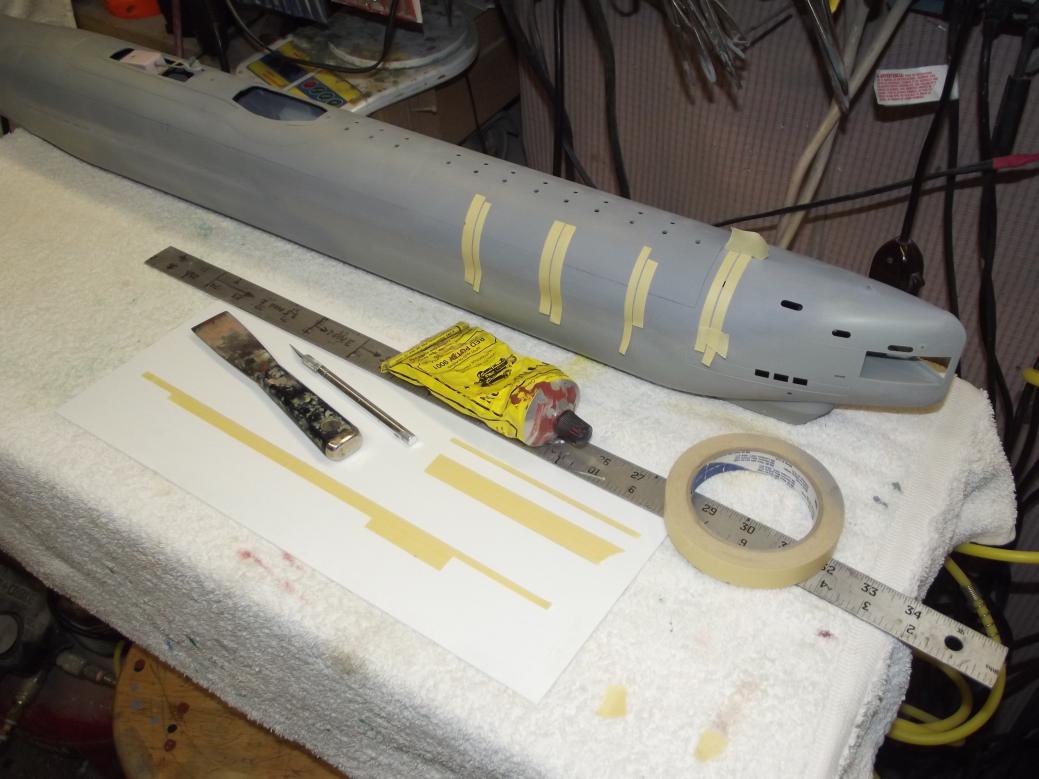

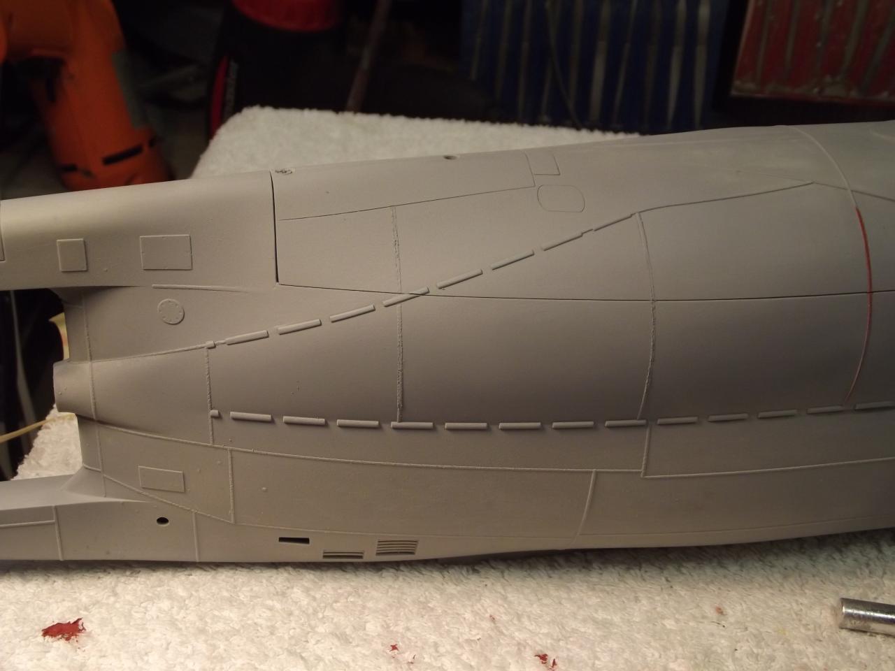

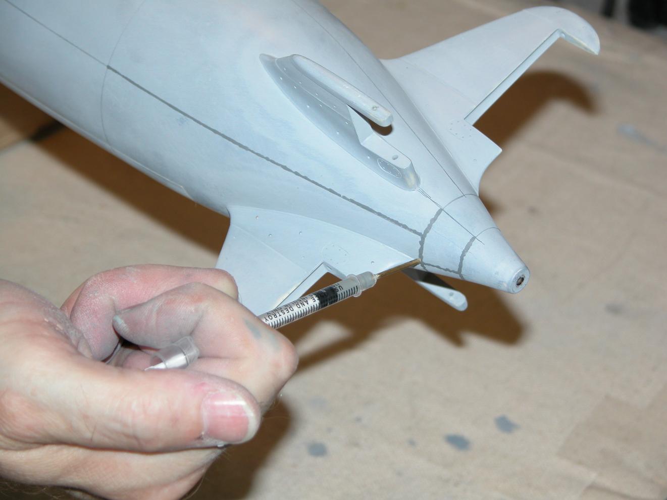

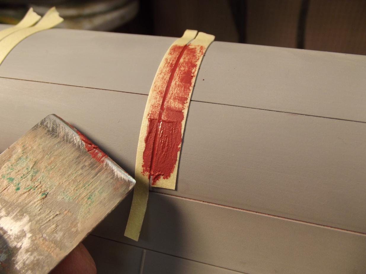

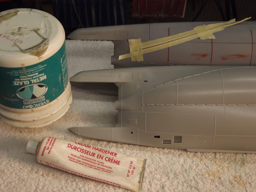

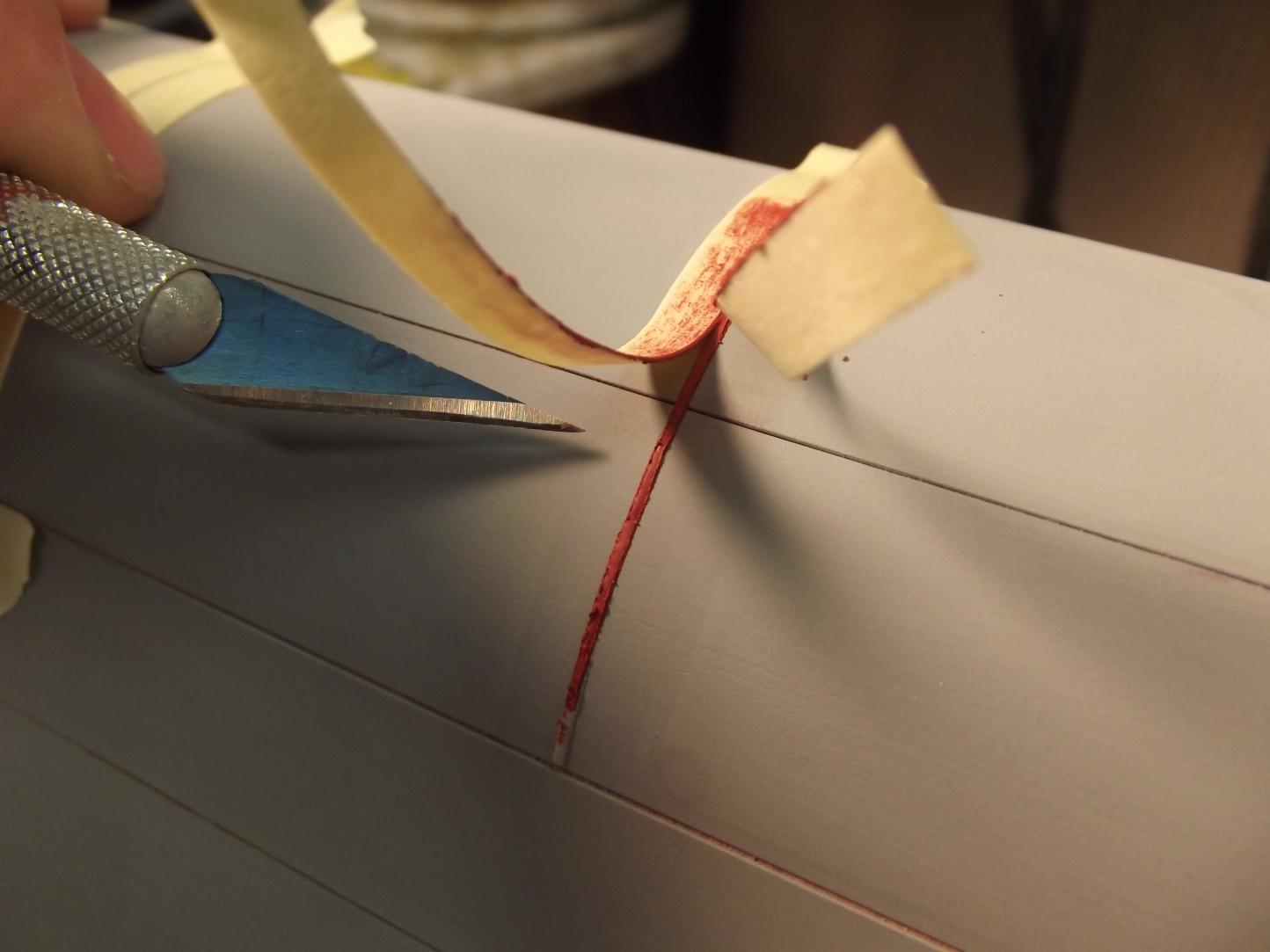

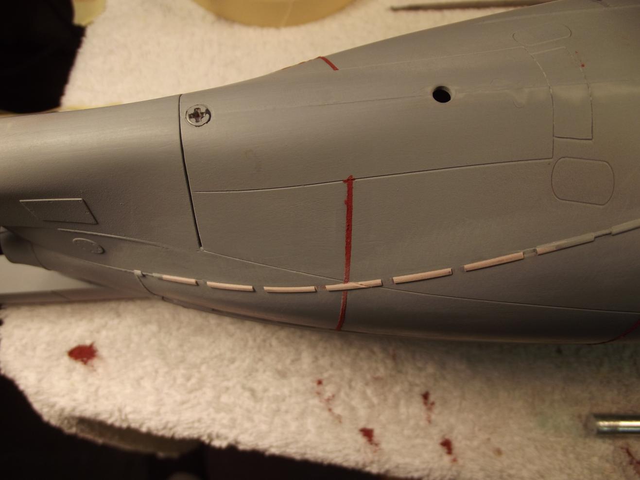

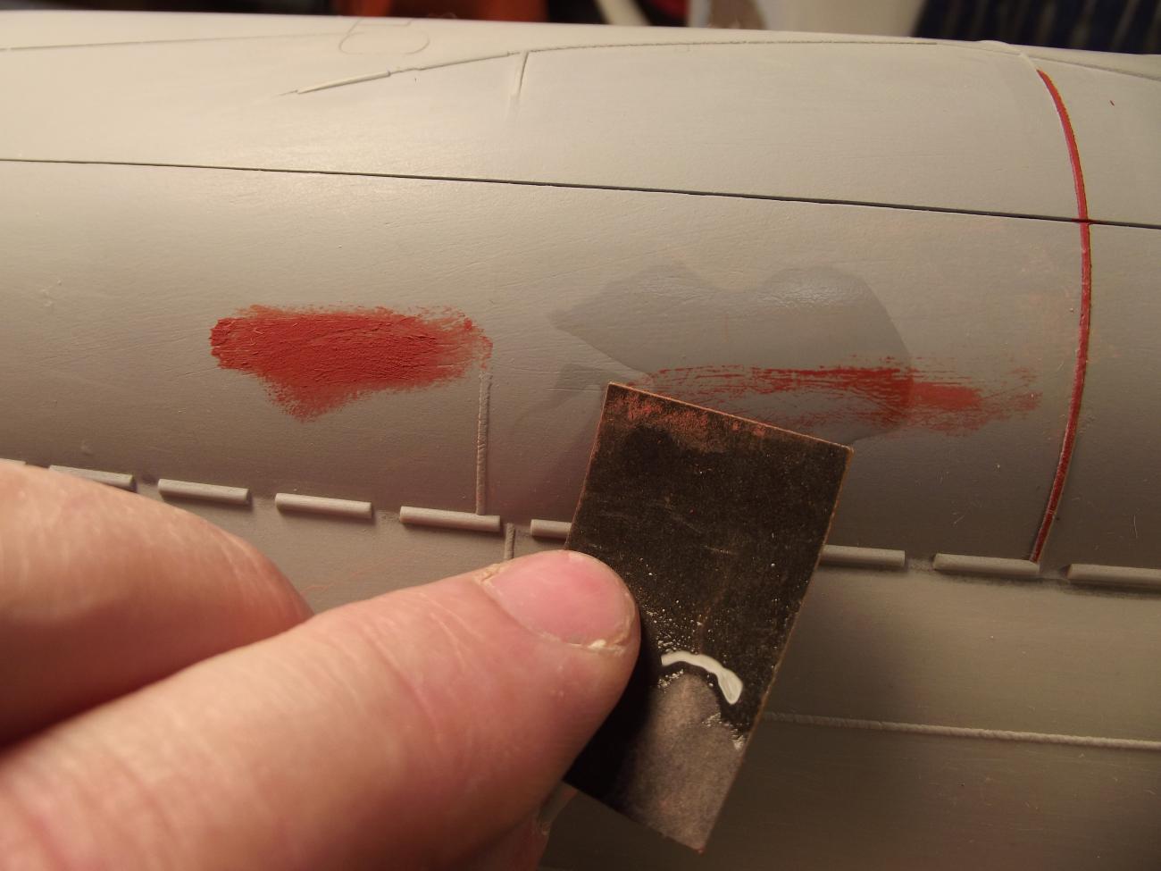

                With all the major surgery done on the hull time had come to rebuild the weld-lines lost to file and sandpaper and I cleaned up the split between upper and lower hull. The weld-lines were built up of air-dry touch-up putty and the big 'bricks' near the stern formed from a two-part automotive filler followed by some careful work with knife, file, and sanding squares.
ID:	76913Click image for larger version
ID:	76914Click image for larger version
ID:	76915Click image for larger version
ID:	76916Click image for larger version
ID:	76917Click image for larger version
ID:	76918Click image for larger version
ID:	76919Click image for larger version
ID:	76920Click image for larger version

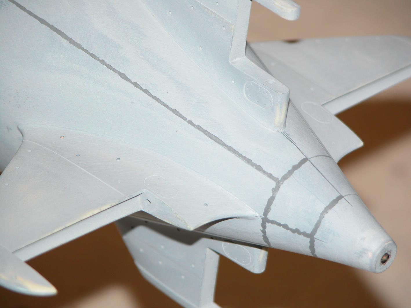

                In the gap between the 'bricks' can be seen a short length of weld-line. I'll likely re-establish those like what I did on the 1/12 KAIRYOU:

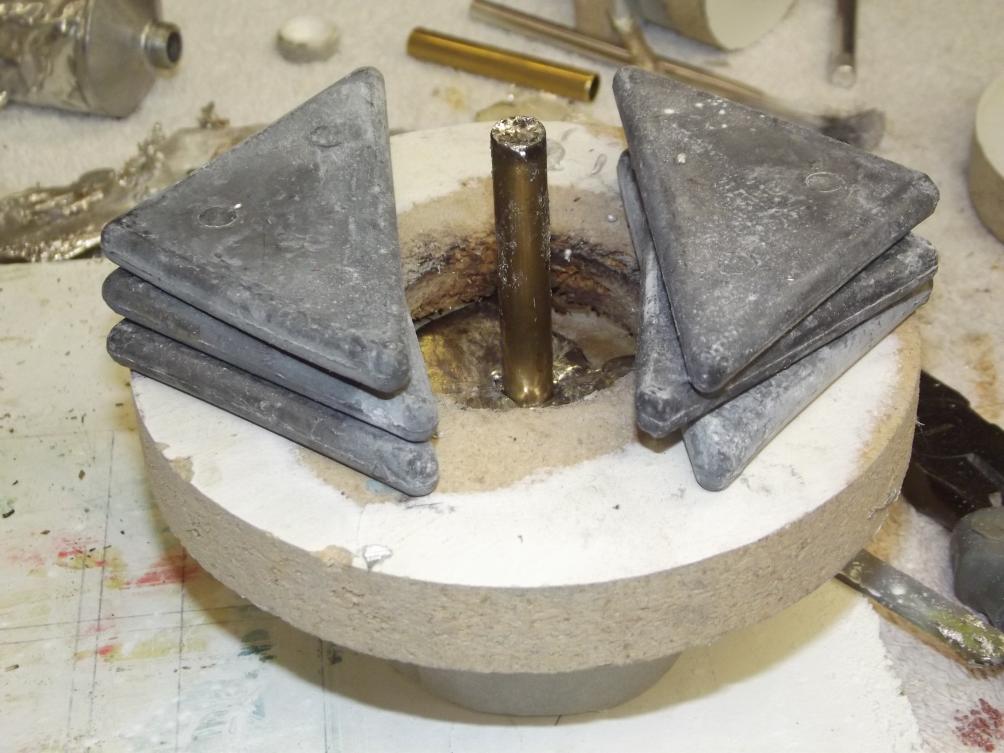

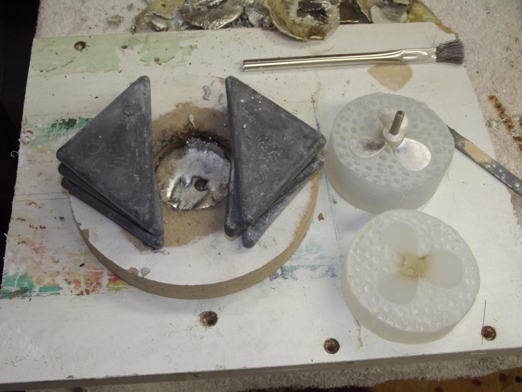

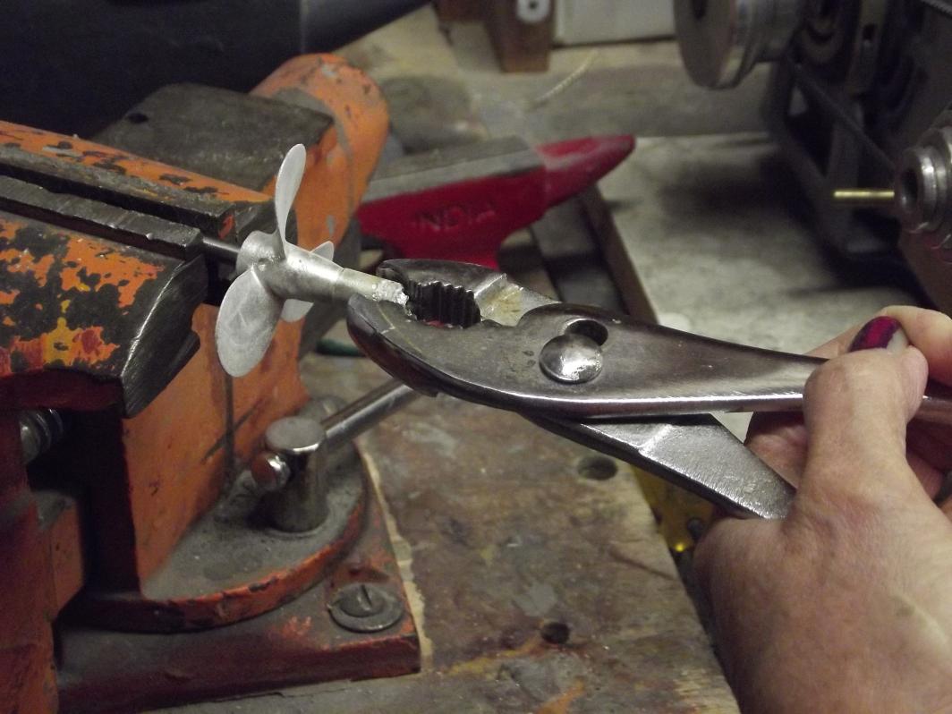

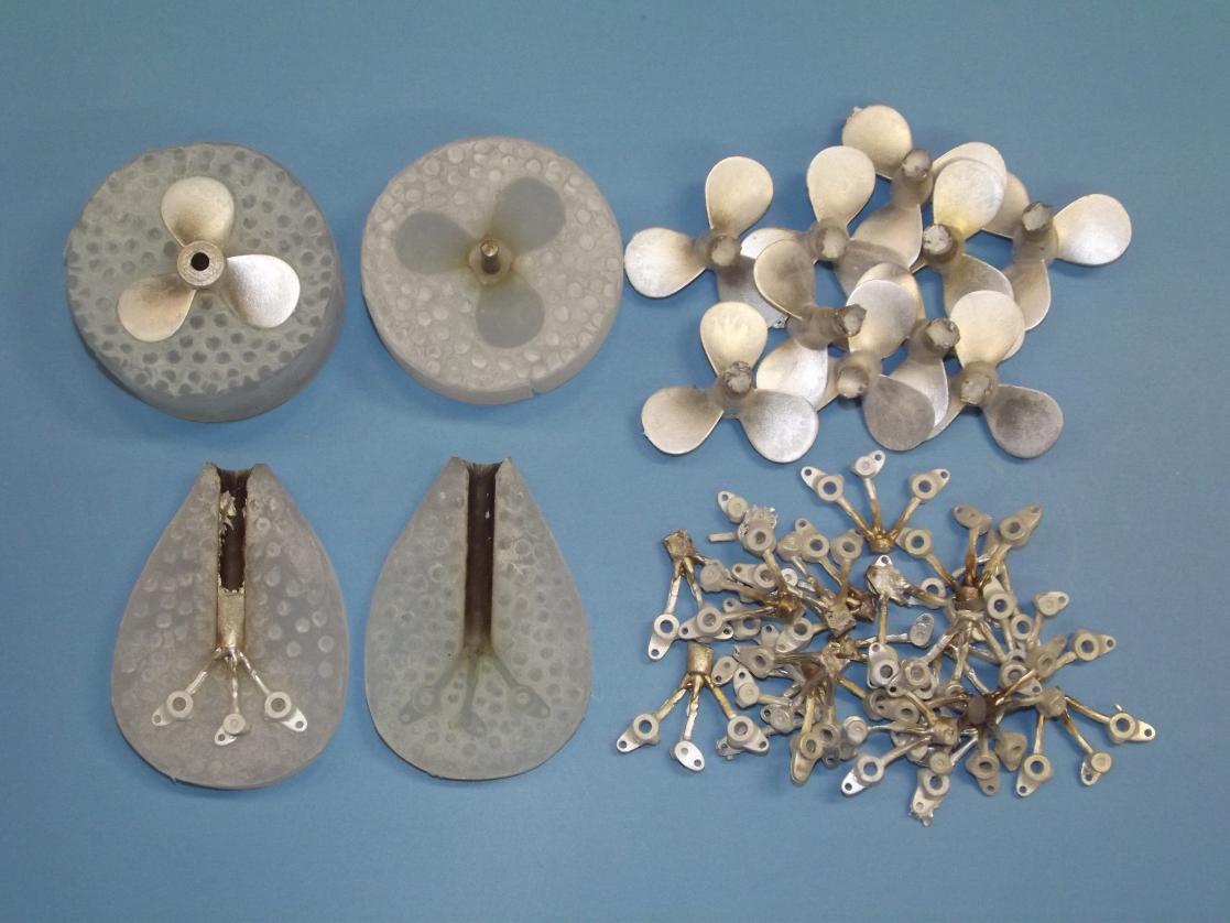

                          Though the BJB TC-5040 silicon mold-making rubber is not advertised for high-temperature work, I find, in a pinch (when I run out of TC-5050), that it will work fine with white-metal work. This evening I made some test shots with the tools, and they are holding up just fine.
                          Now to make some holding fixtures for the bell-cranks so I can drill and tap their set-screw holes. Time permitting I'll shape the propeller dunce-caps, bore and tap the set-screw holes, and work out how the production propeller shaft and bearings will go. Another long night/early morning ahead of me ...
ID:	76926Click image for larger version
ID:	76927Click image for larger version
ID:	76928Click image for larger version
ID:	76929Click image for larger version
ID:	76930Click image for larger version
