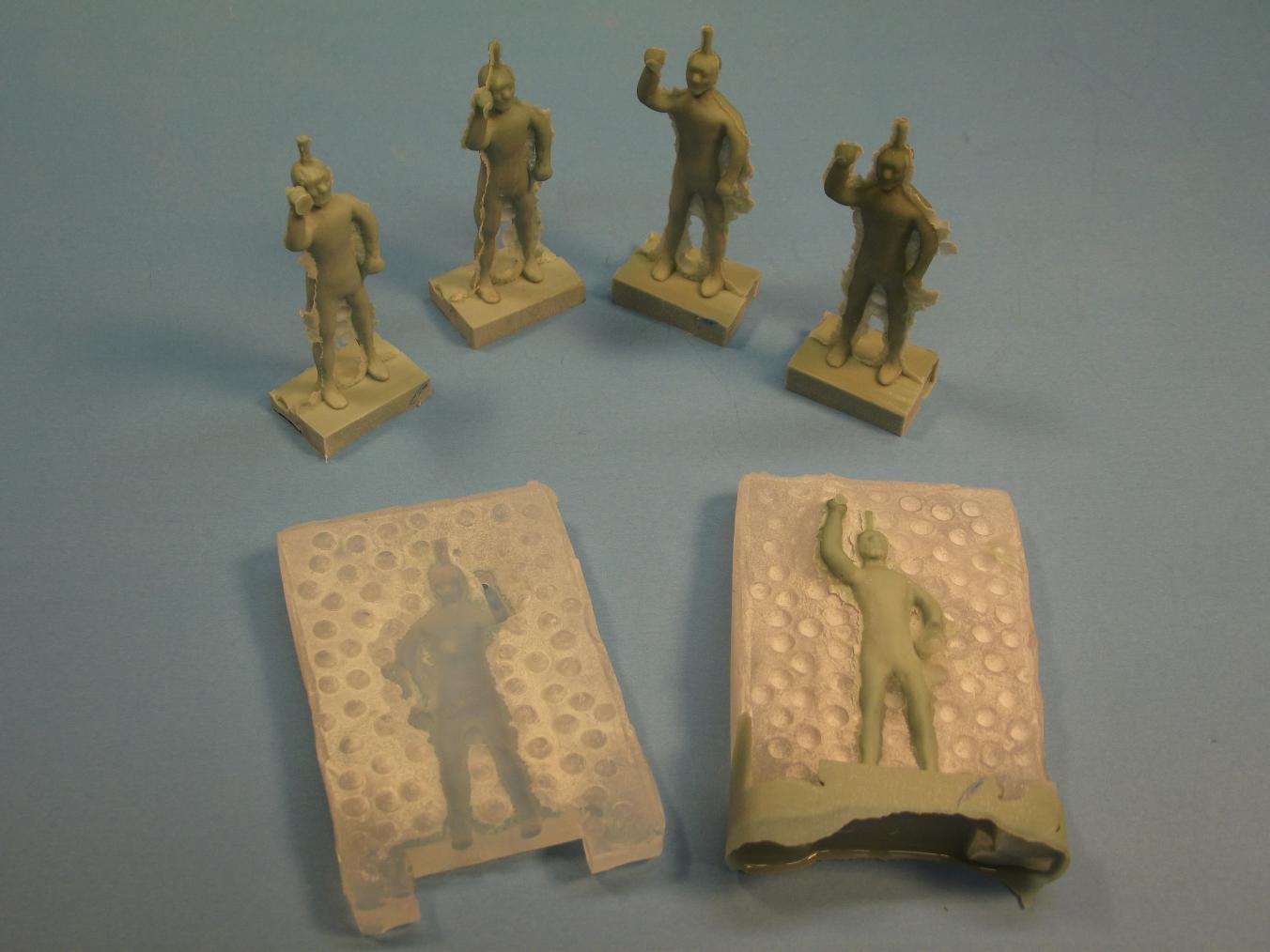

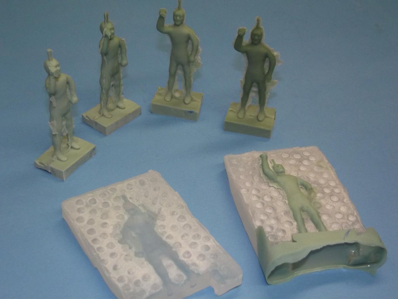

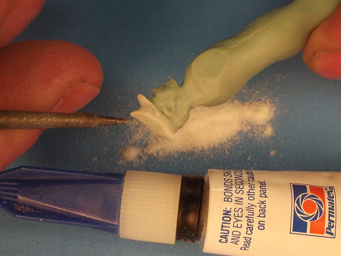

          Sorry, Dan. (I'm working all day to take care of you, Steve, Mamas, and the other guys I have stuff to get off to ... this damned Bronco kit has been all-consuming!).
          Here's what I've done this morning:

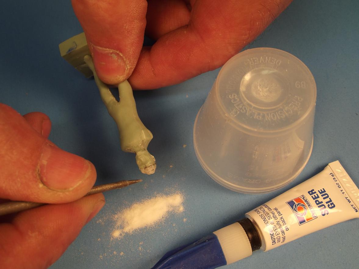

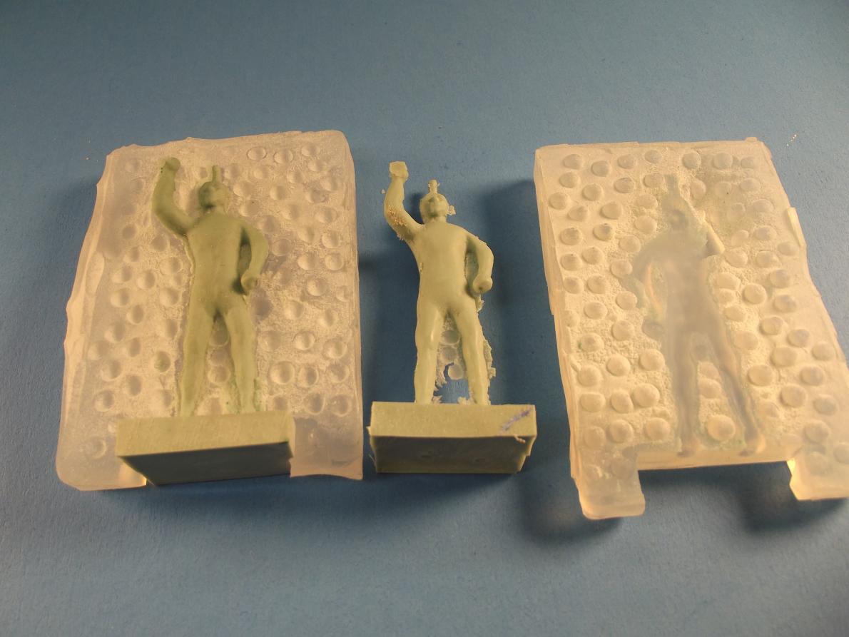

          I want to provide this fittings kit with figures, so I cast up (vacuum assisted) these blanks. Each one will be worked up to represent a specific billet: The CO with his peaked white (dirty white) command-cap, his look-out, and some poor slob on deck with a heaving-line in hand. The enlisted guys topped with garrison caps. All three will be wearing the utilitarian, heavy, one-piece overhauls you see in crew shots towards the end of the war. These boats came into their own in the winter months.

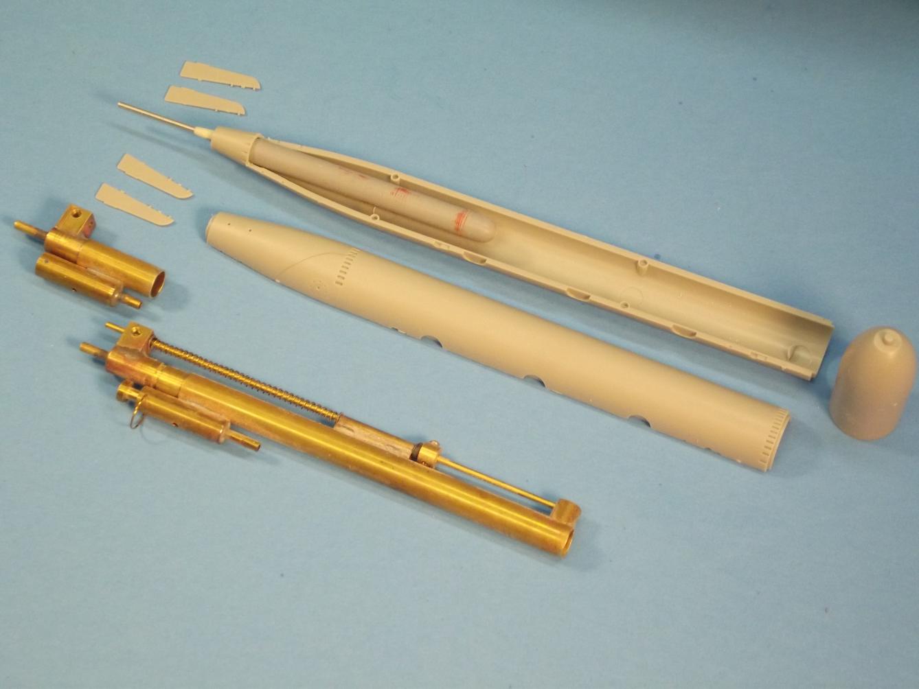

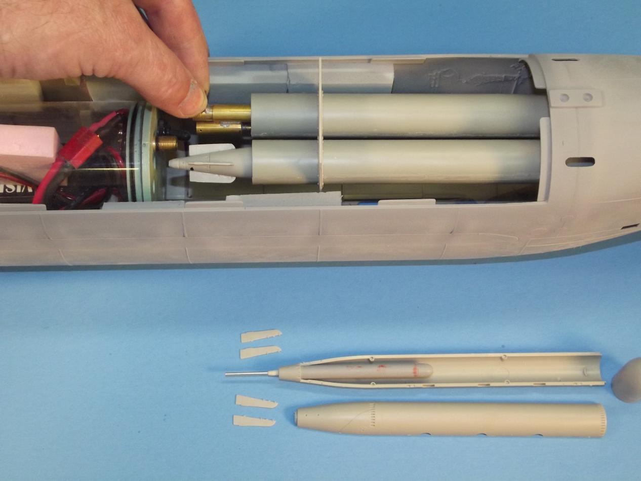

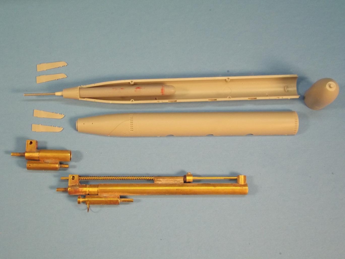

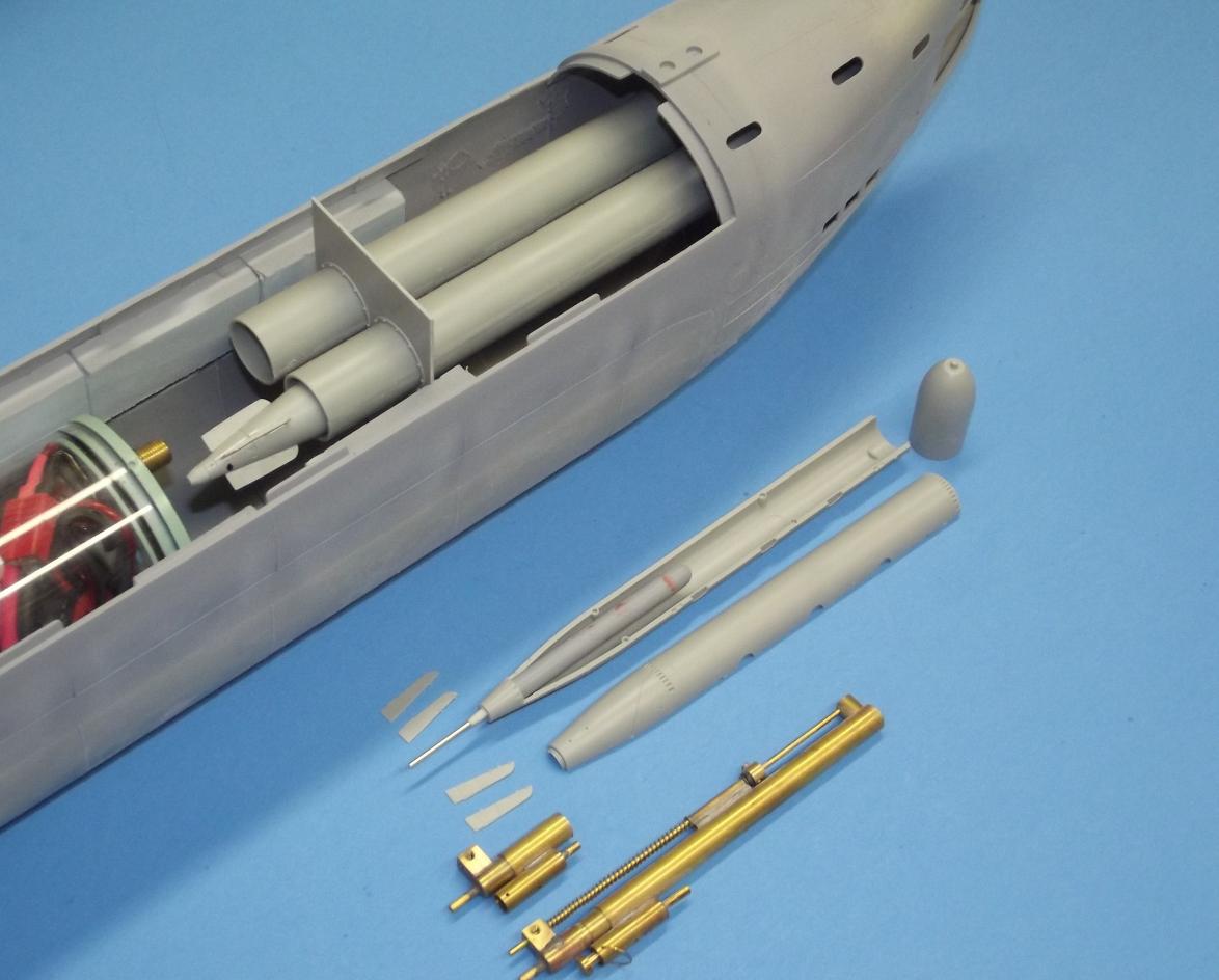

          I'm thinking of simplifying the weapons system here by offering just the breech-end of the launcher with an adapter collar that will make up to the inside diameter of the kit supplied torpedo tube. I'll recommend installing a 'power capsule' (represented here by the way too short 1/72 gas type torpedo body) within the kit supplied torpedo which will be made free-flooding. The kit torpedoes lend themselves to being closed and opened easily as the parts are self-keying. I'll investigate different power-capsule dimensions, volume and weights till I find one that will render the entire assembly neutrally buoyant when charged, and slightly buoyant at the end of run.

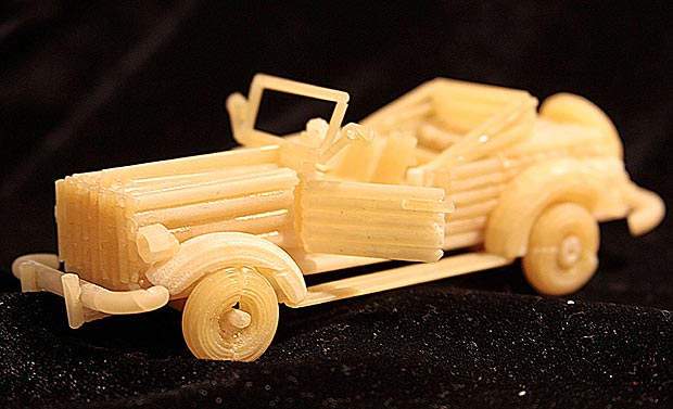

                On the bell crank hole drilling process... What would happen if you used a dry piece of spaghetti/pasta
                in the mold for the bell crank set-screw holes. It might hold up to the heat. Then just drill or tap through
                the pasta. ??????

                  Sacrificial pasta? Please!!!!!
                  In the past I would insert a stud of appropriate thread-cut in the tool to form the required bore, but that was too much work. With a holding fixture (designed to hold up to four pieces at a time) the work goes very quickly.

                    Though the BJB TC-5040 silicon mold-making rubber is not advertised for high-temperature work, I find, in a pinch (when I run out of TC-5050), that it will work fine with white-metal work. This evening I made some test shots with the tools, and they are holding up just fine.

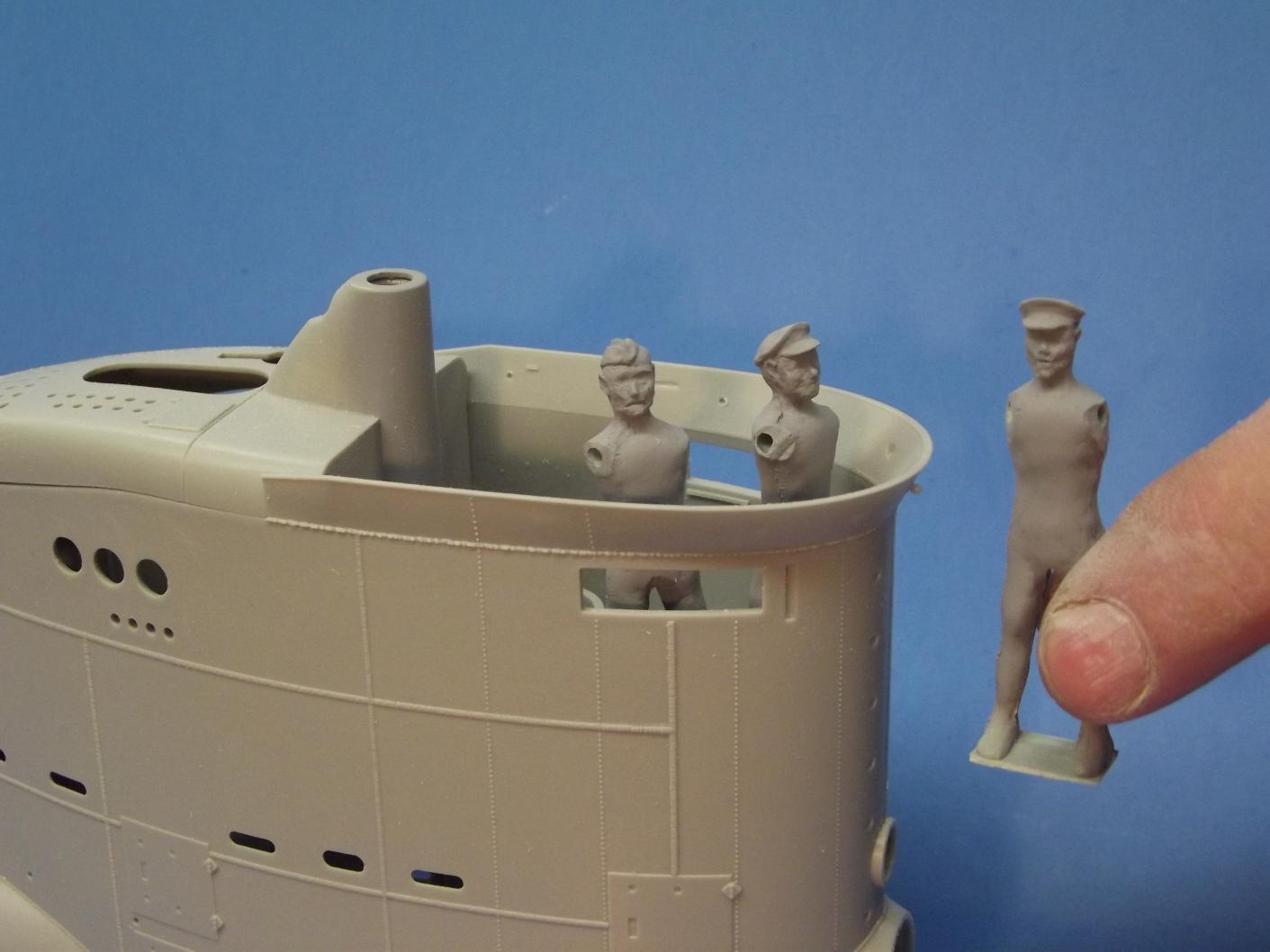

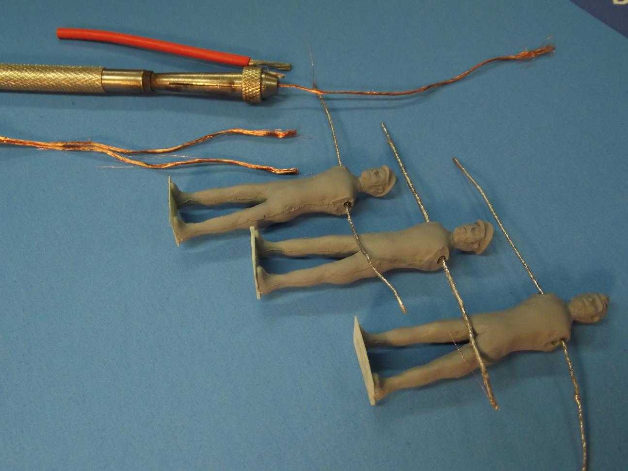

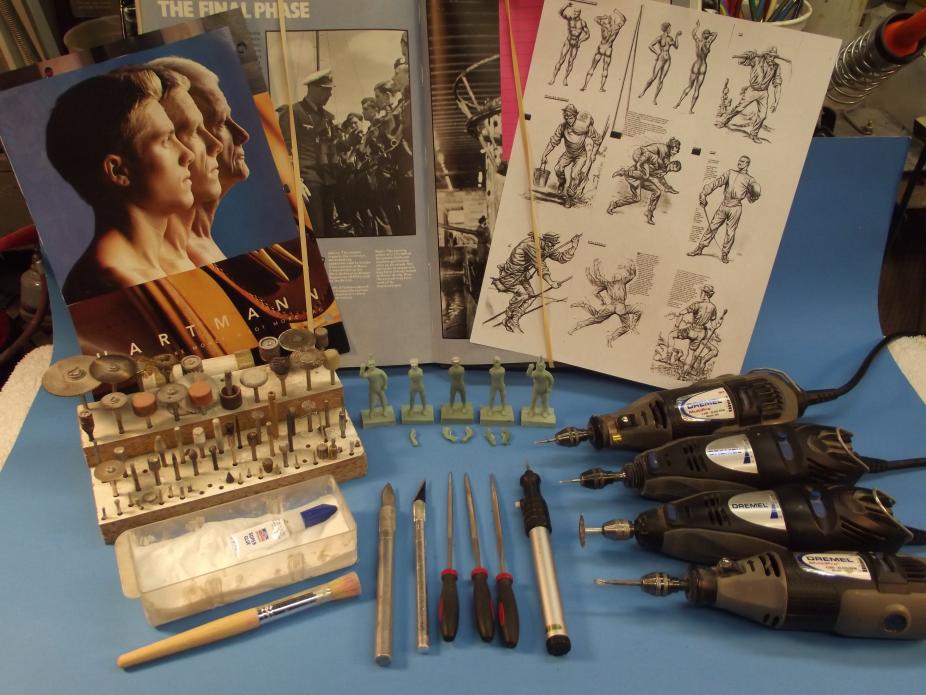

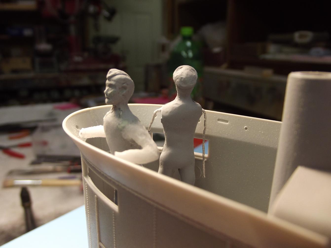

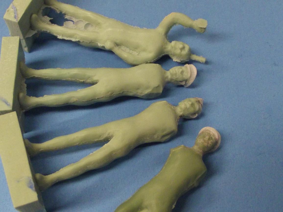

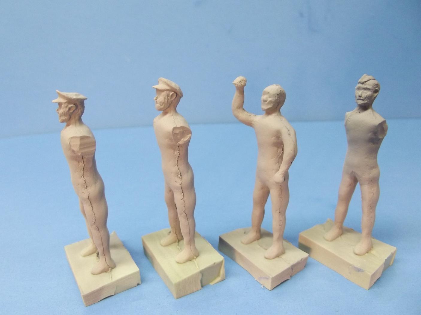

                              Nazi's! ... don't you just hate them. Especially me, after six hours on my butt working out the three bridge watch-standers -- masters from which I will make a tool to produce parts for the soon to be released Bronco 1/35 Type-23 fittings kit.
                              I cast up a bunch of blank 1/35 figures, selected three of them and chopped them up, gave them covers, and am finishing up posing them into realistic postures -- achieving a look like three guys up there who actually have things to do.
                                They had something to do, in particular, while they were in port. Give the Nazi Salute! You gotta have one of the figures saluting.. Otherwise, I will have to break an arm off and modify it so the little man gives a proper salute. "Pappy" Dönitz had them well trained. The whole Reich was crumbling around them and they were still saluting and throwing themselves into the fight. You gotta love the determination of these guys.. Plus taking time to implement the Kriegsmarine Honor Roll Clasp award in March 1945. The game is over and they are still concerning themselves with designing and producing awards for the men! They just didn't know the meaning of the word "quit".. Kind of like me, one day, even if it kills me, I will have a proper and "practical" (I love it when David says that) model XXIII uboat terrorizing my local lakes..
