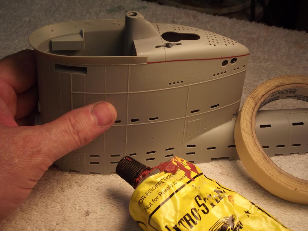

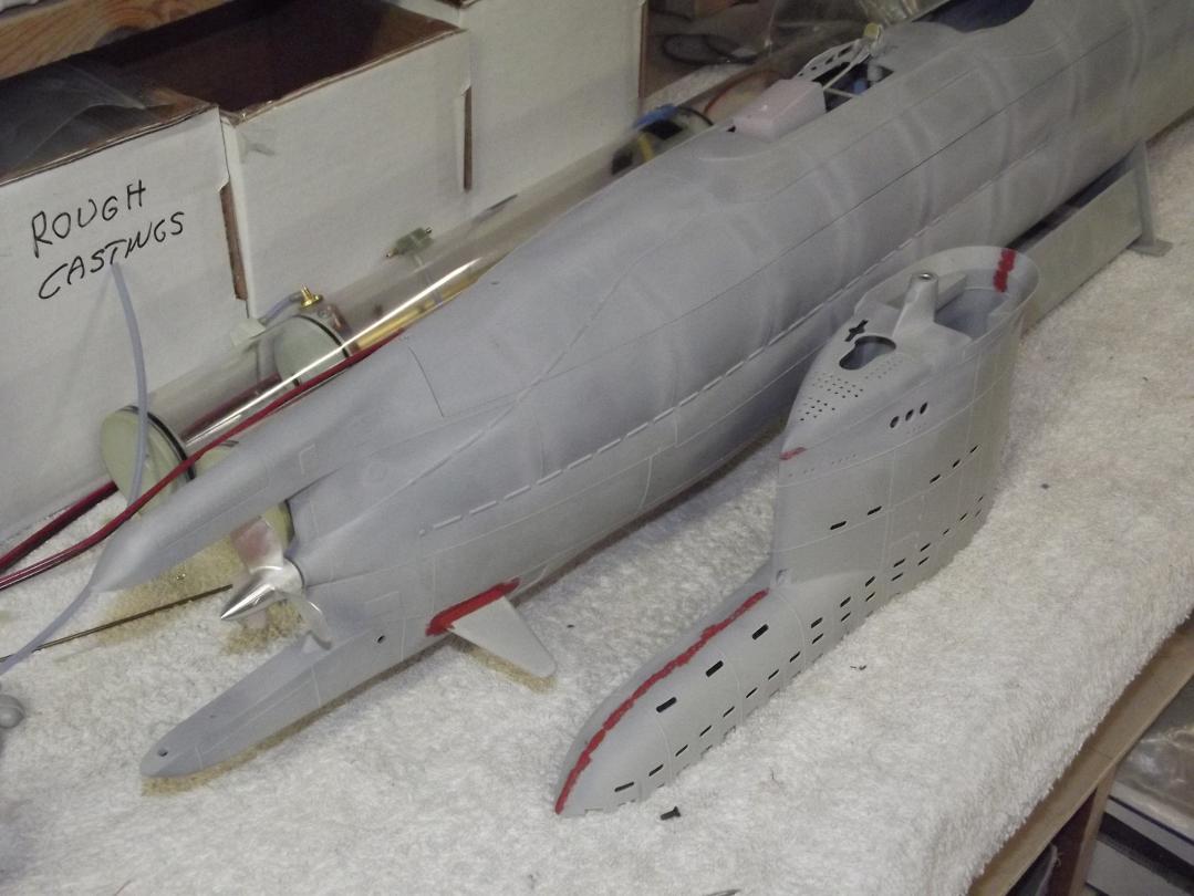

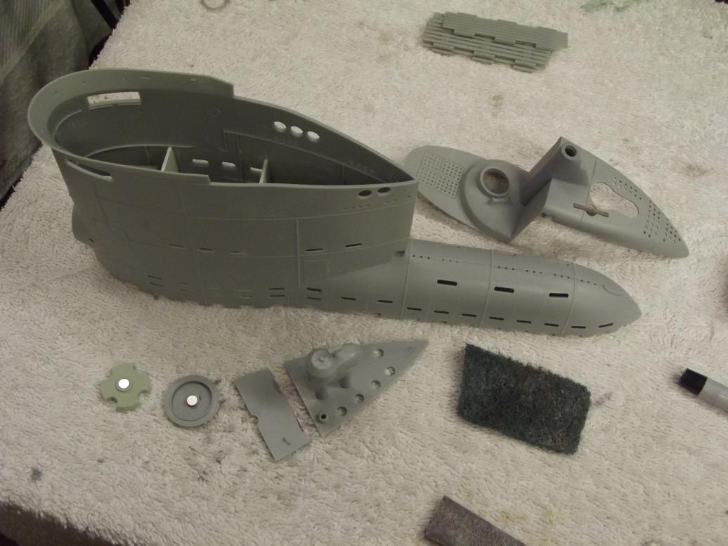

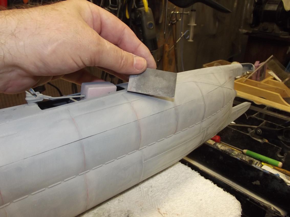

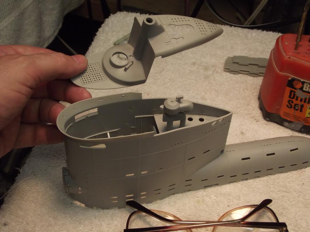

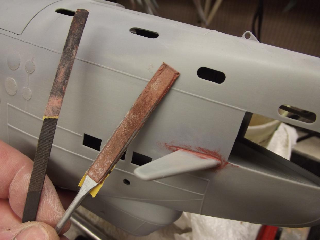

        Some recent work getting the prototype Bronco 1/35 Type-23 kit completed. Also some rough shots of the -- soon to be commercially available -- fittings kit.
        We have our first public r/c boat run on the 18th and I want this bad-boy to be ready for our show at Nauticus. Gotta make the Koi pond there safe for National Socialism!

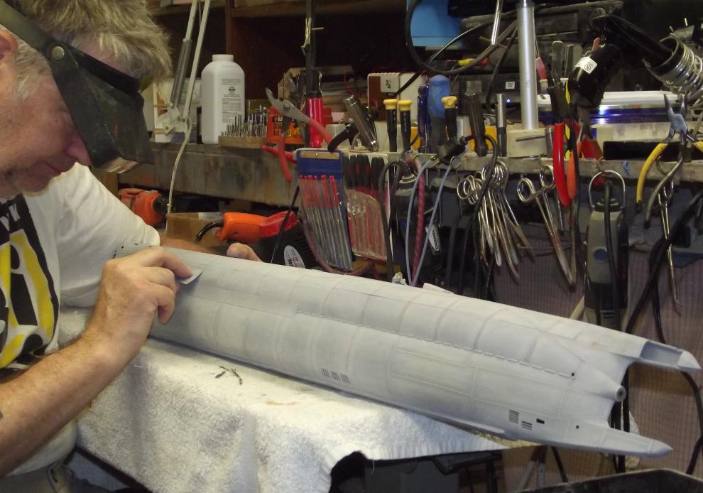

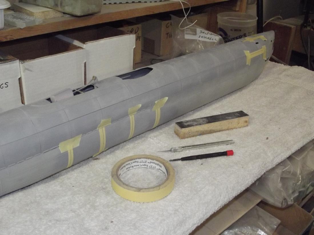

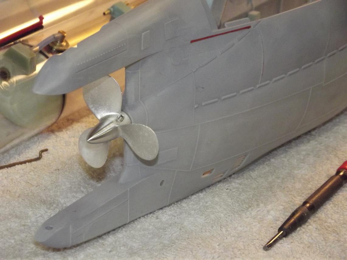

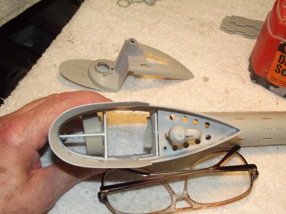

                  Some of yesterday's work. Hope to get base colors down tonight.

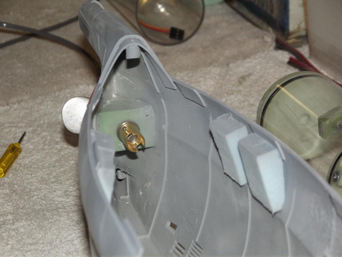

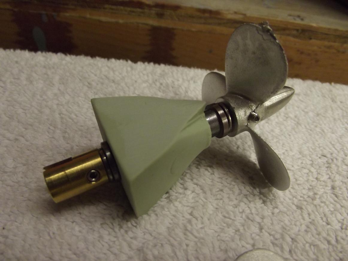

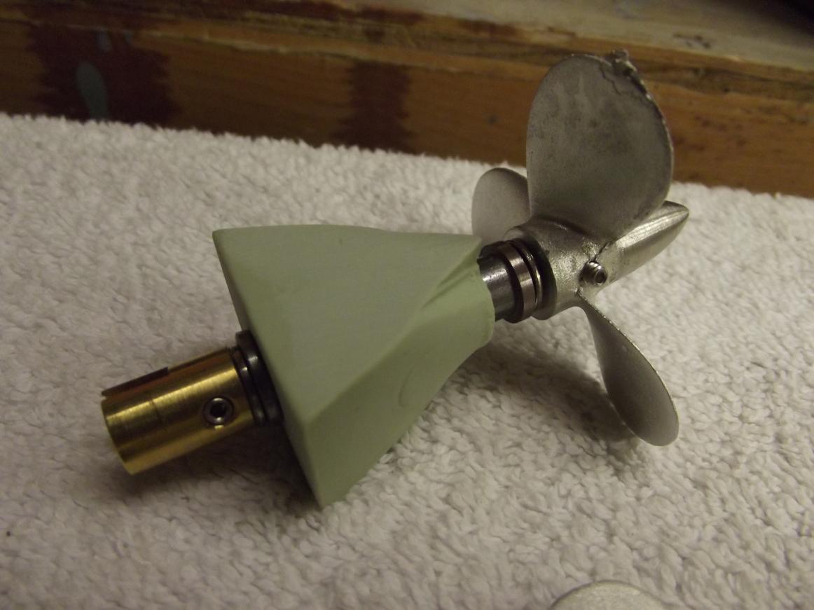

                      Will the propeller set screw remain raised some above the hub surface like seen in your first photo? Or has it just not been screwed all the way down. I would think it should sit almost flush with the surface of the hub.
                      Looks like you have chosen to mount the schnorkel, fixed, in the lowered position. I'd like to have mine raised, so I can use the schnorkel shaft to visually track the boat in my lakes out here (with their somewhat poor water visibility), while it is running submerged.
                        I gotta find a 4-40 X 3/32" long set-screw source! 1/8" is too short, and 1/4" is too long. Damn!

                          You say you need 4-40 x 3/32". I have seen 4-40 x 1/8" set screws online, $5.37 for 100 screws, at the supplier in Texas below. They don't have 3/32" in 4-40, at least not listed on their site.
                          1/3" is too short, and 1/4" is too long? That makes no sense.. Must be a typing mistake..

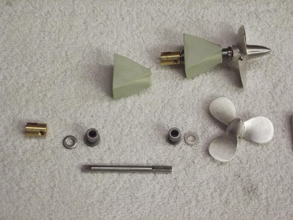

                          Why use a set screw at all on the prop? Why not a threaded prop shaft and threaded propeller, like my 32P kit came with? You are already having to tap the side of the hub, for the set screw, why not tap the shaft end of the hub instead?
                          I am assuming doing that might make your manufacturing process for the propellers more difficult.. You must have had a reason for going with a set screw.
                          I have no experience with set screws on sub propellers, but I do find them annoying on my RC tank.
                          My Tamiya 1/16 Tiger tank, has axle drive shafts that are secured to the gearbox output shafts via set screws. I have found that after running the tank for a while, the set screws ALWAYS loosen and start backing off, causing the axle shafts to wobble a bit. They are not easily accessible without partially disassembling the tank. Actually, as I recall, I have to remove the gearboxes from the hull entirely, to crank them back down. Some guys put glue or thread lock on the set screws. I guess that is the only way to keep the damn things in place. Then maybe they become set in place permanently, which would be a problem for maintenance if you ever want to remove them. Maybe I should quit *****ing about it and just put thread lock on them..
                          By the way, in general, those Tamiya tanks are like babies and need constant attention.. At least I've found the Tiger to be that way. Apparently the real Tigers were not much different in that regard.

                            I use the set-screw on the propeller as I use a Dumas style universal coupler on the forward end of the propeller shaft. I have to first run the shaft through the stern tube from the inside with the coupler already made up. Could not do that if I screwed the propeller down first.
                            I've played with different propeller-coupler-shaft arrangements. This current one suits me and my machiness.

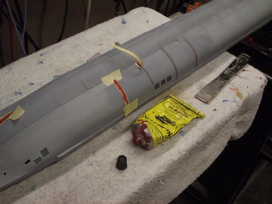

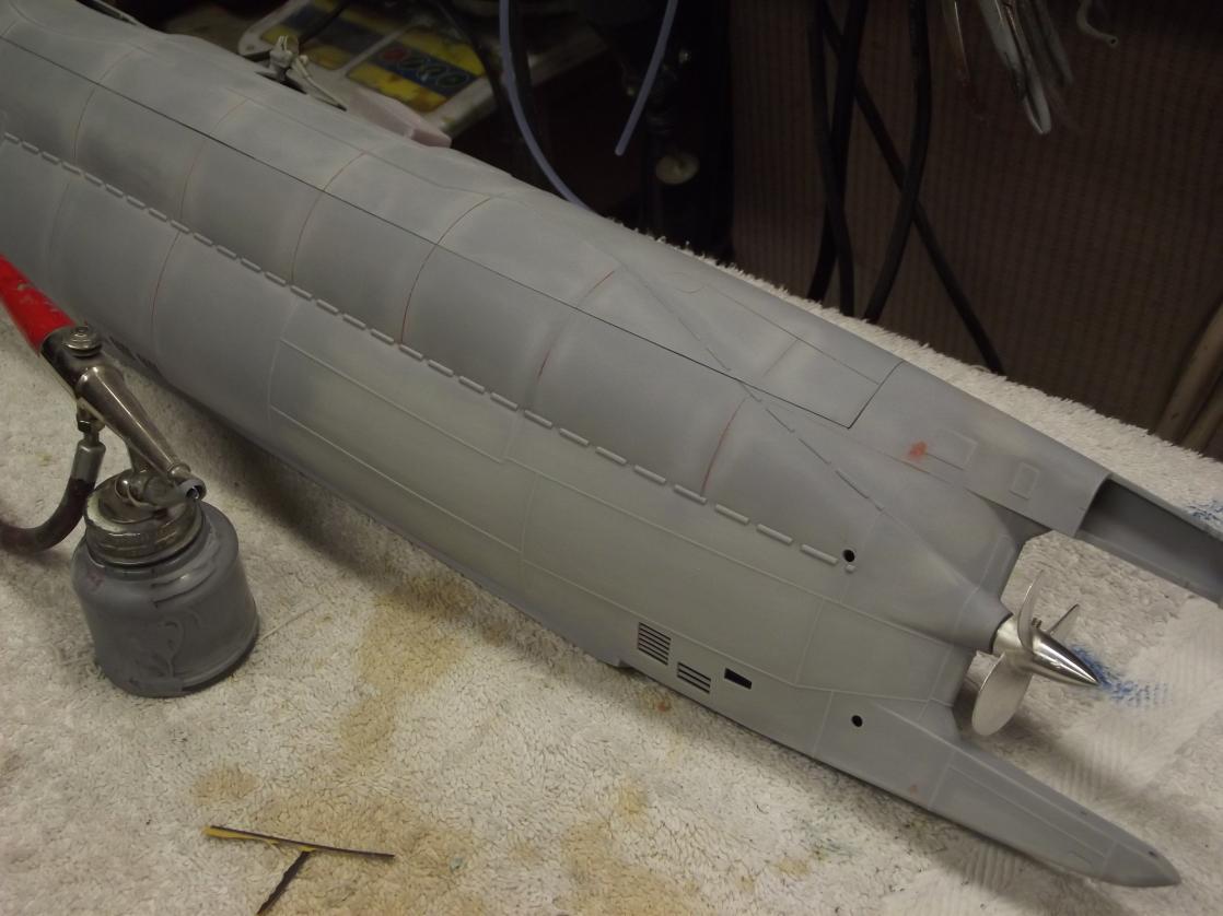

                            Started painting the Beast today -- stay tuned for pictures later.
                              [ATTACH=CONFIG]20100[/ATTACH][ATTACH=CONFIG]20101[/ATTACH][ATTACH=CONFIG]20102[/ATTACH][ATTACH=CONFIG]20103[/ATTACH]
                              If you meant 1/8" is too short, 1/4" is too long, then wouldn't you need 3/16", not 3/32" length set screws? If so, the supplier I linked to does indeed carry 4-40 3/16" set screws. I am not trying to be a PIA, just attempting to help.

                                And helpful you have been. I'll check into that supplier. 3/16" would do the trick. Thank you.
