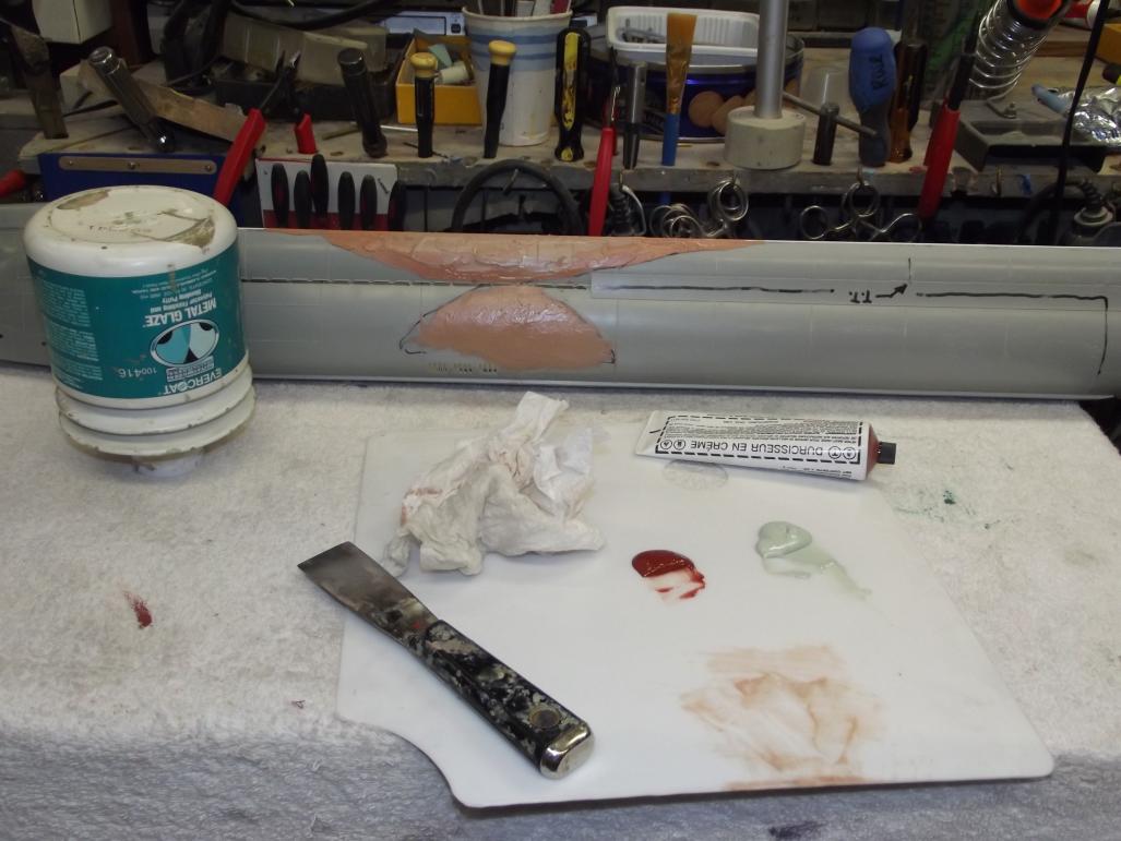

      As I mentioned, there is a decided 'pinch' mid-hull. I elected to build up this depression and get the hull to a more uniform 'double-cylinder' form. I did this with a two-part Bondo-like automotive filler, followed by a scratch-fill with Nitro-Stan air-dry touch-up putty, which was sanded down, and the first of many primer coats applied with the air-brush.
      Sure, I clobbered the raised weld lines. So what? They're over-stated anyway. Not sure if I'm going to rub them all off or not. If I want to retain them I'll re-build the ones lost during the filing and sanding with CA. We'll see.

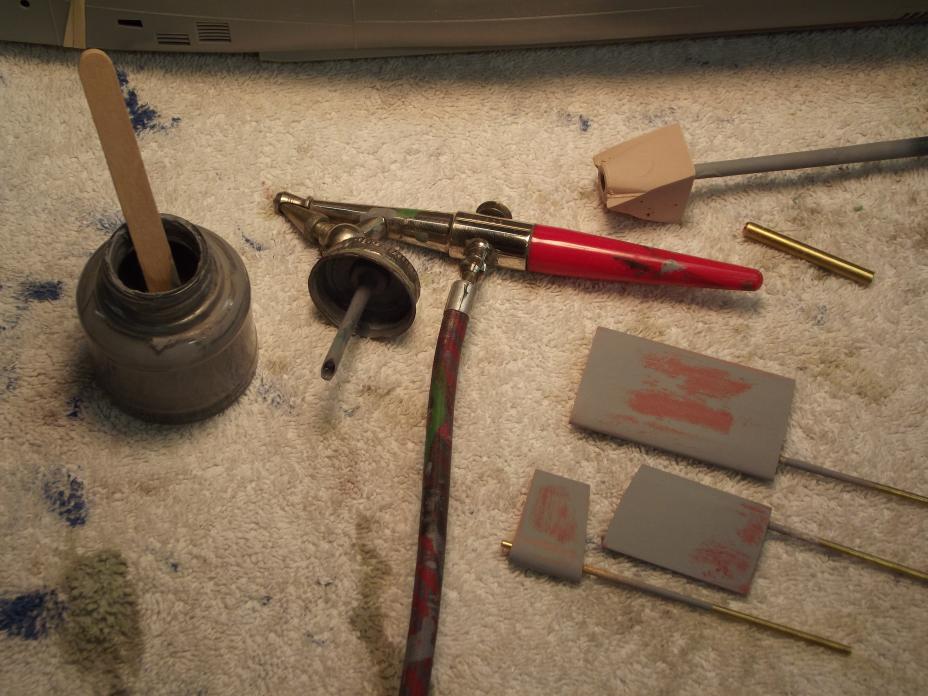

                    Got the closure system worked out for the upper and lower hull pieces. Basically, one set of capture tabs on one half, and another set of capture tabs on the other -- squeeze the upper hull piece a bit as it's installed and it pops into place up tight onto the lower hull. Neat.
                    Got the control surface, propeller shaft foundation, and Sub-driver foundation masters in primer-gray. Tool making tomorrow.

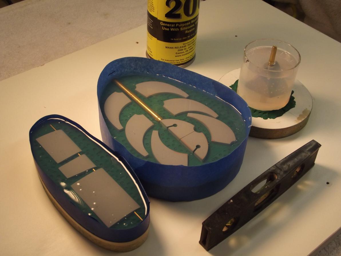

                      Time has come to stick things together, toss this piglet into the water and verify that the SD has enough ballast tank and that the linkages work as designed. But, before I can do that I need the parts. Today I started making the tools needed to produce production resin parts of the control surfaces, propeller foundation, and SD foundations.
                      The initial in-water trials can be done while the plastic parts are in the raw. I'll make the Type-23 look pretty at a later date, time permitting.
