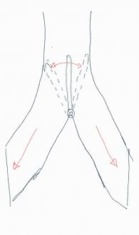

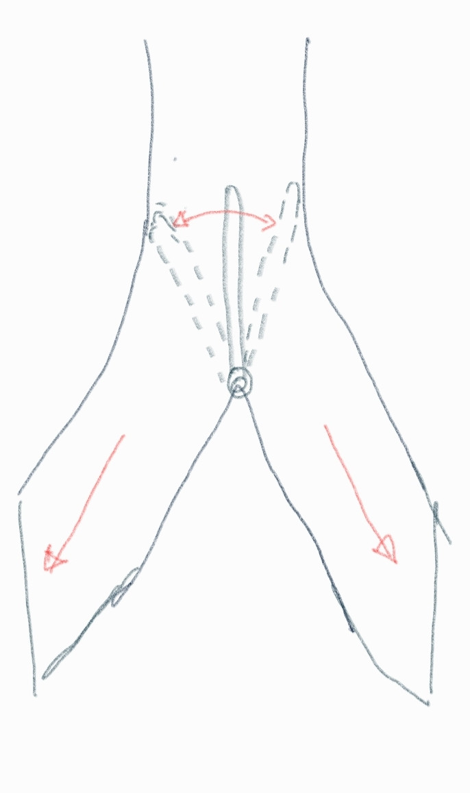

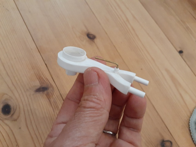

    Single pump- dual output. Diverter valve for differential thrust. Click image for larger version Name:	FB_IMG_1731326319972.jpg Views:	0 Size:	68.3 KB ID:	184036
    THAT!... is slick!
      THAT!... is slick!

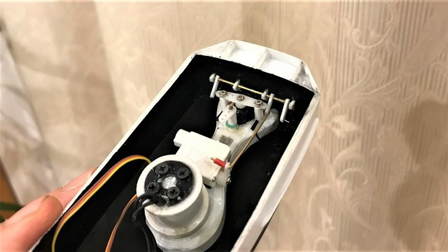

      Some more Click image for larger version
ID:	184069 Click image for larger version
      Click image for larger version  Name:	Screenshot_20241029_225029_Samsung Notes.jpg Views:	0 Size:	58.9 KB ID:	184067............

        What size is twin nozzel output dia.?*
          I like! Might be a good solution for bow thrusters.

              Have you done a tub test?
              IMHO the duct needs to be longer with a gradual bend not 45°. Also the gill slits need to be angled more so as not to restrict flow.
ID:	184178 Maybe use a hairdryer to open up the gill slits some more...
                  If does not work, I sure will have an interesting model...

                                Knock out the gills all together that might give the thrust needed
