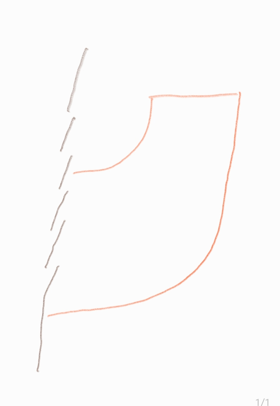

    Why don't you make hinges on the gills,so they can open enough when going forward
    Or control them by a servo to open them on command

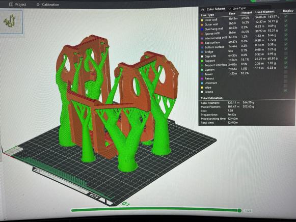

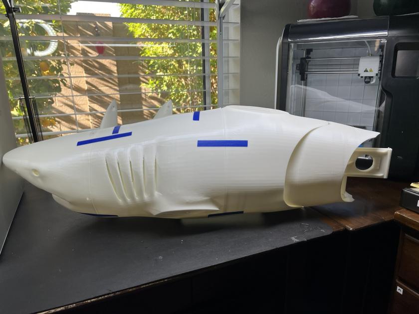

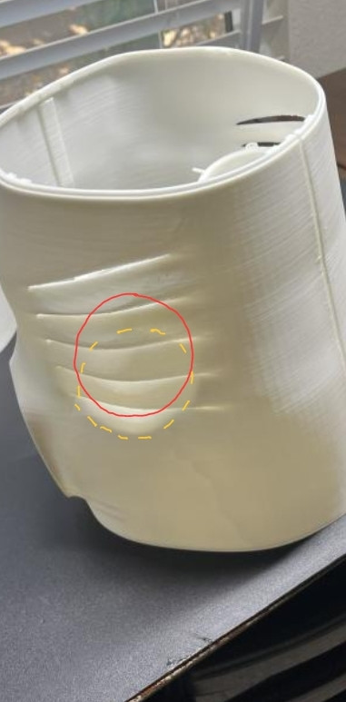

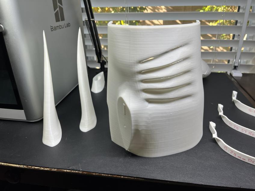

            Ducting looks too far back ( yellow dashed line) , the last 1/4 missed the gill slit.
            May or may not have deleterious effect on performance.
            We'll see during testing.

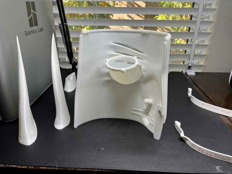

              #36

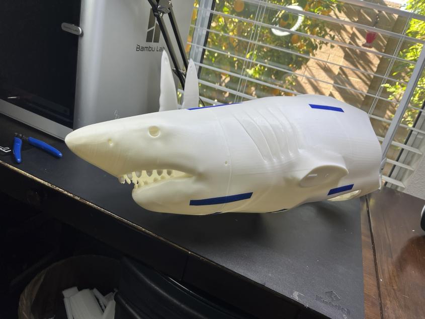

              Mine is a little more advanced. Printed with Bambu X1C too
              I'm still waiting for the waterproof 3p connectors for the motors.
              The only point to improve in my opinion is the pectoral fins that I find too inclined downwards and the teeth that I will redo myself with pieces of ABS
              Francois

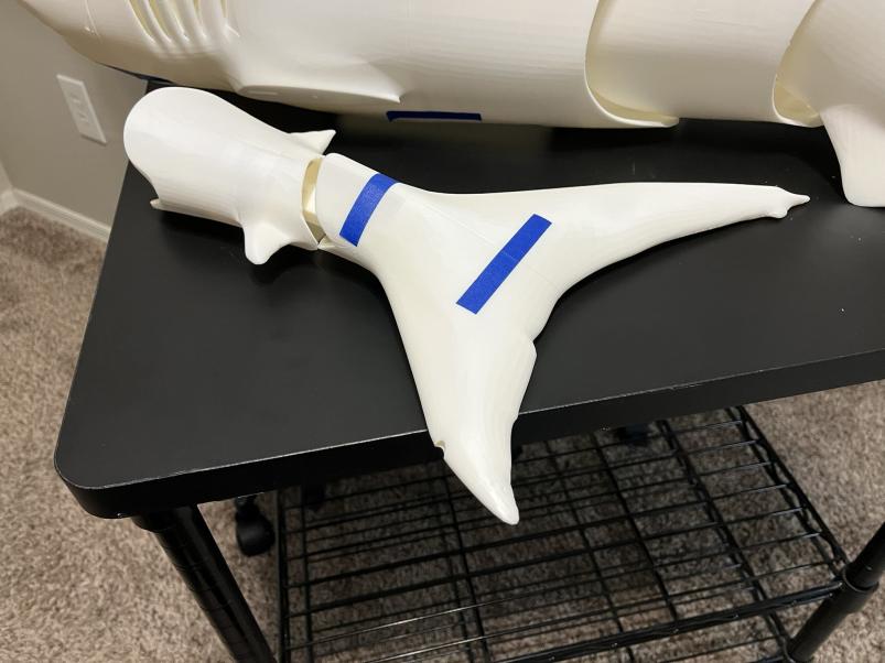

                  #38
                  Originally posted by MFR1964
                  Rob.
                  You gotta love 3D, giving you the possibility to make exotic models, me on the other hand i'm a classic builder, works for me, a question for you, total time of printing?, material used?, what will be the lenght of this shark? and the total weight when completed.
                  Manfred,
                  Sorry for my delay in answering your questions.
                  I do not remember the exact time it took to print out, but a 100% infill I am going to estimate at about 60 t0 80 hours. I use PLA on everything I do because of the environment that I have to work in. The total length of the shark will be at 48" give or take. As to weight, not sure at this point.
                  "Firemen can stand the heat."

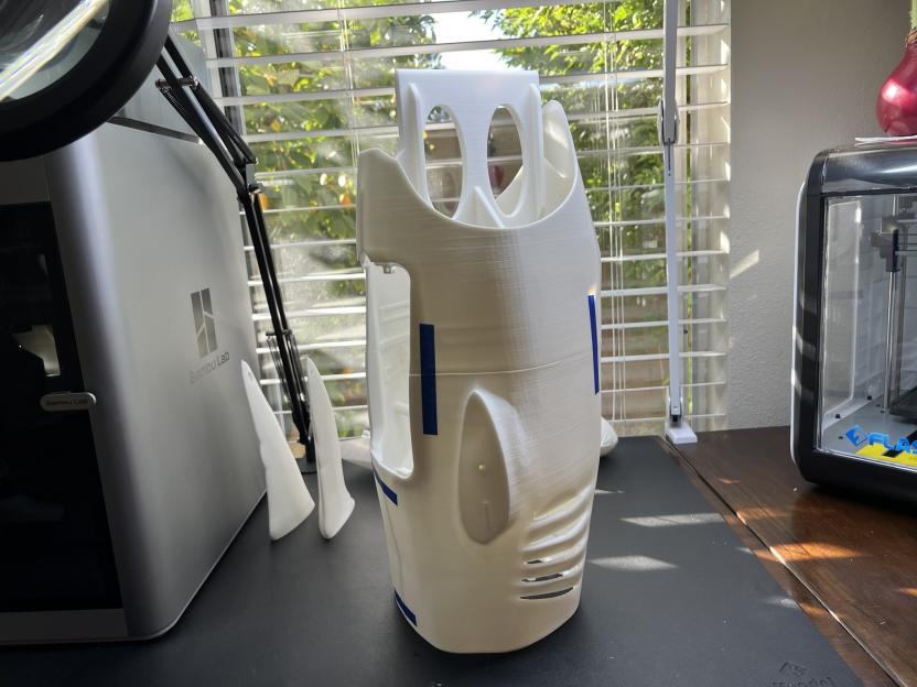

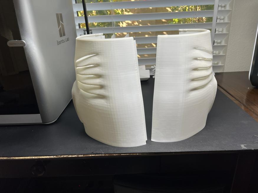

                    #39
                    OK!

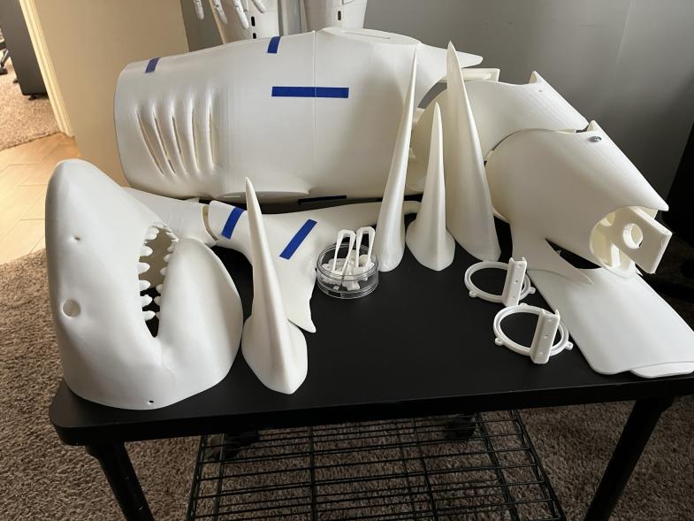

                    As to why I shut down this build and why I am reposting? A senior moment (at my age that would work) I think we will just go with that.
                    The next few pages will be all the photos of the shark build up to this point.

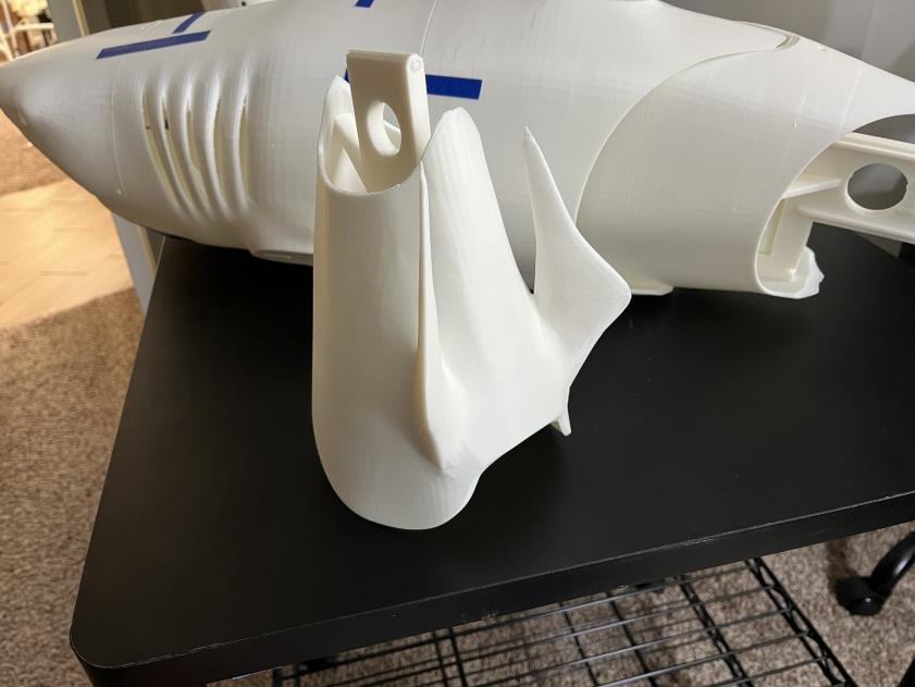

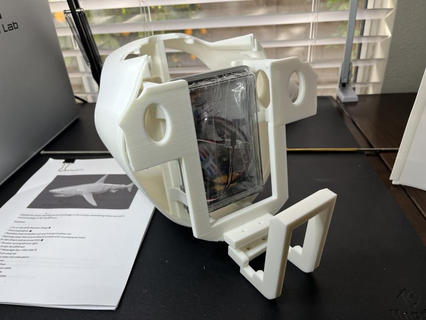

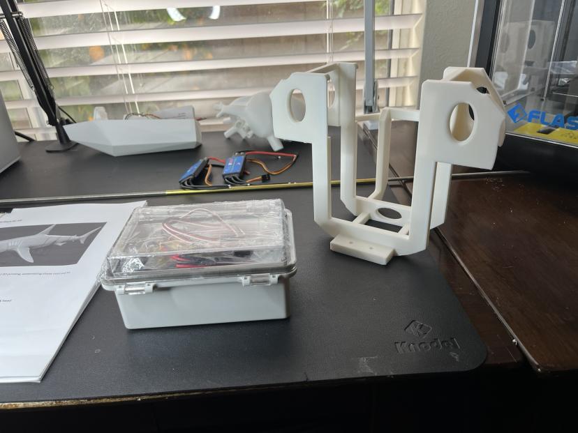

                    The three photos above show the mounting system for the two watertight boxes used for the electronics.
Name:	SHARK BUILD 23.jpg
ID:	185405 Click image for larger version
Name:	SHARK BUILD 26.jpg
ID:	185406 Click image for larger version
Name:	SHARK BUILD 27.jpg
                    The three photos above show the two thrusters and how they are going to be installed.

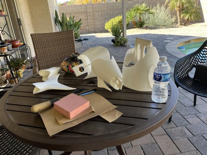

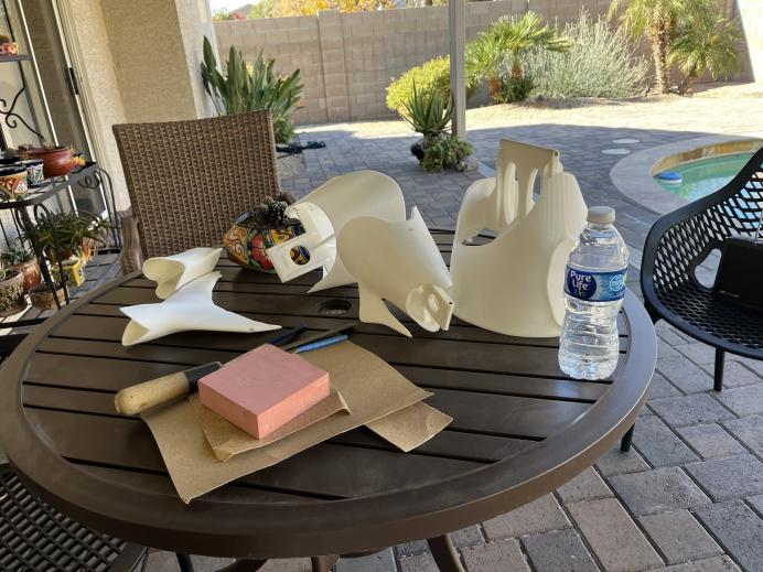

                    This last photo is where I left off. I took all the tail sections outside to sand and clean up the tail sections.
                    At this point I will pick up the build and start to show the actual putting it together along with the electronics and final testing and finish work.
                    Again, I apologize for this interruption in the build.

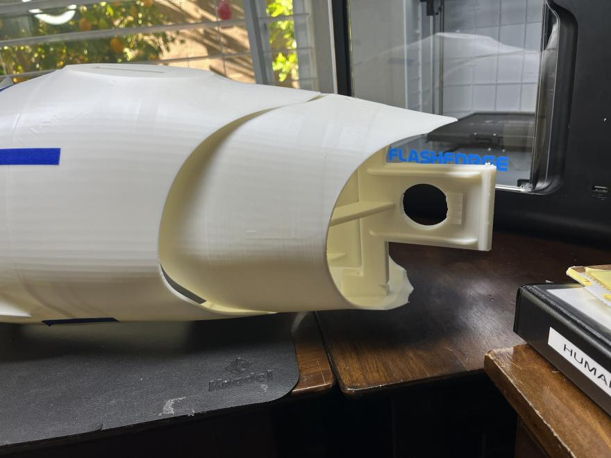

                        #41

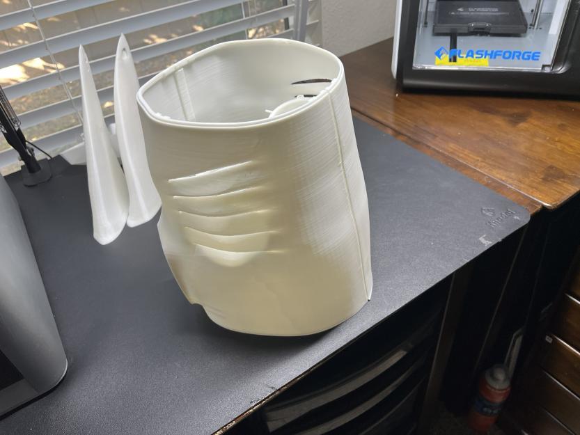

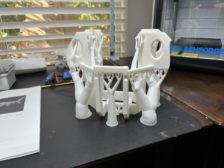

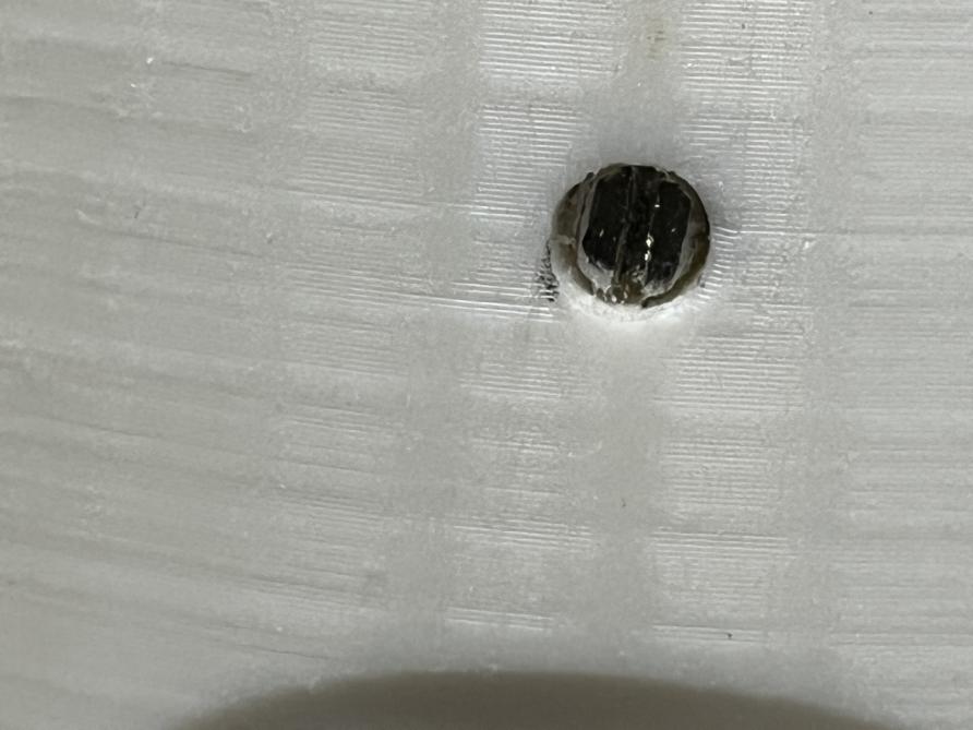

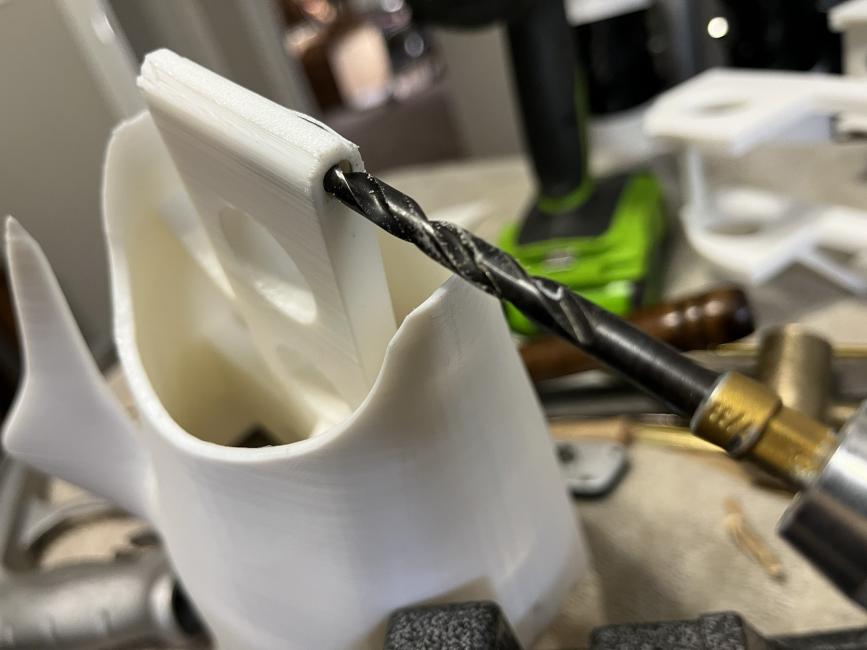

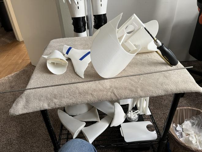

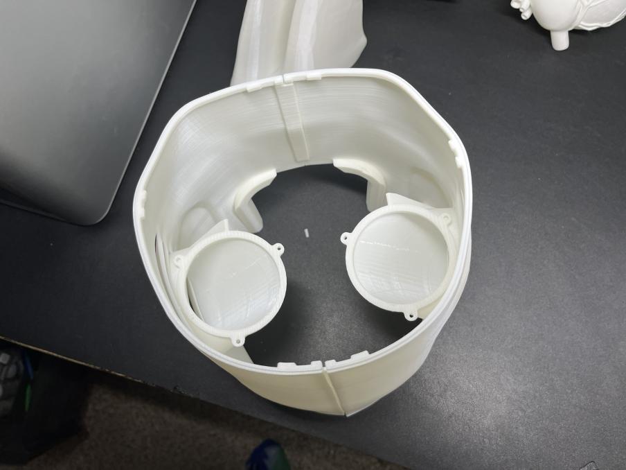

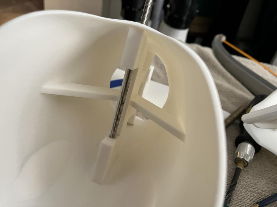

                        Back at doing some more sanding and fitting. The electronics mounting unit needed some clean up so the the two plastic watertight electrical boxes would fit properly and be just snug enough for a good fit, yet not to tight so they could be removed for repair work if required.
Name:	SHARK BUILD 30.jpg
Name:	SHARK BUILD 37.jpg
                        With this unit completed I can begin to put the main hull section together.

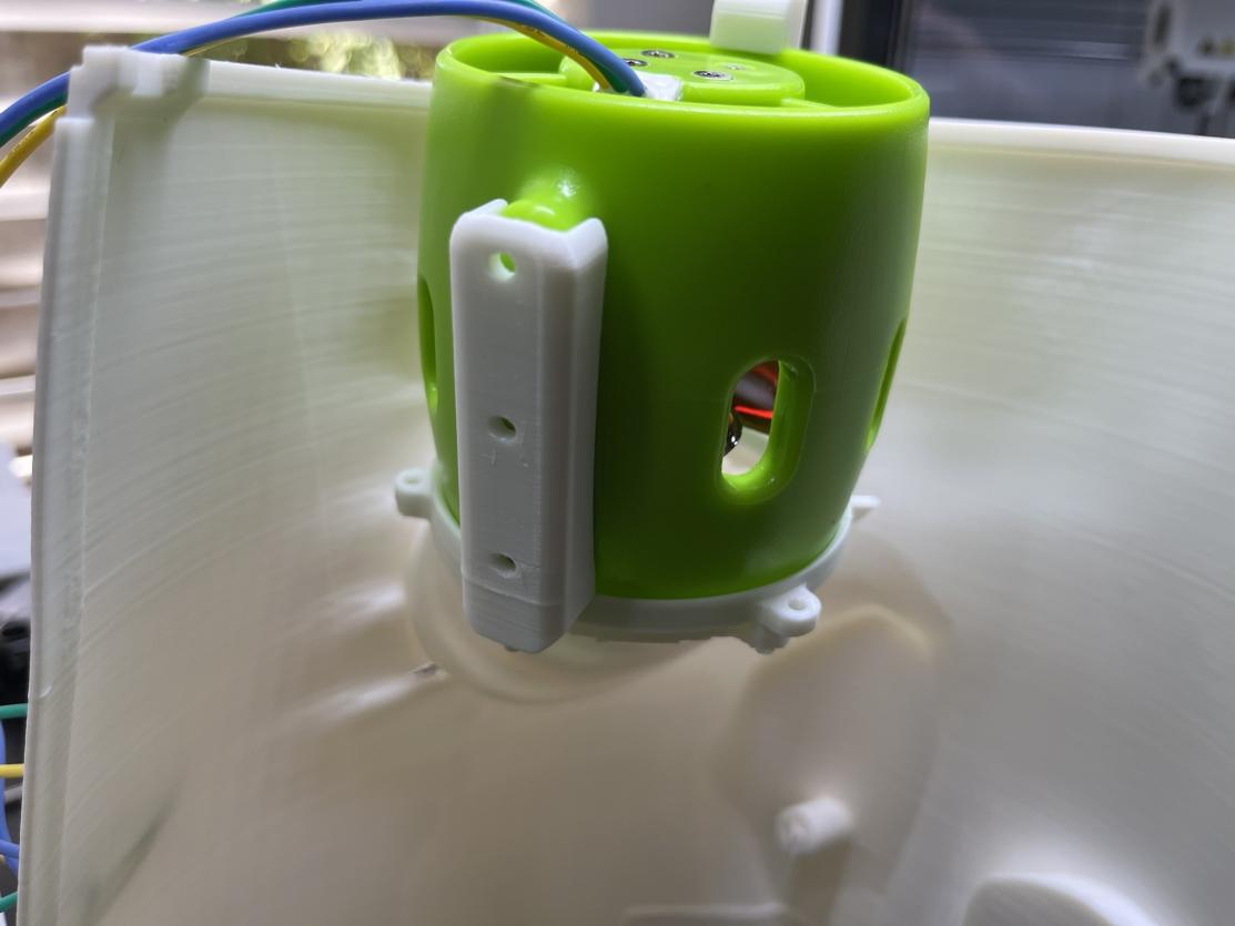

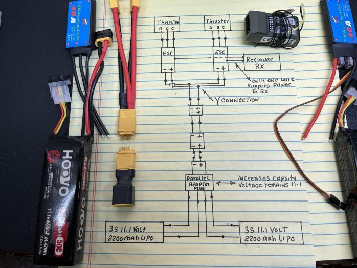

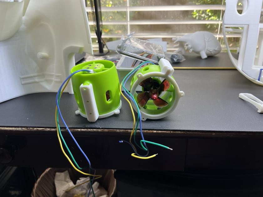

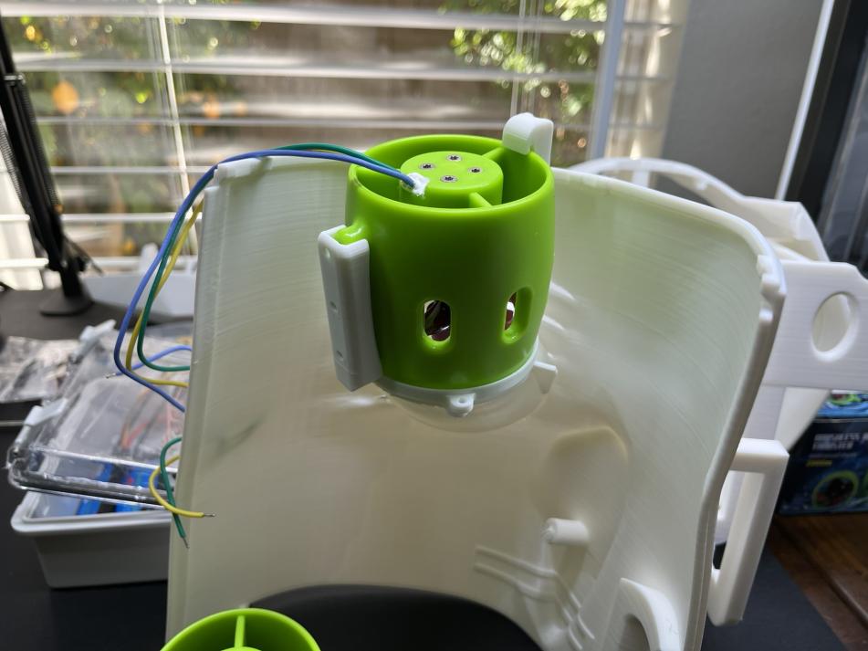

                              Before I get to far along with the main body and electrical WTC I want to set up all the electronics on a static board and test it out before the installation into the boxes.
Name:	SHARK BUILD 38.jpg
Name:	SHARK BUILD 39.jpg
                              I do have a drawing showing the preliminary design for the thruster's operation. My plan now will be to install the layout on a board and do a complete run check before installing this set up in the watertight plastic boxes.
