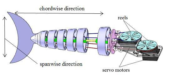

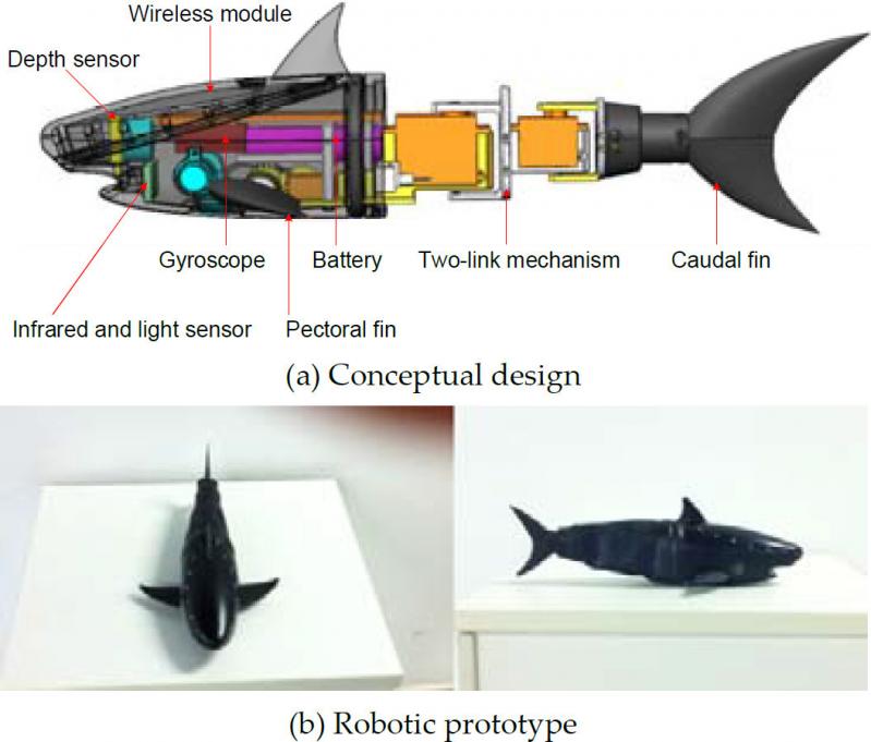

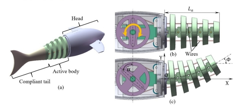

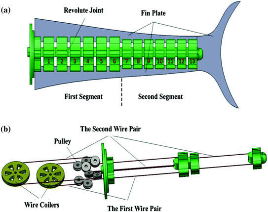

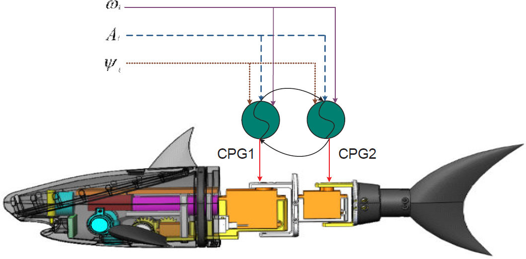

                  Consider taking your que from God and make the fin the propulsor. Two monster winch servos and you're off to the races. You operate in a small pool so you don't want speed and you can keep Bruce's big yap shut.

                      The YouTube below show the very shark that I will be building.

                        For reference the original research publication PDF describing this robotic fish project can be found at the link. There are also some cross references at the bottom of the page to other studies & publicationss on robotic fish
                        https://www.researchgate.net/publica..._Pectoral_Fins

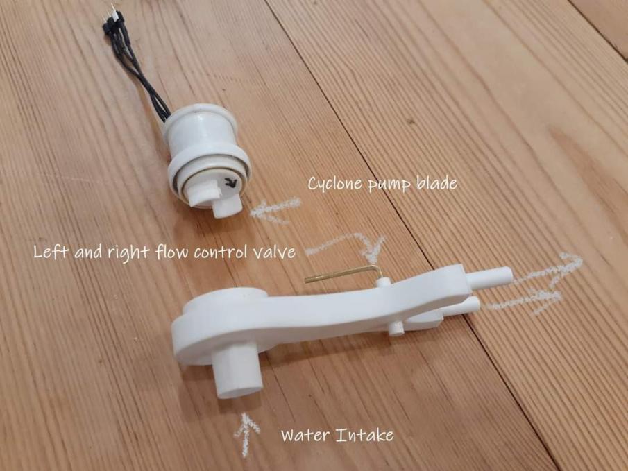

                              Single pump- dual output. Diverter valve for differential thrust. Click image for larger version  Name:	FB_IMG_1731326319972.jpg Views:	0 Size:	68.3 KB ID:	184036
