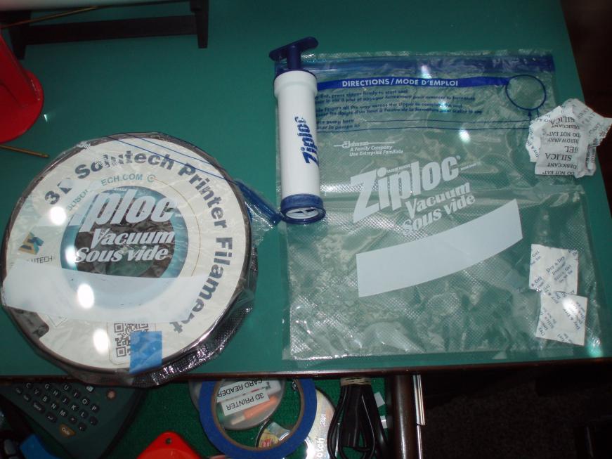

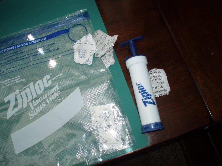

      I have been doing 3D printing for 8 years now and have NEVER used anything but PLA! You do not want to leave your PLA out in direct sunlight! you also have to be careful with moisture content. The filament will expand if it absorbs to much moisture, which in turn can cause nozzle problems. The other thing I like to do with my PLA filament, is not to leave it out in the open for extended times, (when not in use) I like to store my filament everyday if I am not using it. Some may say that is overkill, but it makes the PLA last longer (some rolls I have are 2 to 3 years old) and I do not have any problem with moisture or issues with age.
      My solution:
ID:	138753Click image for larger version
      I use the gallon size Ziploc vacuum freezer bag with the hand pump. I also use 2 or 3 fresh silica gel bags. What the bags do for you is to cover the PLA roll and the pump draws all the air & moisture out and along with the silica it keeps the PLA fresh and dry. This system works great for me. I never have clogged valves or filament that dry's out and breaks.
      I am sure there are lots of better filaments on the market for building Submarines. If the PLA is sealed properly and you keep it out of DIRECT & EXTREME heat and sunlight it works great. I will use nothing else. No toxins and it is environmentally safer to use! I have 3 PLA printed submarines (built and sealed PROPERLY) that have been in my pool several time (15 to 20 min at a time) No problems at all!

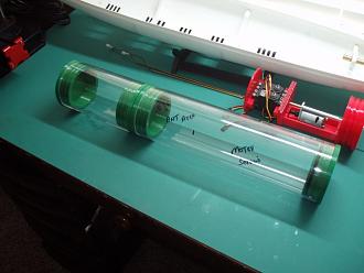

          I guess I like the OLD tried and true methods of 3D Printing! PLA all the way! Now we can get to this project at hand. The Albacore restoration.
          The 3.5"X12" acrylic tubes have arrived so I can get started on the fittings for the WTC.
ID:	138781Click image for larger version
          I am still working on the concept design and fitting sizes!

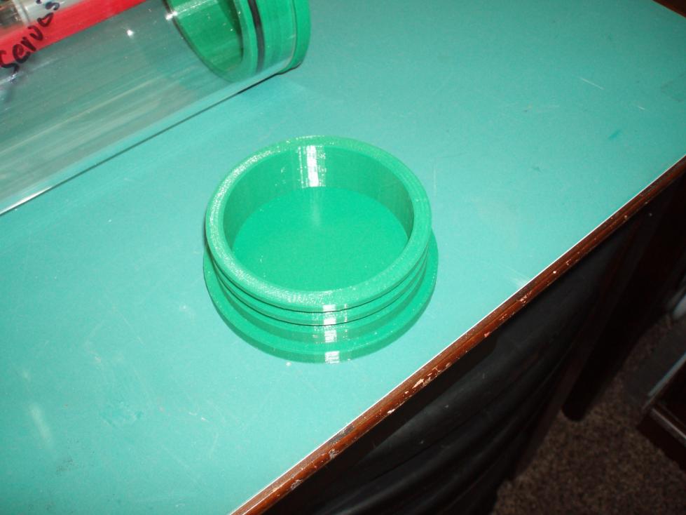

            #95
            After sizing up the end caps I now have the finished end caps printed and ready for installation.
ID:	138839Click image for larger version
            But before I finish up the end caps, I will start 3D printing the mounting systems for the motor, servos, ESC, RX, and the battery holder. So I will get back to designing and printing these parts for the WTC.

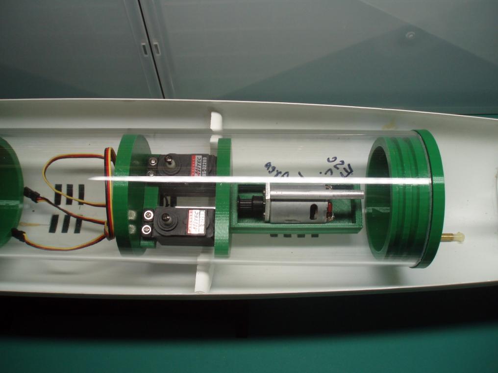

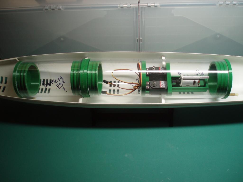

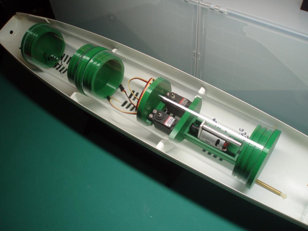

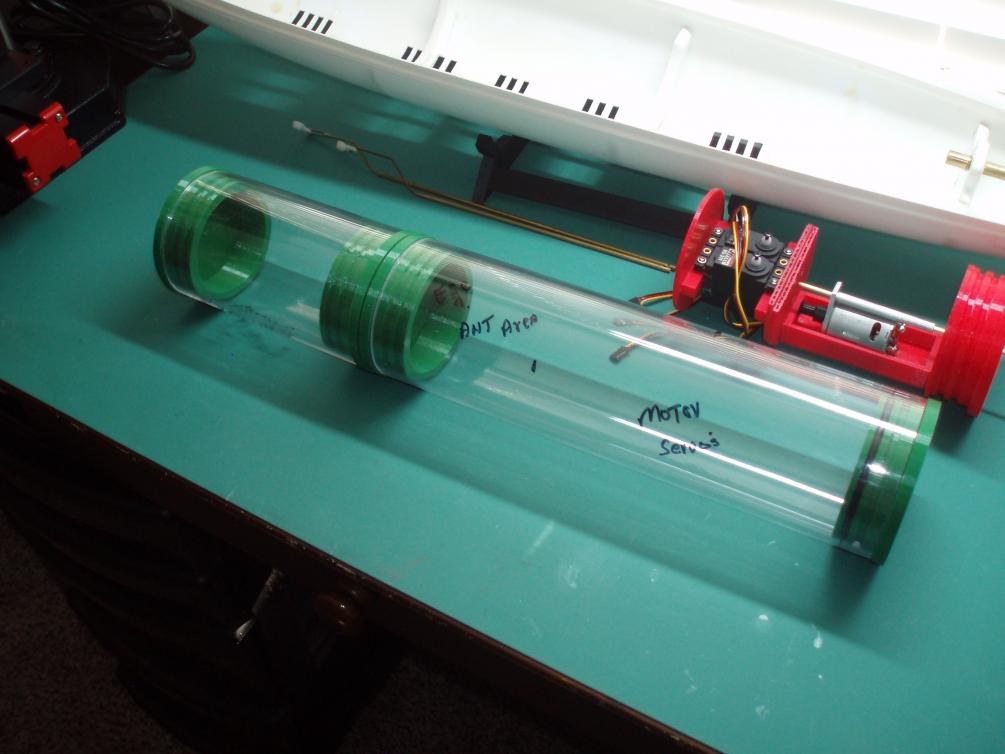

                      OK! Starting to make some headway with the Albacore WTC!
ID:	138963Click image for larger version
ID:	138964Click image for larger version
                      End caps are completed, servo tray is complete with servos mounted, and motor tray is complete, motor not installed yet!
                      "Firemen can stand the heat"

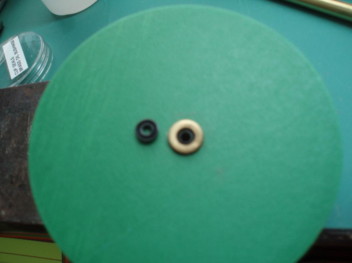

                        I have a question on my motor shaft end cap seal?
                        The shaft does seem to have some resistance as I turn the shaft. Is there a lubricate that would rejuvenate these type of cup seals?
                        Appreciate any input!

                          #102
                          silicon oil (not grease).
                            #103
                            Thanks David! I had the grease and not the oil, but good old amazon will have it to me tomorrow!
