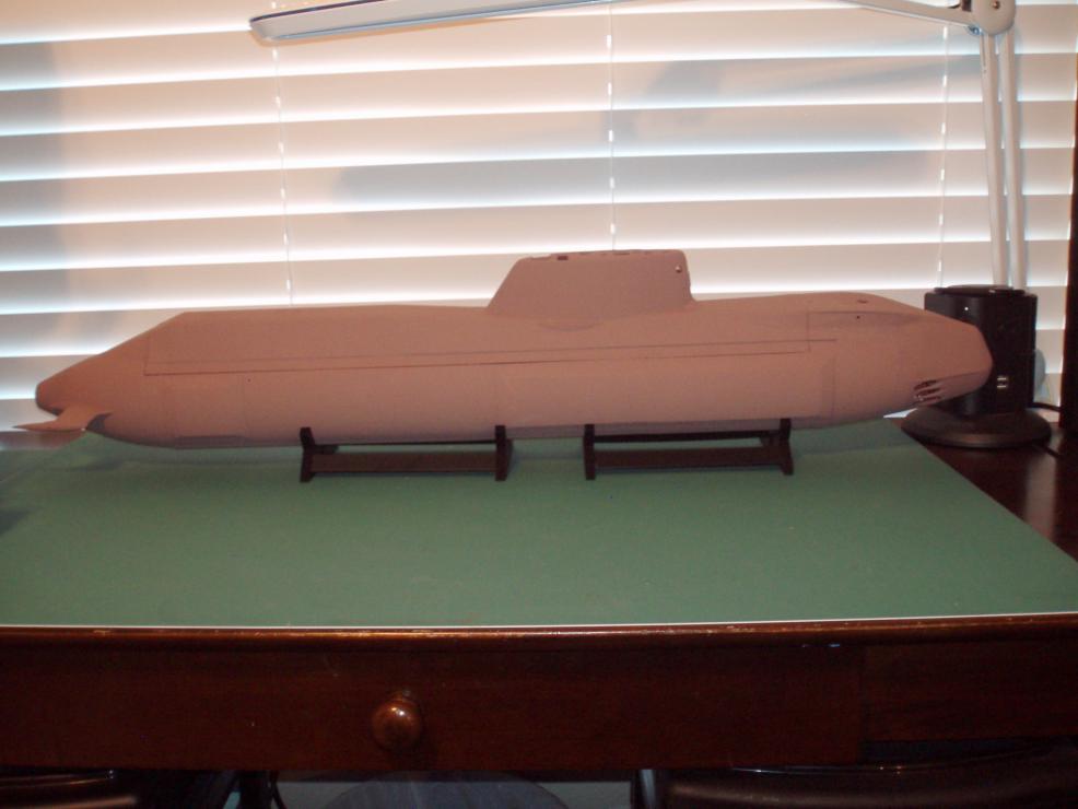

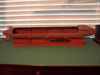

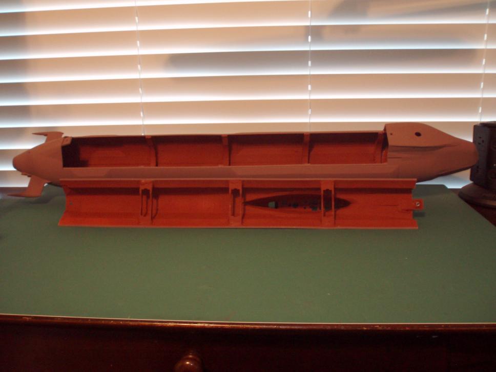

    Will start filling up all the scribing lines today and start making my usual brass stencils.
    What it was good for was to use it as a drilling stencil for all the holes in the deck. Lessons learned.
