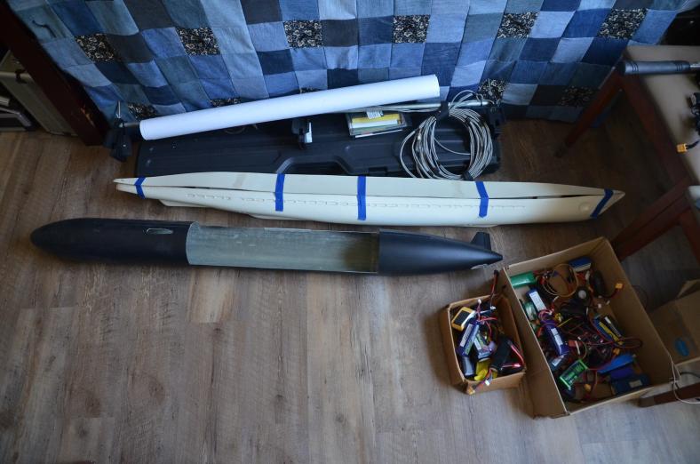

            #155
            It's a big boat.... just for scale, that's a 1/48 type IX hull in the picture with it...

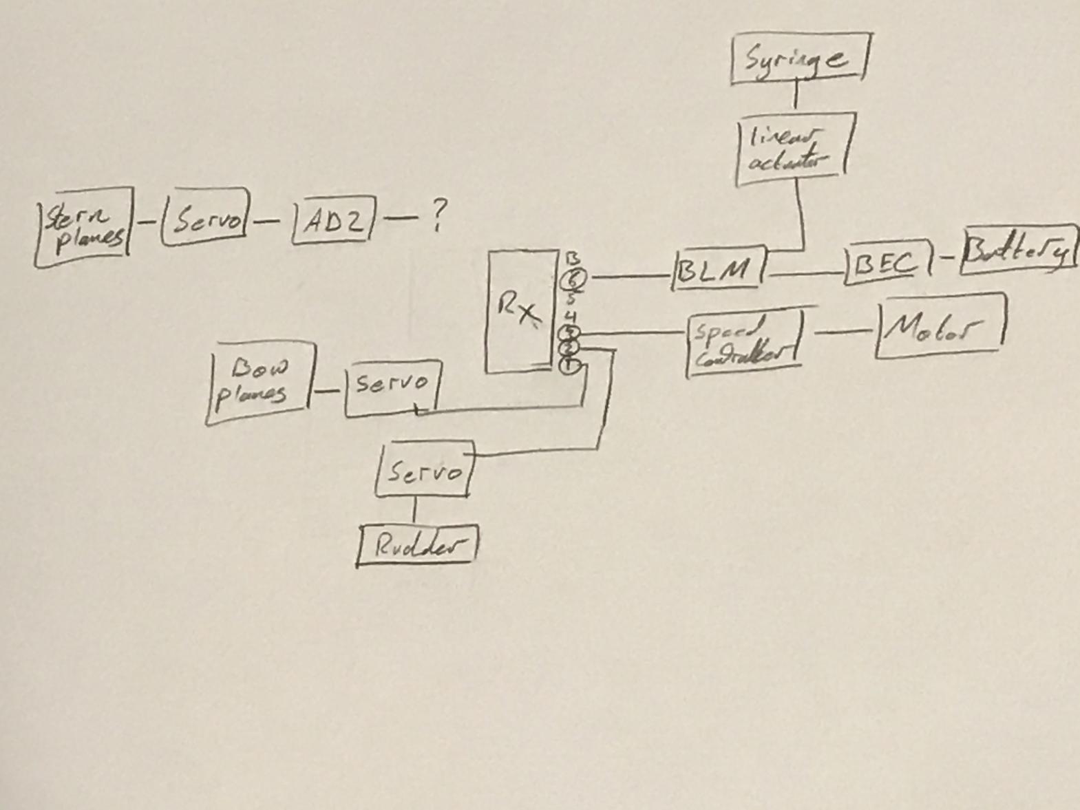

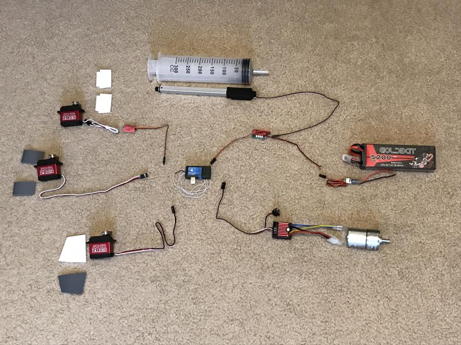

                Hello everyone,
                I'm finally getting around to working on the electronics and the WTC assembly and I've got a couple question on how I should be setting everything up; mainly in relation to where the AD2 is being connected and where and how my battery is being connected to the system.
                As far as I understand the stern plane servo connects into the AD2, and the AD2 acts as an autonomous controller for the pitch, but I'm not sure where on the reciever that the AD2 will plug into; does it get it's own channel or does it share with the bow plane servo (channel 2 in the picture)?
                Second question is how I'm setting up my battery. My initial assumption, as shown on the diagram, is that the battery goes into the BEC and then the BEC leads into the BLM. The BLM then connects to my ballast channel (channel 6 on the diagram) between the receiver and the linear actuator. If this is true, then that would mean that I can ignore the B channel (I assume B for battery) on the receiver, right? Also, my speed controller comes with it's own battery input connectors and an on-board BEC, would I need to do anything with the speed controller to prevent interferences or anything?
                Thank you in advance for any suggestions or advice :D

                  #158
                  Stern plane servo lead to AD2; AD2 input lead to receiver port ch-6 (the one with the rotary knob on the transmitter).
                  Battery to BEC power wires; BEC 5-volt output to any unused receiver port or port marked, 'battery'.
                  Receiver port ch-4 to BLM's three-wire servo lead; BLM output to ballast servo and LPB through a Y-lead.
                  Okay, I think I've got it, I'm redrawing the block diagram right now.

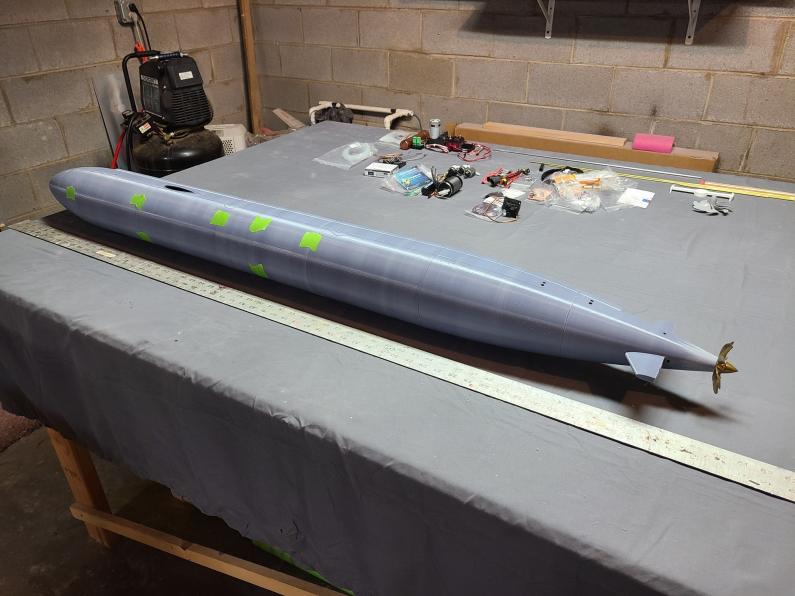

                        #161
                        The current 1/72 LA boat I am printing. 5-1/2" beam and 60" long.
