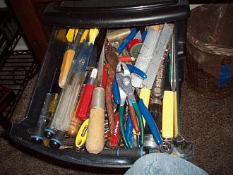

                            #1048
                            Having the right tool, and handy when its needed sure is the way to go!
