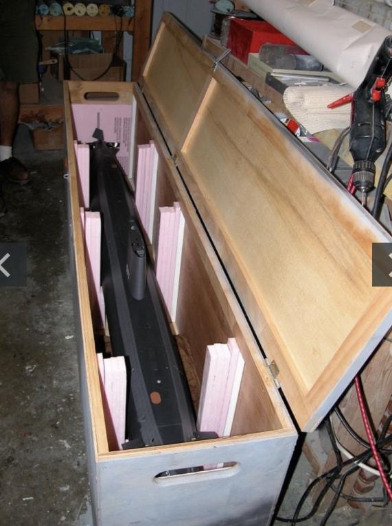

        What's the point in assembling a complicated, practical, beautiful looking r/c model submarine only to have it damaged and defaced during transport and later storage as you shift your attention to other matters?
        I answered that rhetorical question long ago by making it a practice to provide each of my r/c submarine models with its own, custom built, transportation-stowage box.
        Illustrated below are just a few examples, their lids removed to show the contents. Note how soft foam-board frames are used to cradle the model, the hull centered in the box.
        Not shown here, but each box lid has attached to its underside a like array of foam frames, each contoured to girdle the models upper works, just as the lower set of frames supports and girdles the models lower works.
        No big deal. A transportation-stowage box is, after all, just a six-sided,1/4-inch-thick exterior grade plywood container, reinforced at the edges and corners within by 3/4-inch square wooden molding, and outfitted with 1/2-inch-thick insulation foam frames cut out and arranged to support the model within.
        Ellie and I, over the years, have built and worked with small, medium, and stupid-large transportation-stowage boxes. Those boxes serving one major purpose: to protect the contents from damage, no matter how the box is bounced, shoved, inverted, and dropped.
        My model boating buddy, Phil Kordich, built this box. It's fine for the most part, but there is no provision to stabilize the model within should some fool load the box upside-down, or the box should tip over for whatever reason.
        No. I found the only sure-fire way of protecting the model is to cushion it from force applied in any direction; it is my practice to literally cocoon the model in protective foam framing and structural webbing.
        The job, of course, starts with the wooden box. Big holes in the sides permit air to flow freely within. That's an important feature as often the model is put in there still wet from a run at the lake or pool.
        As to the box dimensions here's my rule-of-thumb (these are inside measurements):
        Length is model length + 2-inches front, and 2-inches at the back.
        Width of the box is width of the models maximum appendage projection + 1.5-inches each side.
        Height of the box is the height of the model from keel to top of sail (masts stowed retracted or removed) + 2-inches at the bottom +2-inches at the top.
        In addition to the foam sheet frames I'll also provide foam sheet structural webbing, top and bottom, to lend further support of the model within the box and to also stabilize the frames.
        The lower array of frames and webbing is glued to a 'floor' made of the same insulating foam as the frames and webbing. This floor sits within the bottom of the box and is removable. The upper array of frames and webbing is glued to the bottom side of the boxes removable lid. That lid is secured in place with deck-screws that run into the molding strips atop the box.
        First item cut out from the sheet of insulation foam is the floor, which is marked for locations of lower foam frame pieces which will be epoxied to it once they are cut to contour with the bottom of the models hull. Same will be done for the upper half of each frame, but those items will be affixed to the bottom side of the boxes lid.
        As the hull section geometry is constant through most of the submarines length, most of the frames will be cut out in an identical fashion. Only at the bow and stern will special frames be required because of the hull tapper at those points. I've already started in on a cardboard template that will be used to mark out the frame cut-outs -- having lofted off the sectional form of the submarine with the aid of calipers, compass and other drafting tools.
        Using the paper template to mark out the cut-outs to the frame blanks. Each frame will be divided into an upper and lower half, the split occurring at the centerline of the submarine.
        The floor is set into the box and the bottom halves of the first two sets of frames are positioned within and the model carefully lowered into the box. All this to validate that the model is properly centered within the box. That check completed I can, with confidence, finish cutting out the rest of the frame blanks.
        The band saw, equipped with a very narrow blade, capable of tight radius ruff cuts, makes quick work of punching out the centers of the foam frames. At this point the frames have not been cut into halves.
        An oscillating vertical drum sander refined the cut-outs. Once cleaned up each frame was cut into an upper and lower half.
        With the aid of straight pins the lower half of the frames were epoxied to the floor piece.
        The model was then plopped down onto the frames, and I began the laborious task of lofting the geometry of the bow and stern stations off the model. That dope needed to start work on producing accurate (Ha!... never happens the first time!) cardboard templates for the bow and stern frames.
        Cardboard section templates for the upper and lower forward frame. Note the tight, perfect fit with almost God-like accuracy... achieved after only five previous, unsuccessful attempts! This method is more gosh-and-by-golly than science, I can assure you.
        With all bottom half of the frames glued to the floor, the floor was inserted into the box and the upper half of the frames pined atop their counterparts at the bottom. I then applied epoxy glue to the top edge of each upper frame half, sat the lid in placed, and drove all of its deck-screws down tight. This permanently bonded the upper frame halves to the bottom of the boxes lid.
        The lid was pulled clear and foam structural webbing installed.
        Done! Now, back to fun kit-assembly chores.
                          The transport boxes are as Good looking as the model they are made to protect!
