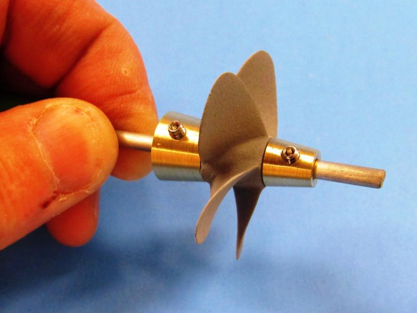

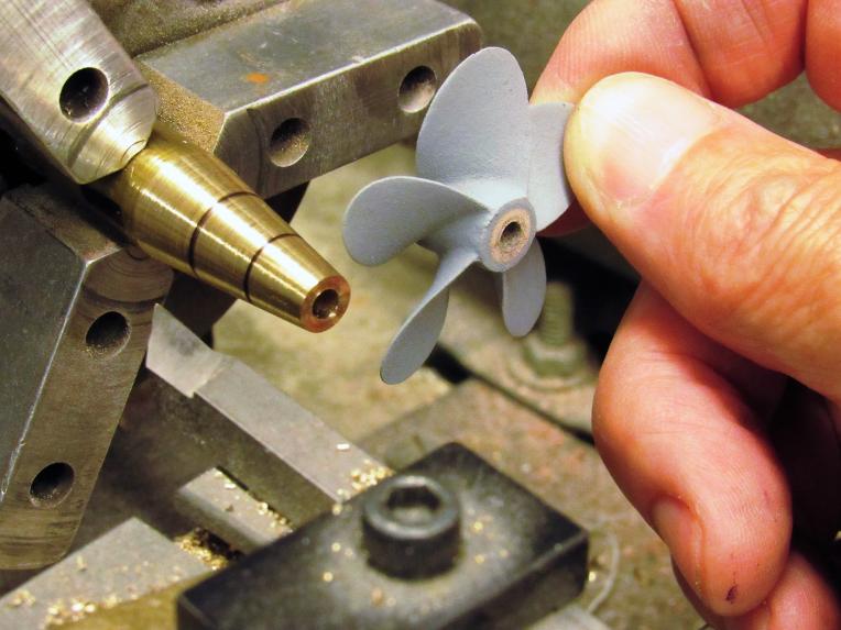

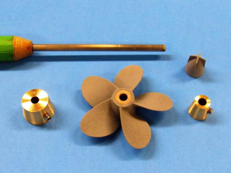

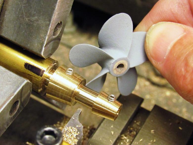

    So you're using the locking collars as guides in tapering the propeller hub.
    Will you be fabricating a new dunce cap or just use the existing kit part?
      • 13982
      #1187
      Yes, a bit like how I assured symmetry of this 1/96 ALFA propeller hub.

      I'll be making a new, properly fitting, dunce cap.
