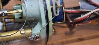

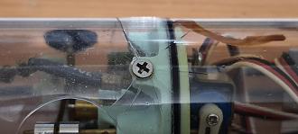

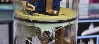

ID:	161510Click image for larger version
ID:	161511Click image for larger version
ID:	161512 So that's what happened to mine.
                Drilled a small hole at the end of the crack to prevent it progressing further then used UV cured glue to seal the crack. Still haven't tested it though.

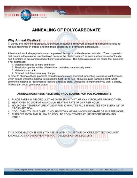

                    There you go: Annealing of Polycarbonate (thomasnet.com)

                      #1210

                            Really interesting and one I will look into. The hard part is how will I do that in our oven. It will mean me taking my wife out to dinner and come up with a good answer why I have clear pipes baking at 250 degrees. LOL
