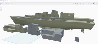

Since I'm mostly a 'skimmer' guy, I'm also working on scaling up a 1/1000 version of the Halifax Class Frigate to 1/144 to make it R/C suitable.
See how it goes. I've got a sample print going right now.

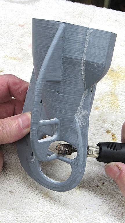

To make a quick and dirty filler you first apply wet CA to the area you want to fill. You then sprinkle on backing soda, (Sodium bicarbonate) over the goo. The high pH of that compound is very high, causing the CA to cure hard almost immediately. You then grind away the excess with rotary tools, files, and sanding sticks.
Like so:
