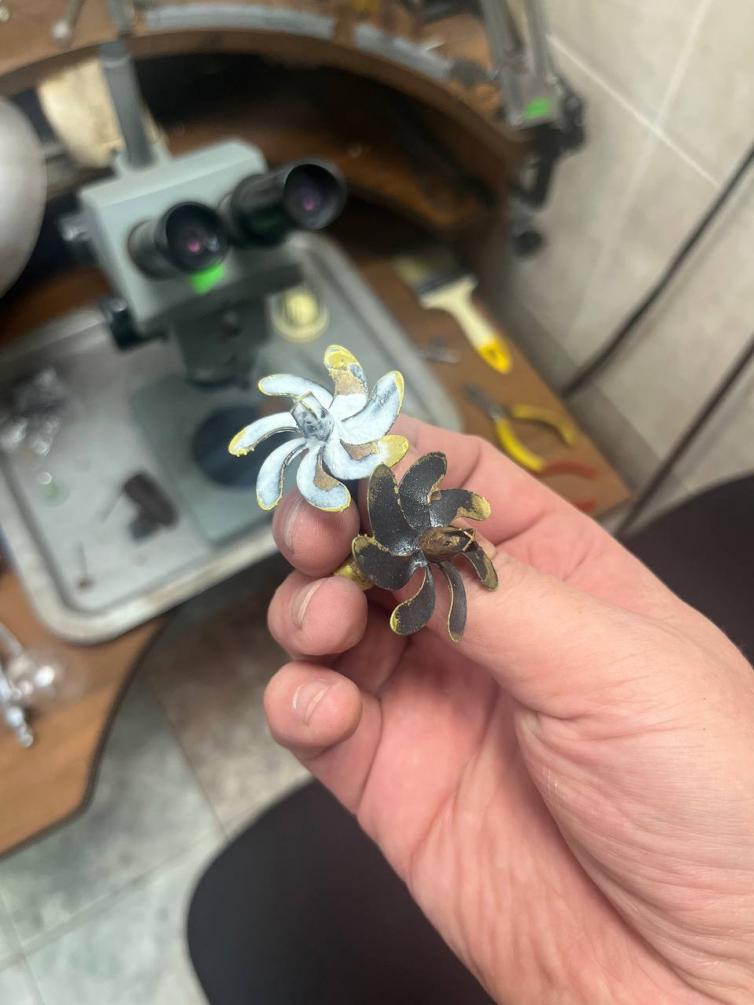

          My first step toward building my own radio-controlled boat. I cast brass propellers for Project 941.

            #3695
            Investment casts! Excellent.
            What's the plan once you chop off the sprue -- how are you going to formulate a fixture to hold the work as you bore out the propeller shaft hole?
            I applaud your effort so far. Nothing looks like brass other than... er... brass!

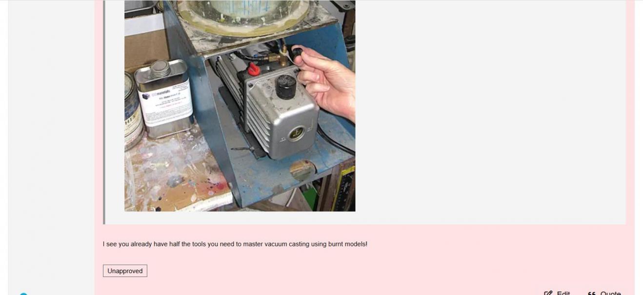

                        #3701
                        I see you already have half the tools you need to master vacuum casting using burnt models!
                        • CollectiveBorg
                          • Dec 2025
                          • 34
                          #3702

                            #3703
                            Though marked, 'unapproved', I still got your post.
                            Yes, I'm well equipped but don't have a burn-out oven or crucible for melting the brass ingots (I was trained by a Jeweler decades ago, but never had a use for the process in my business)

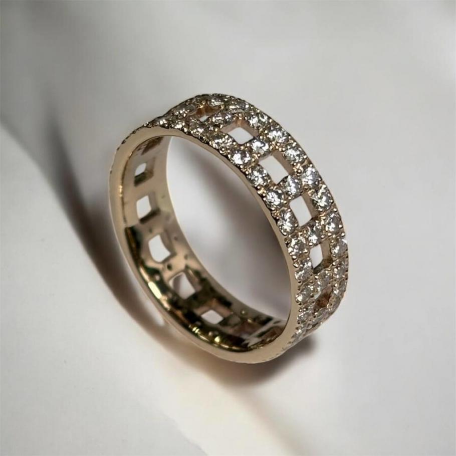

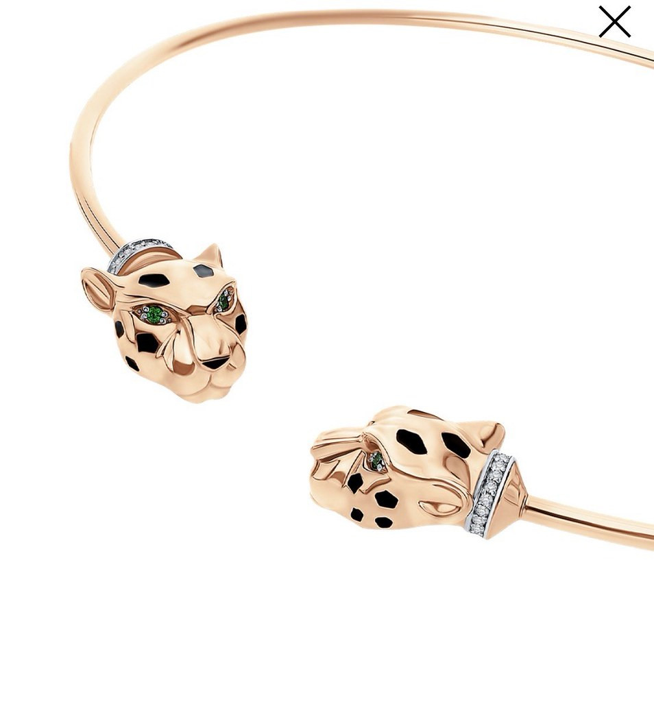

                              I created a topic ( Investment Casting: Everything You Were Afraid to Ask or Didn't Know), Where I'll describe, show in pictures and videos, what I do every day. I'll show all the steps step by step specifically for this forum, using the example of a product required by modelers.
                              I apologize in advance; English isn't my native language. But if you're interested, I'll tell you everything you need to know about how to do it without spending a lot of money.
                              By the way, I use the same technology to make things like this:
                              (Yes, this is my work, it's 14k gold, these aren't photos of a neural network; I have photos of the intermediate stages as proof):​
